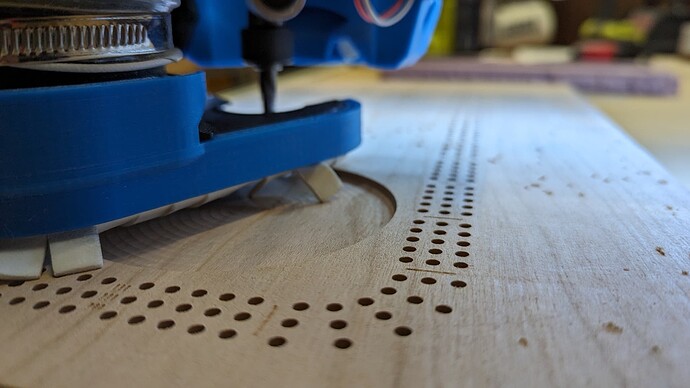

Tests look good! I’m pleasantly surprised with how well cherry wood mills. Tomorrow is the real cut…
Go spinning murder robot cutting monster thing!

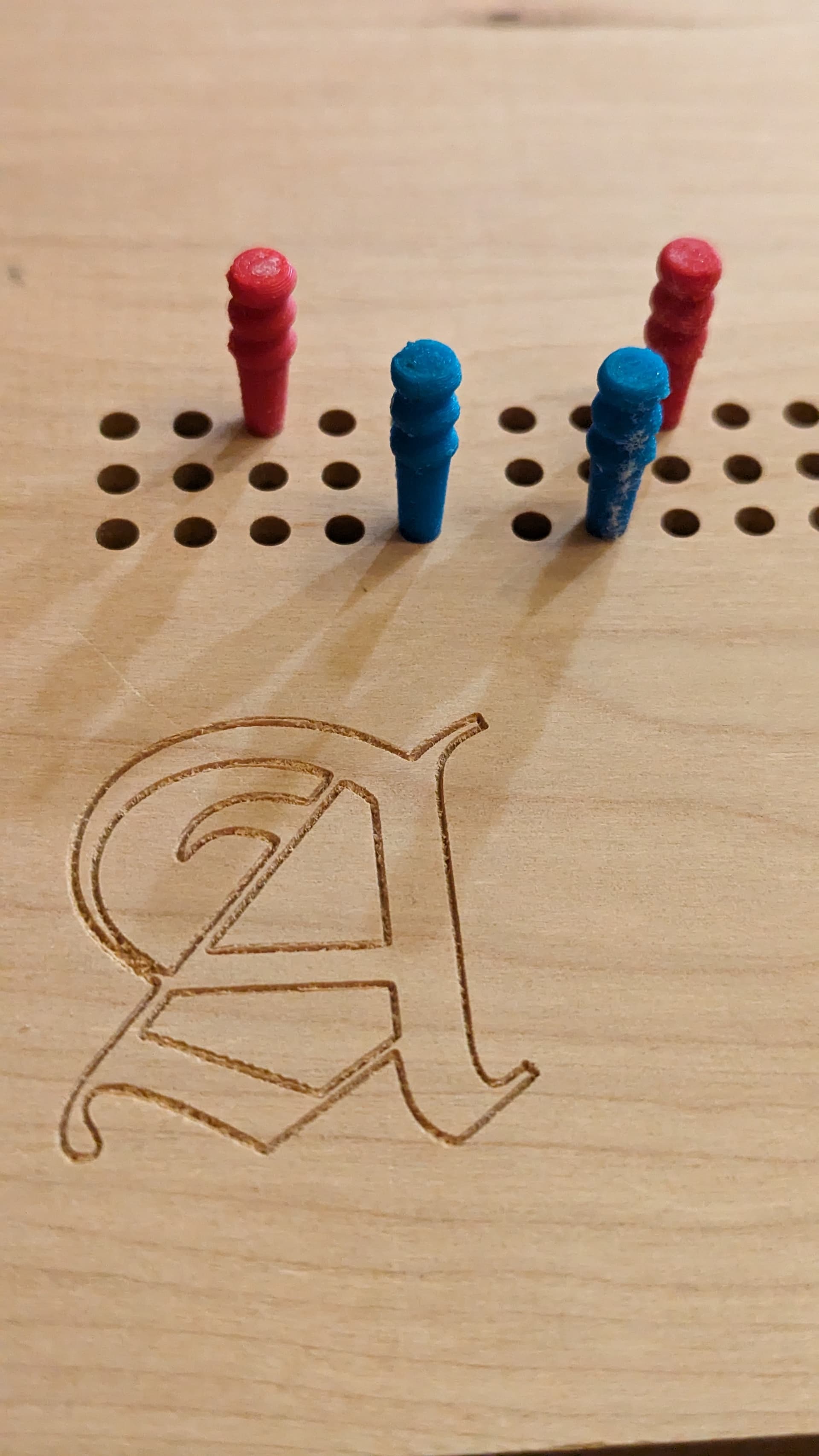

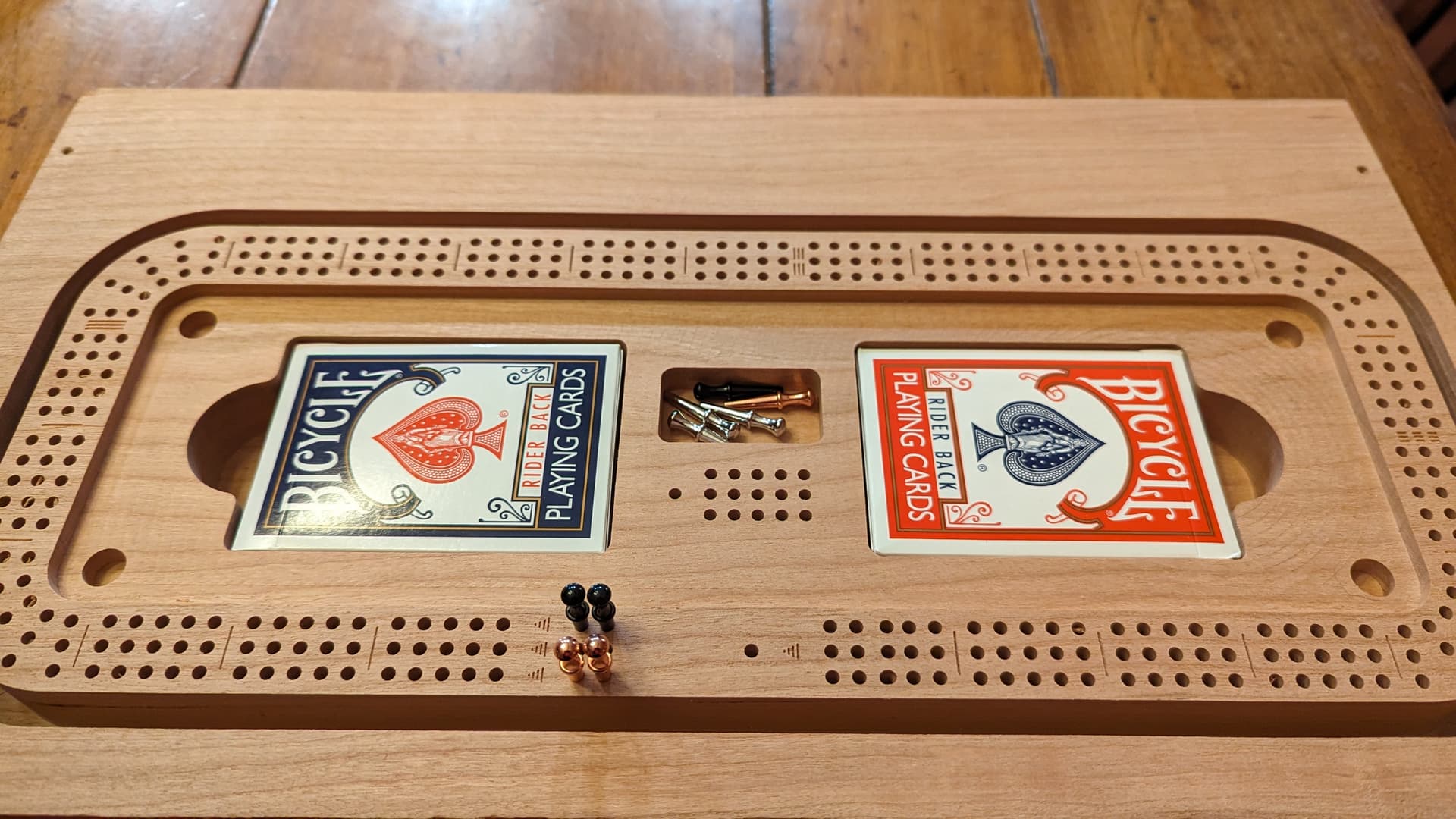

First cut is done and I’m pleased with it. There’s a LOT of sanding in my immediate future…
I guess one of us needs to create a “sanding robot” to go behind the “spinning murder robot cutting monster thing”!
Great looking board! Nice cut!
Very nice beautiful design. Cherry is wonderfull but sharp tools and correct feed are require to prevent burning it looks like you nailed it. I love working with cherry finishes wonderful and gets more beautiful with age.

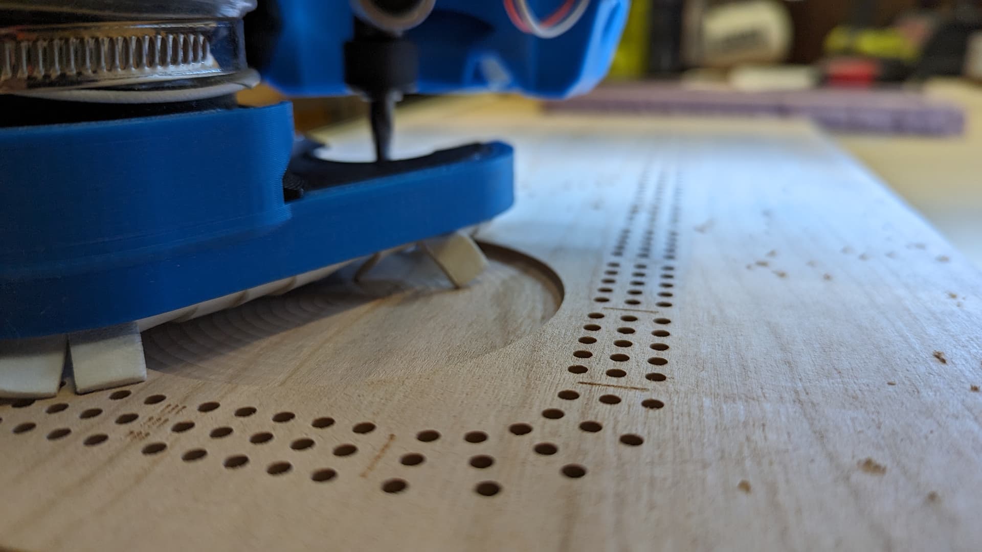

How long did it take to do all of the holes? I’ve read some other posts about using a drill bit (designed for less than router speeds) vs cnc bit which can’t go as fast. Wondering how it went for you.
The holes are pretty fast. On the order of 15-20 minutes.
I’m using the 1/8" carbide drill bit from IDC Woodcraft that’s designed for this use case, and it cuts beautifully. No worrying about the bit heating up too much, and you plunge pretty quickly with it.
There’s a bit for everything! Thanks for the info. It looks beautiful; whoever gets that board is going to be real chuffed. So cool!
