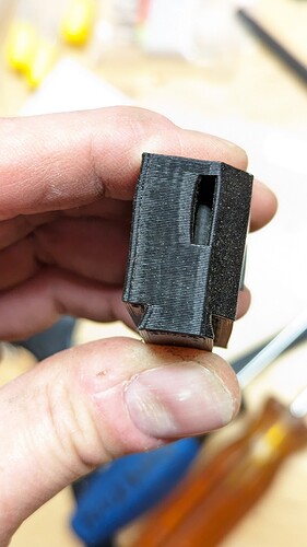

When it loosens, the belt is pretty floppy. I have been tightening it only to the point where it doesn’t flop around, but not so much that it makes a sound when plucked. I am going to reprint the adjustable belt holder for that side today. The non-rail belt has not budged, so it’s likely the print.

Hopefully I explained myself ok in the first post. Is the screw able to get into the block enough to get to the M5 lock nut inside? There is a locknut inside correct?? If both of those are a yes then the belt shouldn’t be getting any looser than how you set it.

Yes, both of those are true. But I think I saw somewhere else on the forum that it could just be that it printed with a slot that’s a little too big so the belt slips a little. I can’t count how many times I’ve removed and reinstalled it, so that obviously isn’t helping.

Also, I found the belt issue:
The Y min end loop had slipped inside the holder. I replaced the holder and stuck the cut end of a zip tie in the loop, which should keep the belt from slipping into its holder again.
