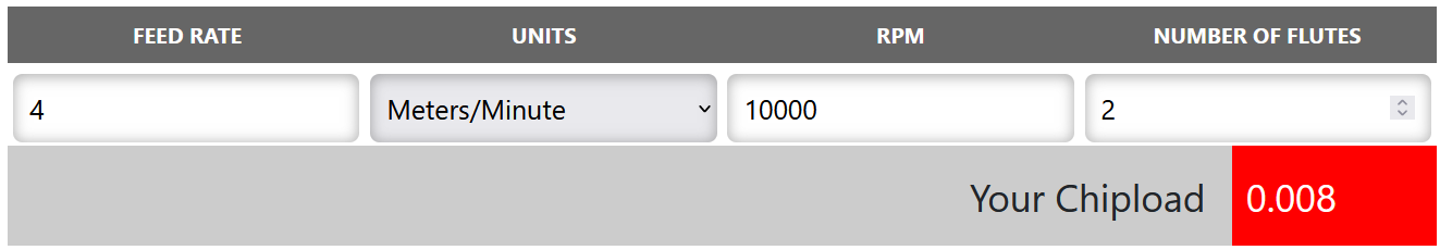

Given that I am cutting deeper than the bit width, I knocked 25% off of the given chip load per the calculator instructions. I’m still getting 66 mm/sec when I lower RPMs to 10000:
Maybe (well, probably) I’m thinking about this incorrectly, or not using the calculator properly. I also get fast feedrates from the calc linked on the Milling Basics page of the docs (https://app.fswizard.com/) - nowhere near as slow as 20mm/sec.
Should I lower RPMs? Seems counter-intuitive to me that lower RPMs = faster feedrate.

My math is off. I was calculating for cm/s not mm/s :pensive:
Which would make 210mm/s the feed for that .013 chipload. That seems so fast. I’m probably doing something wrong here.

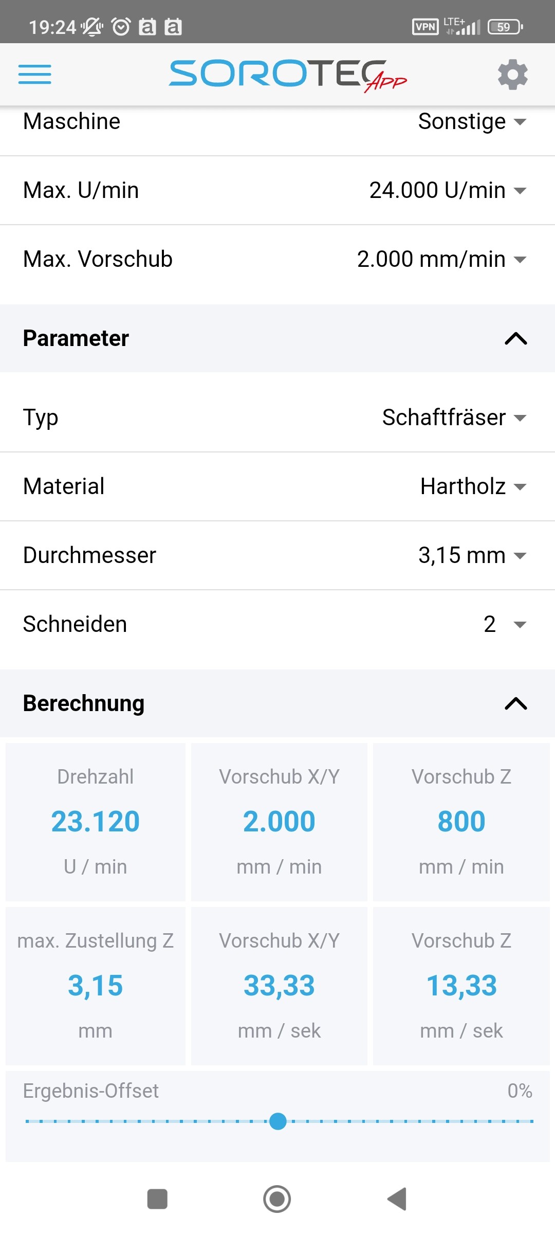

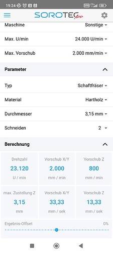

In another thread I posted a screenshot of the Sorotec App, for your 2 flute it calculates this:
So 33mm/sec, but with a lot shallower cut and nearly 24k RPM. And they usually have suggestions for more rigid machines.

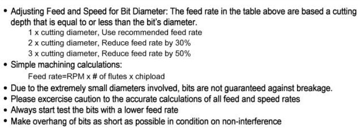

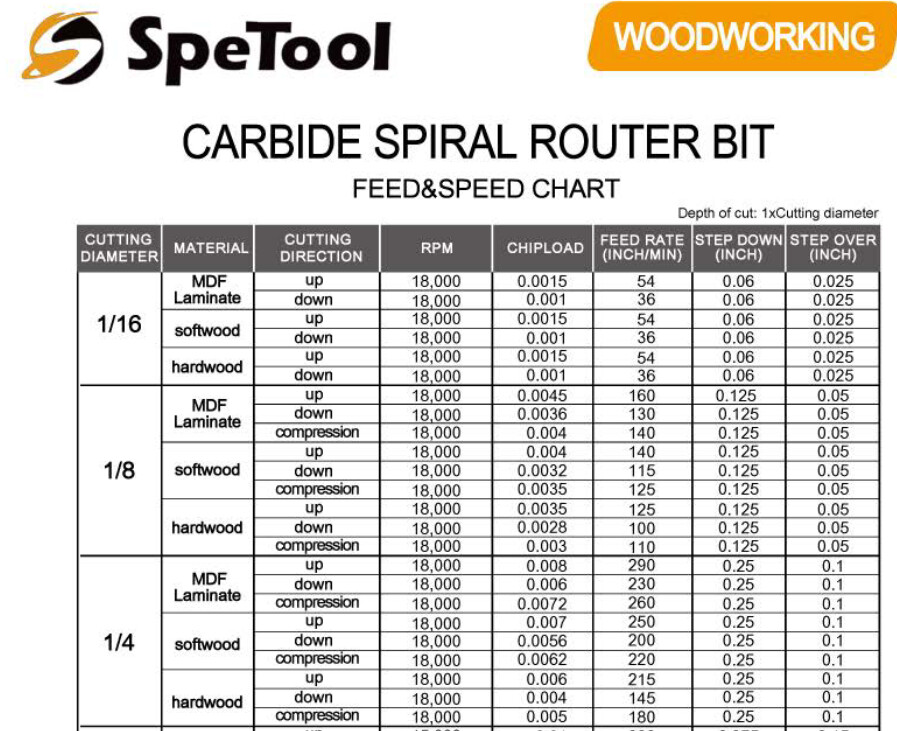

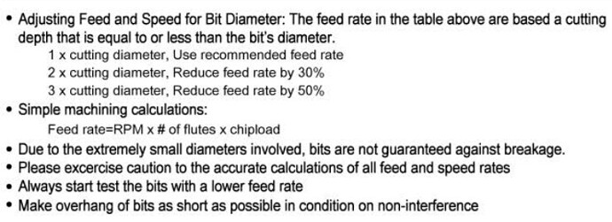

This is all I can find from the manufacturer regarding feeds and speeds:
If I calculate for 10k RPM based on their formula:
Feedrate = 10k * 2 flutes * 0.0072 chipload * 0.7 (to compensate for going deeper than 1x bit diameter) = 101 in/min (43mm/sec)
Does that seem reasonable at that RPM?
