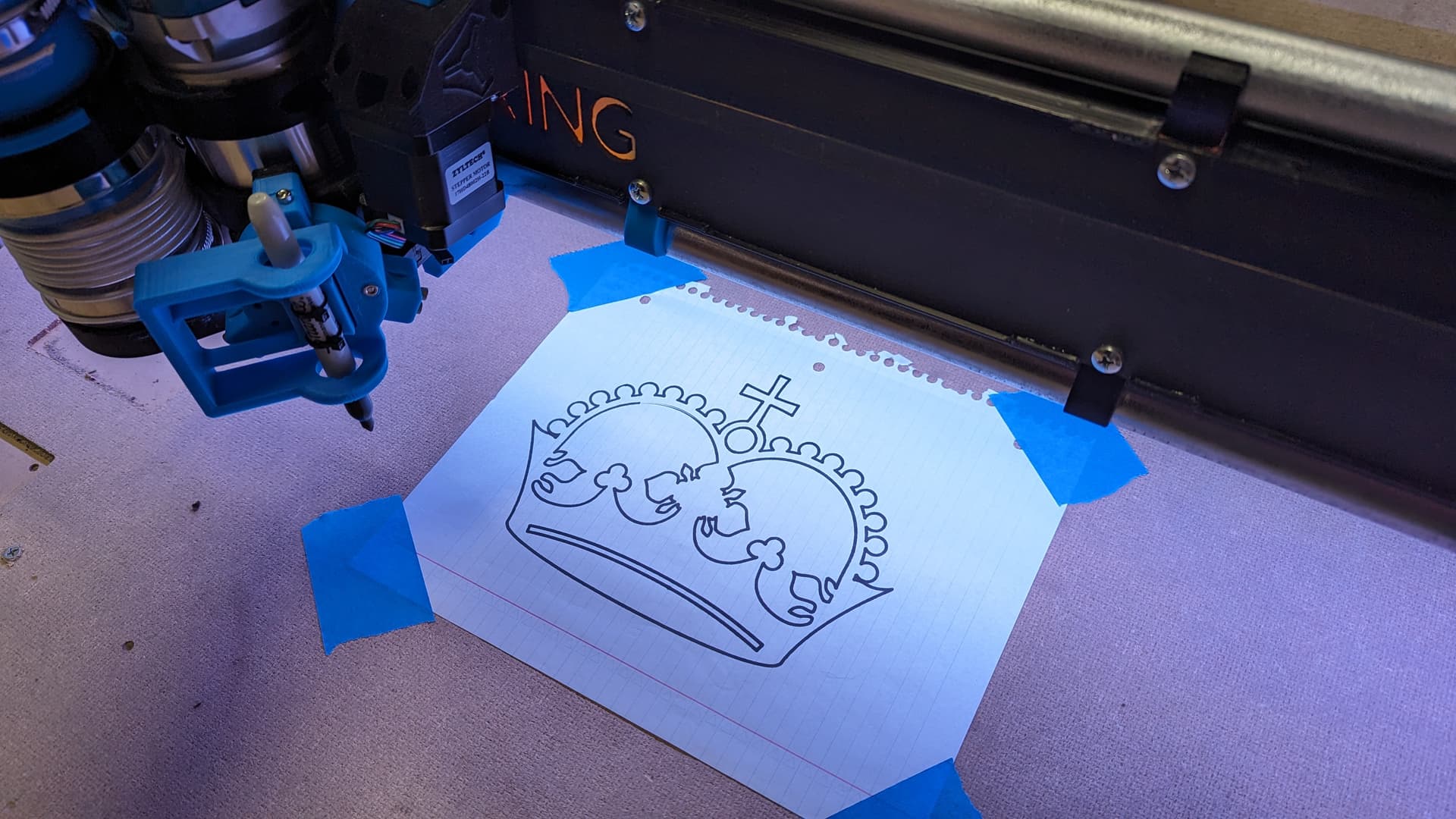

Aaaaand we’re back down on the ground! Once I’m sure about the code Estlcam is creating, I’ll make a new crown file and draw it tomorrow.

Jackpot crown test complete!
Tomorrow I will run a square test and try a foam cut or two to make sure things are working well while cutting. If that goes well, I will start preparing to cut the torsion box!

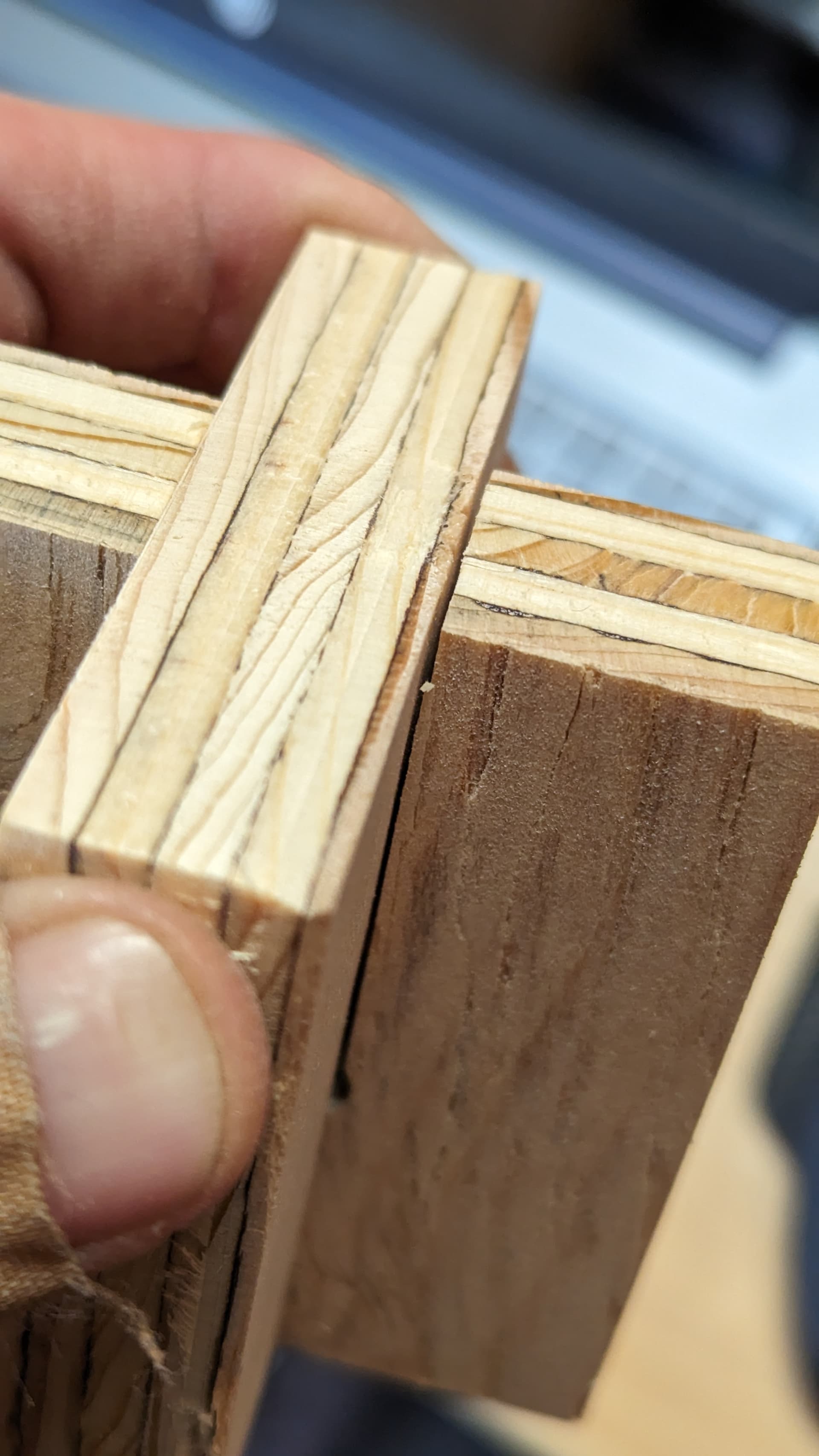

First cuts in plywood! Testing tolerances for the torsion box. Currently cutting with a 1/4" compression bit. I really like how the samples came out!
Query: should the joints be a pretty tight press fit? Or does it not matter once the top and bottom skins are glued and screwed? There is just a little bit of wiggle room in my cuts at the moment.
I tried for a tight press fit. But they ended up with a little wiggle room. I only have a couple of clamps, so when I glued them I put a screw in the middle of the X in a predrilled hole. The screw was long enough to pull the two pieces together and the predrilled hole was sized to wedge out the plywood just a little so the surfaces made good contact.
Full disclosure: I know nothing about woodworking.

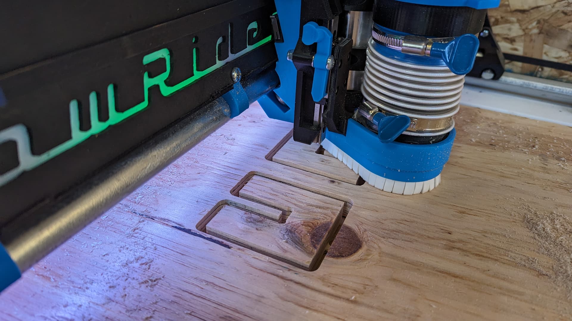

I managed to cut two parametric table spars. There were some missed steps on the other two, including the ever-fun wandering bit. I ended up taking the core off to double-check the X motor grub screws. They were fine and Loctited, so I put the core back on and made sure the bearings were appropriately snug - I think the core might have been a little loose on the gantry. I also ended up boosting the endmill RPMs by a couple thousand, which I suspect might have been what actually resolved my problems.

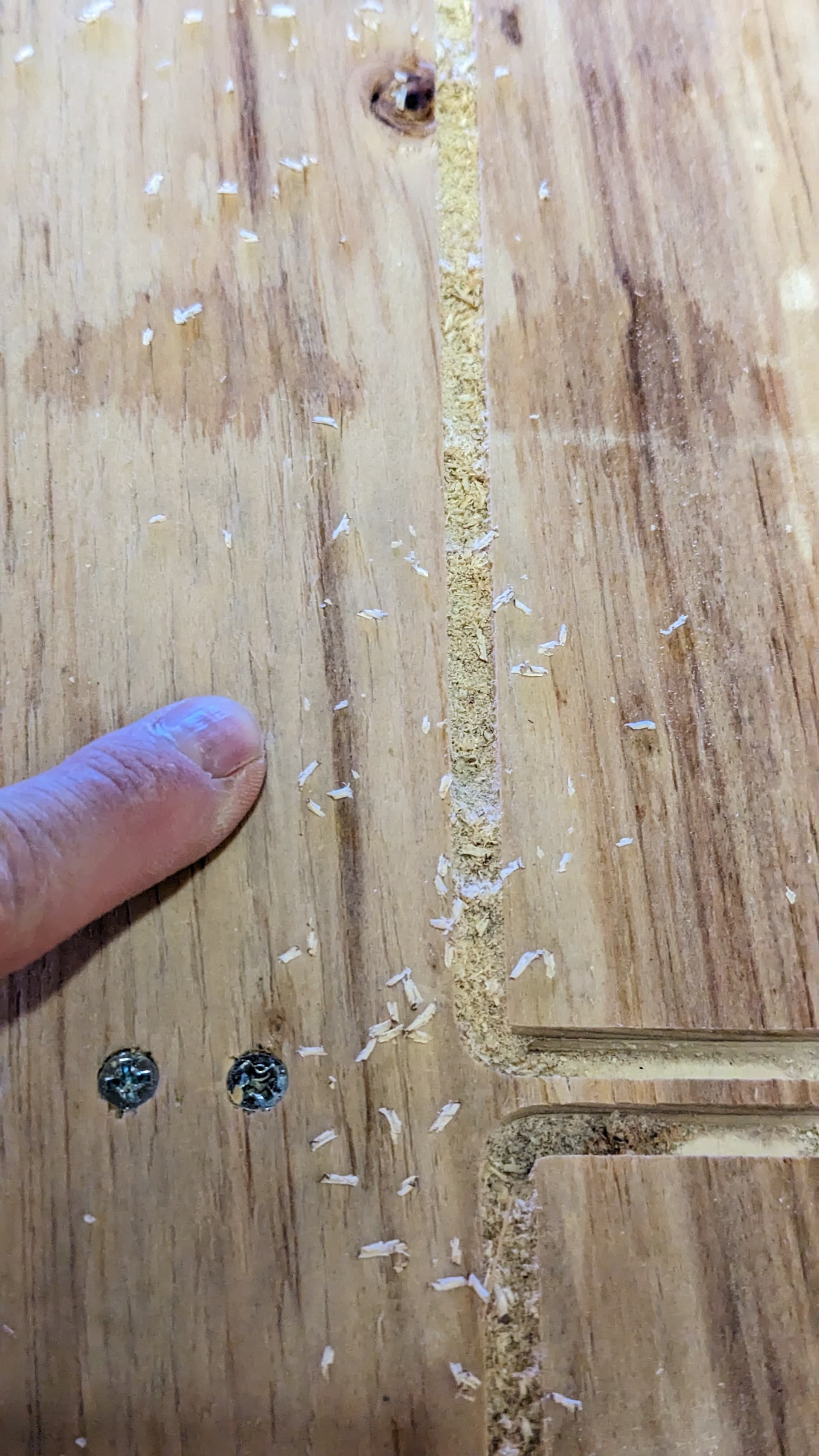

Out of curiosity, this is a photo of the kind of chips the router is producing. Based on calculations (assuming I’m interpreting how chipload is supposed to work), I think I had close to the right combo of DOC, feedrate, and RPMs… but from reading other threads, it seems that a visual verification helps with making adjustments. So, if anyone wants to chime in and tell me how poor my setting choices are, I’m all ears for learning! :rofl:
Currently using a 1/4" 2-flute compression bit with a pretty sizeable upcut section, so:
Depth per pass: 8mm - I know, pretty aggressive;
Feedrate: 35mm/s
RPM: ~20000
This did give me two very nice spars, though, so these settings can’t be TOO far off…
What is the recommended first pass DOC and chipload from the endmill manufacturer?
The manufacturer says 260 inch/min, .25" (6.35mm) stepdown, .1" (2.54mm) stepover for the 1/4" (6.35mm) compression bit, and to reduce feedrate for a depth of cut greater than the bit diameter - 3x bit diameter = 50% feedrate. Unless I am mistaken, 260 in/min is something like 90mm/sec.
Good enough for mental math. All mighty calculator says 110.067 mm/sec.
I need to check my drivers. I’m not exceeding 20mm/sec on deep cuts, yet alone 8mm.
This is what I have seen and somewhat of produced. I have seen bigger. But only on YouTube.
I think you’re moving too fast, if I look online, it recommends about 21mm/s at that rpm for ply, assuming 6.35mm DOC. That lands you around .013 for your chipload.
Entirely possible. I will try some slower cuts this evening to see what happens.
