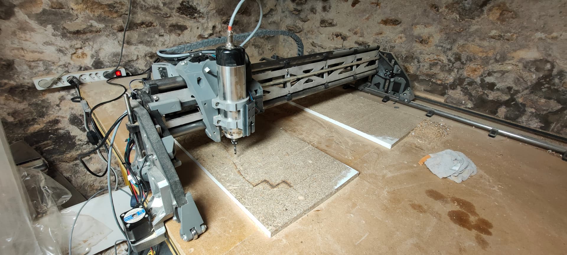

I wasn’t quite convinced by the 1.5kw until just a few days ago
So far, I’ve had pretty similar resuklts with the makita clone I previously had: no major improvement in cut speed or quality, the only real benefit was that the spindle is a lot quieter
Then I switched from my usual “1$ a piece” 1/16" bits to a “not so cheap” 20$ a piece 6mm roughing mill
With this bit, the spindle really started to shine, no bogging down even when removing a lot of material
I’m just starting pushing it right now, but 2mm DOC at 1500mm/min in hardwood (Oak) is fine
3mm DOC at 2000mm/min in hdf went perfectly well too

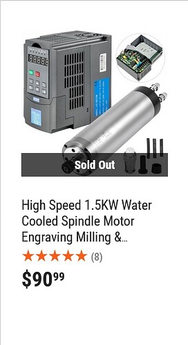

That is the one I was looking at.
I started my build as a compact LR3. It looks like I increase dimensions and power at every step. :smile:
That’s seems like a great deal but sadly, for the time being at least, it’s unavailable.

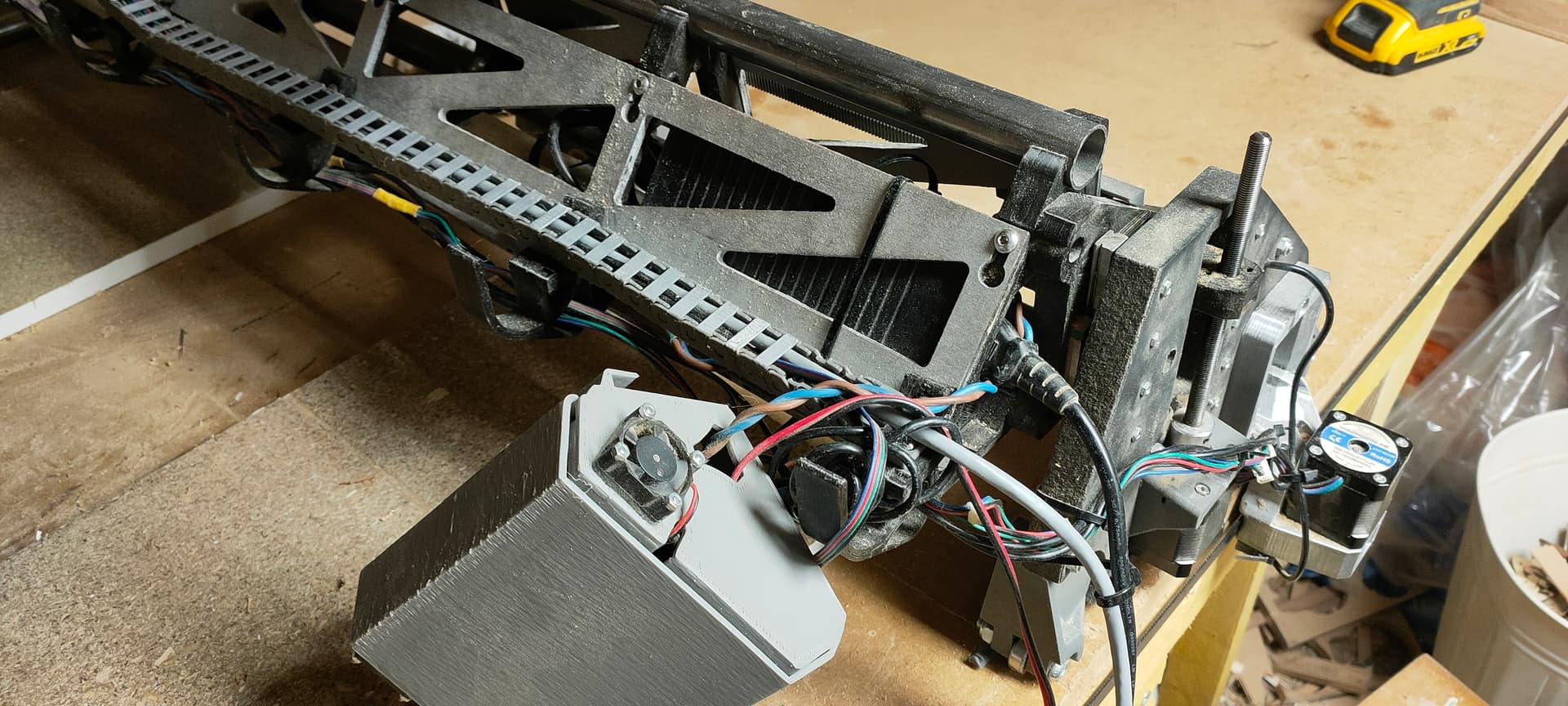

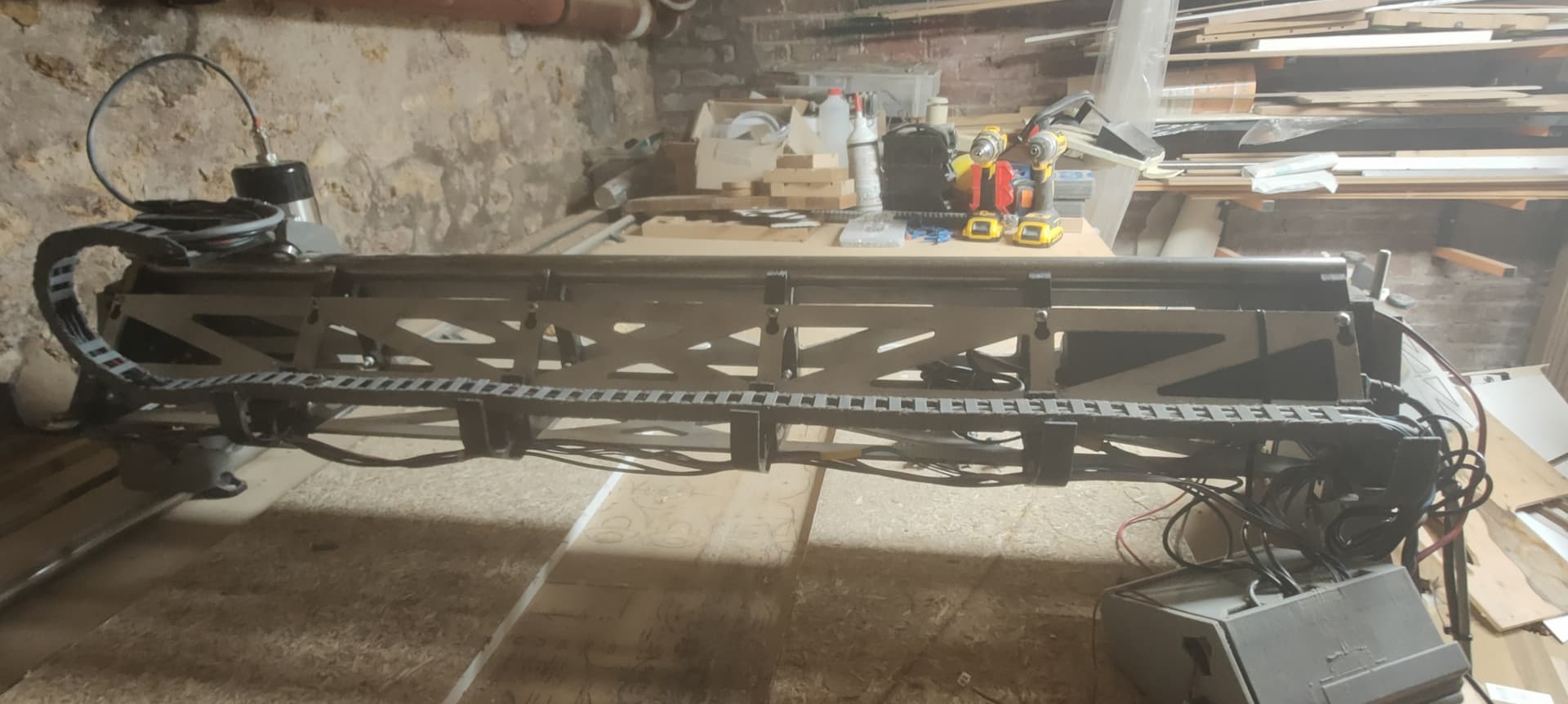

A quick tidy up tonight: I printed and installed Doug’s drag chain mount
Also mounted the PSU inside the struts
I still have a couple lose ends to finish but I’m pleased with the look of it…

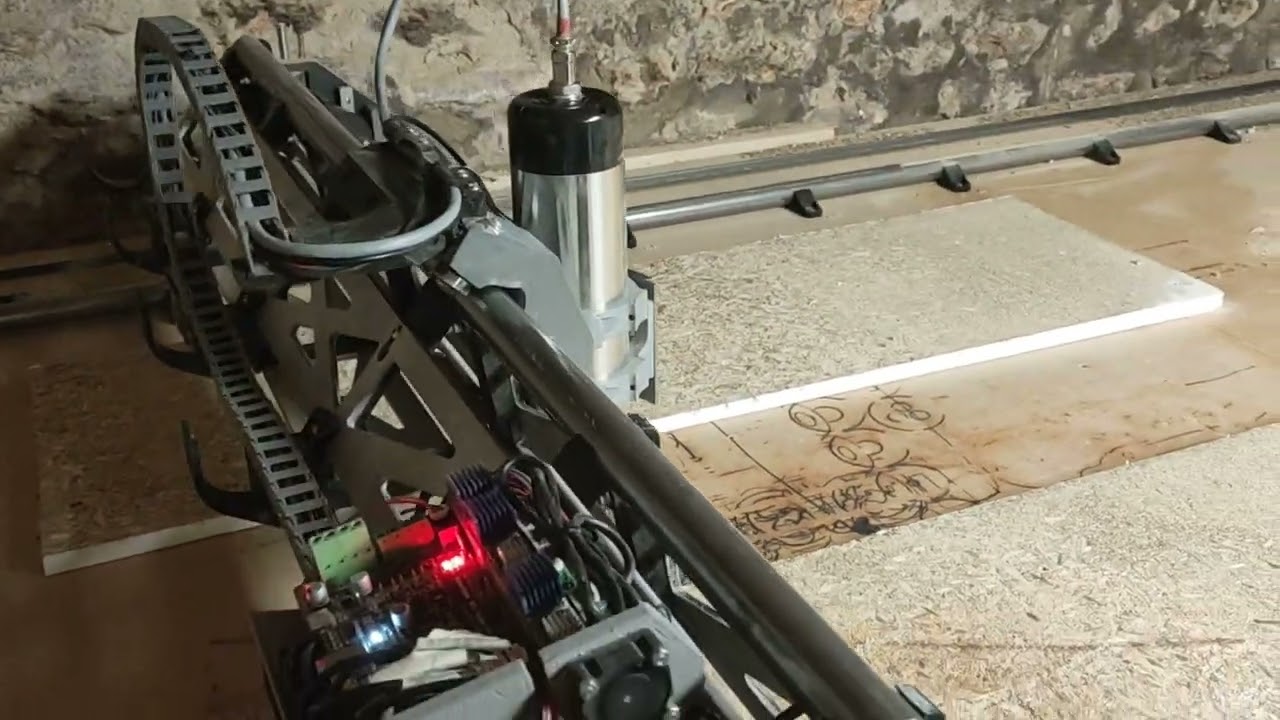

Doesn’t the chain hit the wall if you go too far to the back? I think it can be shortened by quite a bit. :slight_smile:
It doesn’t hit but the rails tends to fall off the base
I guess shortening it can help :slight_smile:

With regard to the chain length, The way I determined my length was to move the X (Core) to the max then add links as needed to make the curve to the core. That lets you get to the far end without having the chain hang over the side.
Another technique is to move the X to home and then the curve should be a little beyond the mid-point of the gantry.
Mike
In the current state, and in order to avoid re-routing all cables, I think I’ll just pull the tail end of the chain until I’m satisfied with the curve at max X as you said, and then remove links as needed :slight_smile:
I may have to re-route a wire for the probe though :confused:
EDIT: actually, I don’t think I can remove any… This is X max

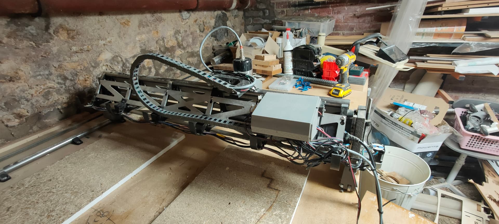

I just gave credit to my fellow forum users, and removed 6 links from the chain :stuck_out_tongue:
Also gave the control box a much needed and thorough clean…
While I was at it I tidied up the wiring both in control box, struts back, and table side…
I’m not completely happy with the drag chain I printed… it’s loosing its covers,doesn’t stay in place, and is not very smooth
I stumbled upon a drag chain I printed 2 years ago that is much smoother and a bit wider, I may design the missing end pieces and switch to this one at some point…

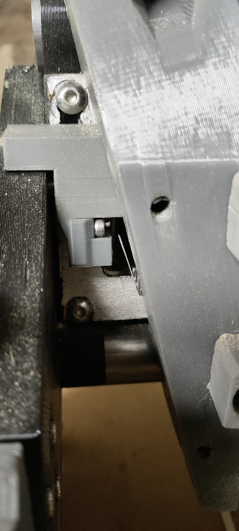

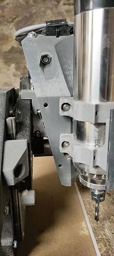

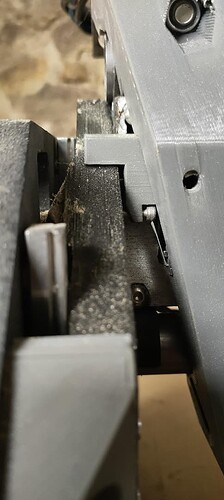

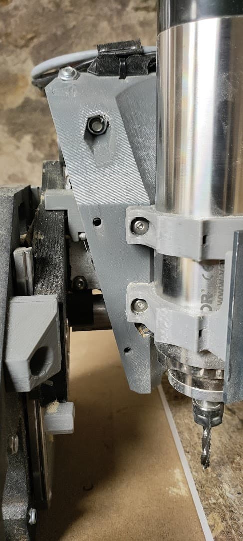

Another much needed “upgrade” or “fix” should I say…

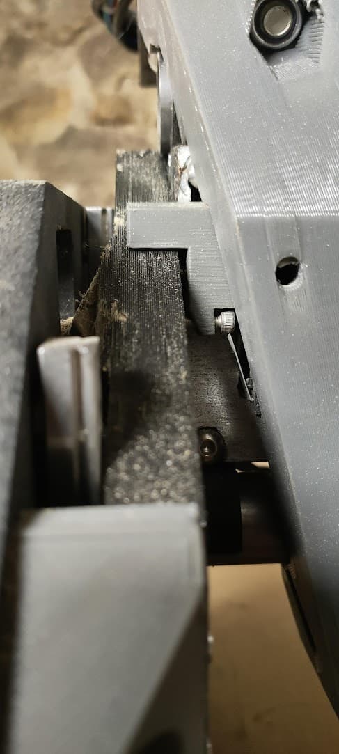

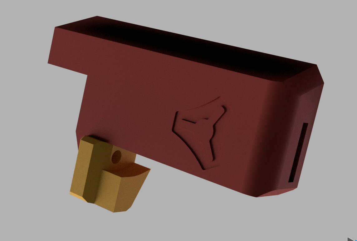

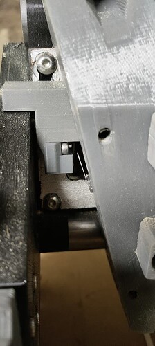

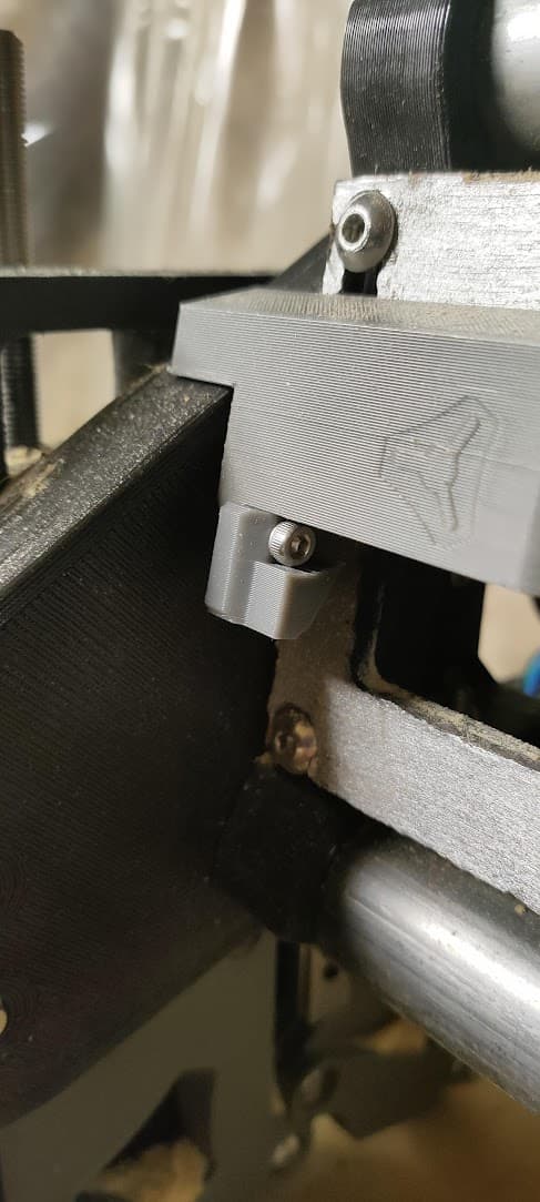

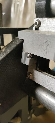

My X limit switch has a shorter arm than the ones sold by Ryan… just a tad… it barely misses the x tensionner adjustment screw by a hair… >_<
Quick 10 minutes design in F360, 5 minutes print… and voilà…
I’ve been using the LR3 without an X limit switch for 6 months straight, although it was just a matter of 15 minutes to fix >_<
