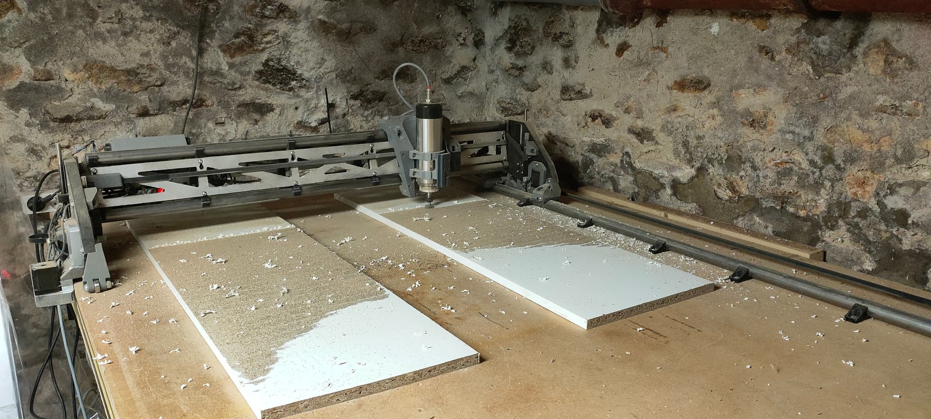

LR3 - France - MKS TinyBee / FluidNC - Side-mounted Y belt
Cool!
Color me impressed…

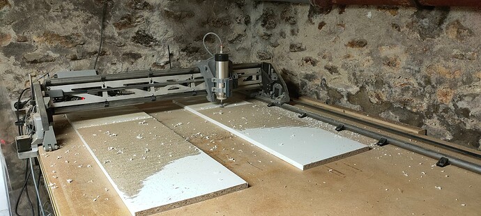

Same part, but this time it’s Oak :flushed:
500-750mm/min at 1.5mm DOC
Wouldn’t even have attemped this on the LR2 :slight_smile:

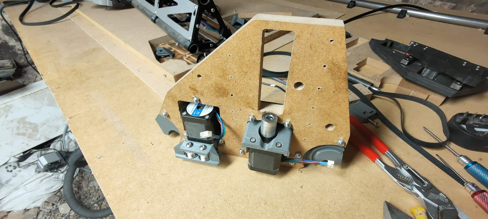

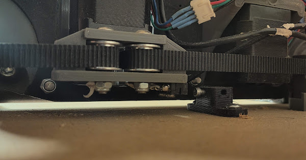

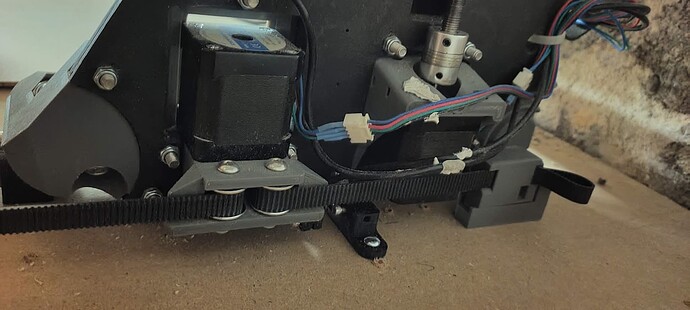

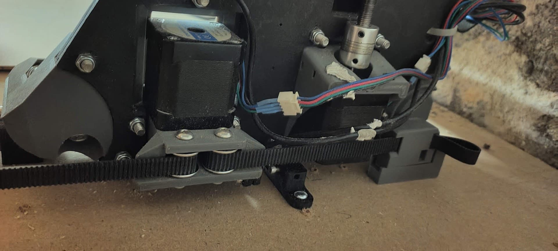

Very small mod today, but it makes a big difference for me
My LR3 now homes in the Y+ direction (that is at Y max rather than at Y=0)
This let’s me home it next to the parking position rather than traversing the whole table each time
Google Photos
Had to make a small block holding an adjustment screw for the rail side
The blocks just clears the bottom of the Z motor but still hits the endstop on the Y drive
On the “rollers” side, this has been a bit easier, because my belt hodler is on the side of the table, so it already clears the Z motor

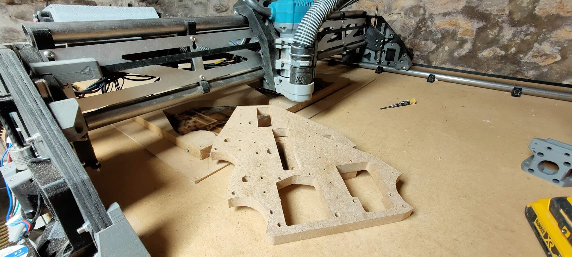

I’m getting the all too common issue where the front rail rollers lift up and disengages from the rail >_<
I think this may be the cause of this problem, the rollers have been a bit hard to install and I needed to force them into place, maybe they’re installed at a bit of an angle or something…

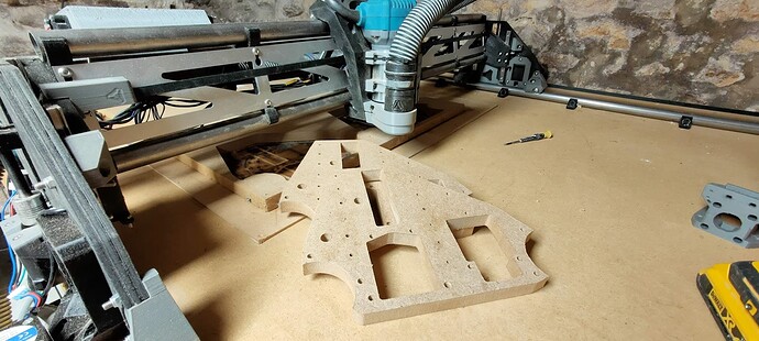

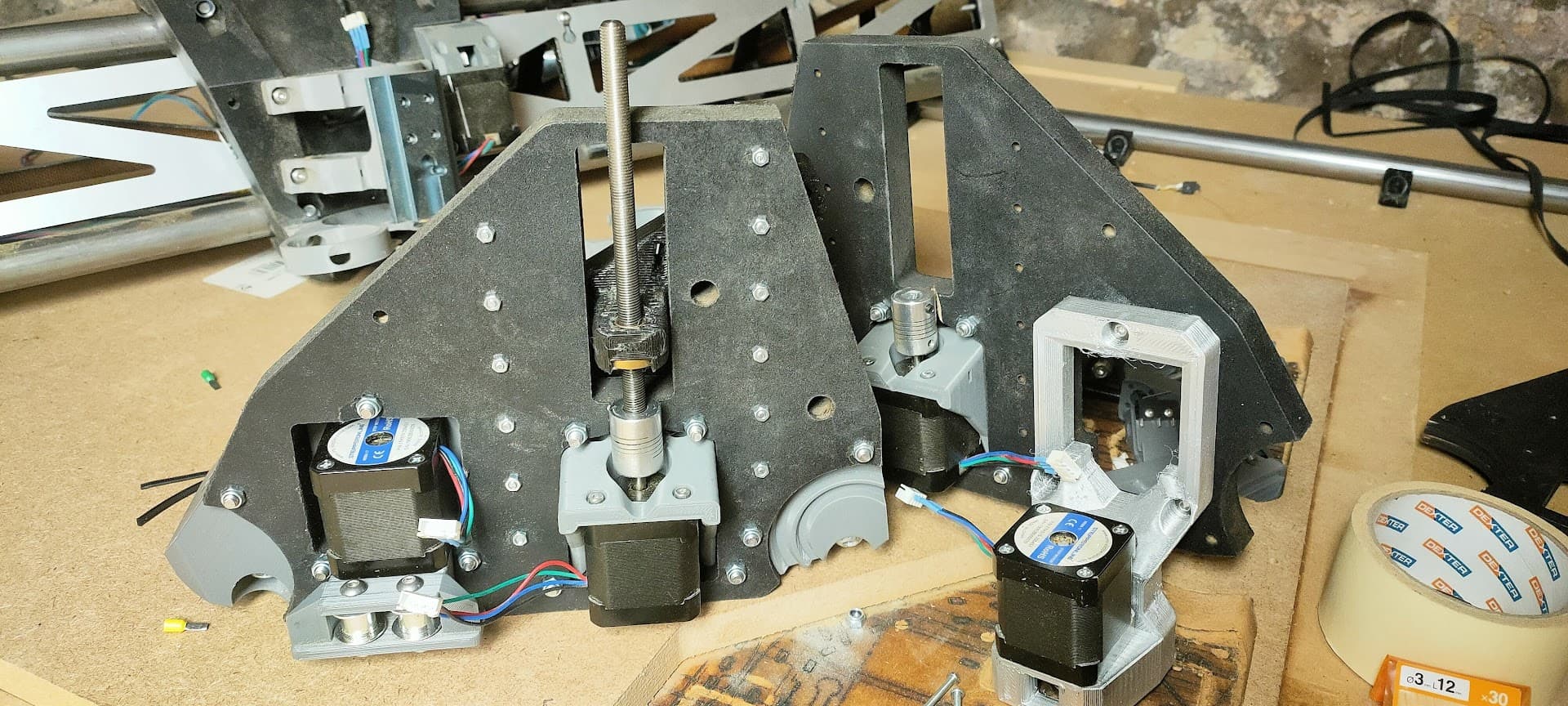

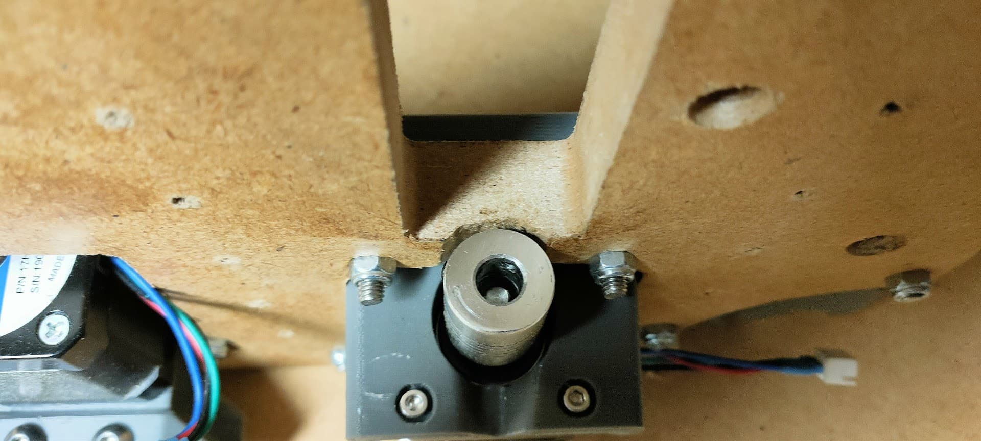

I cut some new plates out of 18mm MDF this time rather than the 3 stacked 5mm plywoods
And began assembling it… so the LR3 is already down after a week of service :stuck_out_tongue:
By the way, when the doc states “Don’t make the plate’s thickness any larger than 15-16mm”, now, I know why :stuck_out_tongue:
Nothing a small cutout couldn’t fix though ^^
I hope rebuilding the side plates will fix the alignment issue…
Anything else I should keep an eye on while rebuilding?

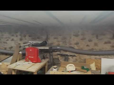

Behold my new and almighty LR3 “enclosure” :smiley:
Now I need to add some 100mm conduits to connect the air extraction inside
All kidding aside, not a bad idea… lol
Not pretty, and really messy at the moment, but it definitely works pretty well…
This could be even more efficient with a better/stronger air extractor (thinking about recycling an old cooker hood…) but it’s definitely better than nothing

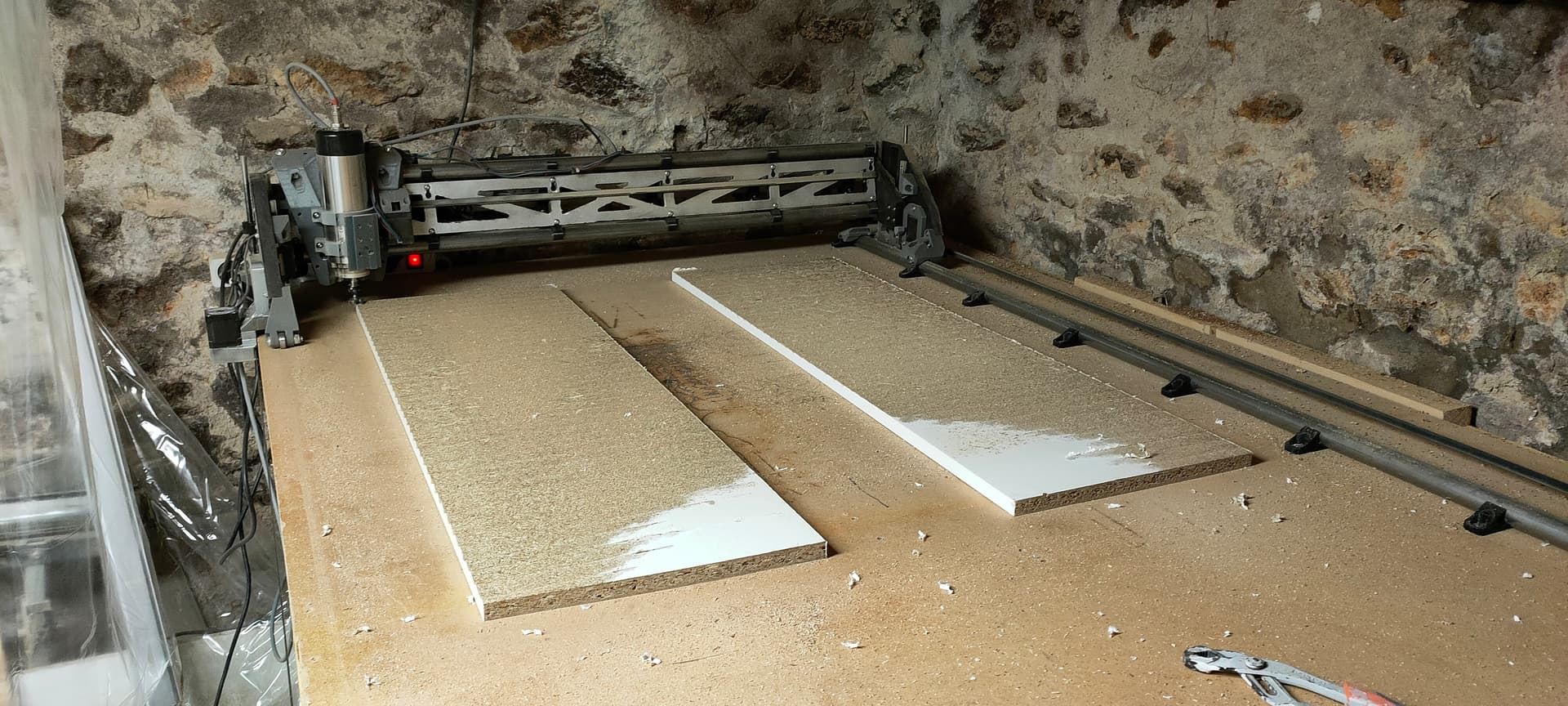

Long overdue task, but I just started surfacing the board…
I have a pretty deep bowl in the center -_-
4 passes and 3mm down already but it’s still there…

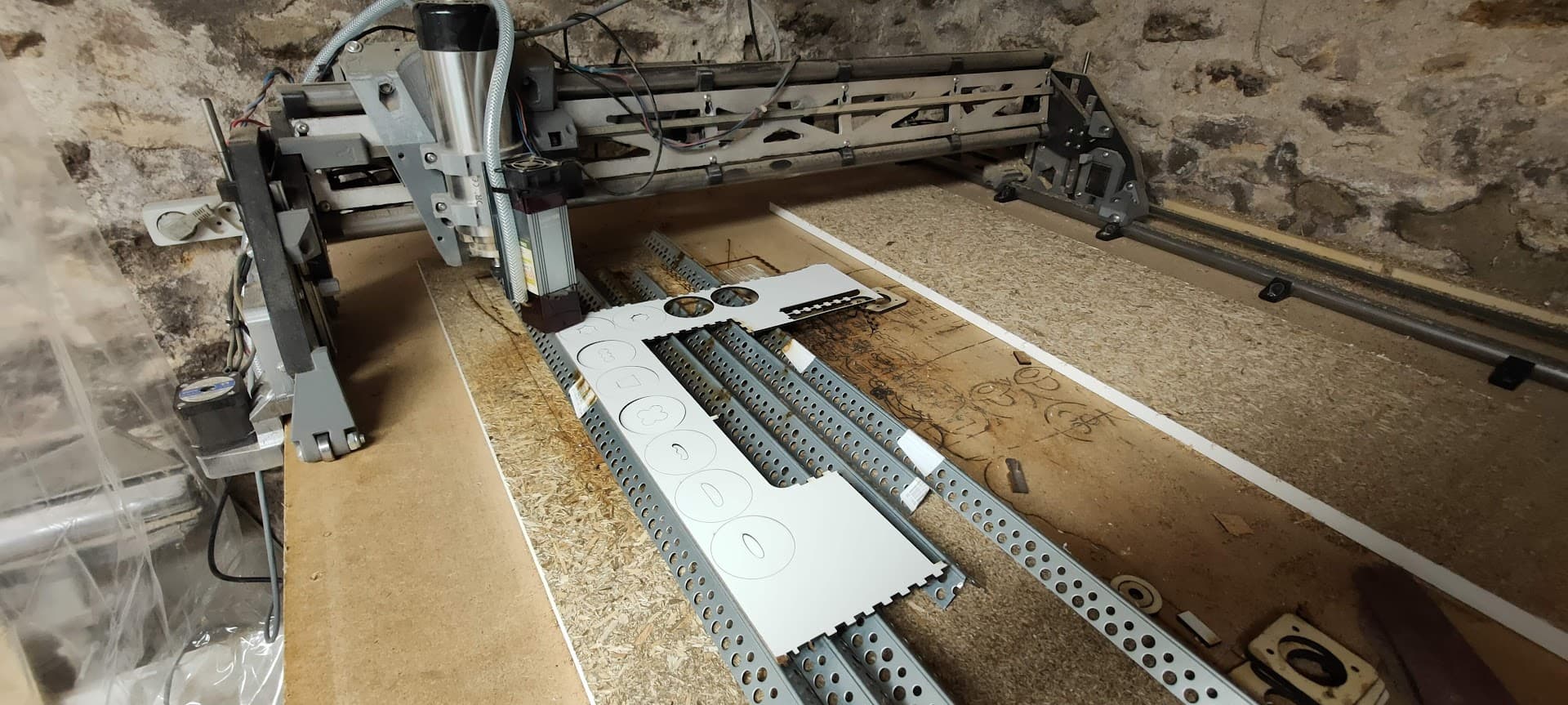

Small improvement, following an idea by @bitingmidge
I made a makeshift “knife laser bed” using drywall corner studs leftovers.
It works beautifully, and costs next to nothing, plus it’s easy to install/remove/adapt depending on the kind of work you’re doing
If you want to get a bit fancier, it should be pretty easy to mount these studs inside a frame and drop it on the LR3 bed as a whole assembly
