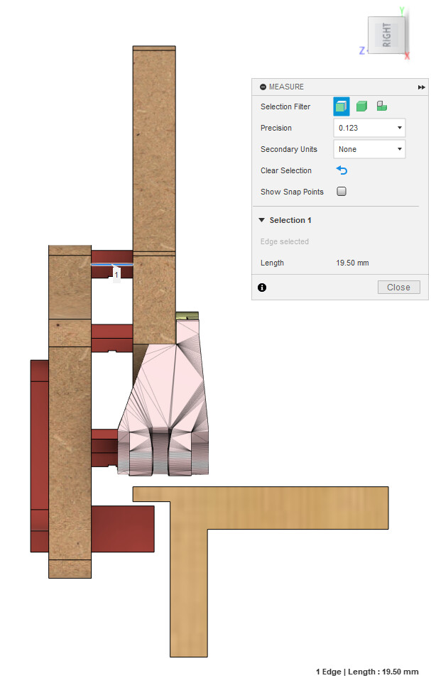

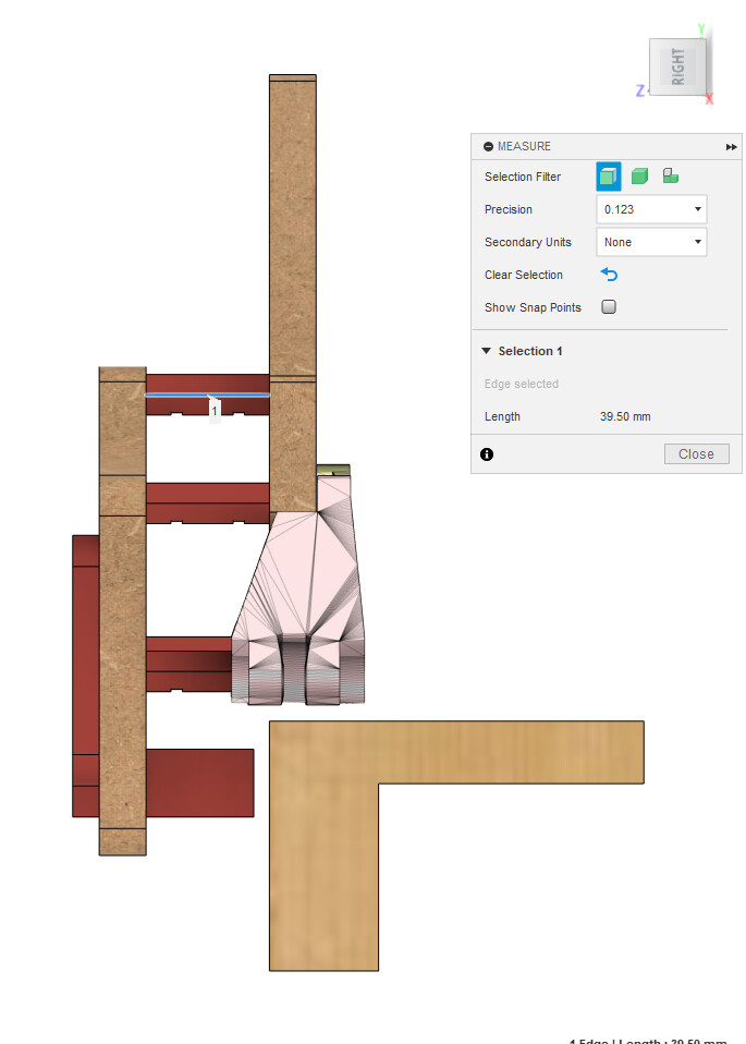

I think I have a solution that would content anyone :thinking:
With this configuration, thicker plates mean smaller spacers, so it should be a win-win situation for rigidity :slight_smile:
The screenshots hère are with 15mm YZ plate and 12mm Y extension plate
I’ll post some with 15/15 ans 20/20 when I get back for you to see :wink:
With 20/20mm plates, I get a 34.5mm spacer (5mm margin between the Y idlers and table)
And this is with 15/15mm plates => 39.5mm spacers
You can also specify a negative margin betwwen the table and idlers and get the belt just under the rollers
If you want this setup you’d need to add an unistrut or strip of wood on top of the table for the rollers to ride on
