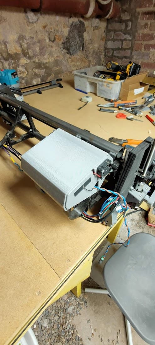

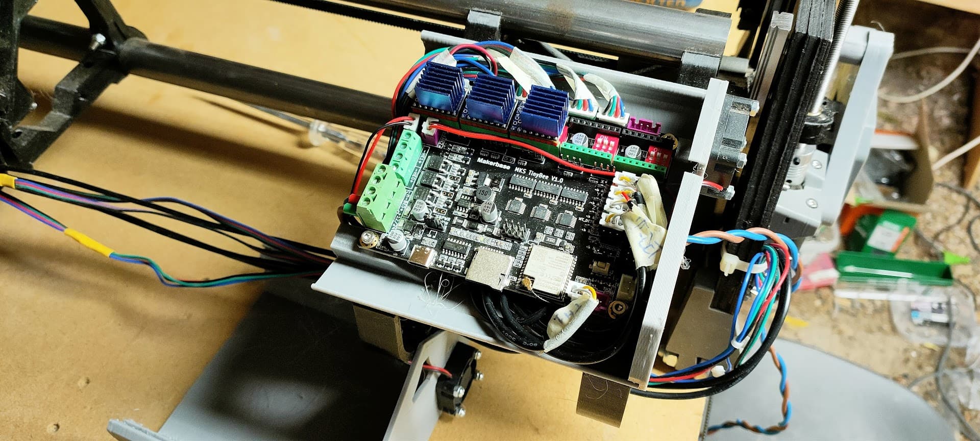

Finished the first assembly and wiring yesterday, still a lot of tweaking to do:
  • I’m getting weird values on the steps_per_mm, I need to investigate this
  • Replacing two burnt drivers
  • Installing the case for the MKS Tinybee and fans
  • Hiding the front belt on the side of the table as it’s getting in the way and it’s really not practical (I much prefered the LR2 designed for this)
  • Cleanup of wiring
For anyone interested, here’s the link to the case for the MKS TinyBee
https://www.printables.com/fr/model/520311-lowrider-3-cnc-control-box-case-for-mks-tinybee
And here’s the LR3 / MKS TinyBee configuration for FluidNC
board: MKS TinyBee V1.0 XYYZZ

Making some progress on the assembly…

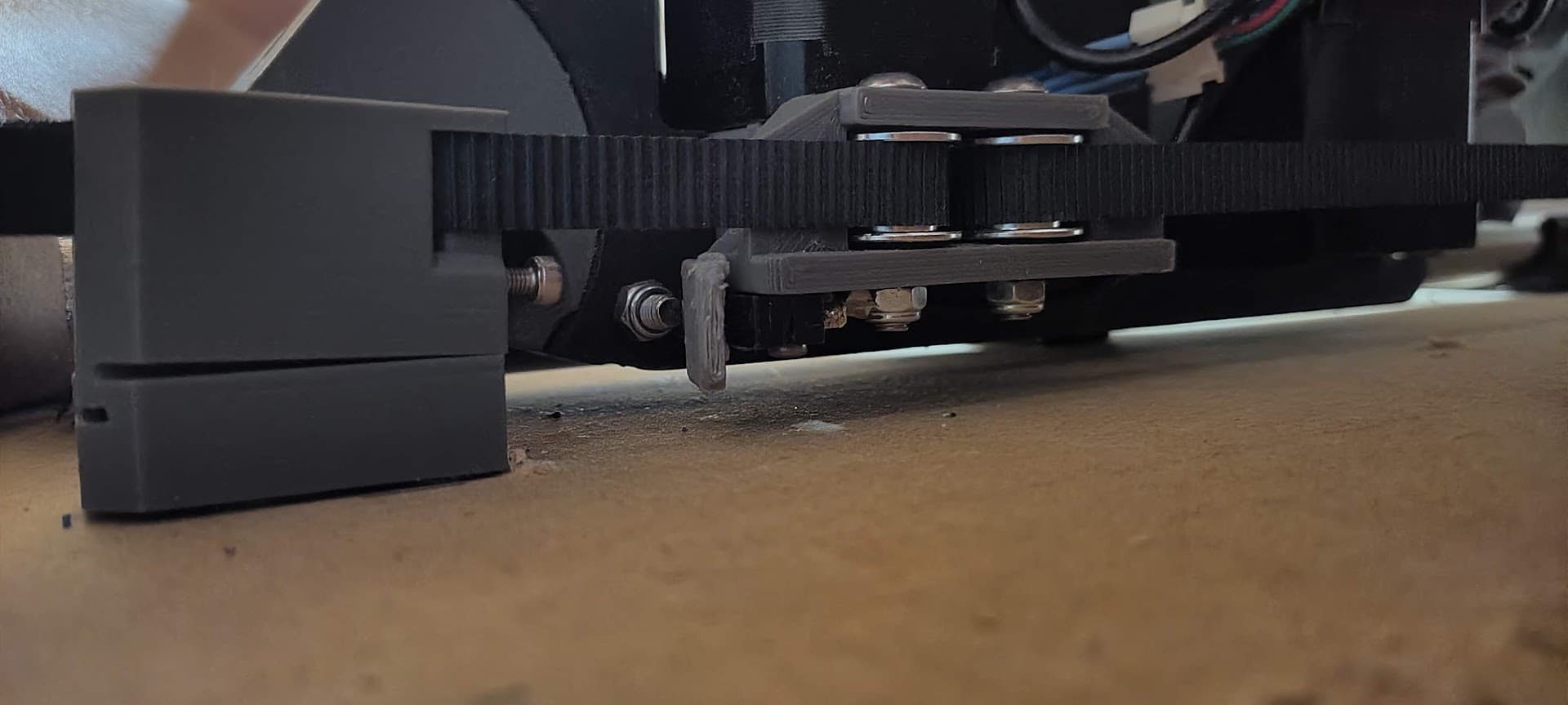

I was really annoyed by the front belt getting in the way, so I tried Doug’s mod
https://www.printables.com/fr/model/422468-lowrider-3-cnc-mod-hide-protect-one-of-the-y-axis-/files
Wasn’t quite convinced by this one, didn’t have the right size unistruts here in France, plus I found it a bit cumbersome to install and easy to bend, cut myself two times in an hour…
So I kept the new side plate, switched back to the original motor mount (didn’t want to relocate the limit switches, and the re-designed one was harder to install…)and designed a simpler mod where I can re-use the belt’s blocks and attach them directly to the side of the table
Currently finishing printing a few parts, and I’m quite happy with it, it seems ok, will see if it works…
Short test track…
The belt runs right against the table’s side, it’s not hidden but still hard to get caught into…
Had to slightly redesign the tensioner block so that the belt’s output is at the rear
(Also added a small hole on the front so that I can home on the negative side if I want to… another project for another day…)

I kept the idea Doug had, you can adjust the distance by printing different size spacers
The spacing is not “adjustable” strictly speaking, to keep some rigidity in the setup
In my case, I needed to print wider spacers so that the Y idlers align just shy of the side plate (in Doug’s version, they are aligned with the side plate)
The current design depends heavily on the thickness of your side plates, so it’s a bit of trial and error, don’t know if I can make this thickness-independent…
Anyway, for my build, I didn’t adjust using the spacer, I just took the problem the other way around.
I began with attaching the belt to the side and aligning the rollers, and then I attached the rear Y tube to the table according to that
Note: If you wanted to do both side, this could get a lot more complicated though (kinda like the LR2)
Guess we’ll see… the motor is a bit further away from the side plate, so I expect there will be a bit more flex…

I designed a daughter board mount for the adapter board to fit inside the case - under the MKS TinyBee, I can share this if anyone is interested
Same for the laser mount I designed…
