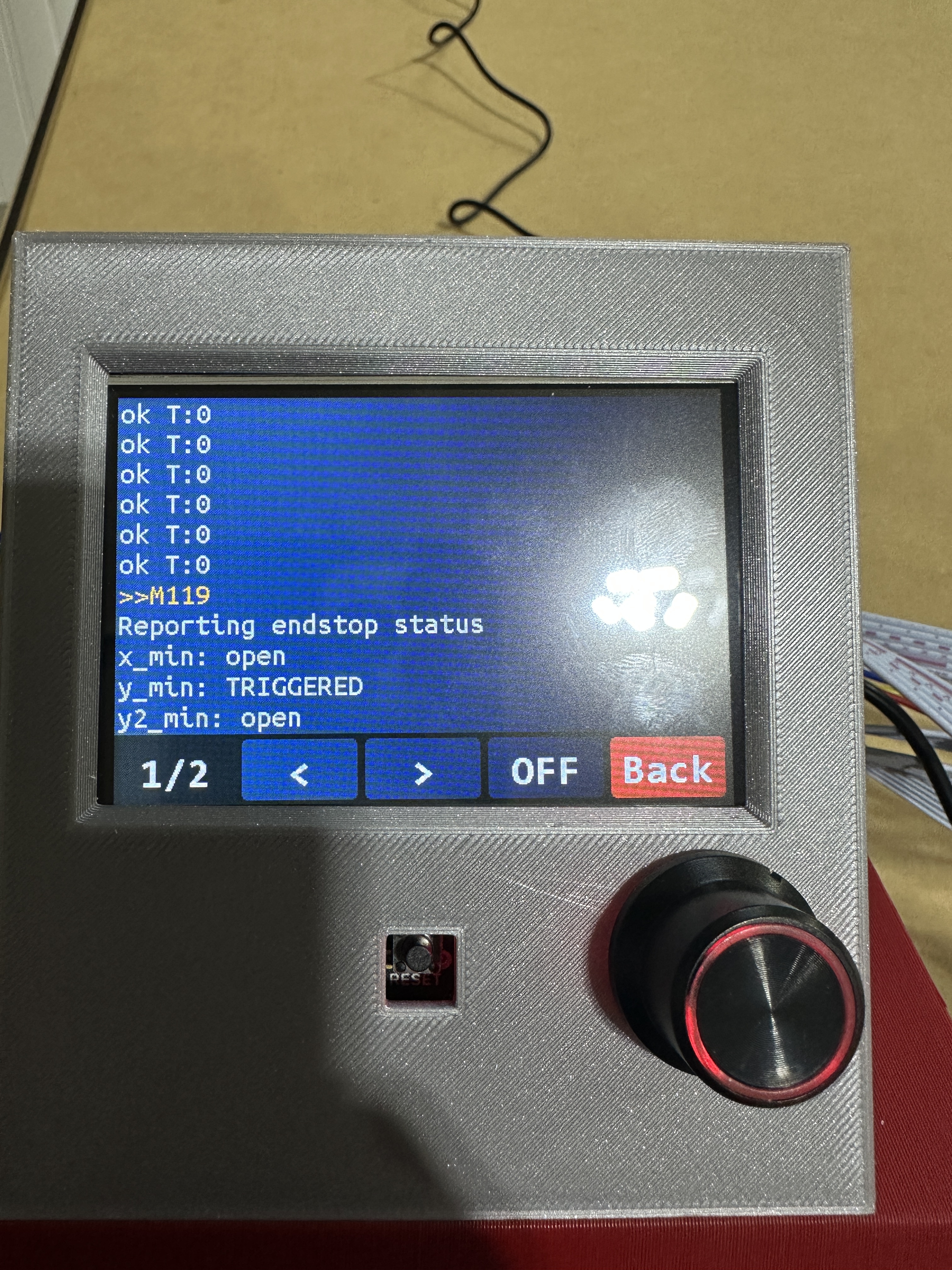

I will try that and update you with the results. I am pretty sure it is the butt solder joint I did.
This is my right side end stop. So definitely a short
That is the wrong firmware.
You should have X Y Y2 Z Z2 Probe
Or go to page two and make sure the rest are there. Never seen them split screens like that.
New solder and everything is good!
Seems that it just split it. Here is how it looks after I fixed the soldering.
Congrats! Looking awesome!
