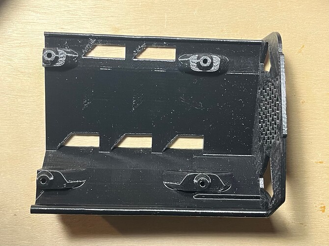

Did some work on a case for the Jackpot the last couple of days.
Printed @DougJoseph 's case from printables:
https://www.printables.com/model/643082-lowrider-v3-mpcnc-jackpot-cnc-controller-board-cas
(The sharpie-ified lettering didn’t turn out as well as it should because I have old hands :smile: )
(Hey, @DougJoseph … Do you know what would be really cool? A version of this case with an option for a keystone jack mount right where the keystone jack is emerging from the case… :smile: )
And here it is, with the V1 power supply temporarily wired with PowerPoles so it fits my standard that I’ve used on the JL1 laser wiring and the SKR boards that I’ve bought or repaired.
Powered up and verified the jackpot runs and the FluidDial pendant still works. Forgot to take a picture of that last step. Old brain :slight_smile:
In the background is one of Doug’s strut braces with integrated nut traps… because I was curious about it. I have one of those and a bunch of the regular V1 variant.

Doable! LOL
This is much better than a banana for scale!
Sounds like it’s time for a v2.0 with some variations including this (hopefully doable without interfering with the cooling fan space).
