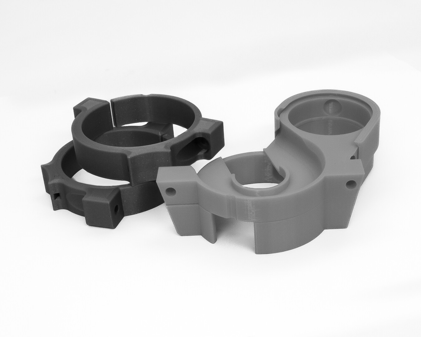

I think I might have accidentally made some progress. @Fodder1 Chris needed a couple of router mounts replaced and I figured that while I had the file sliced I might as well print a couple more, and that led to the other mount bits. Yes I know I’ll probably replace those with something custom but as with the LR2 I am really happy to build stock and nut out the rest when I know what I am doing.
As always, really lovely models @vicious1 - what a joy to print!

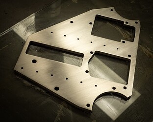

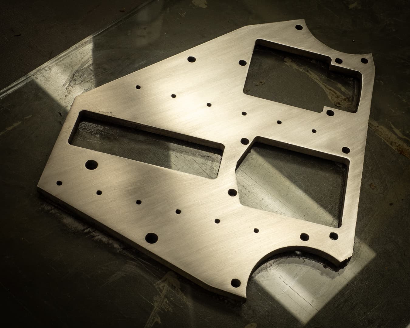

I noticed that the laser cutting had left slight “swelling” around the perimeters of the cuts, so I thought I’d lap the plates to make sure they were flat.
Which led to taking a sander to the thing to iron out the bumps, which led to giving a quick rub with 400 grit, and then 600, and then 800 and that’s where it will stay.
For now.
I figure if I do one side of each plate per day to “good enough” it will be finished well before the printing, but I am quite afraid I won’t be able to leave it at that!
As my descent into madness continues, I couldn’t leave it at that so took it to 1500 and even polished a test patch, just to show that 1500 grit isn’t good enough to polish.
This kind of metalwork is completely new to me, and I should have cleaned up the laser swarf and ugly cuts before I got this far. Nervously filing now lest I make some ugly mistake.
And if I haven’t said this a thousand times before, it’s worth saying again @vicious1 , those parts are a joy to print! I’m in no rush, but there’s a bit of momentum happening and it might turn out quite pretty in the end.

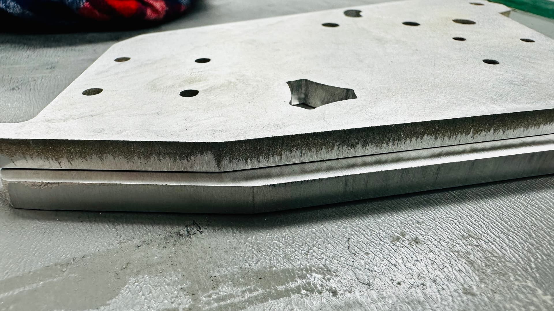

Just a note for those contemplating laser cutting of metal components.
This photo graphically illustrates the amount of cleanup necessary if you care about having the edges of your cut square.
The bottom part has been squared and when I can figure out how to do it and get a nice even edge I’ll soften the corners a bit.
The top part is about half way, maybe a little less towards being square. (The bit that’s been removed is shiny.) It’s not a huge amount, but there’s a noticeable (half a mm or so) difference in overall dimensions of the two.

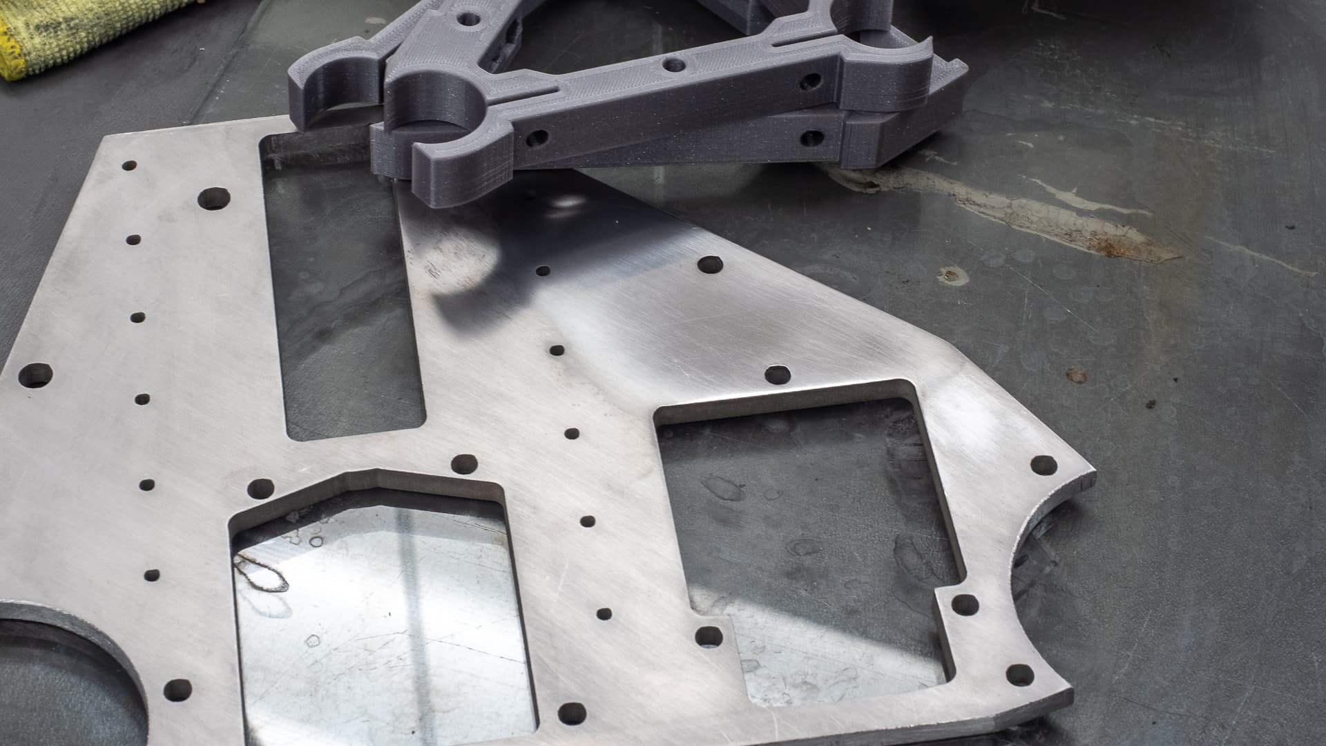

I’ve had a bit of a play with a needle file and cleaned up the logo and that other jellybean shaped hole a bit as well. There was very little filing needed to get them lookign tidy again.
I’ve probably got several more days (a few hours a day) worth of fettling, but it’s quite satisfying, almost like polishing a casting in places. I thought I’d get away without doing anything to the internal corners but that thought didn’t last long.
If any of the metal work guys reading this can give me a tip on the easiest/most efficient way of relieving those sharp corners I’d appreciate it. Presently I plan to just go through the grits of sandpaper using my thumb as a cove.
The braces will be finished printing today, and tomorrow as if to convince myself that I really am underway, I’ll start the core. I was going to wait until I had the Mk4 of course so I can show off a perfect print, but time and Lowriders wait for no man.
We’ve always just used a Noga deburring tool to break the sharp edges on parts. It can be tricky to get it looking good/consistent though, if you’re after more of a machine chamfered look. The rotary countersink for the Noga tool is awesome for relieving the edges on holes, though.
Alternatively, a light chamfer using a trim router and bearing-guided 45 degree cutter should work well for the majority of it. If the bearing is larger than the internal radii then a little bit of blending with a hand file might be needed to get it looking consistent.

That’s the set that I have at work and at home, as well as a couple of bigger countersinks etc. The bigger rubber handle is much more comfortable, though. The blades last near forever on aluminium It is possible to snap them but spares are cheap. They also work really well for removing the edges left by brims or the ‘elephant’s foot’ effect on 3D prints, too.
