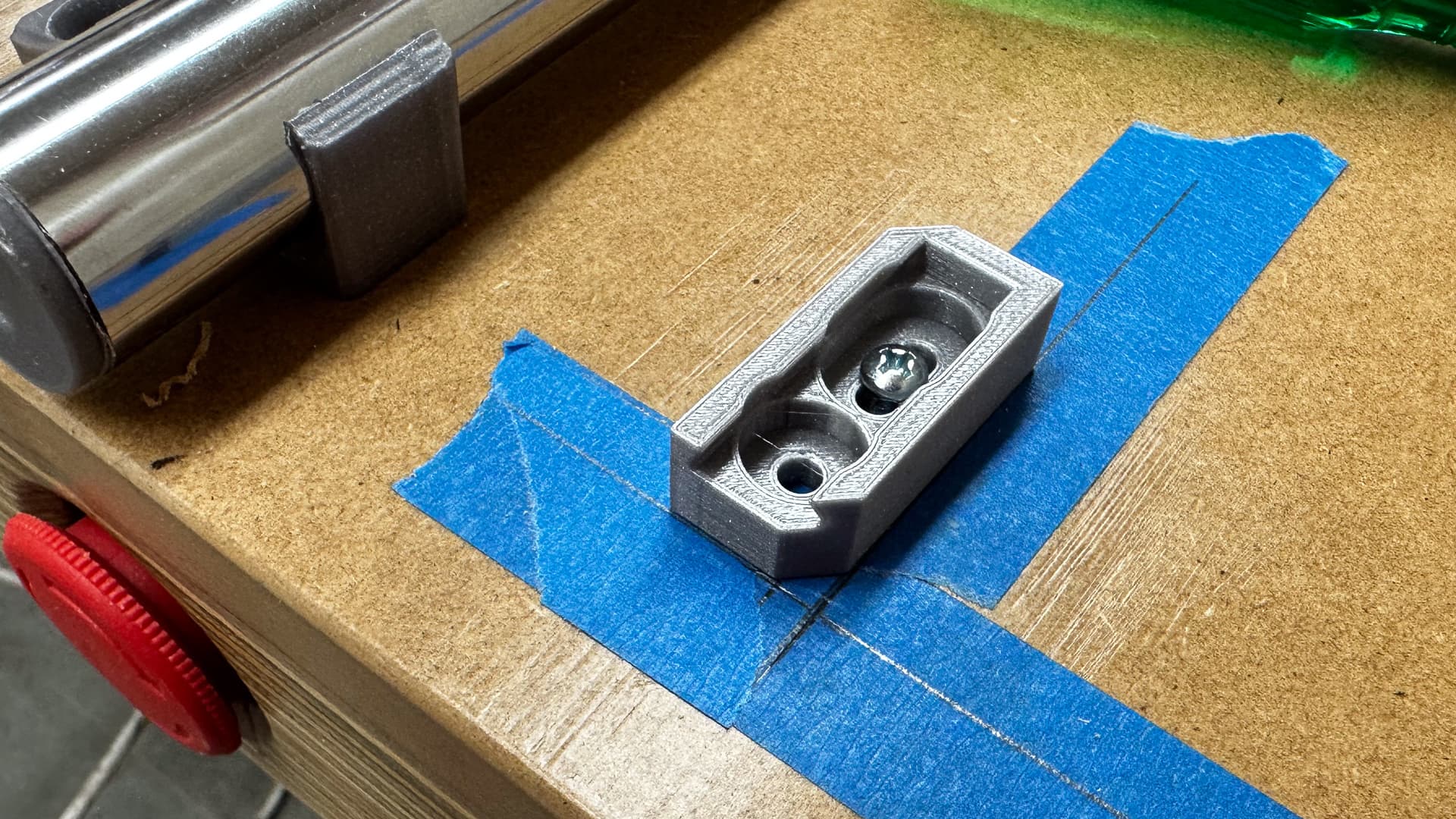

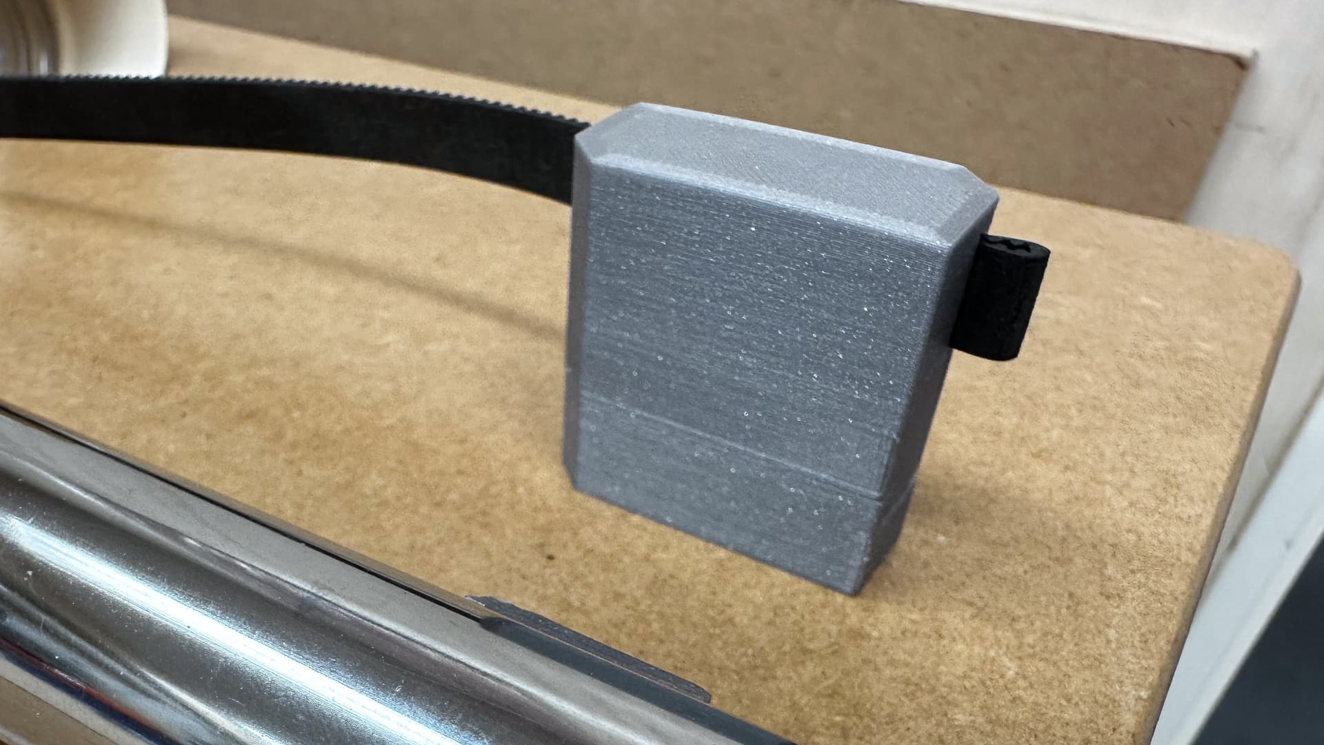

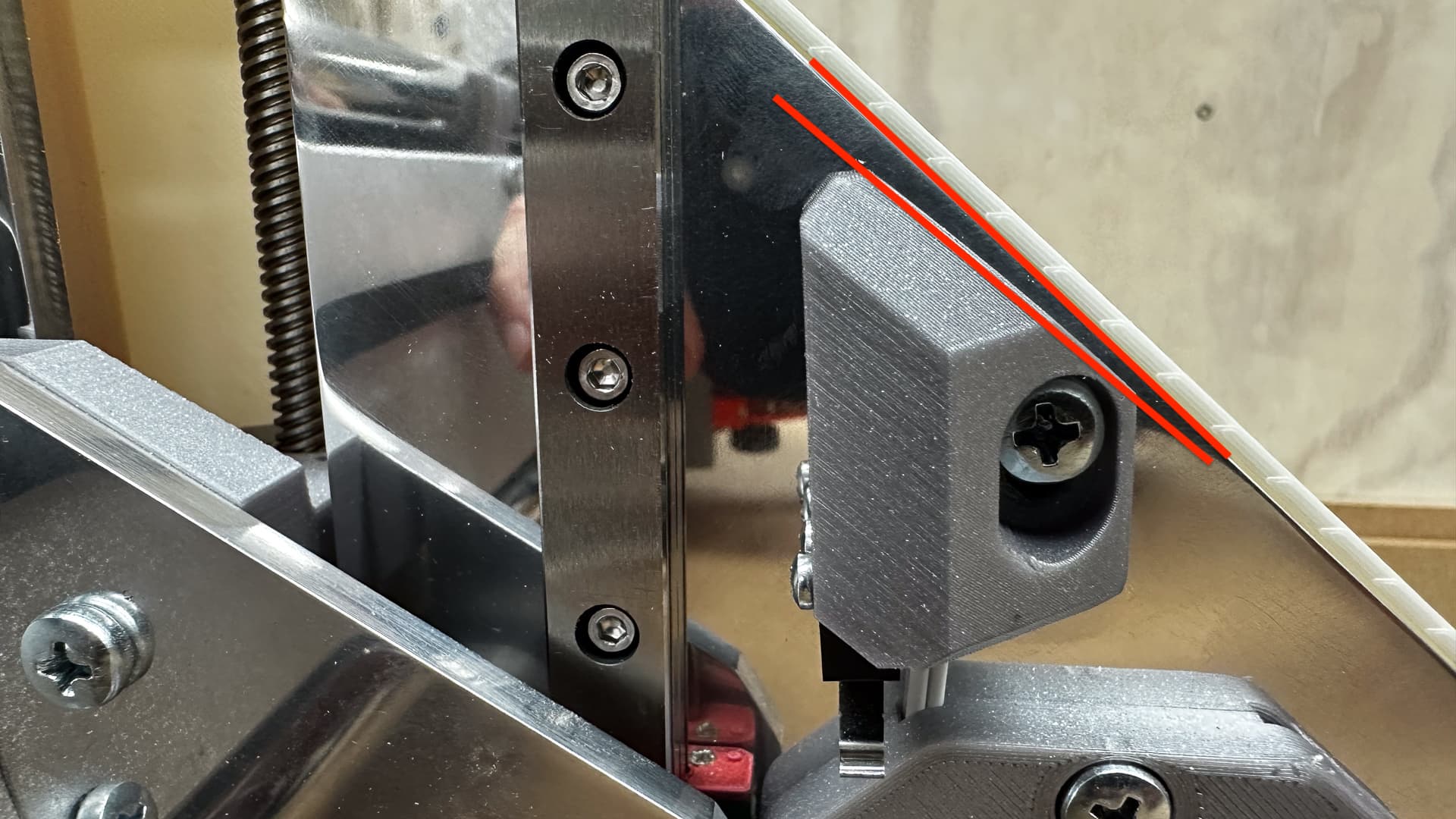

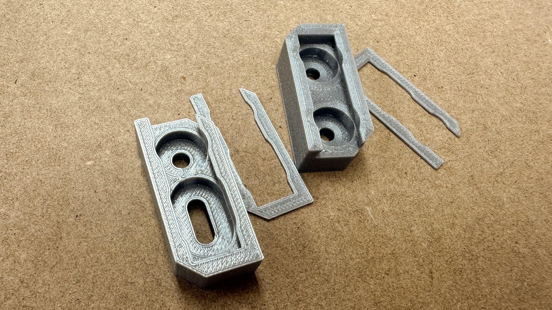

After one of those days when life has just got in the way at every turn, at 3:30 I finally got downstairs and installed the new front stops. They are super easy to adjust as one would expect with the slot.

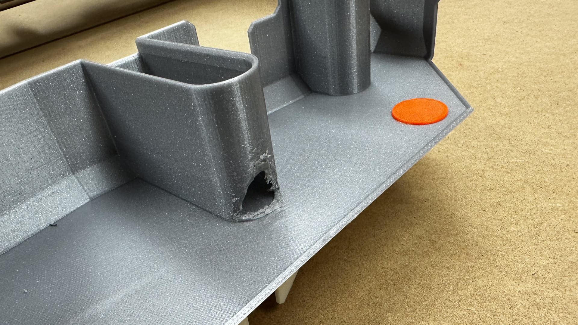

While I was at it I printed a couple of shims - 0.9mm high and less than 1c worth of material, but they take all of the slop out of the dovetail.
I was going to use the orange test pieces I printed earlier but I thought hang the expense, if I run out of money I’ll borrow some from my kids! :wink:
The silver ones are nigh on invisible and it still slides buttery smooth.

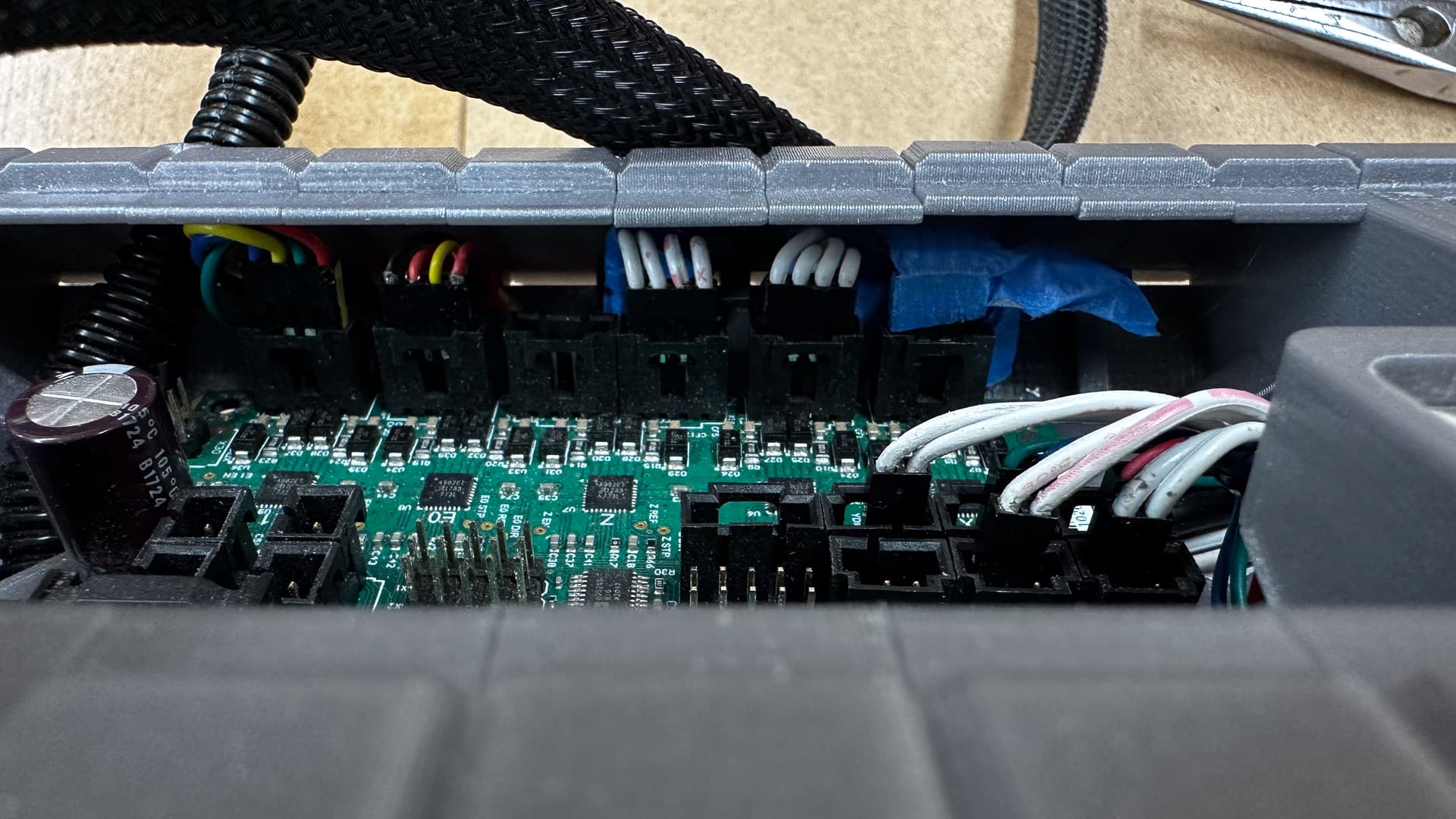

Now to dismantle those looms to get to the "Y’"s!
As reported on another thread, while I had the back strut off, I switched out a usb cable and Repetier started talking to the Mac! :open_mouth:
Then, despite my chronic lack of room, I managed to switch the “Y”'s using a pair of long nosed pliers and the old hold-your-breath-and-hope-you-don’t-wiggle-a-pin-off-technique, which all wen’t surprisingly smoothly.

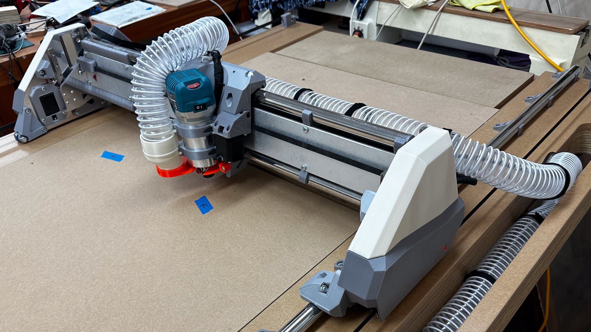

Time flies when you are having fun, so a couple of hours later, everything is almost working. I plopped the router in to see how things were and apart from tilting forward by a shave, all is well with the world.

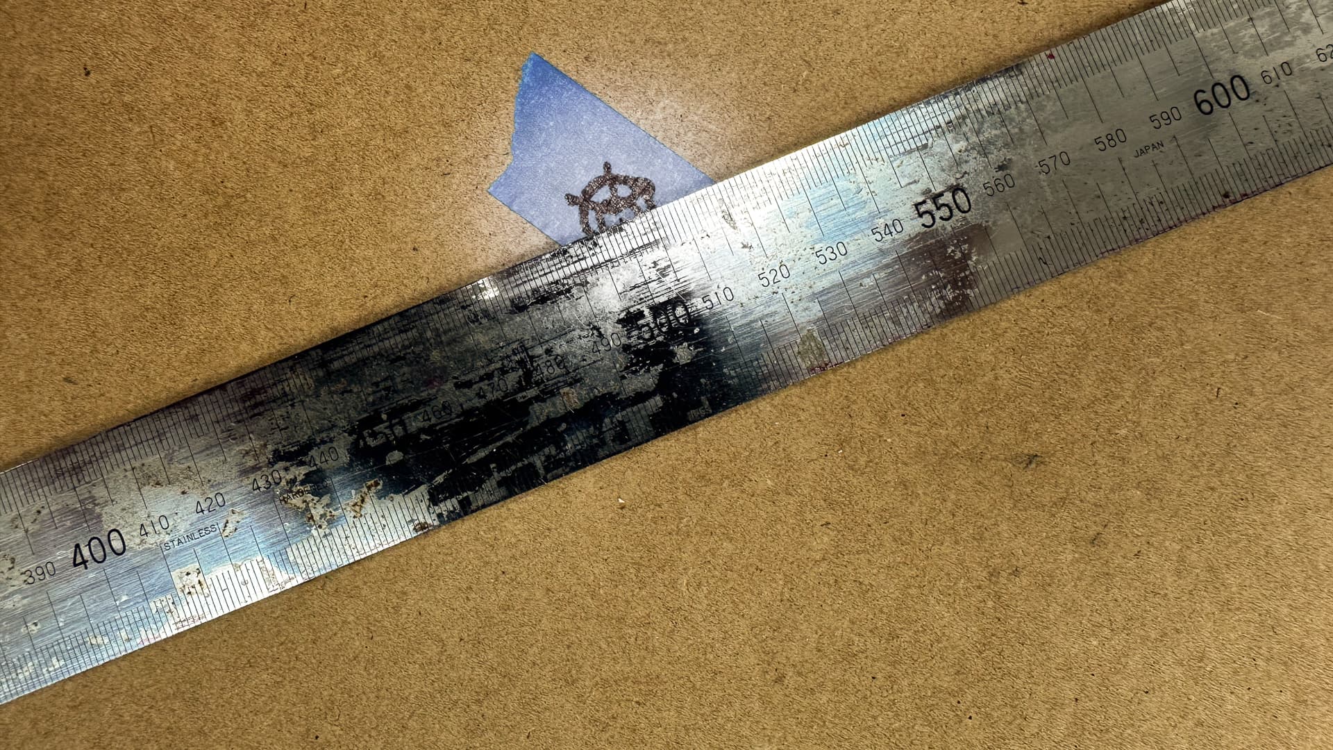

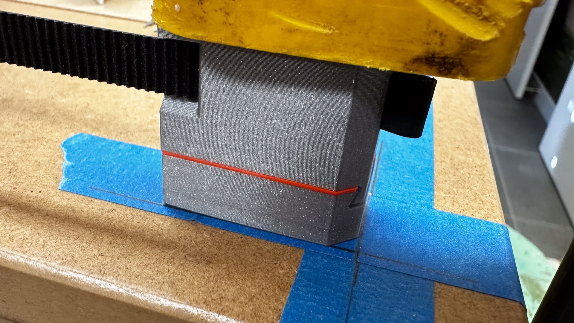

I’m not ready to run a full square test yet, and probably won’t for the time being because I did do a quick 3-4-5 check only 300mm 400mm and 500mm and I was absolutely astonished :open_mouth: by the results. Under that little sharpie dot is a pin prick and I’m going to say that at that size and with the implements at my disposal the out-of-square is immeasurable. It’s certainly good enough for the girls I go out with when you consider the next thing of importance will be the braces and they are only 80mm not 300 wide, so the error will be a quarter of this at worst.

Oh, and perplexingly enough - the original open circuit error on x homing has not recurred, so either the joint has wiggled itself back and all is well, or it’s getting ready to ambush me when I am more stressed and in a rush to do something.

I have been testing an different type of connection point and do not have a good one yet. If you are not happy with the shims I think you can just scale the Z on the lower part down a percent or two and it will be tighter.
Nice! :trophy:
I actually think the shims are a nice solution - they work really well, take five minutes to print (both) on a slow printer and are completely optional and adjustable to take into account any printer tolerances. They are possibly a little janky compared to the super nicely sorted everything else, but once installed are virtually invisible. Since only one or perhaps two persons other than me has even been bothered about the issue, I’d suggest you get on with other more important things.
Or make shims part of the solution. :smiley: I like this solution as it distributes the load evenly along the dovetailed keyway, but there are zillions of builds that tell me it’s not necessary.

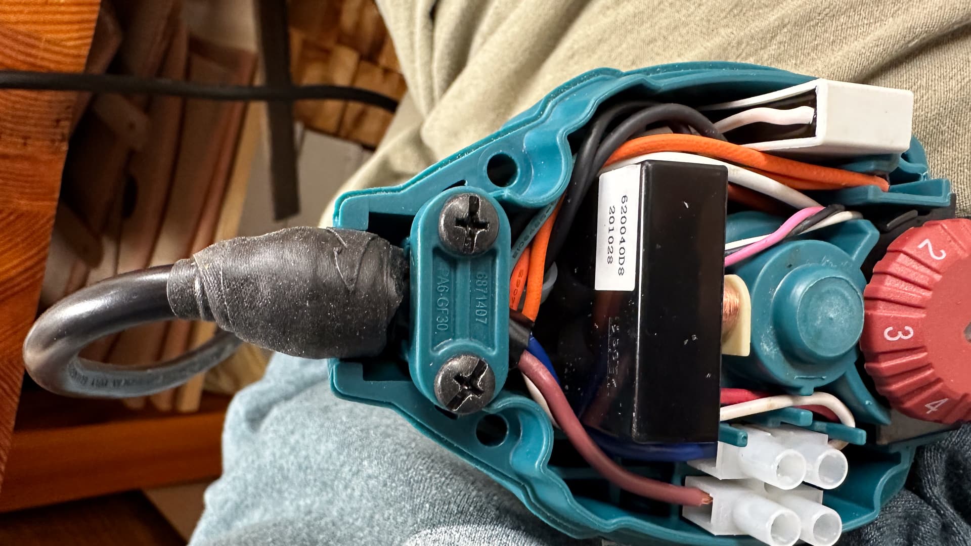

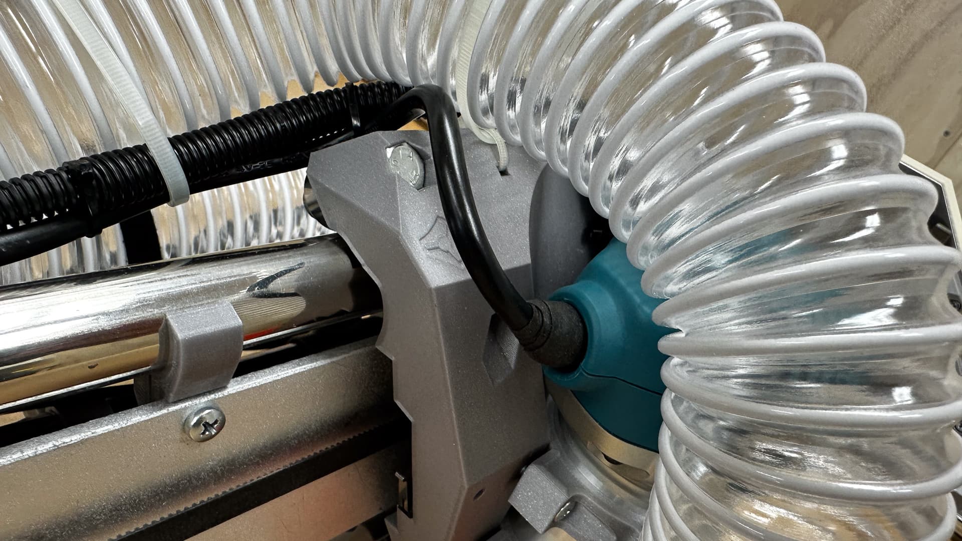

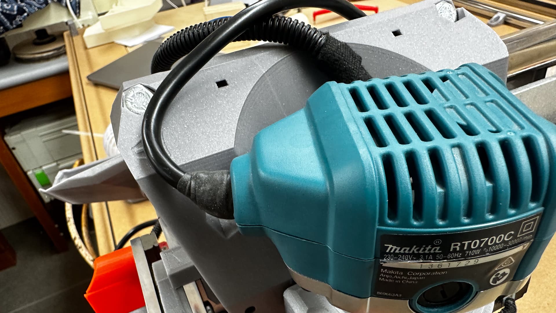

In the meantime I’ve broken the seal and ruined the warranty on my router - swapped out the cord for the IEC lead, and because I’ve just noticed in the photo the active has some bare wire showing, I guess I get to do it again tomorrow too. I have already had it apart again to remove the old rubber strain relief and make my own stubby version.

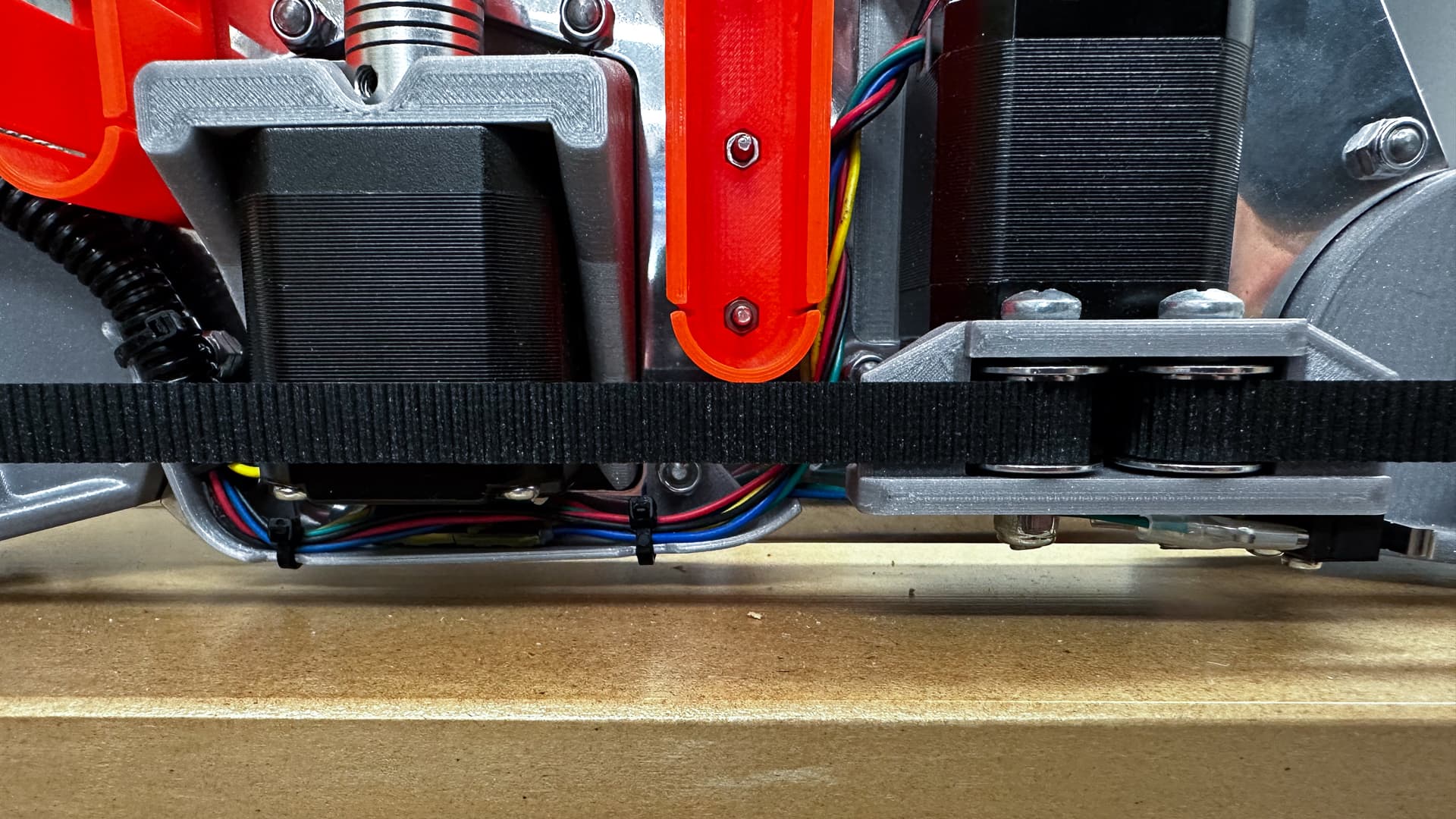

Then there’s the reason I insist on testing myself before uploading models. I came ver close to uploading the fender models but am now glad I stuck to my guns. The clash with the belt is miniscule, barely a mm maybe not, but it’s a clash I’m happy no one else has to see. Easily fixed with a Dremel albeit hasty and nasty, but it’s also easily fixed in the model so I will do that in the coming week or so, if ever I get this thing running!!
Never fear - I will be printing completely new ones once the Mk$ arrives in a week or two.

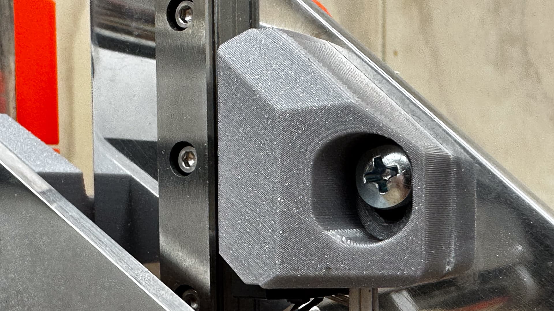

The of course there’s the right hand Z-stop which didn’t. It missed out by three thicknesses of tape as it turns out, so a slight twist of the mount fixed that - I will have to smear some silicone on the back to give it some grip on the polished metal.

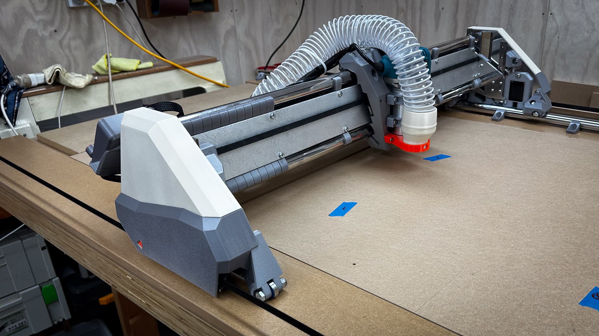

I finally had everything moving properly, homed everything, ran to the table extremities, auto homed everything and started to think about how I was going to mount that Sharpie. So I fitted all the leads and vac hoses, tidied everything up, added my fenders and thought I’d make a short video.
That was when the right hand Z jammed on the way up - loose bolt. Tightened it all, started the film running again, and the left hand Y stopped working entirely. That gave an interesting sound effect and motion. I have no idea on that - so when I regain my composure we’ll dismantle it all and look once more for the culprit.

No, it’s very crooked because the Y stepper simply stopped working. I was in the process of photographing it “auto-homing” when the terrible graunching started. Initially I thought it was the hose catching in the slot, which would have been a lot harder to fix.
