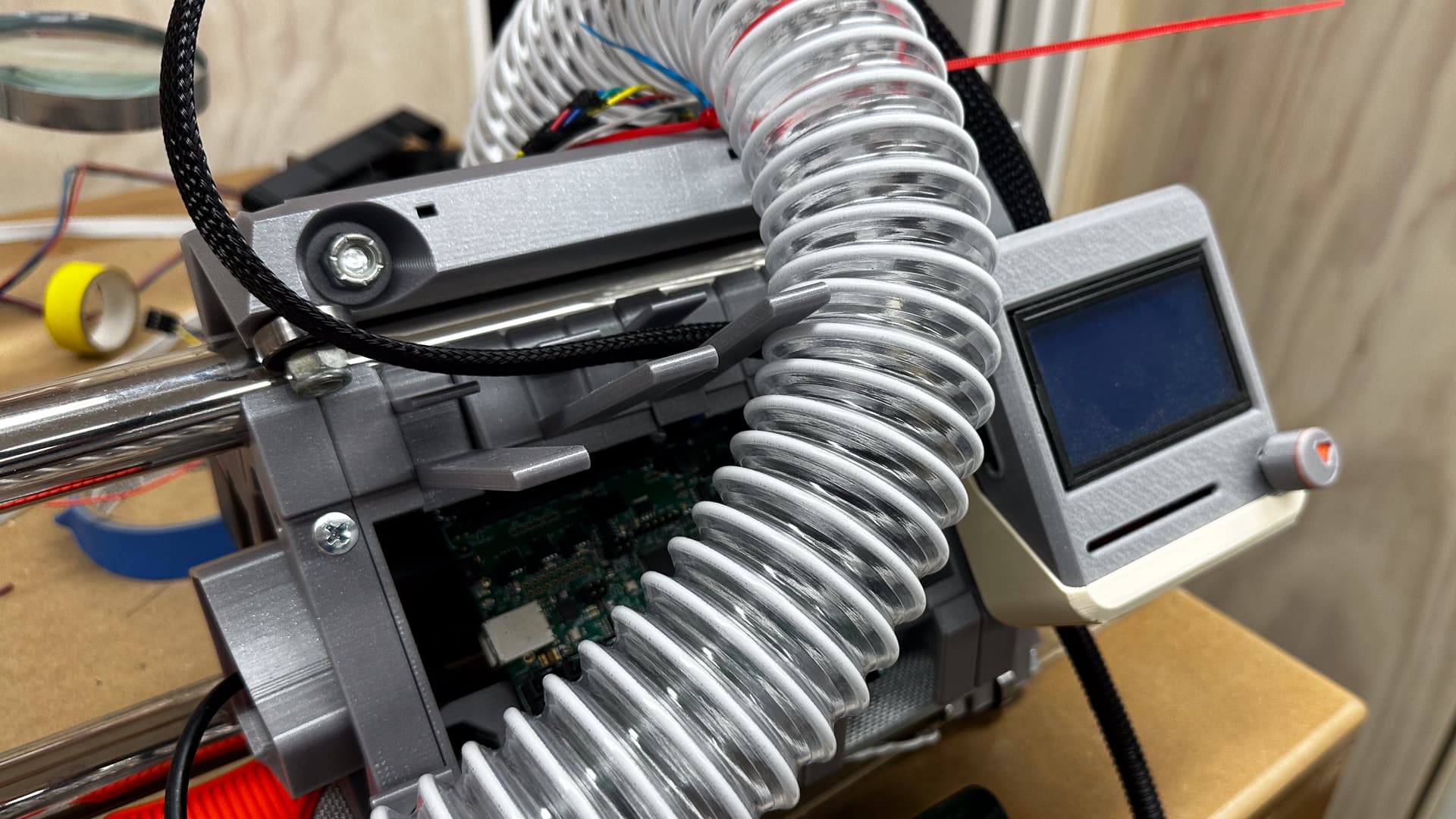

Well yes, I would like to be finished shortly, but there doesn’t seem to be any end to the tweaks I still need to make. Routing the vac hose to the “other” side seemed to be a good idea at the time, but in reality it clashes with just about everything.

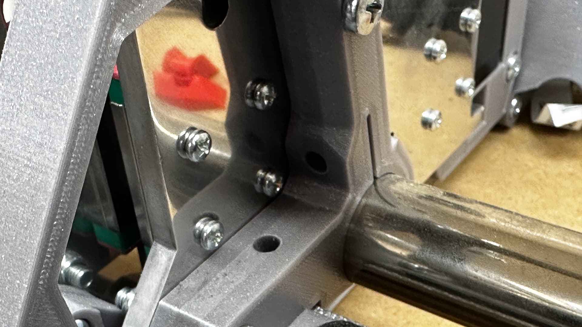

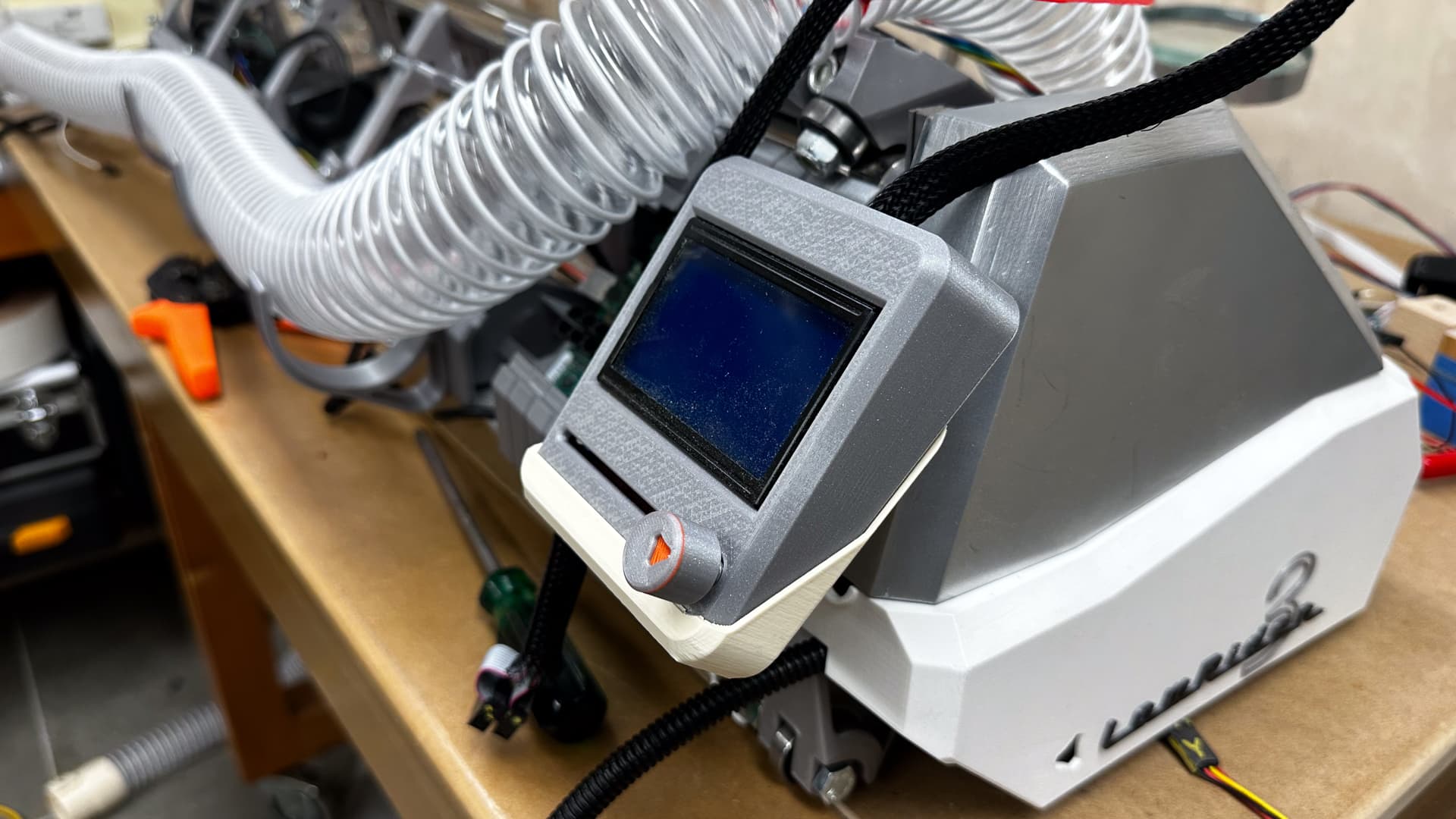

So I’ve mocked up a mount for the Graphic controller that seems to do the trick neatly. It just bolts to the brace end bolts and is at sufficient angle to hold it all very securely. Now I can get rid of those “rhino horns” that I quite correctly feared would foul everything.

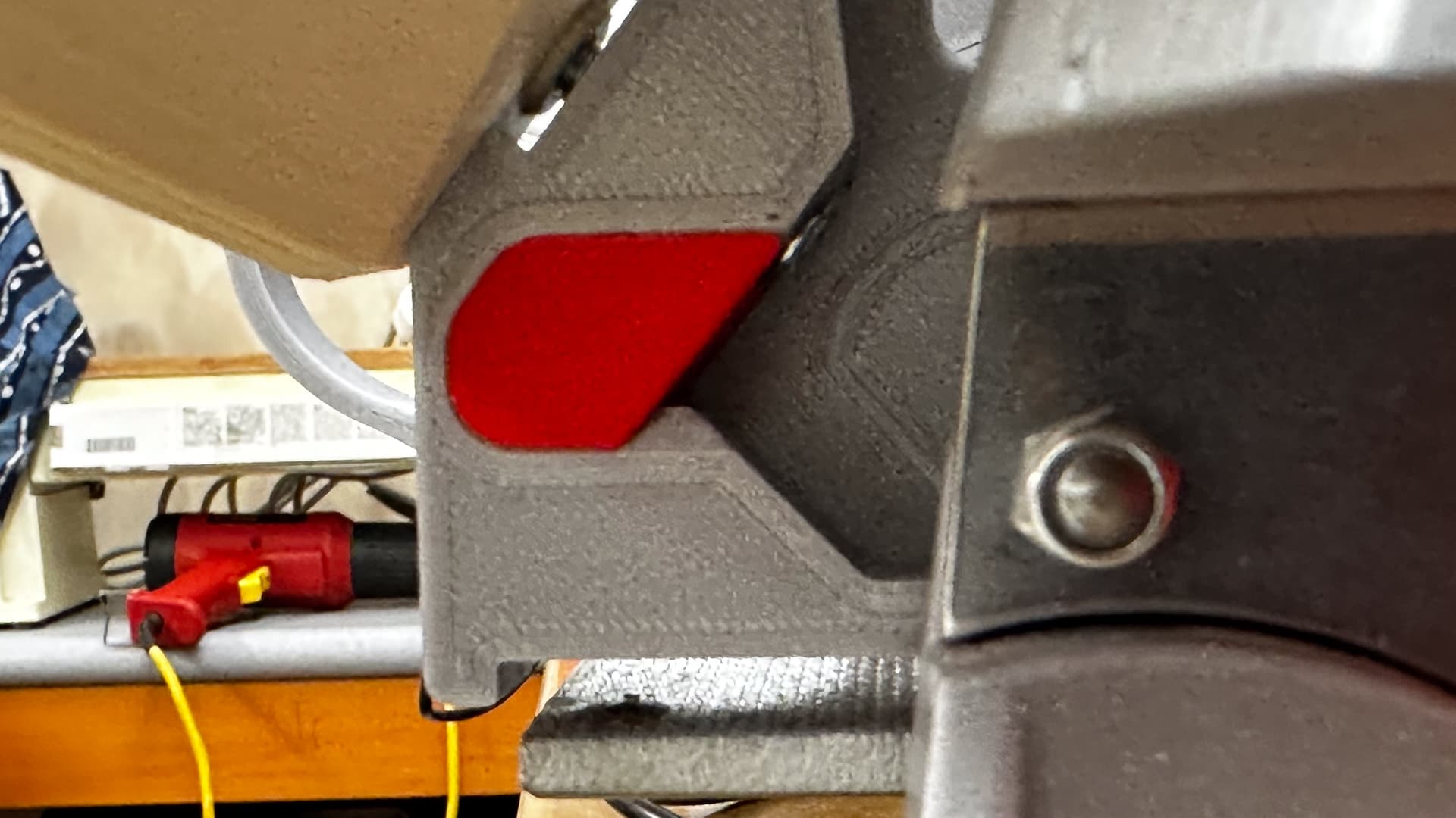

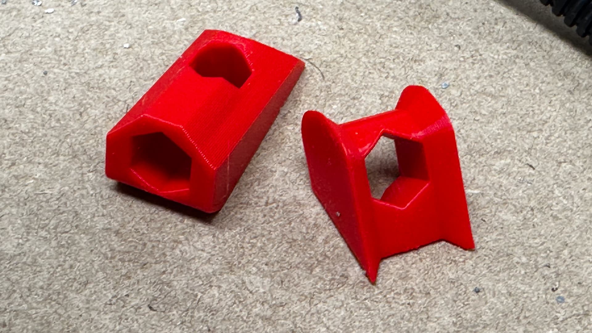

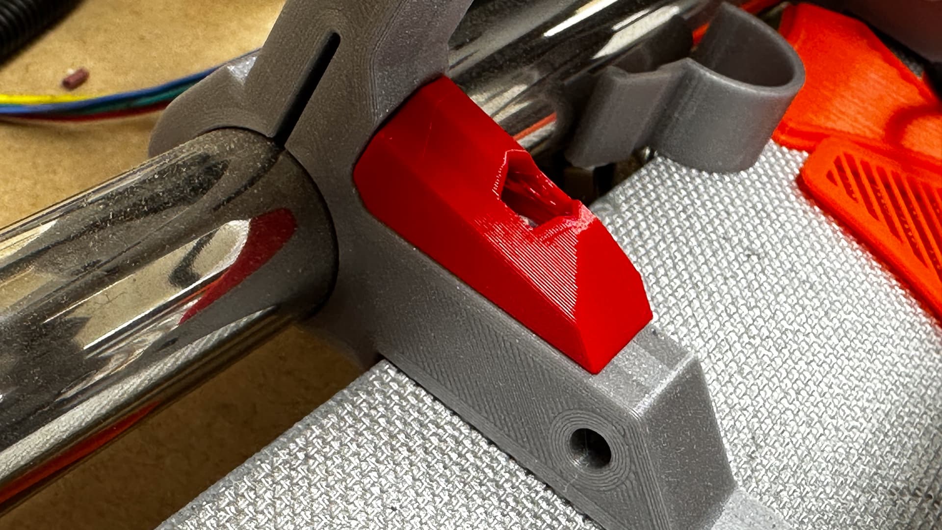

This is why I don’t get things finished, but its also why I love the 3d printing process! I was pondering the thought of “after market” captive nut devices for the braces last night, and made these two splendid little fellows in the blink of an eye. Both just slot into place, the one that goes on the front edge balances until both nuts are in, but as long as one nut is in place first it works like a charm.
Of course the only place it would be useful for me is on the end, and I didn’t take into account the rail mount screws - if anyone is interested I’ll make one with some cutouts for the ends. The reflection of the bits in the plate is purely accidental, but I thought I’d point it out anyway.
I just thought it was a simple idea for those (like me) who have printed their braces before discovering @DougJoseph 's version with the captive recesses incorporated.
So cool!
Actually it might be useful if micro-adjustments are needed to align the end braces. I might go ahead and install them in the ends anyway - can’t do any harm!

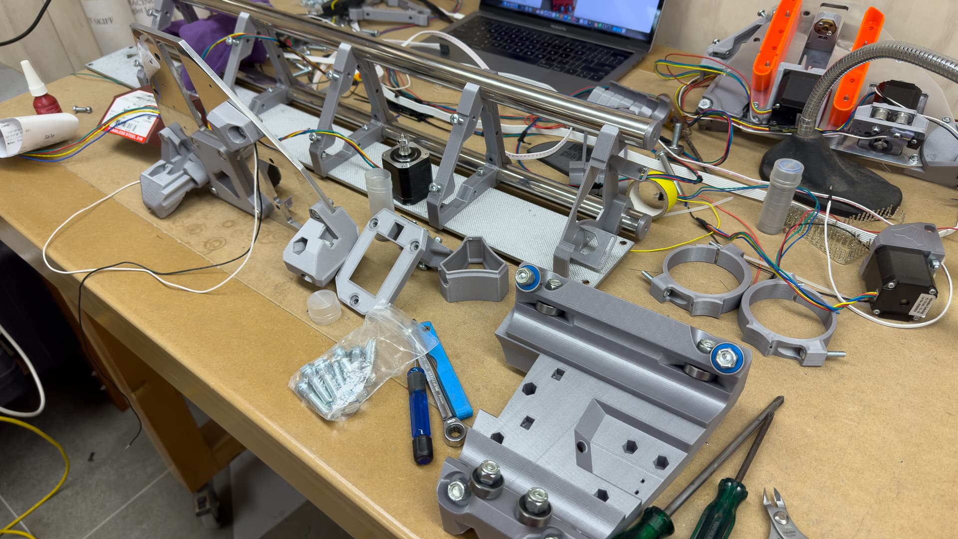

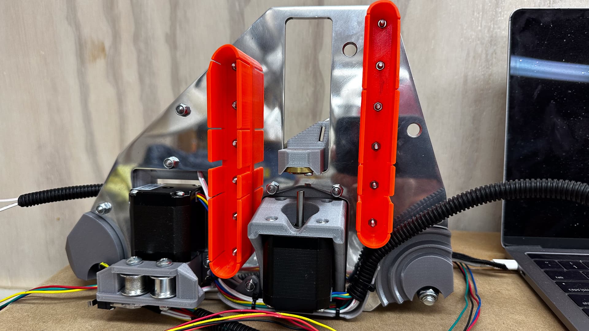

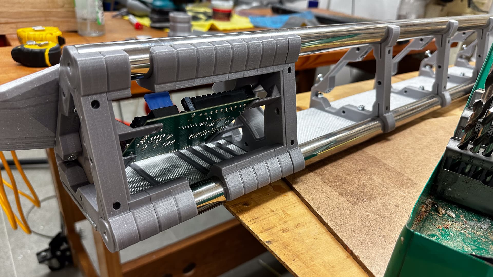

It seems like for ever to me, and it must be interminable to you if you’ve been following, but it’s only been five weeks since my desk last looked like this.
I cannot tell a lie, I am getting a bit anxious now, and interruptions loom once more, I’m pretty sure I know where everything goes now, so I thought I’d start the build proper.
“look mum, my bearings have turned blue!”
Those with keener eyes than mine might even spot the bottle of Locktite! :grin:

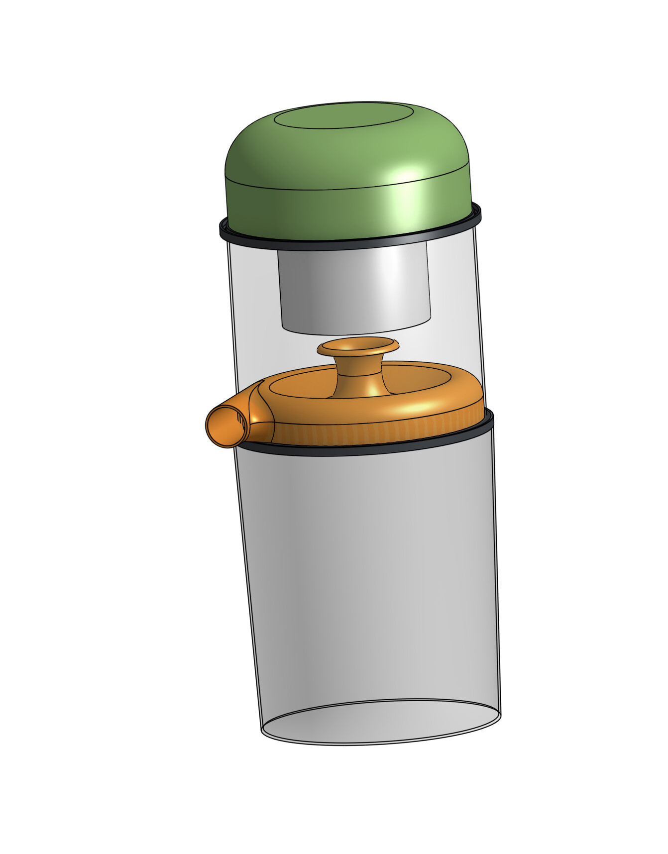

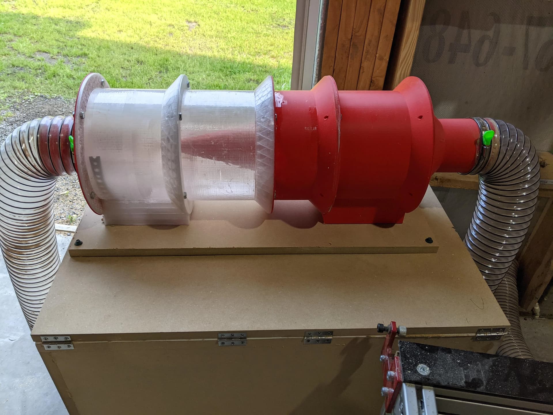

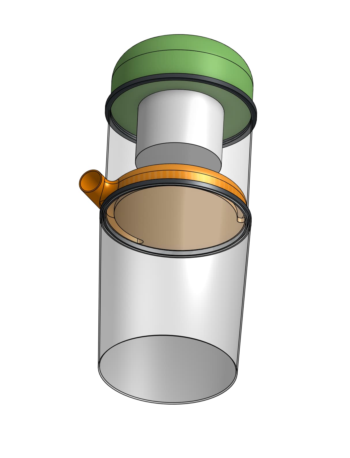

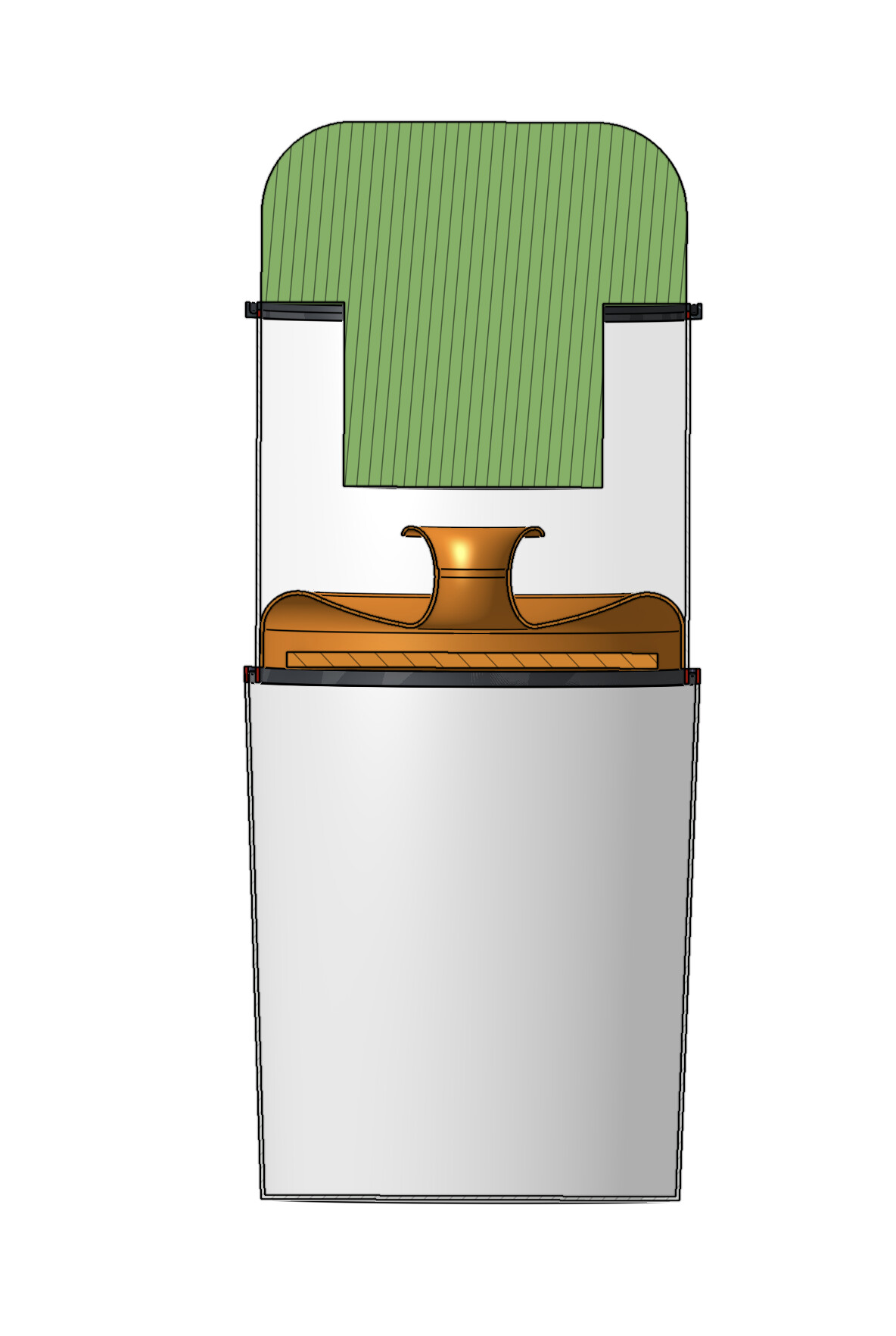

I’ve got just a few days to get on with this thing, so I started this morning by drawing a dust separator instead. This is inspired by Thien, Dustopper, Marius Hornberger, Mathias, and just about every other video on youtube :woozy_face:. Since I can buy a new shopvac for less than half of the price of a dustopper, and I don’t want the Mk$ to be wasting time sitting around doing nothing when it arrives…
Can I bury this thought for the next two months while I wait???
Ryobi vac, split with a bucket section, printed “spiral” with adapter for bucket and vac bit, and cnc cut Thein baffle.
I might make her one for Christmas! :smiley:
Ok, hear me out…
“Horizontal dust separator inside the LR3 struts” :smiley:

As always, it’s been a day ebbing and flowing as I try to pick up on all the little details I’ve thought about and get into assembly proper.

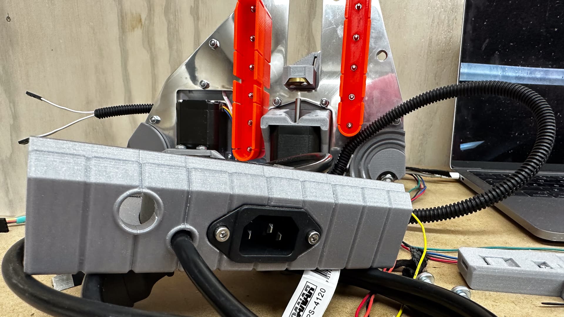

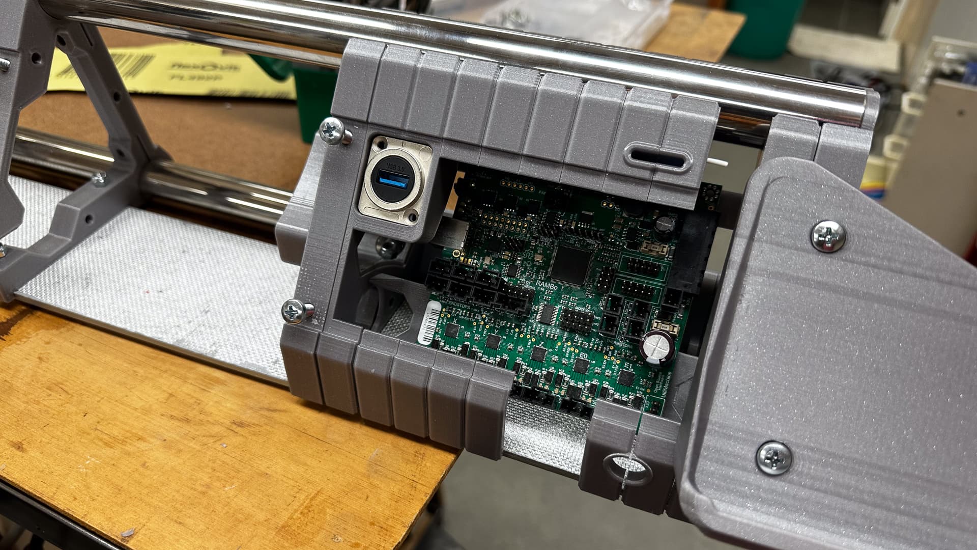

I’m super happy with the board enclosure in the beam - the missing “teeth” will be in tomorrow - they were just left so I could adjust the dimensions if I had a print error. Curiously the Graphich Controller tray is striped because I used variable heights and obviously that doesn’t play well with Galaxy Silver. I’ll wait till it’s all together to decide whether i can live with it or not! If there’s a Joker in my life sometime in the future it will go in the bin anyway.
It’s a squeezy fit, but Ironically there’s a ton of room under the board for stray cable length.
And speaking of squeezy fits - the clips for the fenders do up the degree of difficulty but I am really satisfied with the results thus far. I drilled out the laser-blasted holes a smidgen over m3 but still less than the holes in the rails, but due to the the tiny misalignment of the holes it was a cow of a job to get the rails running smoothly. I wonder how many LR3’s are out there with rails out of parallel from one side to the other? A few tenths of a mm over four feet won’t make any difference, but it’s annoying!
Oh and while I had everything on the drill press, I finished the holes which will remain with a tidy countersink - should have done that first time round.

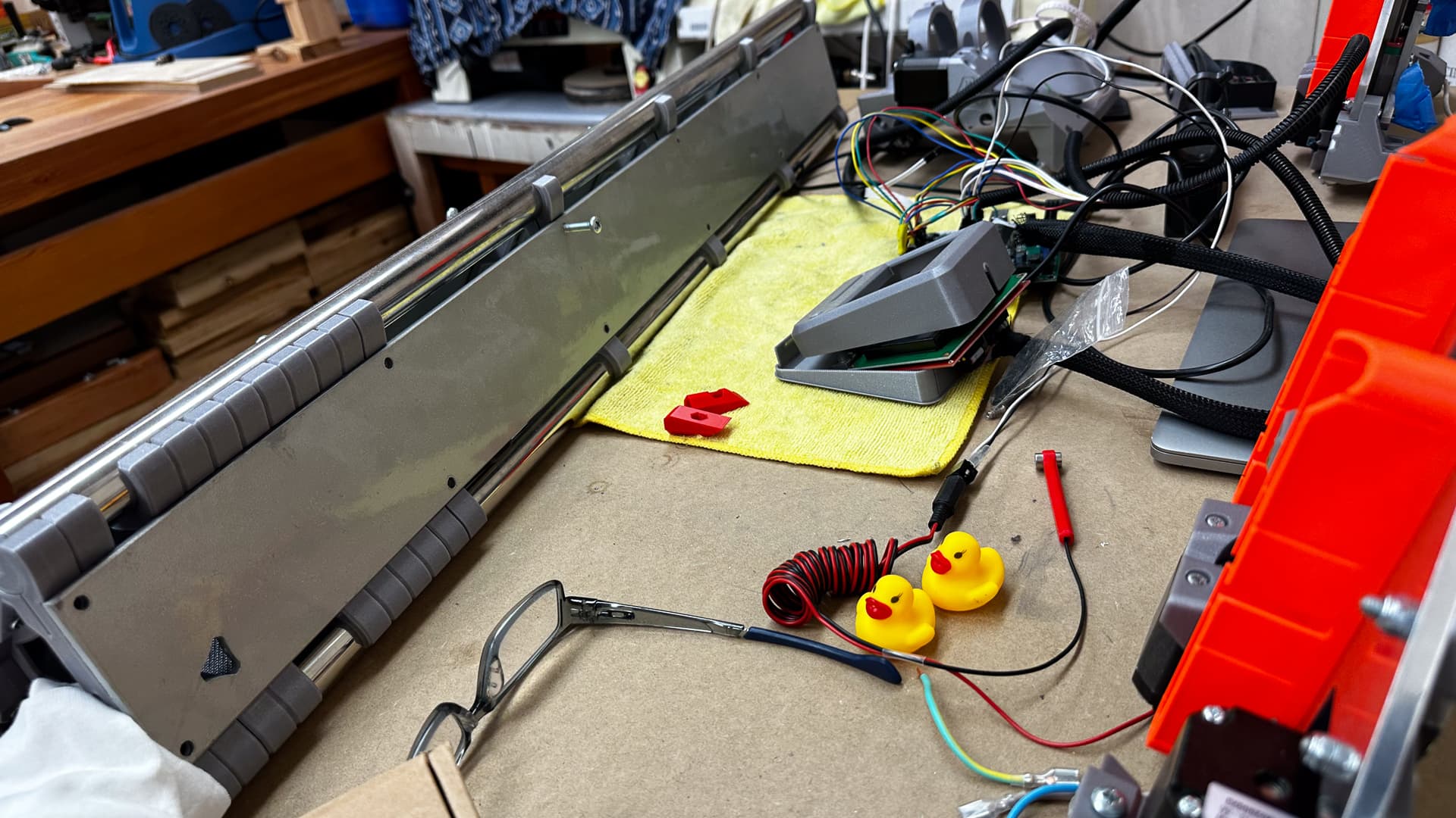

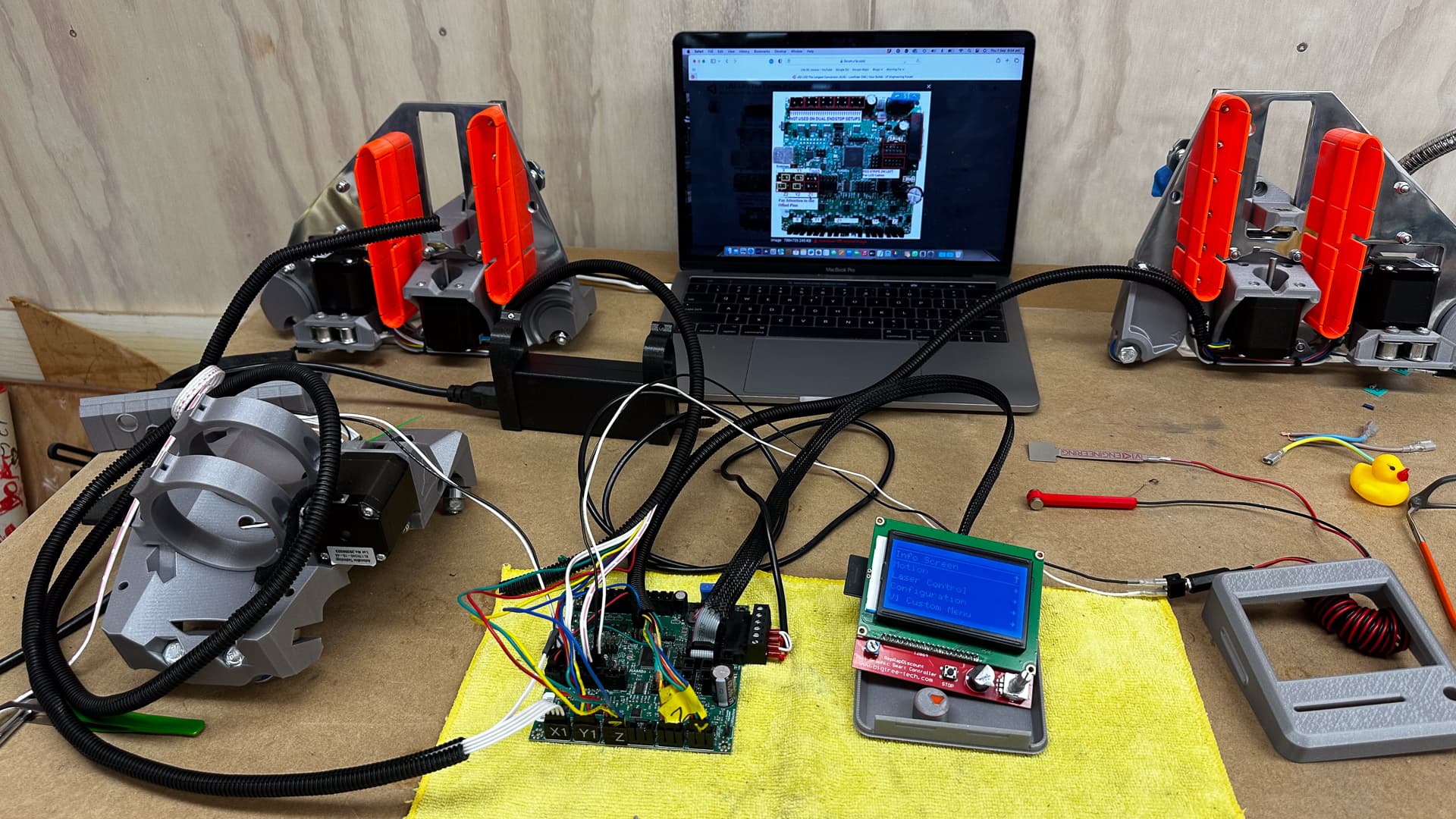

TROUBLE in Paradise!
Fixed by @vicious1 Ryan in less than twenty minutes - I’m blown away ! Thank you so much!
Well just when things were tickety boo, it’s all gone to you know what! :open_mouth: This is what happens when you try to get one duck to line up with itself.
I guess there’ll be a short delay in progress.

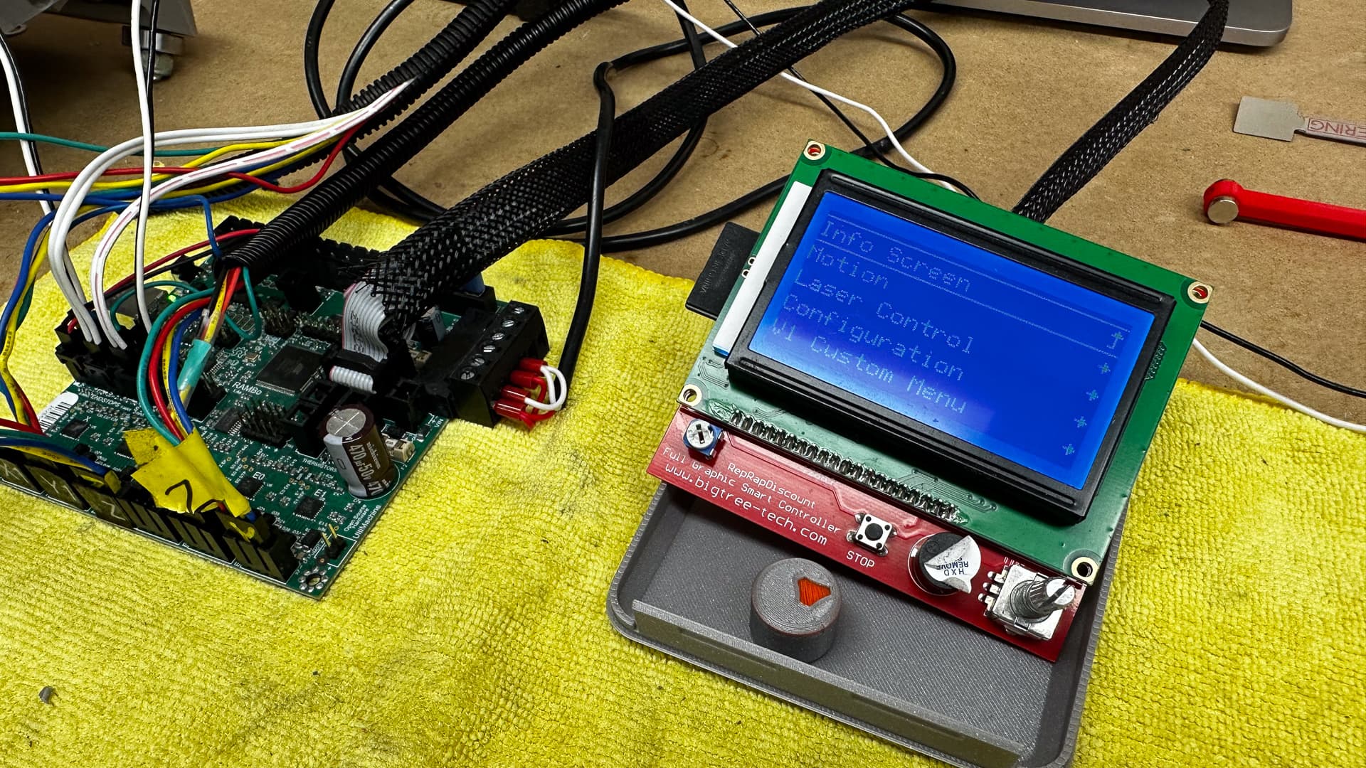

1) GRAPHIC CONTROLLER UNRESPONSIVE
I’m fairly sure everything is wired correctly and that it’s not a wiring issue. I think in all of my mucking around I’ve damaged the rotary encoder, is that even possible?
It feels normal and there’s no sign of damage on the soldered joints - but only the click works - which means I can toggle between the home screen and the next screen but can’t move to any other command.
Soldering in a new one may be within the limits of my skill set, but I don’t have a clue what to buy and in at our local electronics store the switch is about half the price of a new controller (no counting postage!)
Everything else appears normal, I reflashed the board a few weeks ago and everything was operating perfectly, today it’s not.

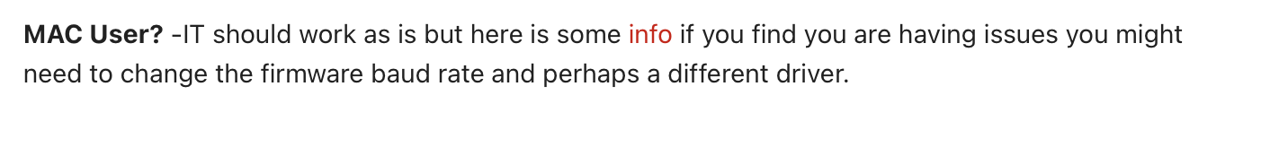

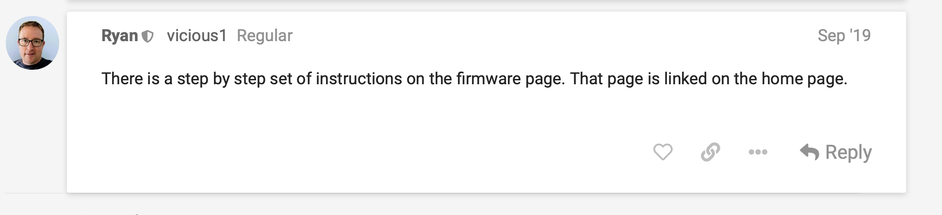

2) Well use Repetier you say!
Right well it’s time for the old “can’t connect to the Mac” messages. I seem to recall there’s a baud rate thing so went looking in the forum and the documents-
Either it’s my confusion or the docs are somewhat out of date (if I get through this I promise I’ll try to fix that, but I am so far out of my depth with this stuff that in itself would need someone else’s supervision)
So the docs very helpfully have this link -
Which takes me to a thread from 2016 in which are a number of dead links, and posts of code which I have no hope of understanding. But at the end of that thread there’s a neat post which takes me back to where I started.
Yes I am a bit frustrated, but not at the support - just my own inability to see clearly what I need to do.

Two options. Physically swap the gray cables on both ends. Not all the wires are used so if one broke the other cable should be fine. Second would be to hit teh 6 solder joints real quick to make sure they are fine.
250000, try that.
I don’t think whatever driver issue it was is a problem anymore. It has been so long I am confident it isn’t an issue.
a)maybe
b)try just reflowing them real quick first.
c)I mean…
d)Make sure the baud rate and port are correct, if there is still an issue install the Arduino ide and the drivers when it asks. I think that solved it before.
THANK-YOU!!
Both suggestions were brilliant! I’m up and running (actually I’m having a cup of coffee but will be back to it shortly!)
In the 18 minutes between my post and yours I began working methodically through the Repetier Manual - and had discovered the Baud Rate thing (note there’s a reference in the above thread to another baud rate that doesn’t work). I also (ahem) allocated a port, which seemed to make a difference! :woozy_face:
Swapping the cables worked immediately. So I’m back on line and ready to make things move. I suppose I should replace them! That should have been an obvious part of my troubleshooting but I hadn’t given it a thought - it’s crazy how panic (not that I was panicking - perhaps frustration) makes one blind!
I’ll put off the Repetier learning curve for another day.

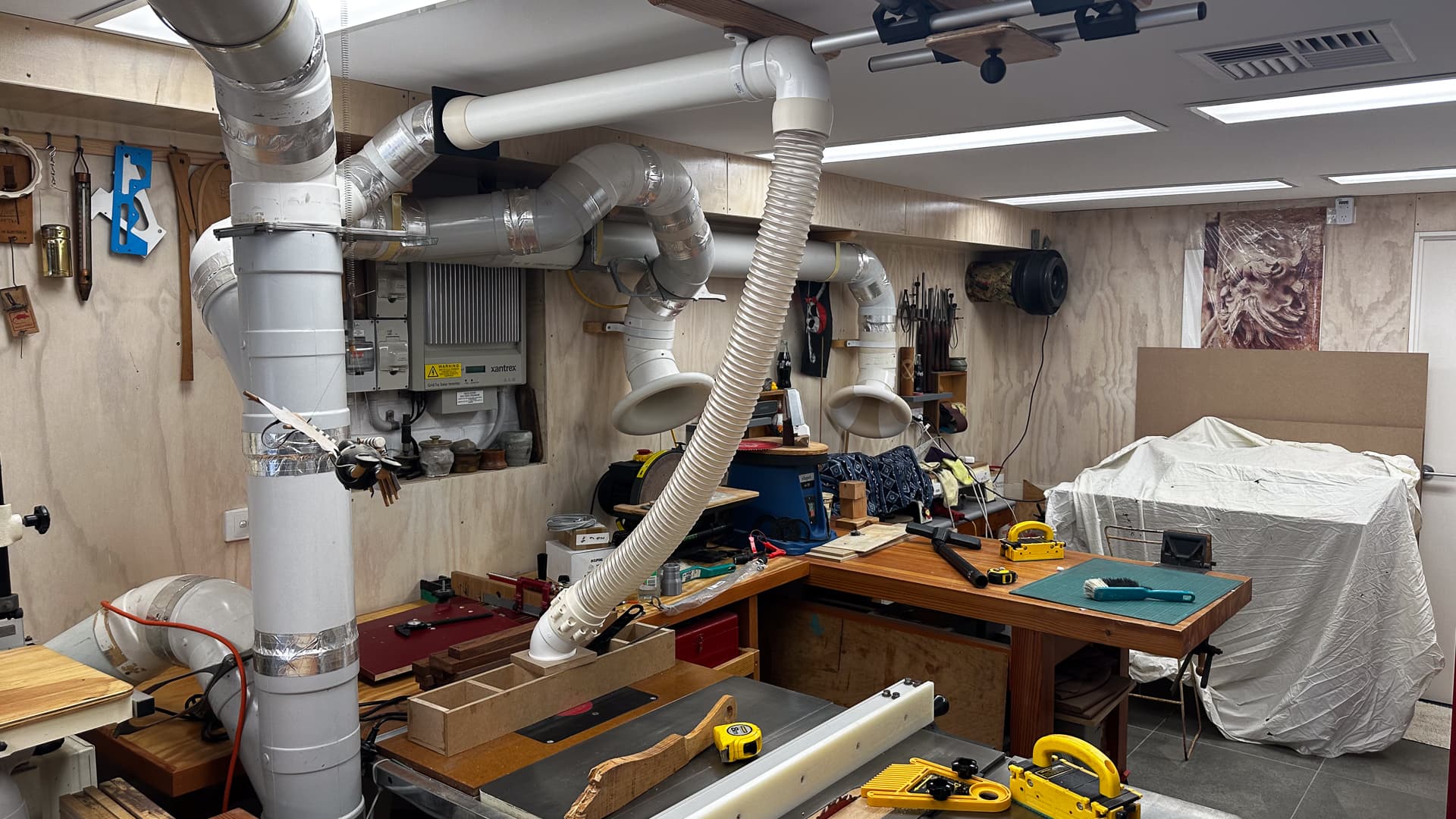

Eight days into spring and it’s a balmy 22.5° in the shed, which is pretty much where it is most days during winter, and the humidity is a “great for wearing protective gear” 99.8% :woozy_face:

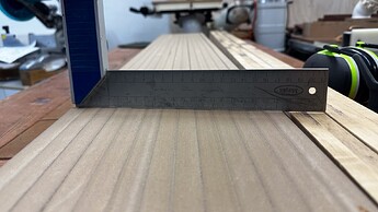

I needed to clear all that “terminal” “M119” stuff out of my head and what better way to do that than to cut MDF into little bits! MDF is my least favourite material to work with I think, but it is very good at what it does. So I’ve covered the LR3, turned on every dust extraction and filter device I own (and I own a few), and cut the bits for the table internals (one more run through the thickness sander and they’ll be perfect.)
Once I get tired of the sweat under the mask, I vacuum all the dust I can see and vacate for an hour or two till the air is safe to breath unmasked.
This afternoon - MDF vs the dado Blade! Oh I love the way mdf dust cakes in my hair! :smiley:
