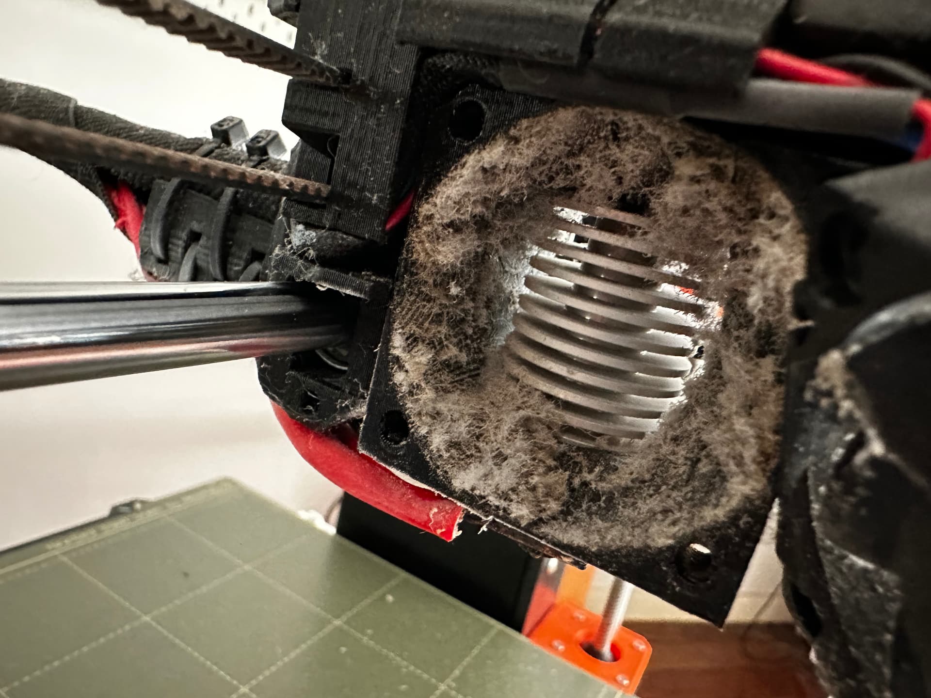

Turns out you really should clean your fans occasionally, and even with a machine kept in an enclosure, 4000 hours is probably more than enough time to start a fire if you try hard enough.
The nozzle clog turned out to be really odd too. I had changed filament to start a print, realised that in my dozey state I’d loaded the wrong colour and immediately unloaded it pretty much in one action, before it had even started oozing from the nozzle. Through sheer fluke, a tiny knob of filament formed just below the PTFE tube, in the hollow of the empty nozzle but just far enough away from anything that gets hot, to jam up the works. Bizarre, and the machine is now clean and greased and ready to run (I think) complete with software update!

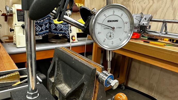

Thanks for the heads up! I thought I’d check our your warning, and being somewhat bereft of proper engineering measuring tools I set up a shonky jig with the dial indicator and got close enough.
The bearing on the left is an original @vicious1 version, on the right the new “blue” one. I kept the indicator in place and moved the bearings so they would be in the same location on the axle.
Both were identical in overall diameter, both ran true with no deflection on the gauge.
Both are loose on the axle, with the diameter difference measured by deflecting the bearing by applying force below it.
The original bearing deviates .22mm, the new one .24mm.
Given that the bearings are installed at an angle and not exactly opposed, I’m going to guess the total difference installed at .03 mm. I suspect that when the bearings are actually settled on the rails that this will adjust to zero. Perhaps a machinist in our midst could care to comment, but I don’t see any reason for concern.

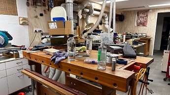

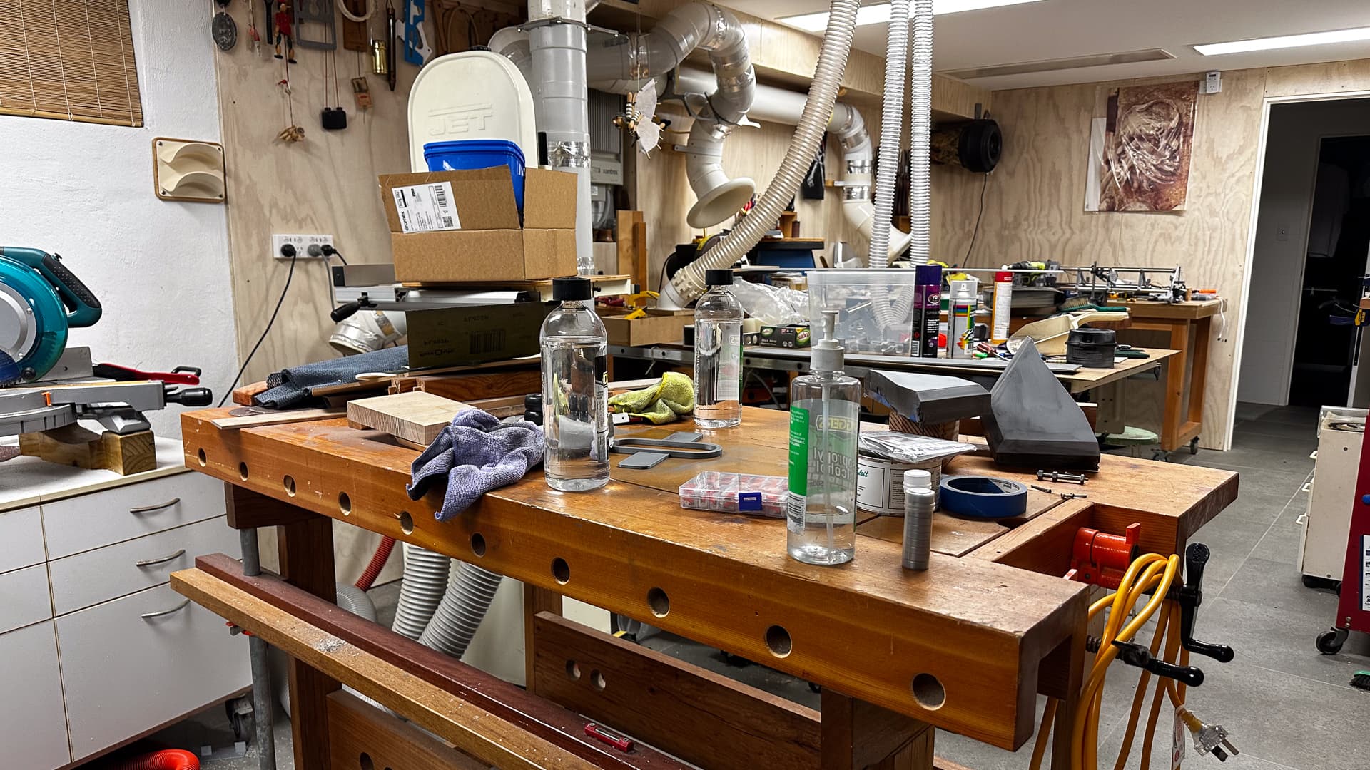

A bit of infrastructure work this afternoon, and there’s so much mess I can’t think! Everything from the other side of the table saw down has to move 300mm to fit the new table size (at the far wall).
That means pulling out stuff at this end, to get to the dust extraction ducts to tweak them a bit, putting castors on the benches that don’t have them (three of them) and hopefully putting things back in some semblance of order so I can get back to it. The car gets to sleep-out tonight while the chopsaw and bench take up part of it’s space, so hopefully it’s having a good time.

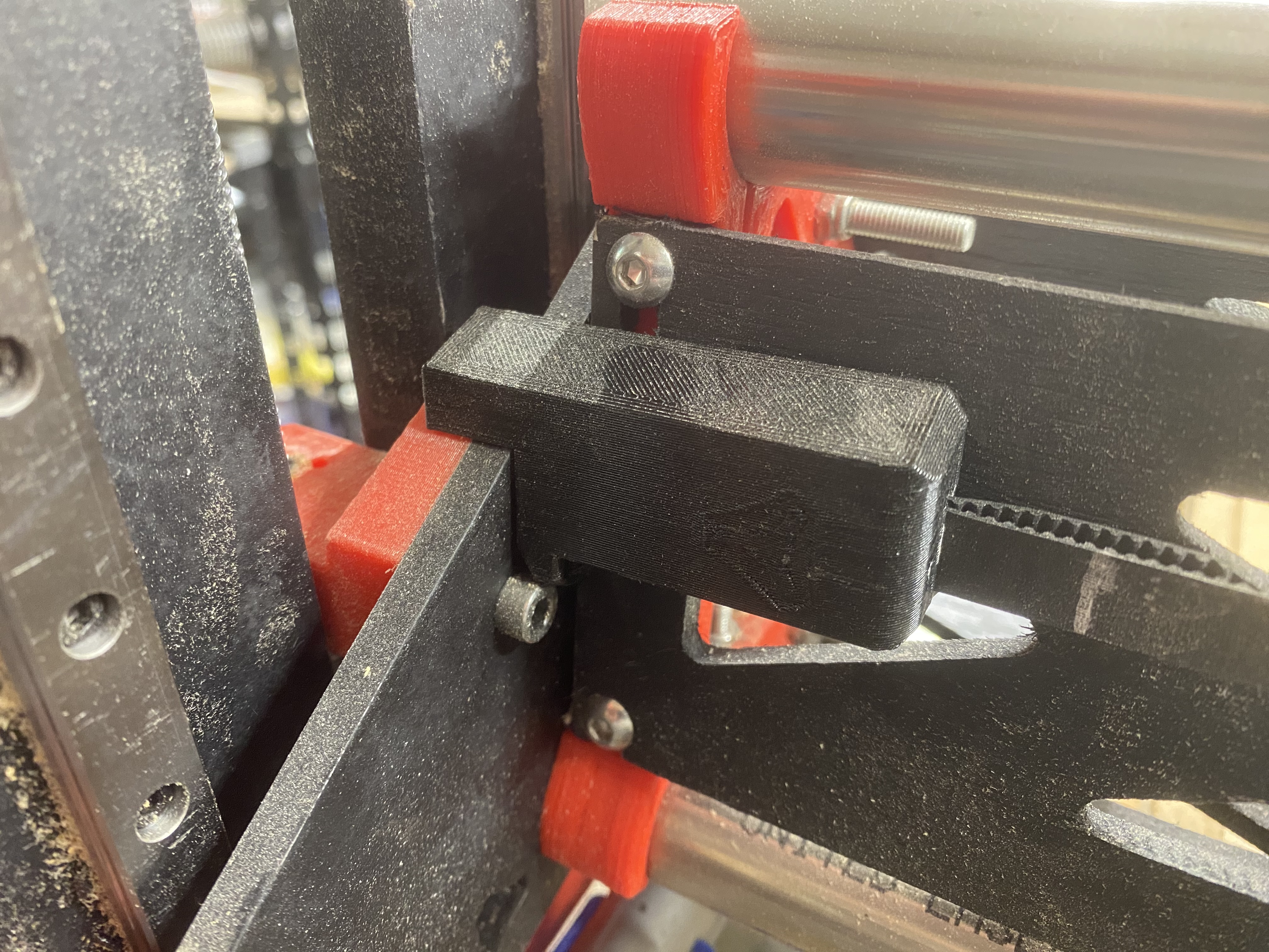

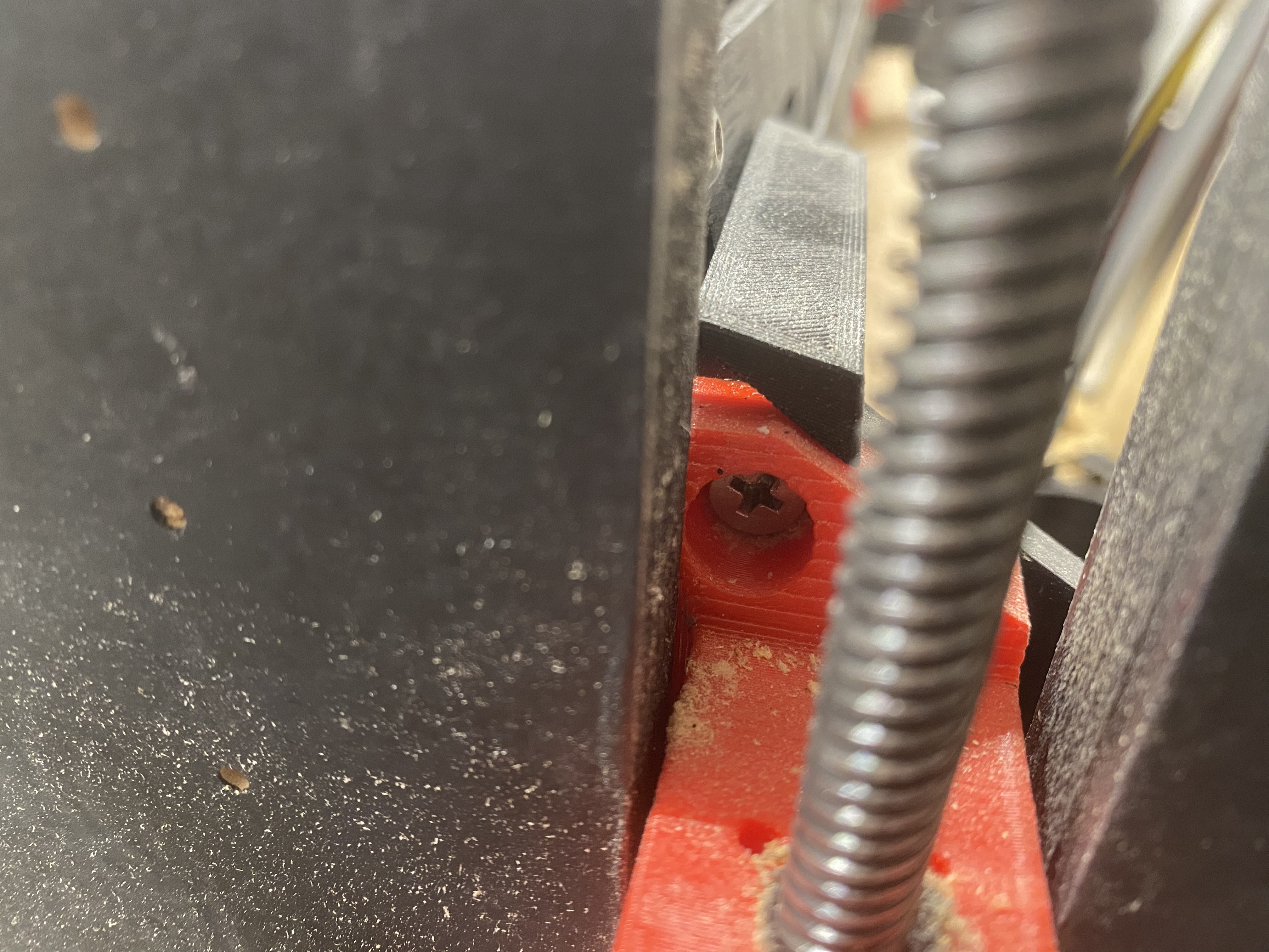

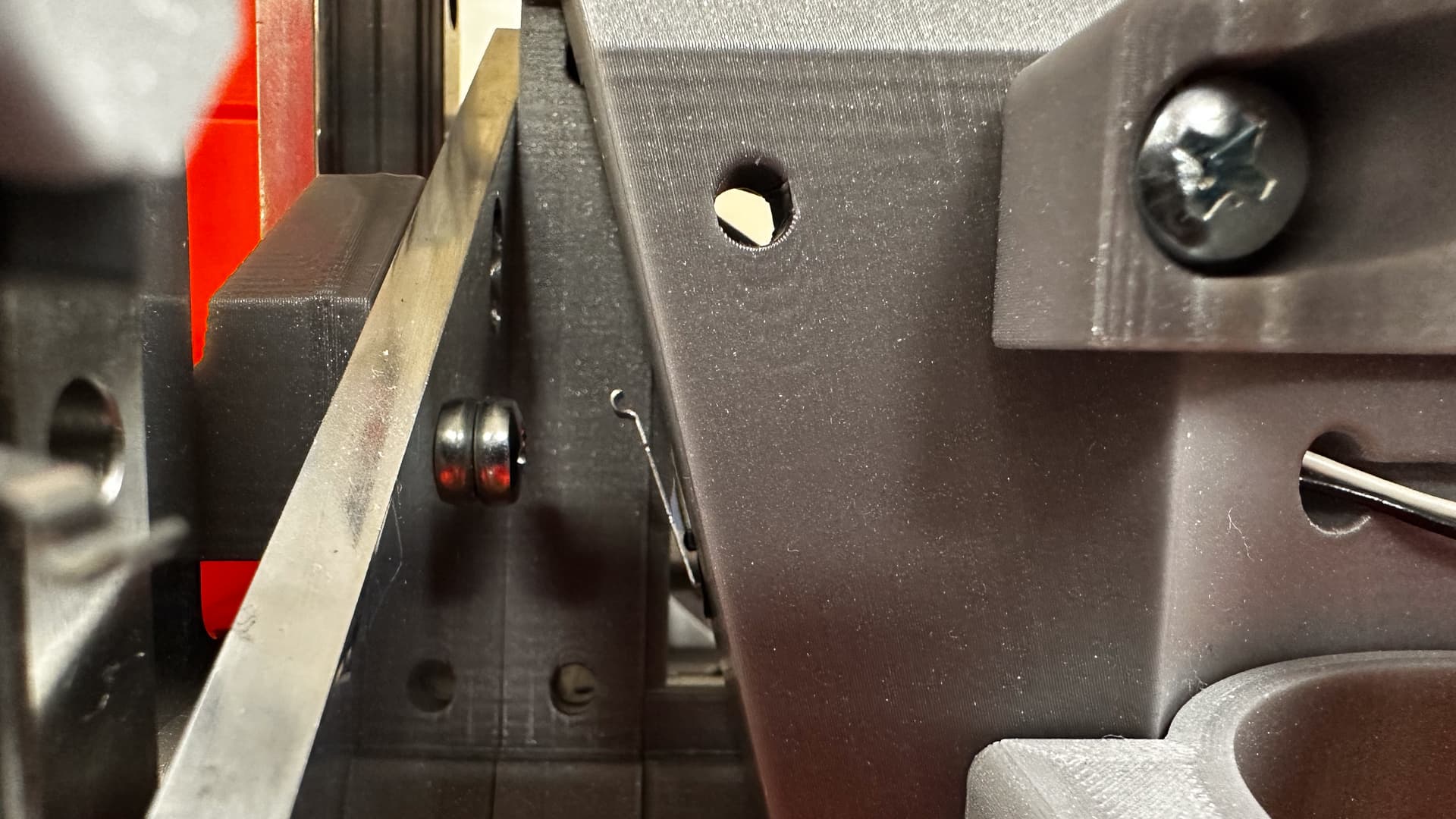

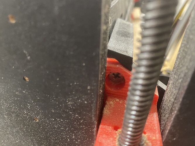

In the meantime - what am I missing here? Why does the X endstop not have anything to stop against? The belt fitting slides through above it, and as always when there’s a mystery, I can’t find a single photograph from the just the right angle to explain it!
It is supposed to trigger on the X belt tensioner. Maybe the switch is upside down?
I guessed that, but the tensioner passes clean over it - I discovered it accidentally - will be pulling it apart in a day or two anyway to start the final assembly so thanks for the suggestion.

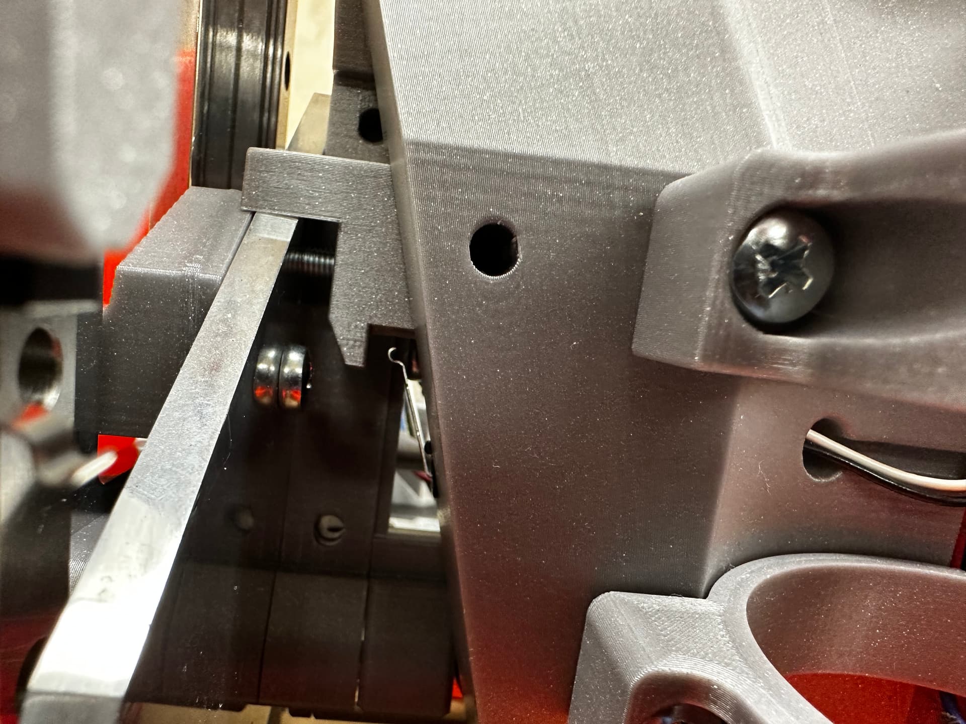

The two attached photos show how the X belt tensioner looks once it is installed. I’m probably looking at your photo wrong, but your X belt tensioner does not look right? Anyhow, maybe these pictures will help?
View from front:
View from side (through YZ plate):
With the tensioner installed - obviously we’ll have to be careful about giving it plenty of slack
That’s looking better…
About that… Early on I noticed there is an unused screw hole on the end-stop plate. It technically can have a screw installed that grants another level of adjustment, in which the head of the screw becomes the new end stop plate. Normally should not ever be needed. In my case, I needed it for a short time because an early version of my remix of the LR3 (Makita) dust shoe (mod’d to accommodate 2.5" hose) was too wide at first, and I needed to hit the end stop “sooner” to avoid collisions.
That´s great! Just wanted you to avoid the issue I had :slight_smile:

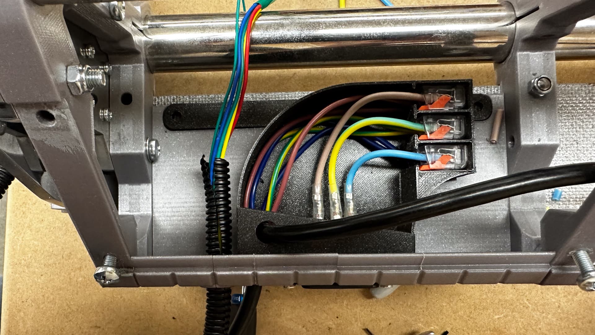

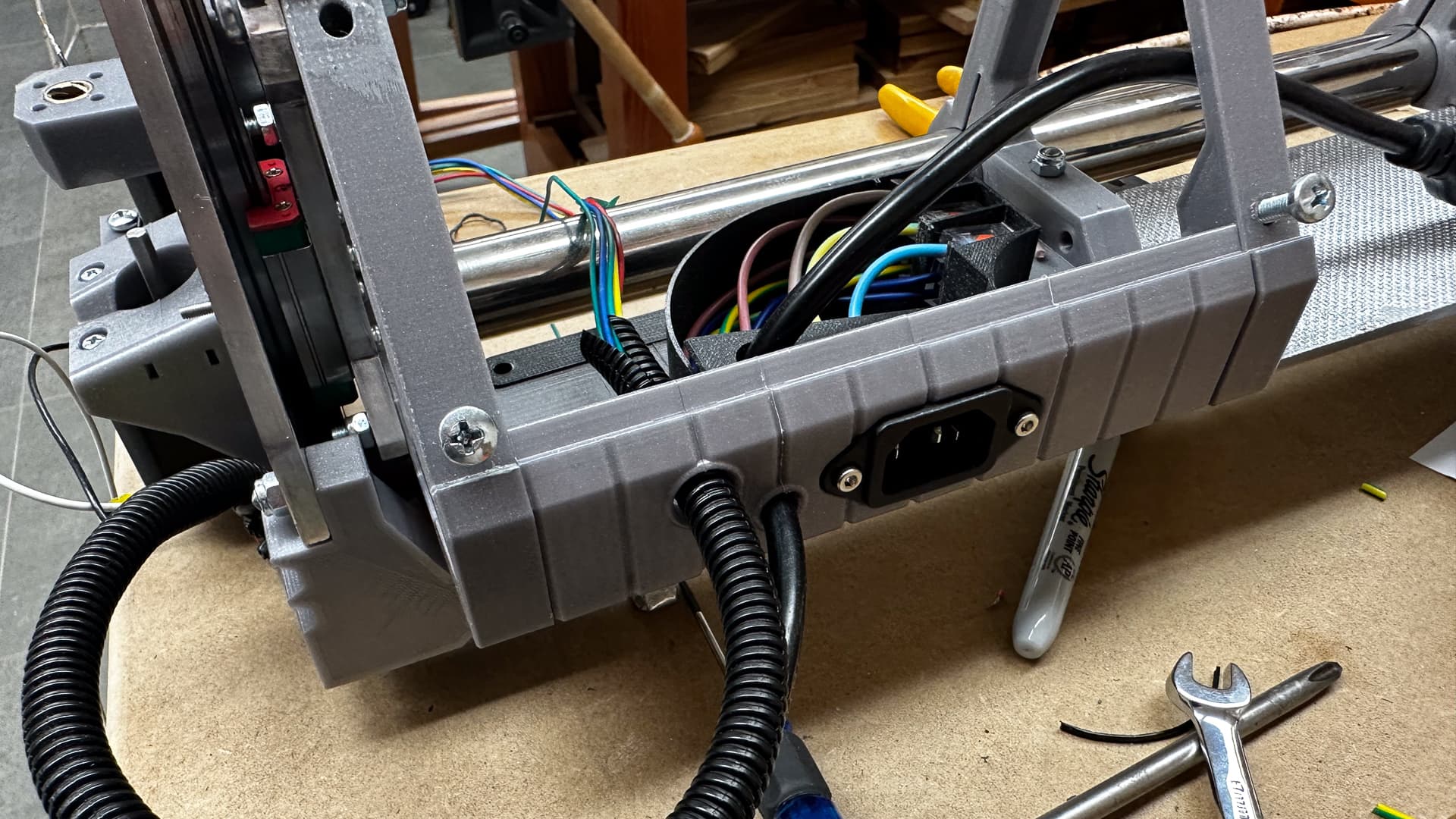

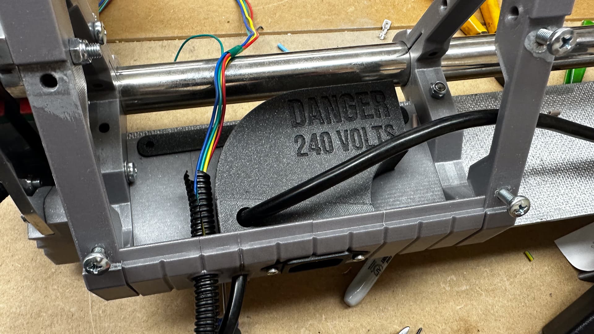

Back in full-on procrastination mode, with an entire shop area that needs sorting, so I cleared just enough space on a bench to sort out the 240v wiring.

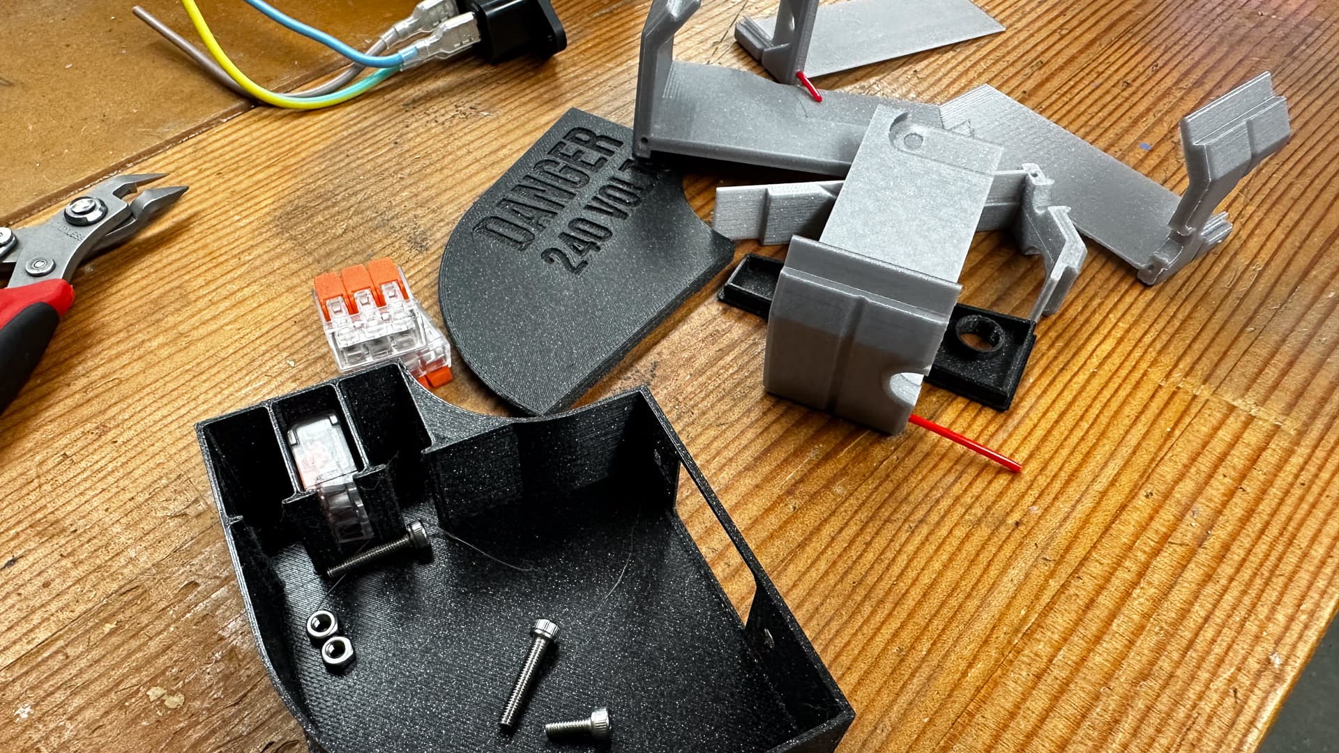

Now that the printer is sorted it’s time to make some final bits.

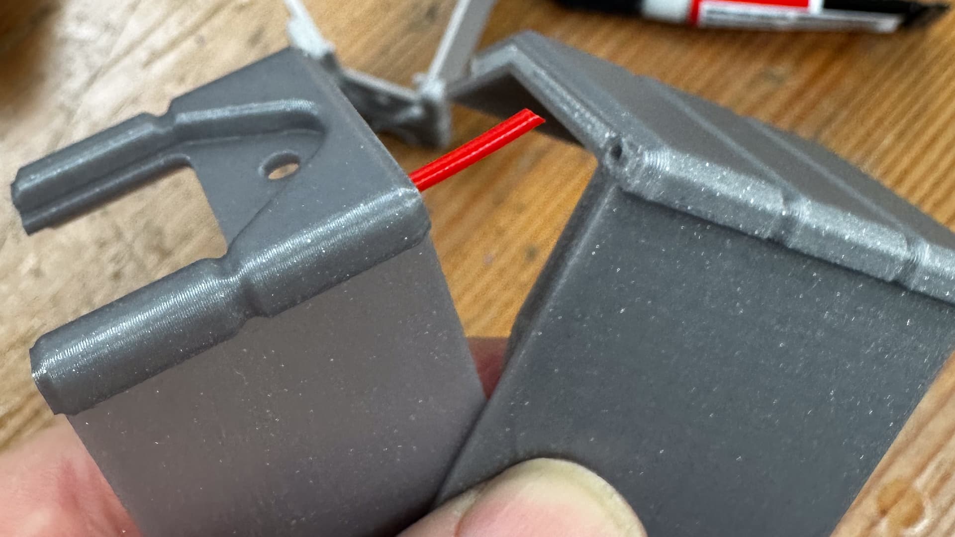

Glueing is made easier with a filament dowel just to hold everything in place.
It’s all pretty much click-to-fit but a dab of superglue on each part before assembly never hurt anyone.
The box sits happily in place and no, this is not the first check fit of the little Wago style connectors.
The wiring probably doesn’t need to be tidier than this. I’ve put a zip tie on the power leads so they can’t be pulled out easily.
It looks as though it was meant to be there I think.
When it’s all done, the lid snaps on - it is removable but it’s a nice tight fit so I’ll just leave it in place till I know I’ve finished.

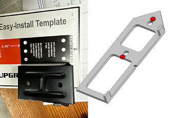

When you open a box of things that have to be screwed to something, always check the “easy install template” just in case it’s going to cause a bit of bother… in this case it actually bears no resemblance to the mounting brackets for the casters! :smiling_face_with_tear:

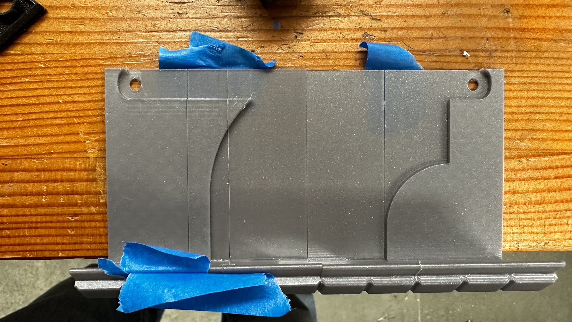

I’ve got twelve of these things to mount, in semi-accessible places, and if they aren’t spot-on the tables will be pigs to move. I’d normally print a quick jig to make life easy. A hole in a piece of cardboard just won’t hold my drill bit in the right place twelve times.
Since I also have to centre these holes on the legs, I’ve added a couple of pins and a notch to make marking centre easy. On my machine it’s a 30 minute print and these templates are a nice way of using up all the stray bits of filament too.
Oh - the red dots are where the “easy install template” suggests I should be drilling holes.
