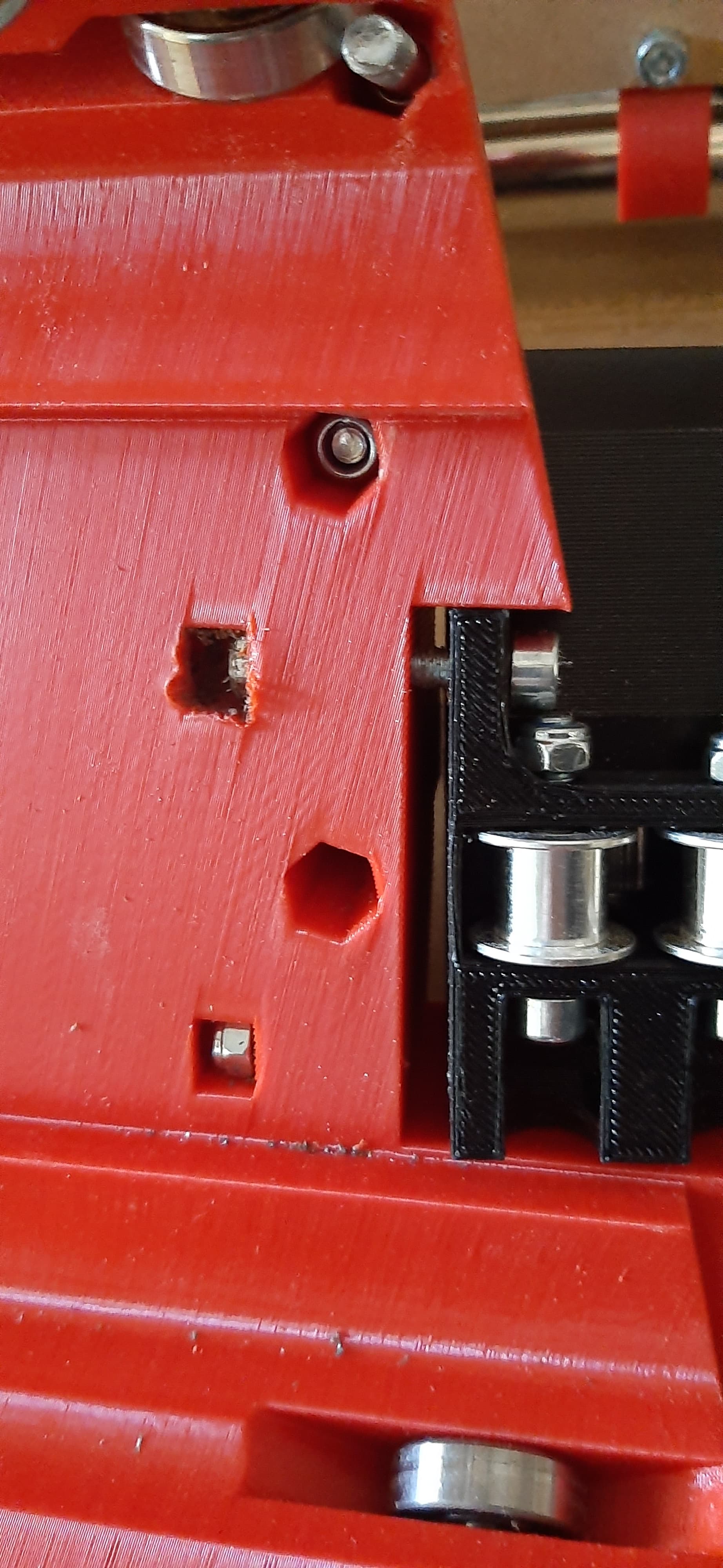

Hi all, didn’t have enough time to continue, but yesterday tried to push things forward and accidentally pushed core from the table :grimacing:
X drive snapped and I had to print it again. I did that but today when installing it core nut holder broke and I can’t fix it properly or even back off…
Do you have any tricks to work with this situation?
You can jam a flathead screwdriver next to the nut to keep it from spinning.
I hate when something small is stirring shit so badly :frowning:
I have to reprint whole core.
Anyway, thanks for a tip Jeffeb3 - it would work if the screw was not rounded already :confused:
I think I really need something to recycle prints into filament… MPRecycler? :wink:
There are a couple of things I’ve done to get screws out like that.
  1. Heat. The core is thermoplastic after all, and a bit of heat can melt the broken plastic around the nut and resolidify the way the nut is held, allowing you to back out the nut.
  2. Baking soda and CA glue. This makes a pretty solid mix, which can also hold the nut. It might also try to hold the screw threads though, so it’s tricky, and more difficult if you’re planning to discard the primted part.
  3. As mentioned, a flat screwdriver.
Me, I’d use heat. An old soldering iron, or heat gun, and maybe some stray filament melted into the opening.
Hi Dan, thank you! I have already made a decision to print core again, but your tips are great if this will happen to me ever again. I would try them, but simply while trying to fix this I made screw head rounded inside as well as nut rolling in the pocket… I tried to cut line in the screw head with grinder to put flat screwdriver there to be able to spin, but I do not have grinder small enough, so it was starting to touch stepper… I don’t think it is worth my time - I’d rather waste printer’s time then mine :wink:

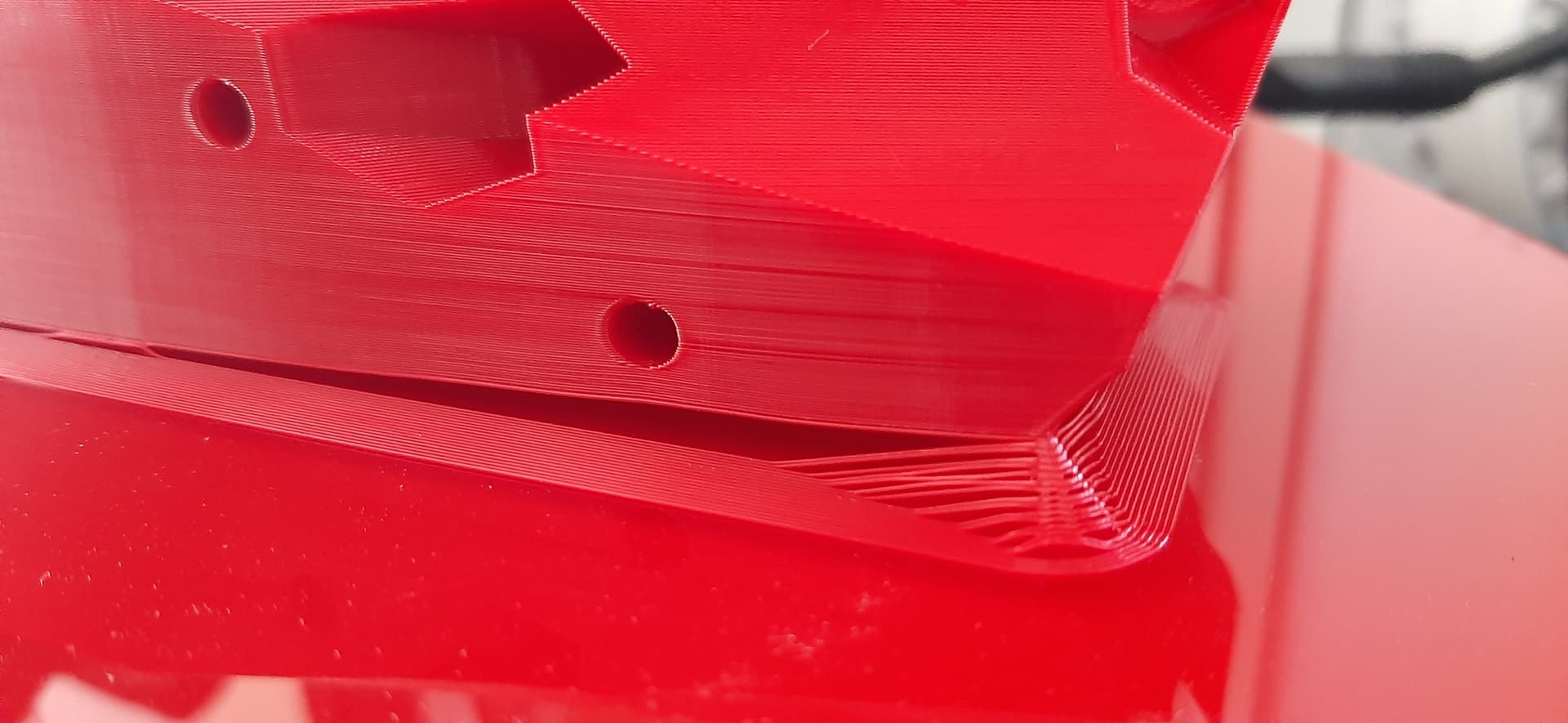

Argh! Warping! Should I start again with raft or this will do you think?
Question: Can I put one of the sides of LowRider a bit higher then the other? I plan to add flat aluminium bar under the non-rail side, for flatness reasons. 2-3 mm higher then rail side. Or should I take the rail side higher as well? Maybe just correcting with endstop arm will suffice? Or on firmwere level?
And in other news I reprinted whole core after this warping issue, added raft and it printed better then the previous one, so I’m happy :slight_smile:
