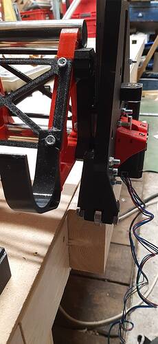

I could not continue because my screws to attach linear rails to side plate are too big and they block movement of the trolley.
if you can see anything wrong please say now or forever hold your peace.
There we go! Just lead screws missing.
We came up with some original solutions, community didn’t see coming. The use of stickers, and crumbled biscuits (on the right side of the photo).
Please do not mention oversized linear rails - they will become useful or cut.

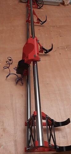

My table is too short or my pipes are too long! Arghh!!!
I can add Doug-Style rail on the side and it will fix the width problem I hope… How did this happen?!
Anyway…
Is my rail placed ok(ish)? Or should I push it even further on the edge?
Print the rail clips, clip them to the rail and push it to the border of the table. That should net you enough space. The rail can definitely be moved as much as needed.
Do you mean placement like below? If yes, should I add something to attach belt to?
I have definitely changed my initial measurements in “it will be fiiiiiineeeee” way! “Few cm more will not hurt”! “I’ll add just a bit!”… Argh! I did that for pipes (they are 150cm, while calculator says 143cm), but didn’t do that for the table… table is 158cm. Silly me!
