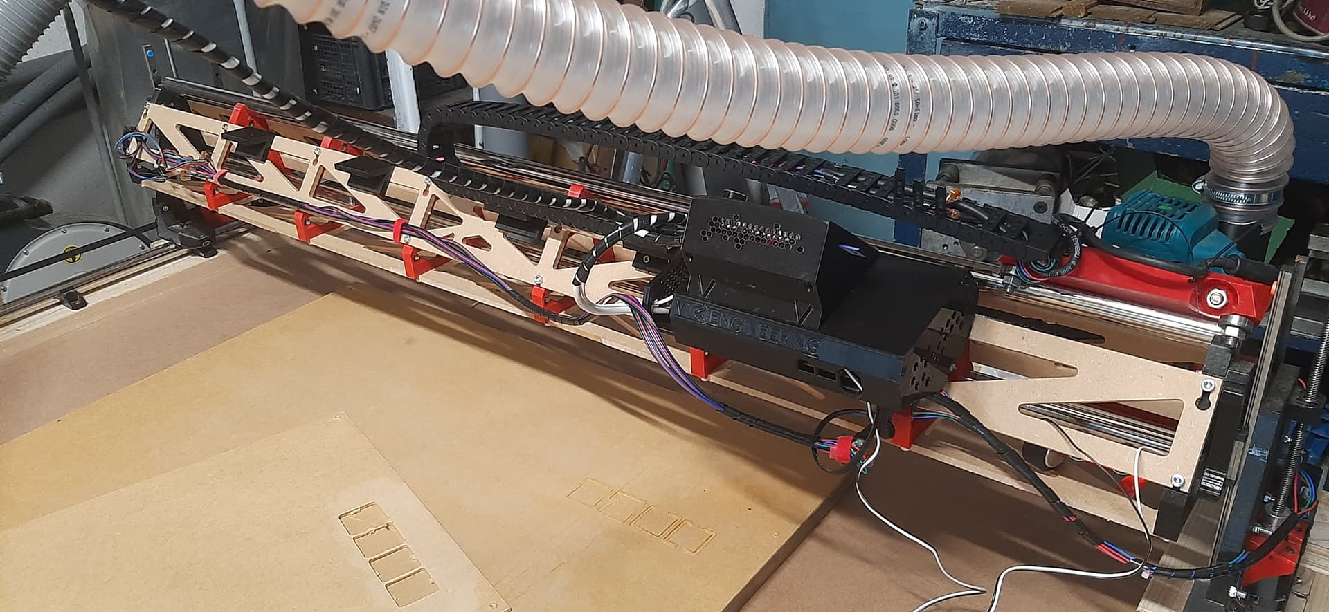

And why do you think it’s not great idea to put aluminium bar for lowrider to ride on?
My thinking behind this is: I can’t get mdf/plywood long enough (3m) to use at ends of table and I don’t want to have a “bump” when connecting two pieces of anything.
I could use lumber but this seems like worse idea then aluminium.

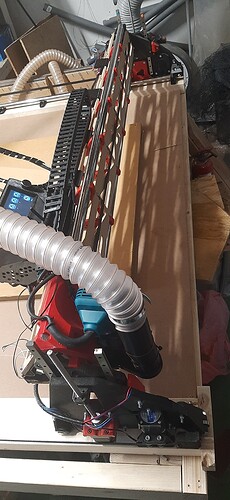

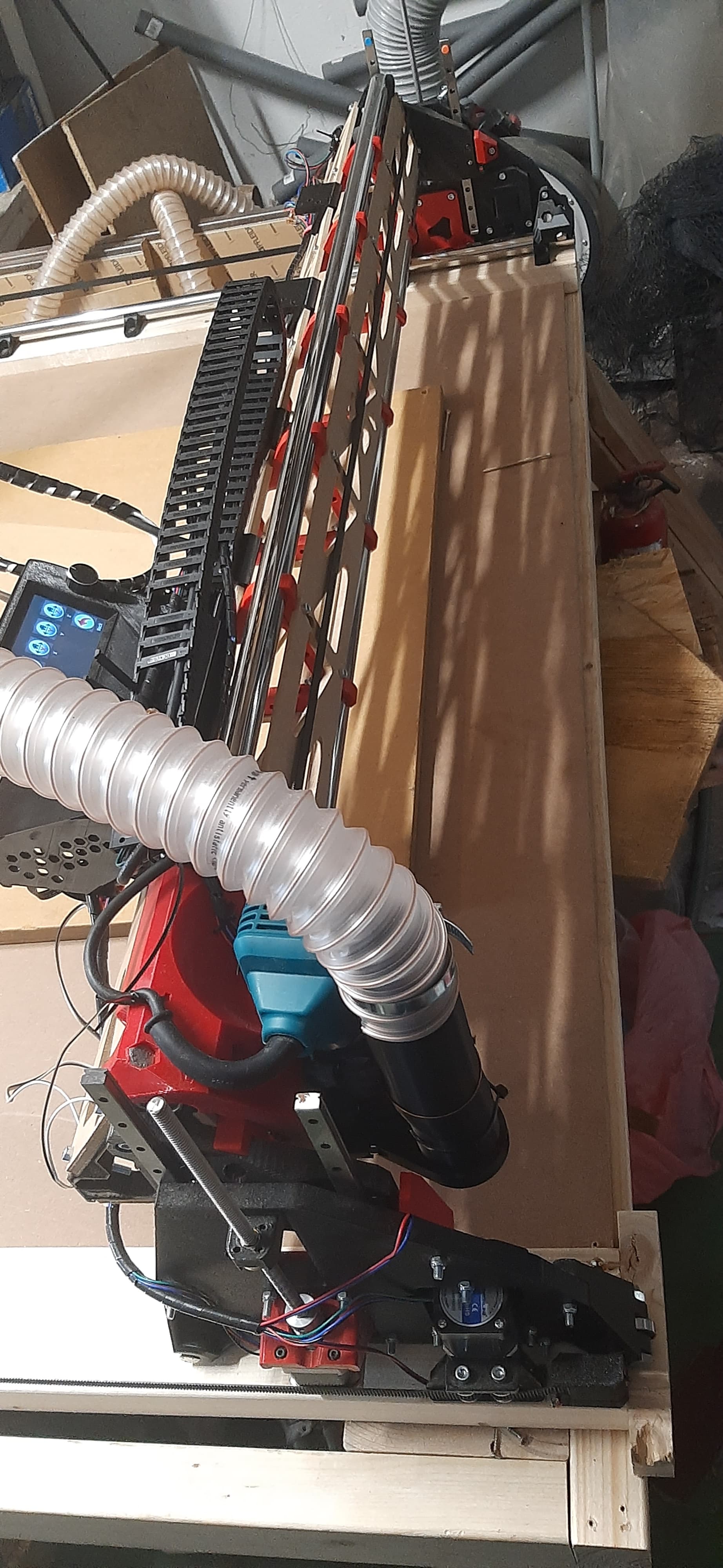

Hi everyone! Last month was not very eventful in terms of LowRider. Work is to blame! I slowly recover and find more time to do stuff. So I managed to actually finish the build - I mean I installed struts and put everything back together. Table is finished as well. I connected my dust collection/router through fan0 on SKR and this works great.
I connected Z-probe and tried it once, but when it touched the probe it looked like SKR’s reset itself? Why can that be? I mean, steppers lost power for brief period and screen went black for second or two.
I suspect I have to change places of wires going from the probe into controller board… could that be it?
Z-probe is working as expected now! Getting close! :smiley:
It is annoying there is no way to run gcode snippets from touch screen. Or is there?
