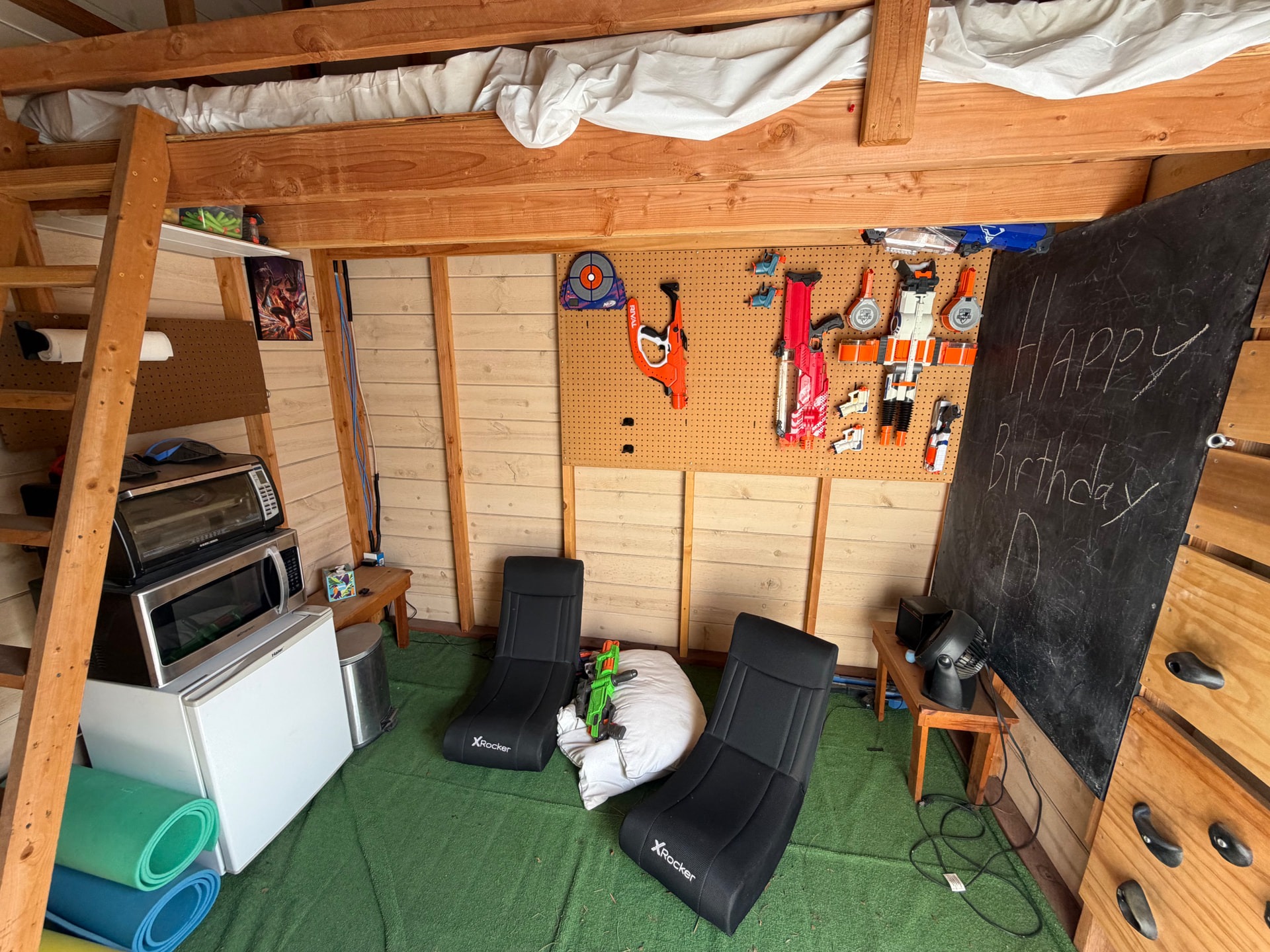

Okay, sounds good. This is the area I am going to put it, which is why it needs to be able to fold up. I’ll clean the place out, set it up either on the floor or on some sawhorses, and I’ll go from there.
I have a class during which I can work on designing something like the table, I will work on the CAD during the week.
