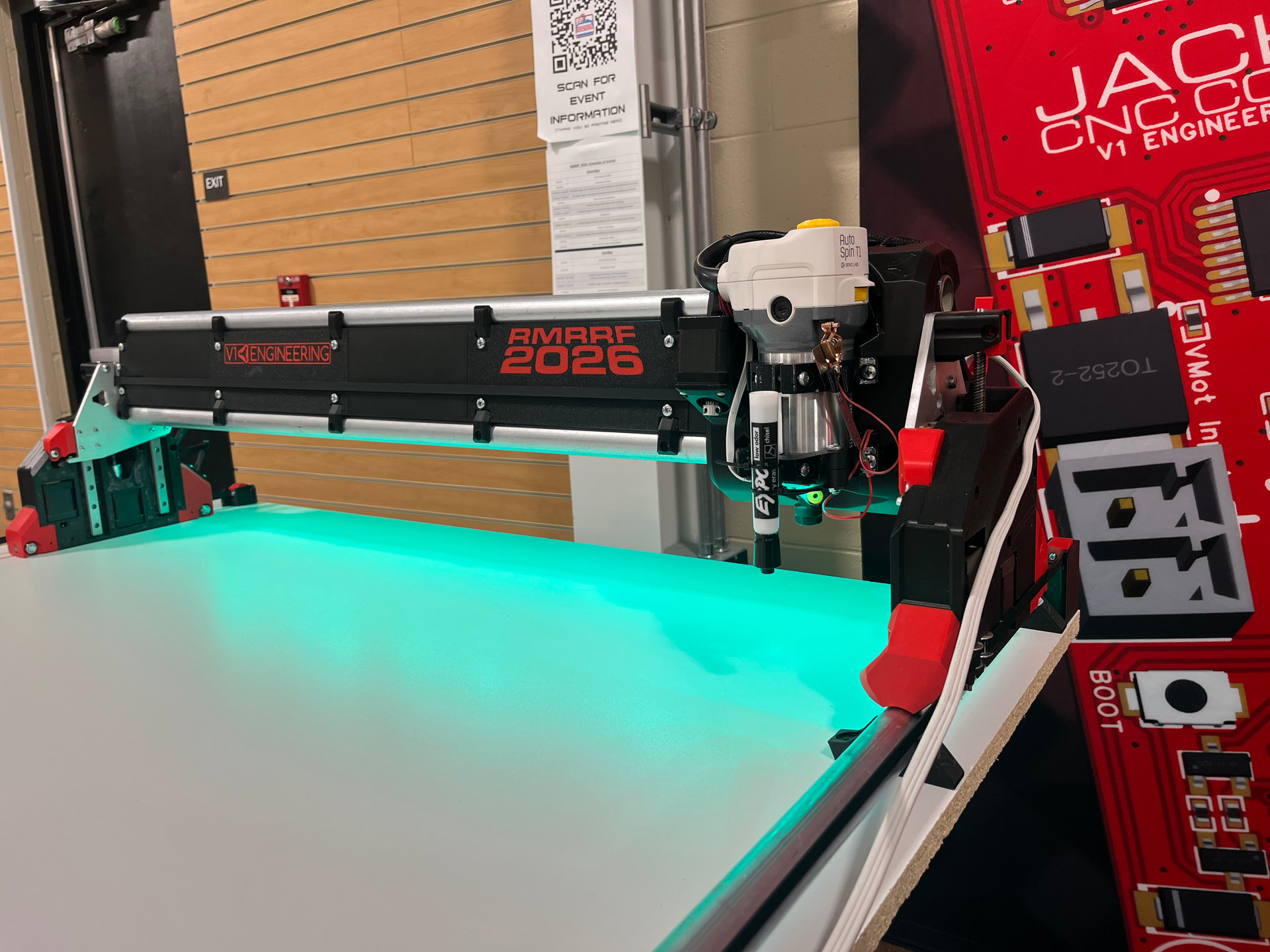

If I can get a filament company like polymaker to sponsor it, I will re-print all of the parts in the recommended high-temp material. However, seeing as all of the parts were given to me pre-printed, I think I will stick with what I have for now. Also, is it okay to leave the plastic strut plates that were there from RMRRF? I like the design and want to leave it as sort of a memento, unless it would lower the performance, in which case I’ll screw it into the wall above the cnc or something
Those are temporary strut plates. Use them to cut out the permanent struts and then hang them on the wall. :oncoming_fist:
Read through these docs to learn more about the LR4 and how to make your permanent strut plates. I can tell by your enthusiasm that you are going to love your new CNC.
Sounds good! I’ve skimmed through those docs once or twice already, and taken a longer look at areas of interest, so I figured it would be better to cnc the plates, figured I’d ask anyway. Maybe I can do some sort of 3D design similar to the 3d printed one on it later on…:thinking:

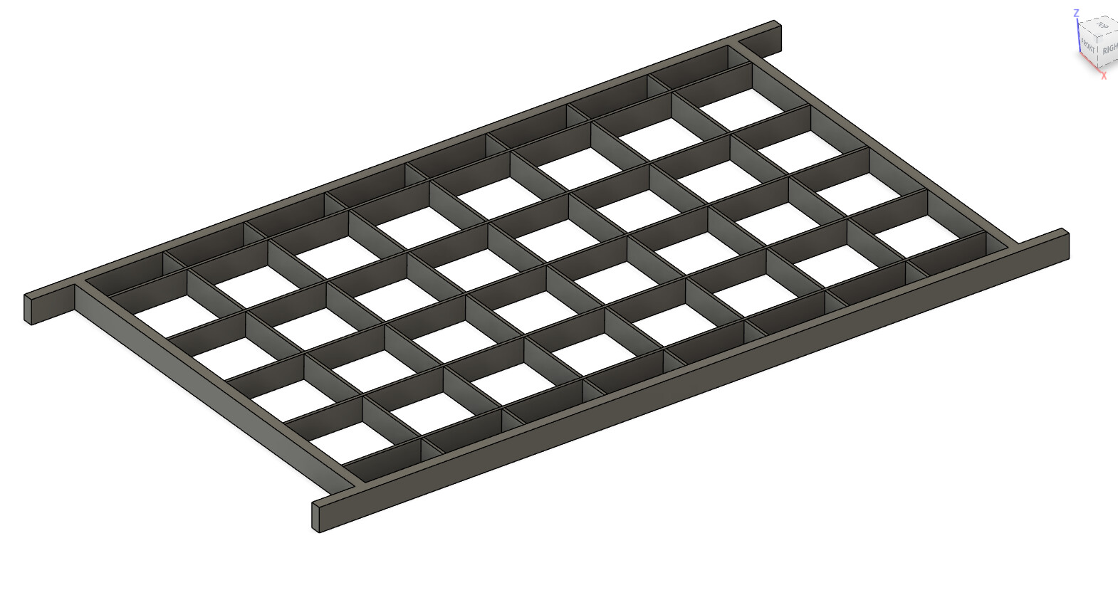

Oh, and I just finished designing the basic frame of my table (I hid the top and bottom boards) and made it fully parametric (hopefully nothing breaks lol). The boards slot together and are designed to be cnc’d out of 7/16”OSB with a plywood top plate, an MDF spoilboard, and an OSB bottom plate. It is also going to have a 2x4 frame since I am going to be folding the whole thing up against the wall, currently working on that design as well.
No, those are more than adequate for now.
They are not the standard temp strut plates, they are interlocking printed full span.
If you want to change the width of the beam, then you should reassemble with the printed temp strut plates and use the generator to create a new SVG, then do as Brit says to cut a new strut plate.
Not many noticed it, but the RMRRF strut plates are multi-color , interlocking parts.
A little Easter egg from Ryan almost no one saw up till it’s now revealed.
Take another close look:
Maybe if you ask Ryan , he could customize one of the interlocking parts if you go to a different beam width.
Okay, that is what I noticed and knew it was different from the normal ones, which led me to ask, and is why I really like them and wanted to keep them.
