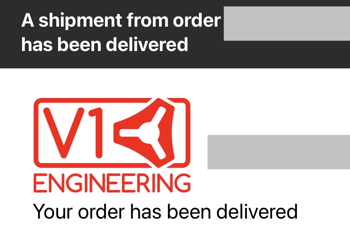

It’s here!

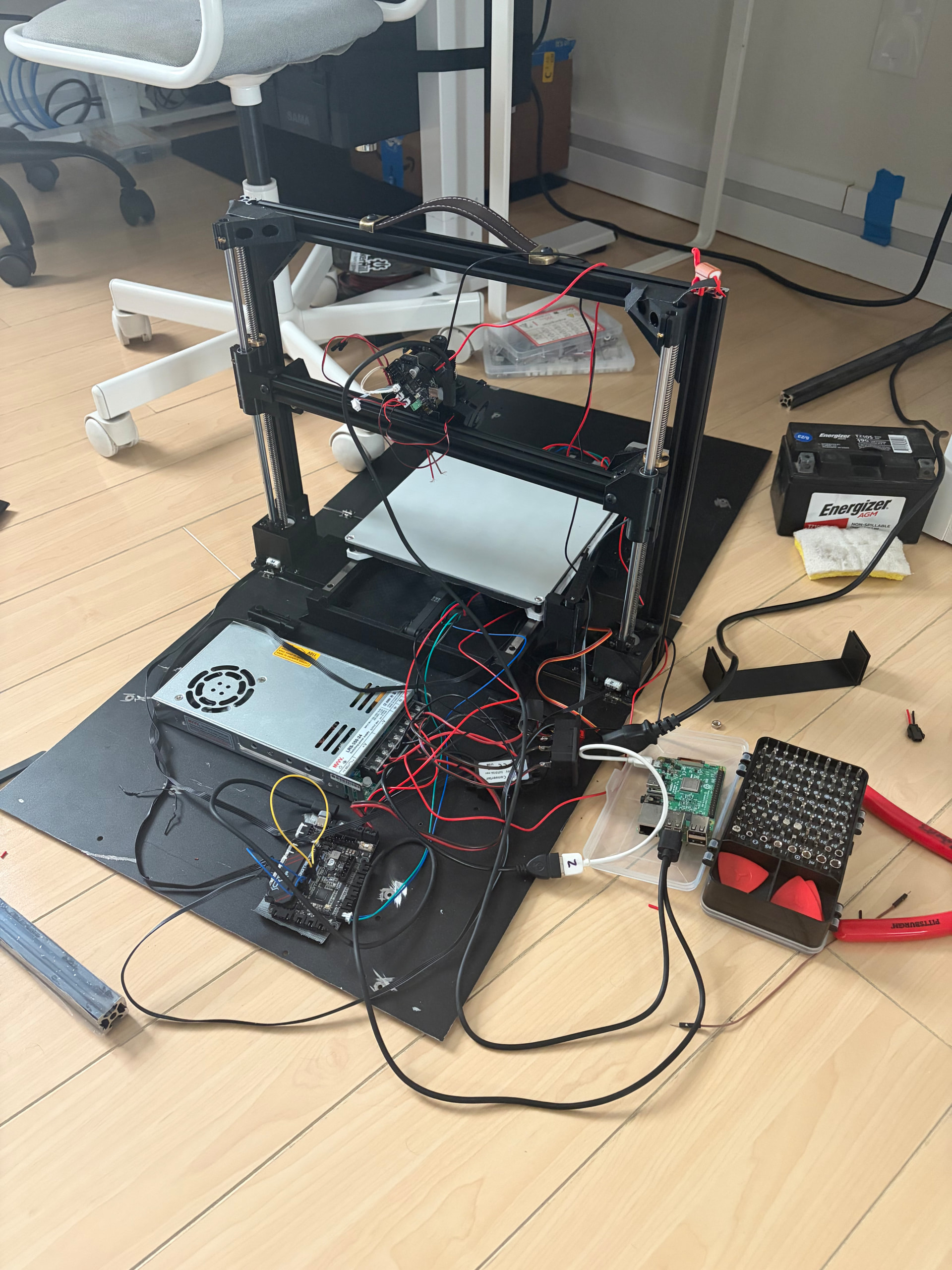

I haven’t been able to really start on the cnc build yet, here’s why. The way I got out to RMRRF is through hack club, and I have to get the 3d printer I designed to print a benchy in order for it to be considered “complete” so I can get reimbursed for the plane ticket. Therefore, my parents won’t let me start a new project (cnc) until the printer is wrapped up. I’m getting close and hoping I can get started on the cnc this upcoming weekend. In case anyone is wondering, here’s what the printer looks like. Working on getting the toolhead board to talk to the pi and then I should be good
