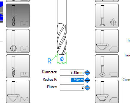

OMG!!! How did I not know this? ESTLCAM will auto figure out the radius for a full round. I have a 1/8 bull nose and I was setting it up but didn’t want to math. So I typed 2 for the radius which is impossible. It autocorrected. I can type 1.58 or anything smaller. But anything bigger half the diameter it knows to cut you off. So just hit a random number on the keyboard like 9 and let it do the rest.
Super cool tip! I didn’t know that either.
I was entering a tool that I know in imperial numbers and didn’t want to have to convert. I don’t even know what i was thinking when I hit 2. But it worked and I was so excited that my wife knew in the other room.

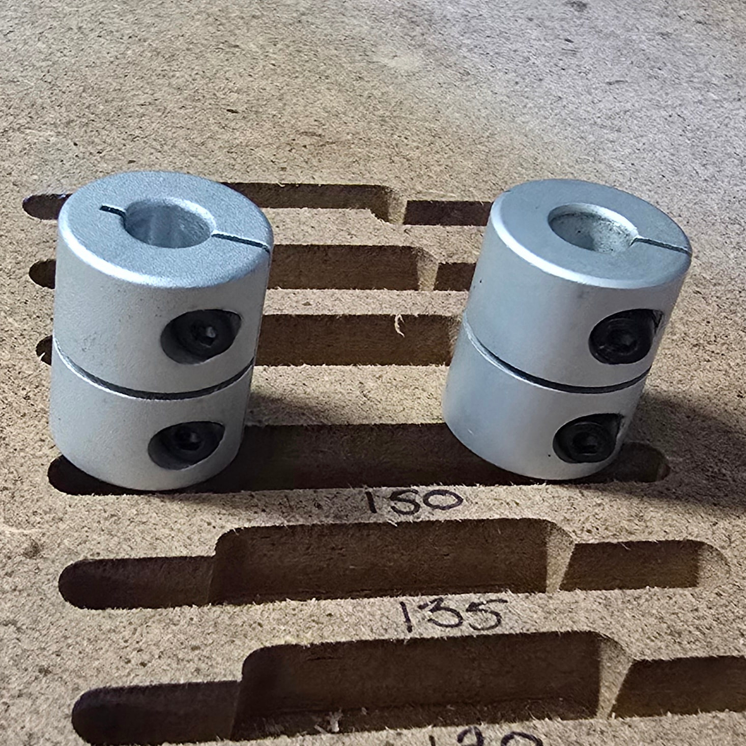

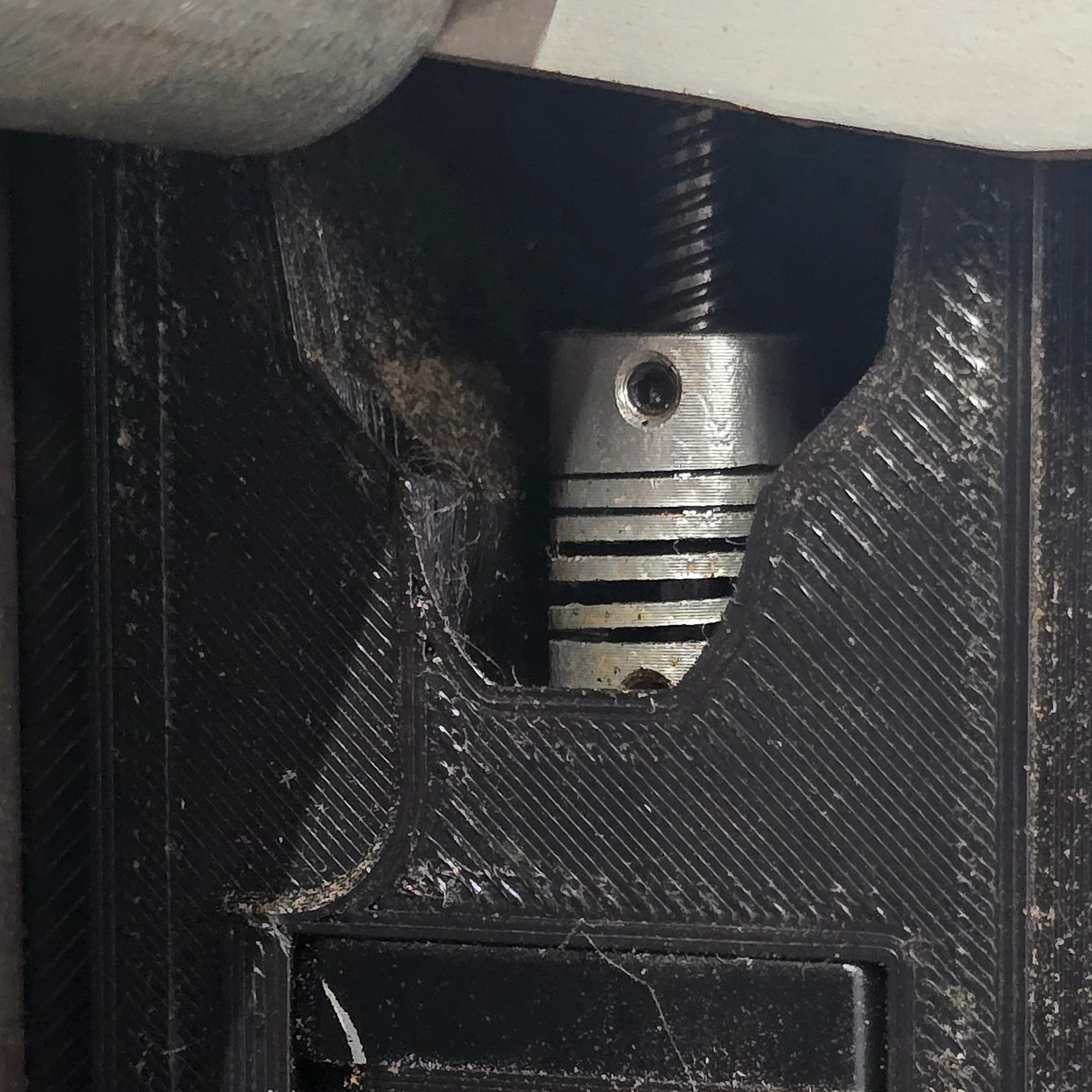

Found an issue with my z axis on the rail side. When I was having issues originally with the z endstop, it must have stretched the coupler. I can’t really get a good picture. But I was redoing my leveling and couldn’t figure out why one side was over 2mm off. Pulloff is 6.373 which seems high especially when you figure it’s eating my already smaller z travel.
I did manage to get a decent picture.
My test fix for now since this side is higher and the coupler is stretched, it’s to loosen the grub screws and insert the shaft further down. If that brings the two sides closer together, then I know it’s the coupler and I can get it’s replacement ordered. Not sure how i don’t have any of these kicking around but the only thing I have is this style
And I forget why, but I was told a long time ago that these are going to cause problems.
Just slide it down further until the leadscrew touches the motor shaft. It is not a big deal.
That is what I am testing out. Hopefully it fixes it. Honestly I have my Z back up over 100mm from the previous 87ish. It is me being overly picky at this point. But if I can get it to not need to pull so far back down, then I will gain that travel back in the down direction. The drop in my table will be more useful once the machine moves its full height.

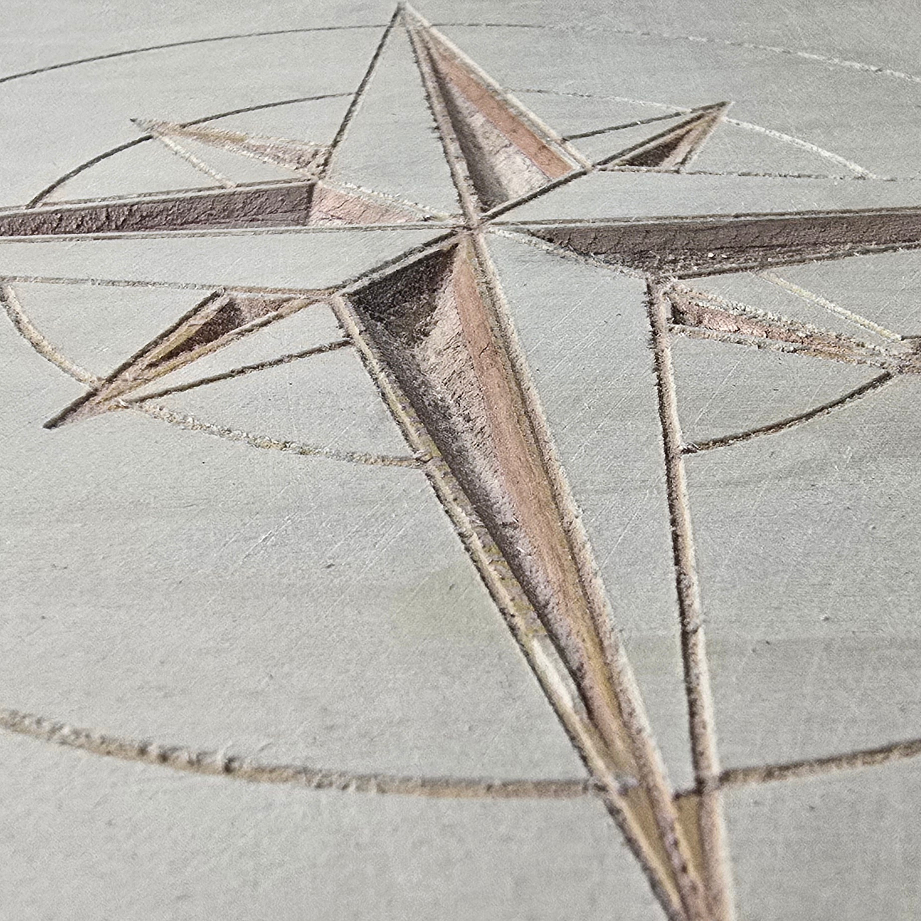

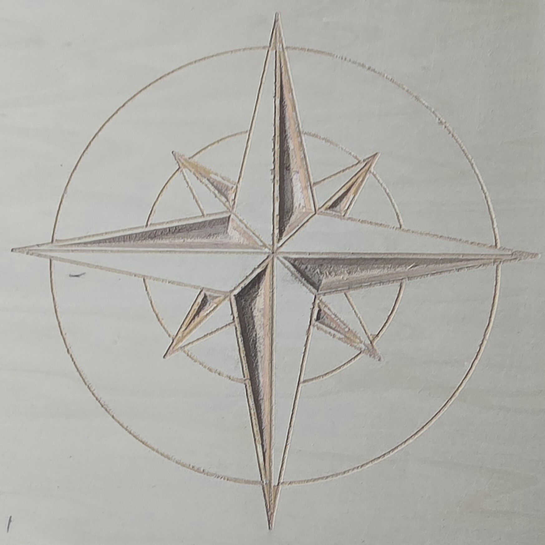

I stopped messing with the z to go help my niece move. But I did get a change to take my first ever Crack at an artsy carving type thing instead of cutting parts. This of on some cheap lowes ply with terrible veneer but it was a test. As such, I give it a 7 or of 10.
The next one should be better
You mean a perfect 5/7? :grinning_face_with_smiling_eyes::face_savoring_food:

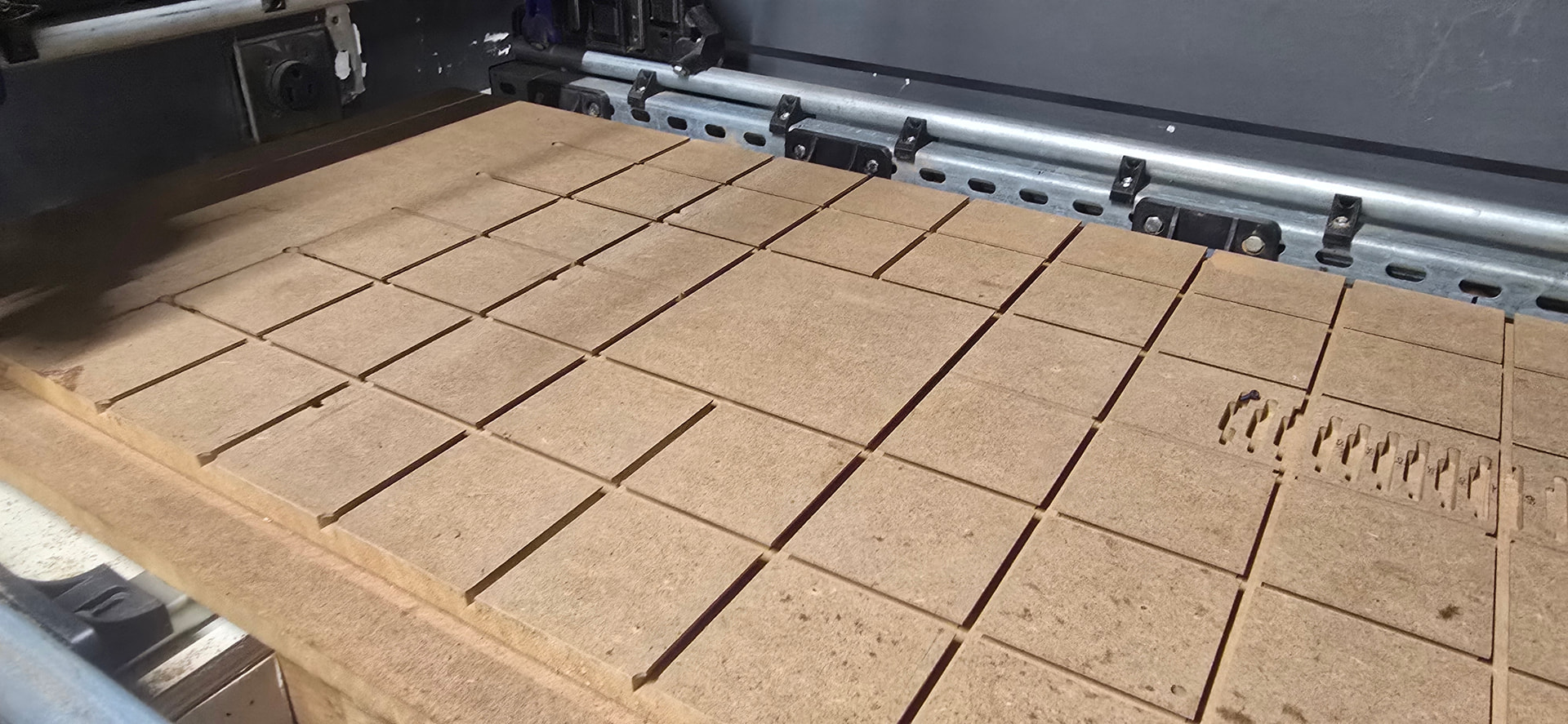

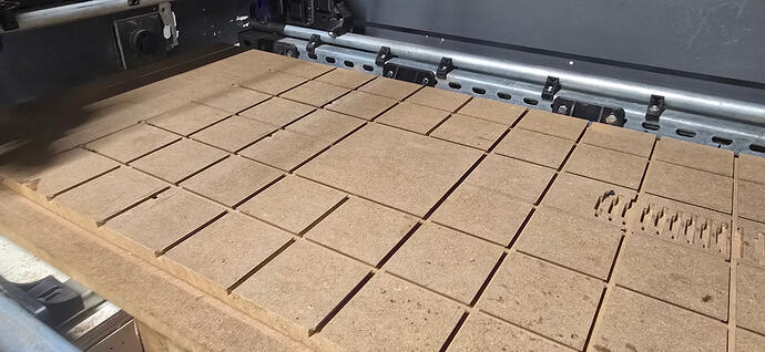

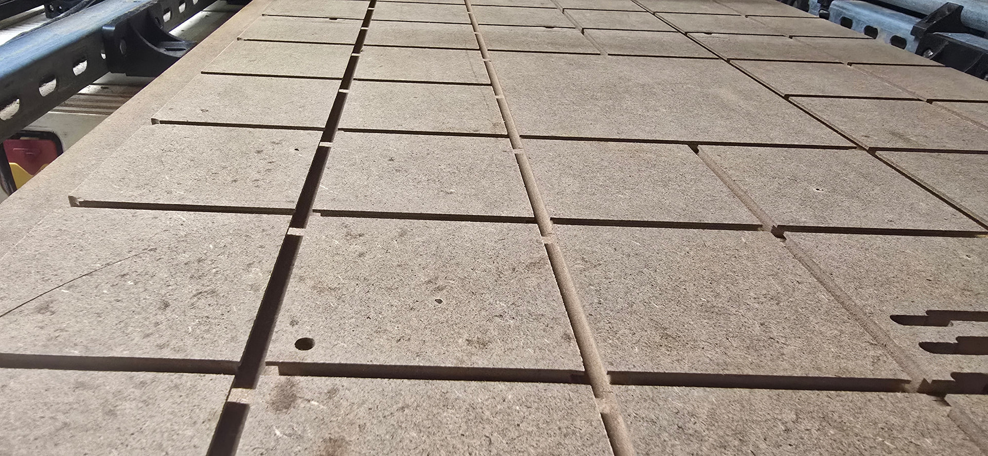

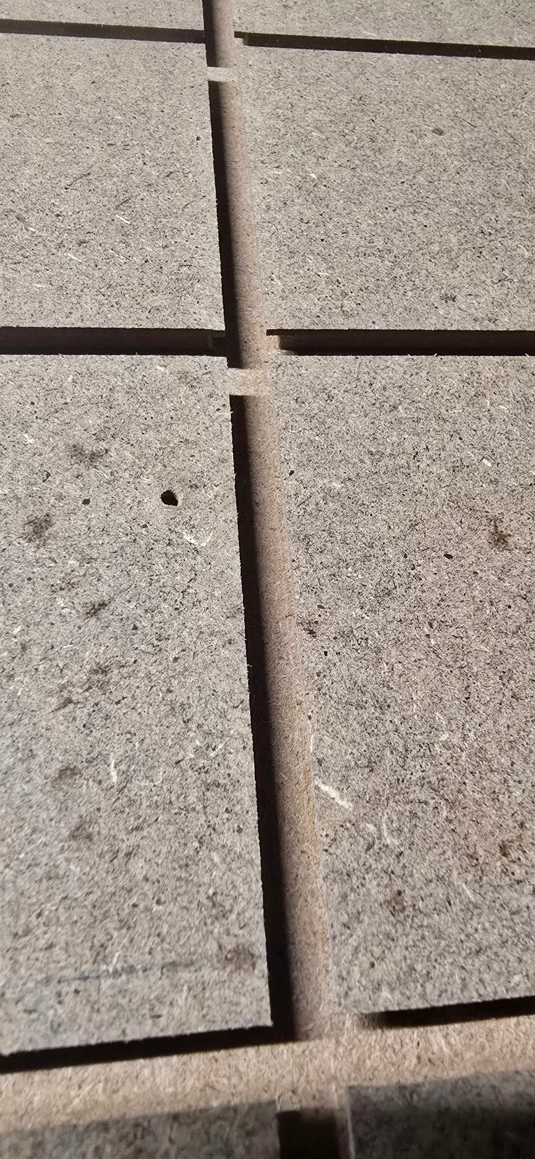

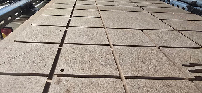

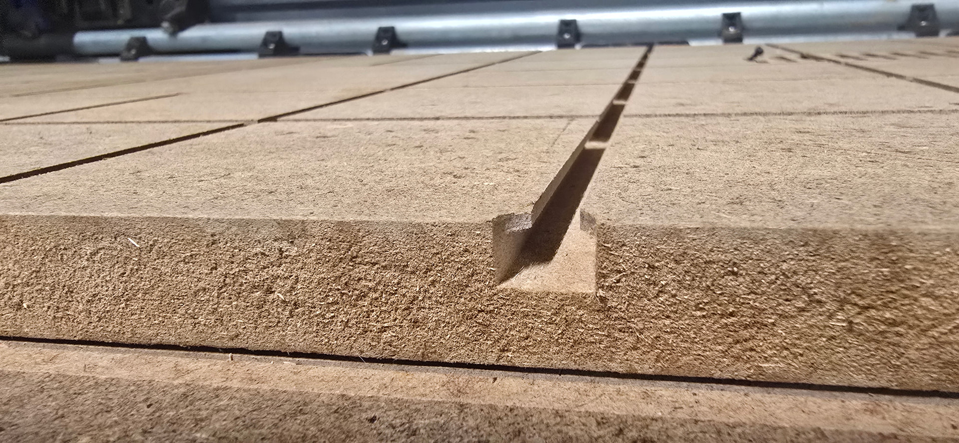

Been tweaking the z a little bit more, but started running tests on my top spoilboard which is going to be replaced soon. I wanted to see how well I could run a 2flute compression bit i have, and a set of t track cutters i have run on the handheld with good success.
Looking at the bottoms and the edges, I’m pretty pleased.
We need an hour meter on these things for cut time. You have put in a good chunk of time pretty quick! That hold down system had to take some time.
I assure you that I have way less time than most. That grid was about 40ish minutes I think. Maybe less. Most of the time last night was me fighting with the start, end, tool change gcode on MM. It’s still not right. But it’s workable.
I’d be very careful to trust MDF clamping stuff down using those chanels, it often comes apart easily in this direction of force.
this was just a test of that bit in the CNC. Im replacing that top spoilboard so I was playing around with it a bit.
