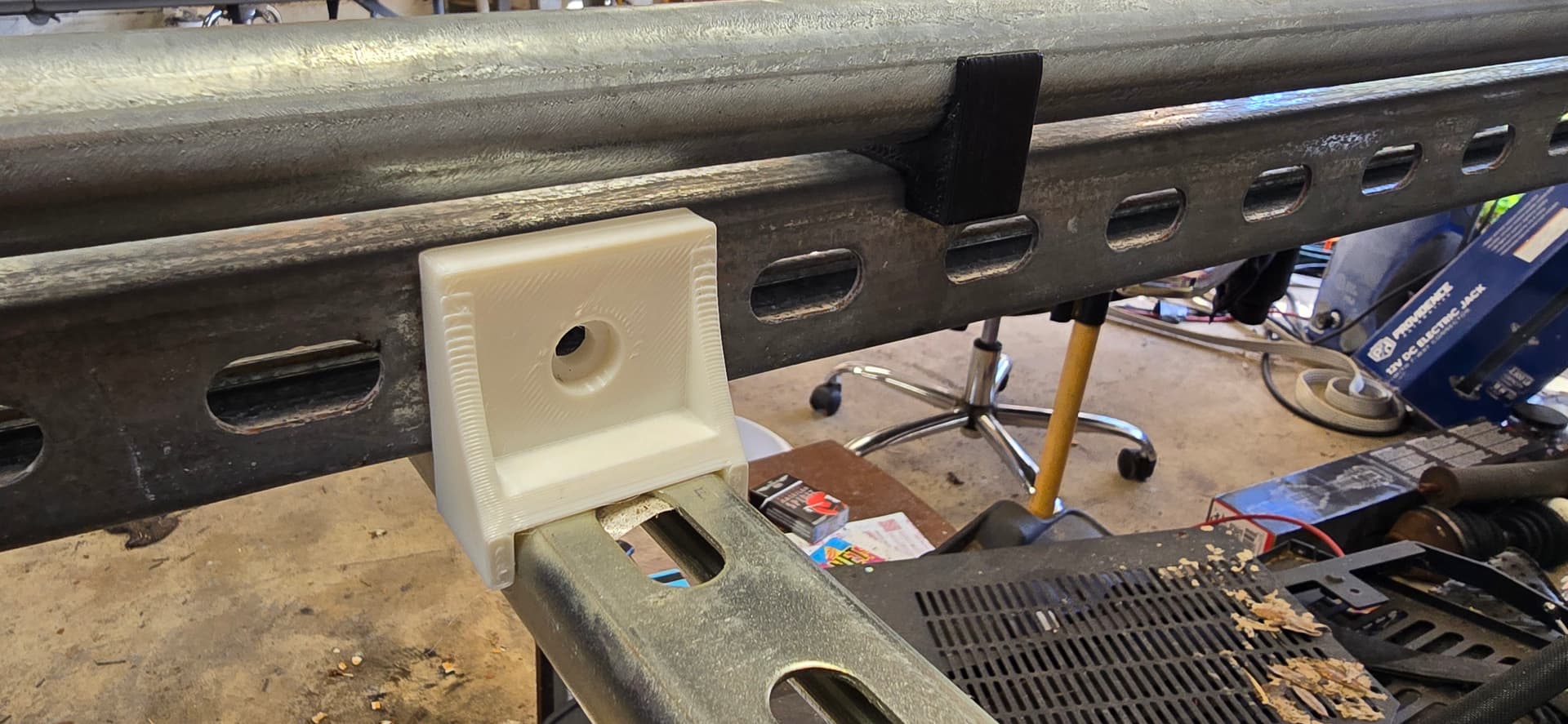

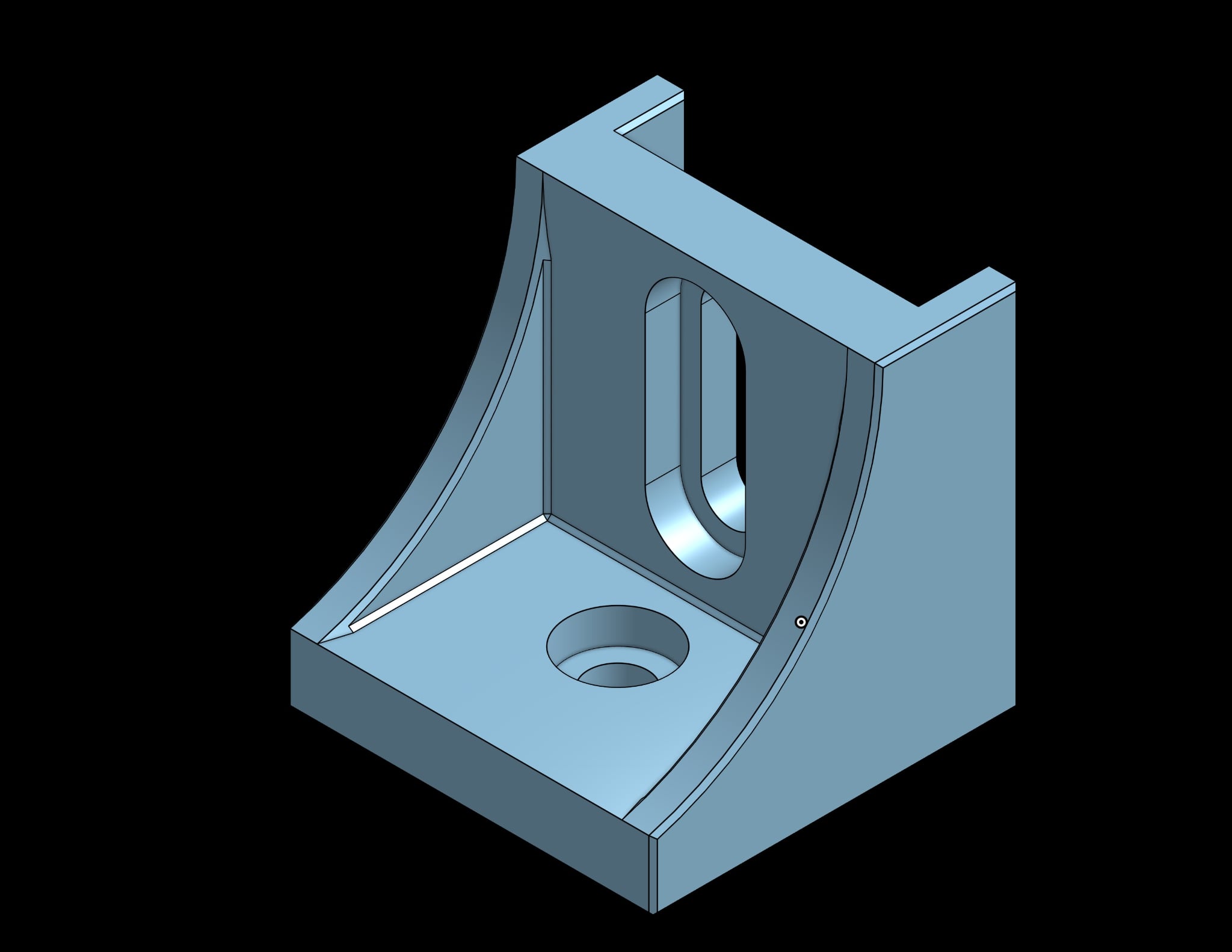

The standard LR4 relies on printed triangular strut braces connected by front and bottom strut plates.
Those plates are more important than they first appear. Together with the braces they create a deep structural section that resists gantry twist.
The EMT tubes provide both the bearing surface for the bearings and part of the structural beam.

I already own a plasma cutter, drill press, welder, and enough 1/8" × 3" steel flat stock to fabricate replacement strut plates.
Rather than asking the CNC to machine replacement parts, I can use my existing MDF strut plates as precision templates.
My fabrication plan is:
  • Cut the steel into two matching blanks.
  • Tack weld them together.
  • Transfer punch the first pair of locating holes.
  • Drill those holes through both plates.
  • Bolt the MDF template to the steel using those holes.
  • Continue transferring and drilling the remaining holes while the template is positively located.
  • Plasma cut the outside profile.
  • Finish to the line with grinders.
  • Separate the finished plates.
The hole locations are the critical dimensions. Everything else can be fit and finished from there.
The outside profile simply needs to provide proper clearance and enough material around the mounting holes.

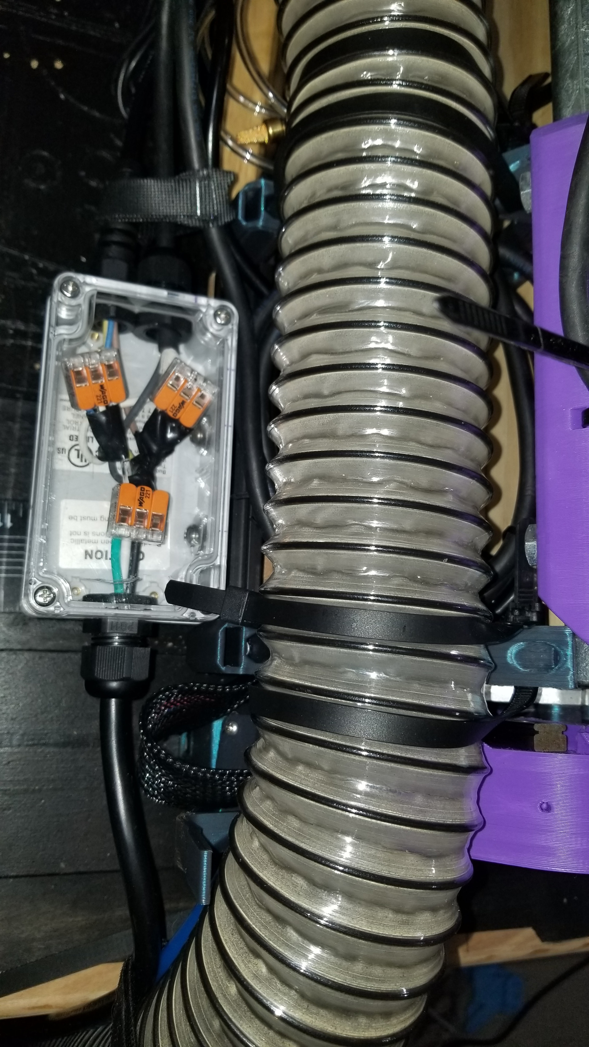

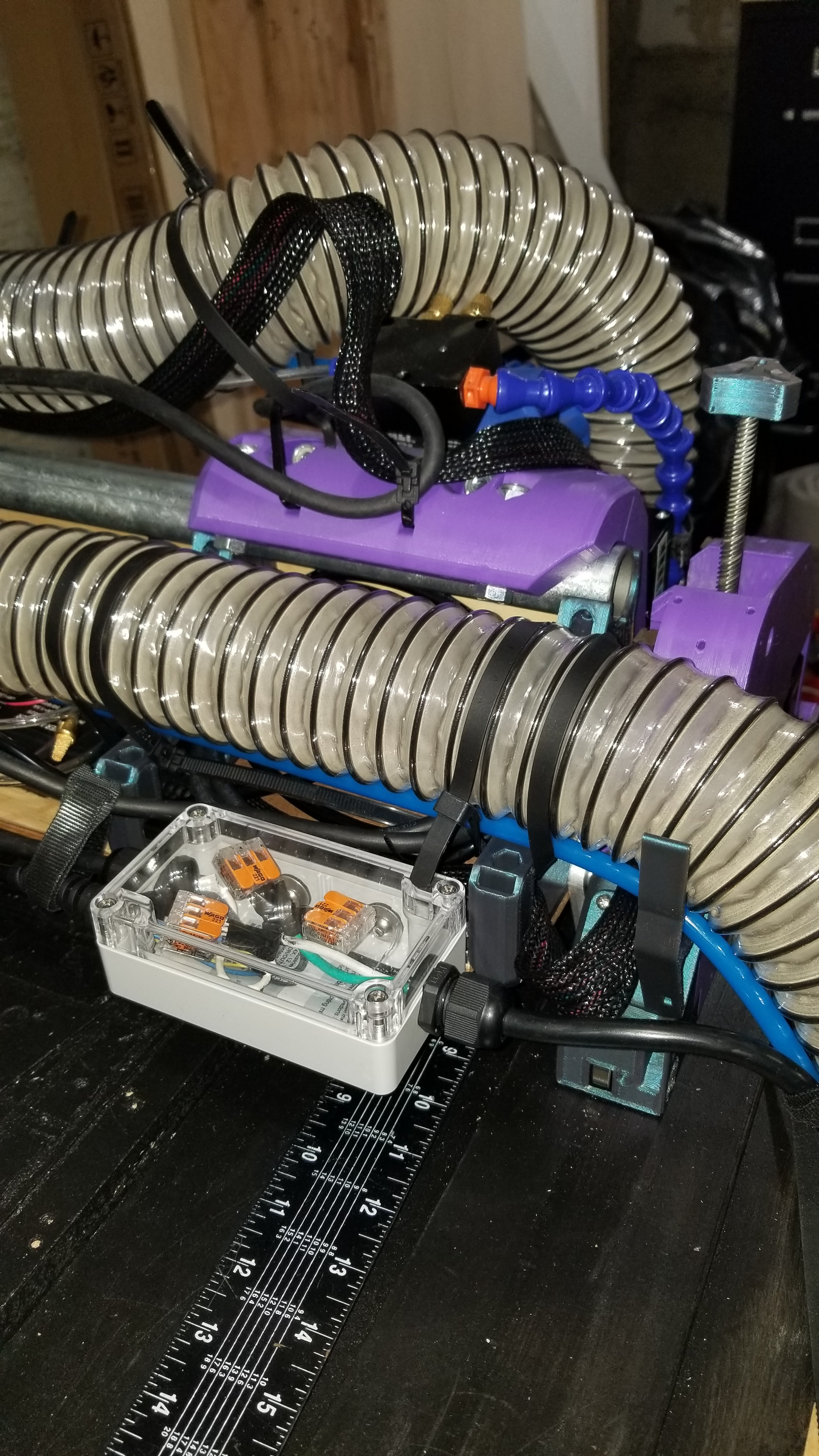

Rob’s suggestion resonated with me. After one too many jobs failing because power cord was yanked (was previously running router and PSU cords to stationary power outlet extension, apparently a few wraps of duct tape wasn’t enough to keep the cord plugged into the outlet).
Ended up less compact, but very functional setup…
Slightly oversized box mounted (with 2020 attached to bottom strut) for future gcode activated relay switched router. But honestly, turning router on/off manually hasn’t frustrated me enough to bother with that.

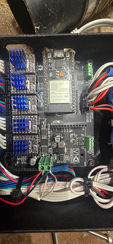

My theory on this was simply to get electronics away from dirt, oil, debris, etc. I haven’t really looked into it too much. But I seem to remember there being a handful of guys running table mounted boxes on the LR3 and that seemed to make a lot of sense to me. I have seen numerous algorithm based ads showing machines costing several thousands, and they all seem to have the control box separate and send these aircraft looking cables through the drag chains. Again, this was a thought and I quickly moved it to the “not right now” category. But the shorter 1/4 sheet machine would make it more feasible than the giant in my garage right now
