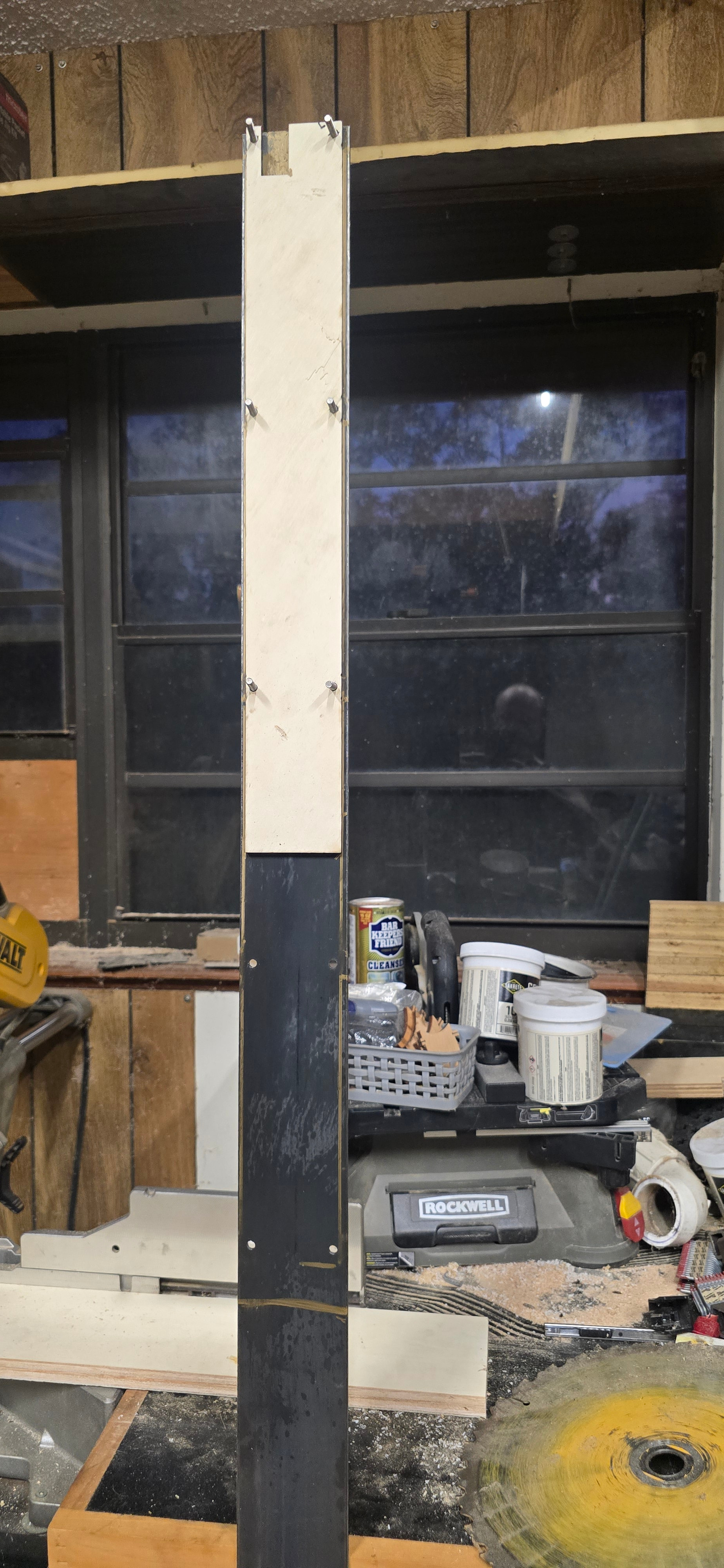

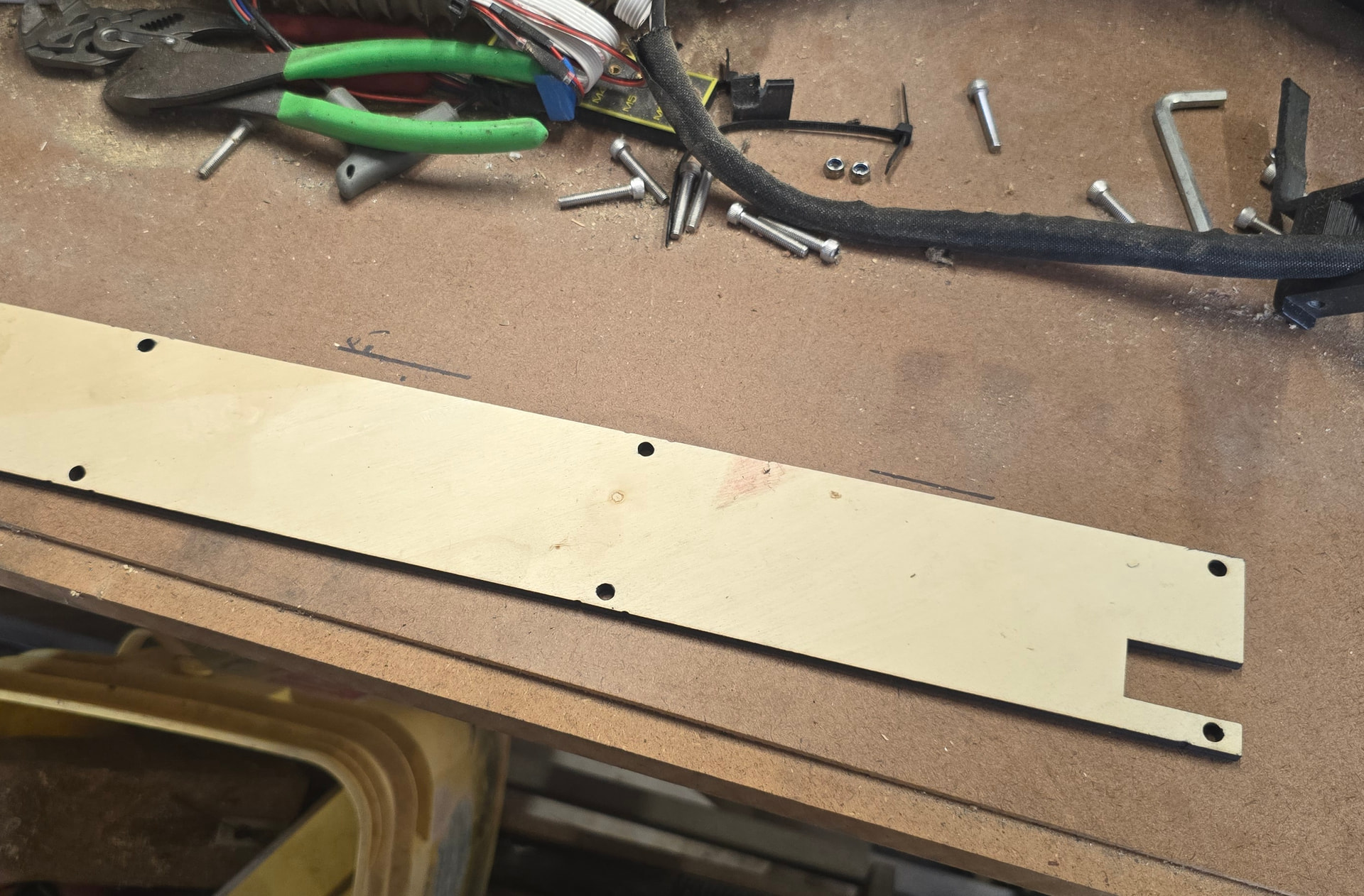

on a whim, I decided to cut section of the new size strut plate on the laser. Glad I did. The holes are not quite the same. I looked at it twice and couldn’t tell why the holes weren’t lining up. Turns out I need the laser version as a template instead of my old strut plates or the holes won’t be evenly spaced. Then i was thinking it would be better to cut two plates with the laser out this ¼” ply and using the machine with a drill bit to make my holes in the new steel plates. 10,000 rpm is the lowest my router goes though, and I’m not sure what my bits will do at that speed, but I know i don’t want to find out. I even thought briefly about how to redneck engineer my plasma cutter torch onto the gantry. But there is so much wrong with that its not even funny. So im back to my original transfer punch idea with the new laser cut section as my guide instead of the old strut plates. I have enough experience with that kind of work that I am fully confident I can do it without any issues.
PSA
THIS IS NOT YELLOW BRICK ROAD STANDARD REQUIREMENTS
I got to mockig up the laser cut section, and then got carried away. I now have all the holes drilled for one of the strut plates. I was referencing holes off each other like beg board and moving my part right along. I completely agree this is not for the general maker who just has a few general tools. That being said, if you have the right tools skills AND experience, it’s not a hard job. Just have to be methodical about it.
There is a note on the build instructions about ti l the tube’s not going past the last strut braces. Then troubleshooting here on the forum, that comes up a lot as well.

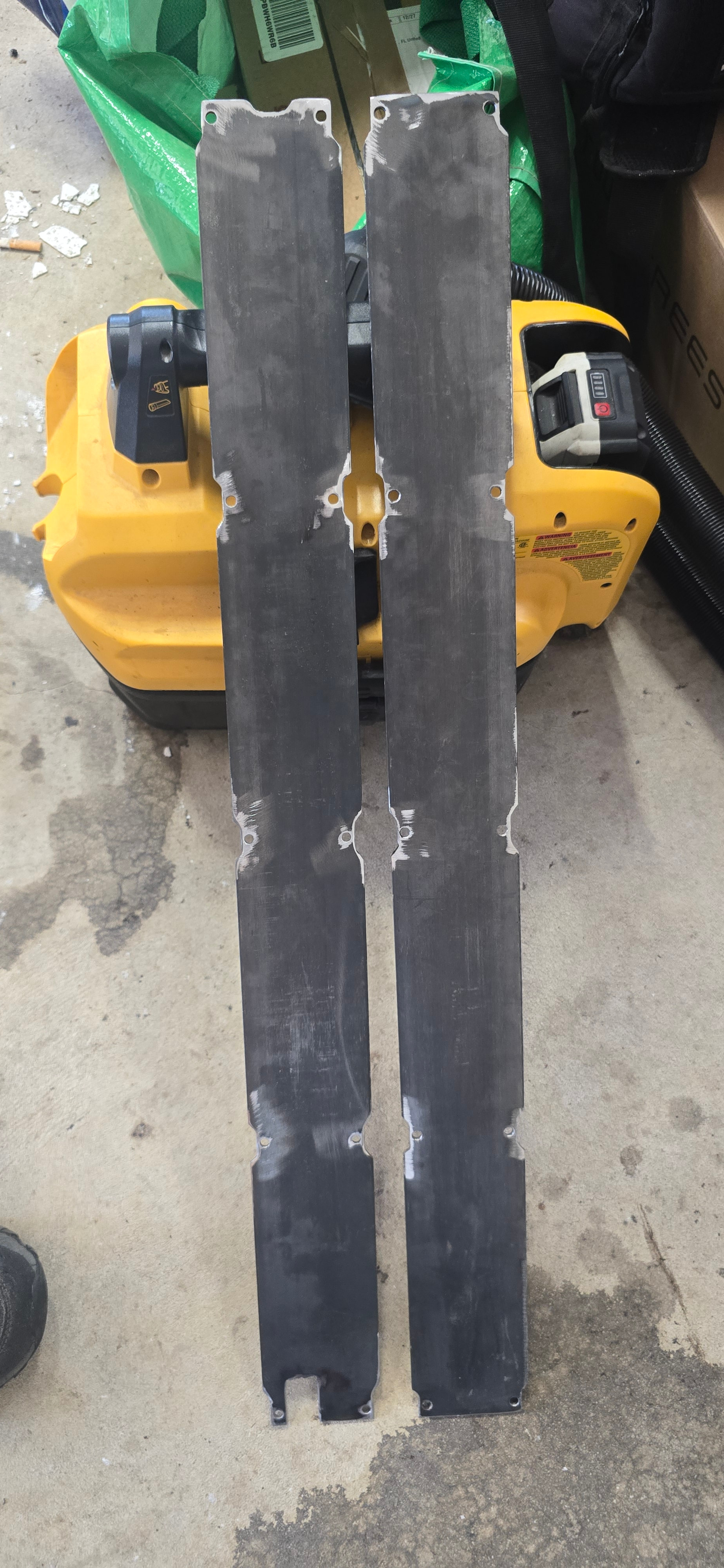

I had it in my head that I’d eventually replace the MDF painted in tightbond on one of my LR4s with some aluminum strut plates. That was until I put together a fully printed beam with printed strut plates in segments and additional braces instead of interlocking plate segments. That beam is really stout.

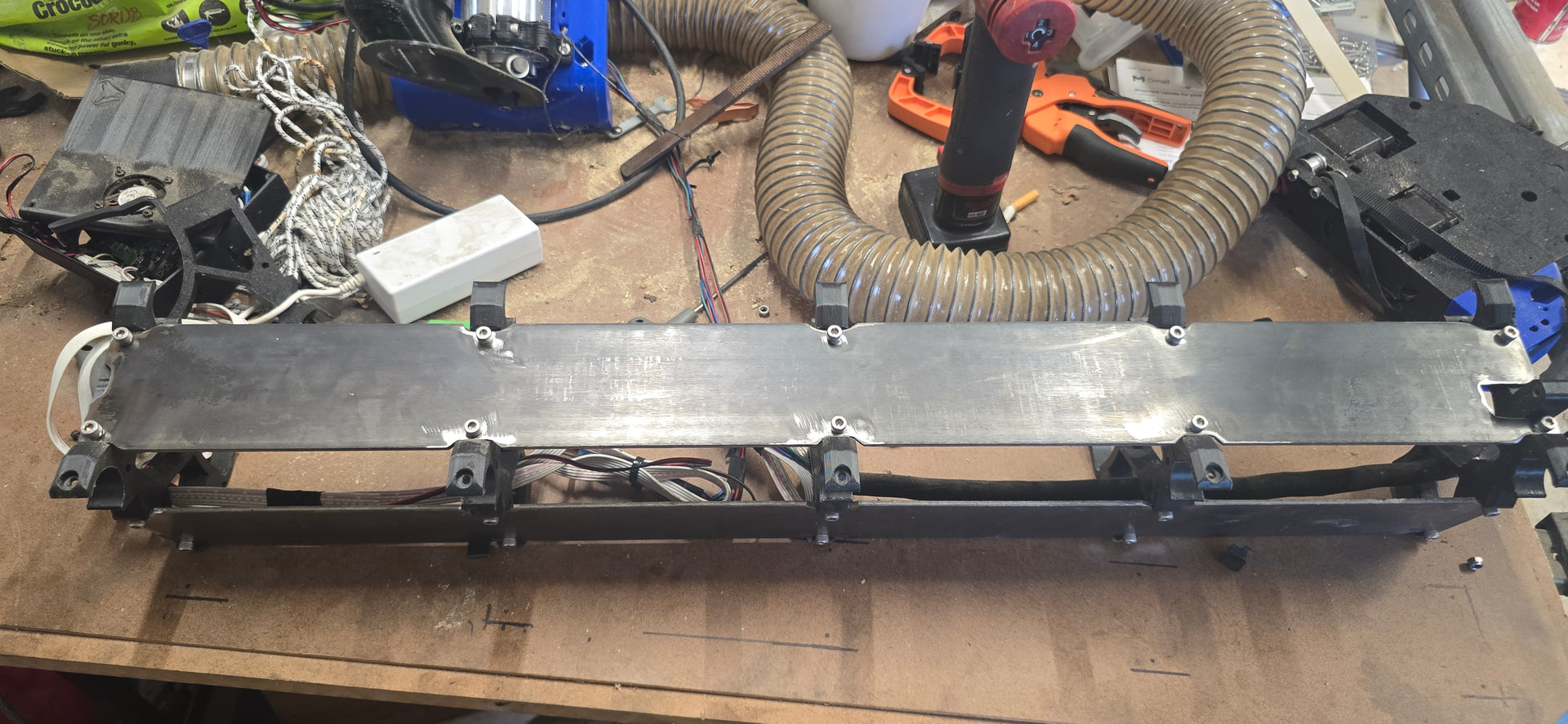

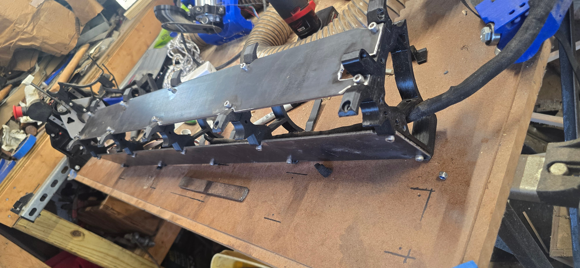

Dry fit up is a success. I guess the hard part is over. I’m going to cut and install the emt for now, but i really want to see what I can find kicking around locally.
I see it the other way around, but i may be way off. I think the metal not wanting to bend or twist lessens the need for more braces. I think if you printed one long gantry the exact same as the braces but it spans the entire length, that’s the idea. The plates are just trying to hold the struts in alignment without the need for an 800mm z axis printer. Paper would twist with the brackets almost touching. That stuff they made wolverines claws from would never twist even if you only had braces on the very end. The goal is to get the alignment as locked in a possible without adamantium. The screws pulling on the plates and the braces plays a role. The tube being clamped by the she bolts holding the plates plays a role. The location of the core when it’s applying these forces plays a role. That’s why I think stiffer plates have historical only done better to a certain point. After the plate resists the forces enough, the weaker links in the chain start to show up instead of the plate itself. But these are just my thoughts on wheat is happening. I have no actual facts other than my steel plates fit.

I didn’t get pictures before taking everything back apart for paint… But the emt tubes are cut, and i had the whole gatntry ssembly together minus the belts.
