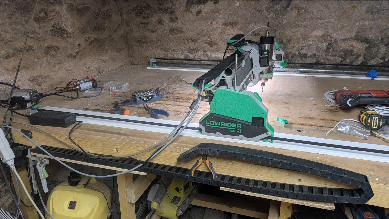

Lowrider V4 can I have the wheels run on a raised surface
I’m considering running a strip of hardboard down the one side of my table to give my wheels something flat to run on (I have a groove I made in my table where the V2 wheels ran in). Will it cause problems to raise the wheels like this by 1/8” assuming the pipe brackets are also raised this much?
No, I’ve had every LowRider on runners. :slightly_smiling_face:
No problem… I even think it makes the setup a lot easier
