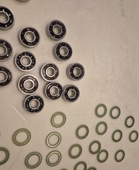

In the end I decided to just repack the existing bearings and stop spending money, so that’s what I did. Used a needle to pry off the shields off and applied lithium grease. They feel better now, probably can curse and replace them in the future if required.

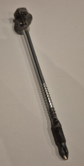

And, as it seems I was not able to find long enough screwdriver, so I made this masterpiece :smiley:

You absolutely need to close the bearings up again or you’ll only have fun for about five minutes. :sweat_smile:
Done that already! :smiley: packed, closed, cleaned and used in the build!

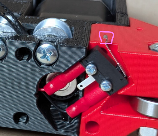

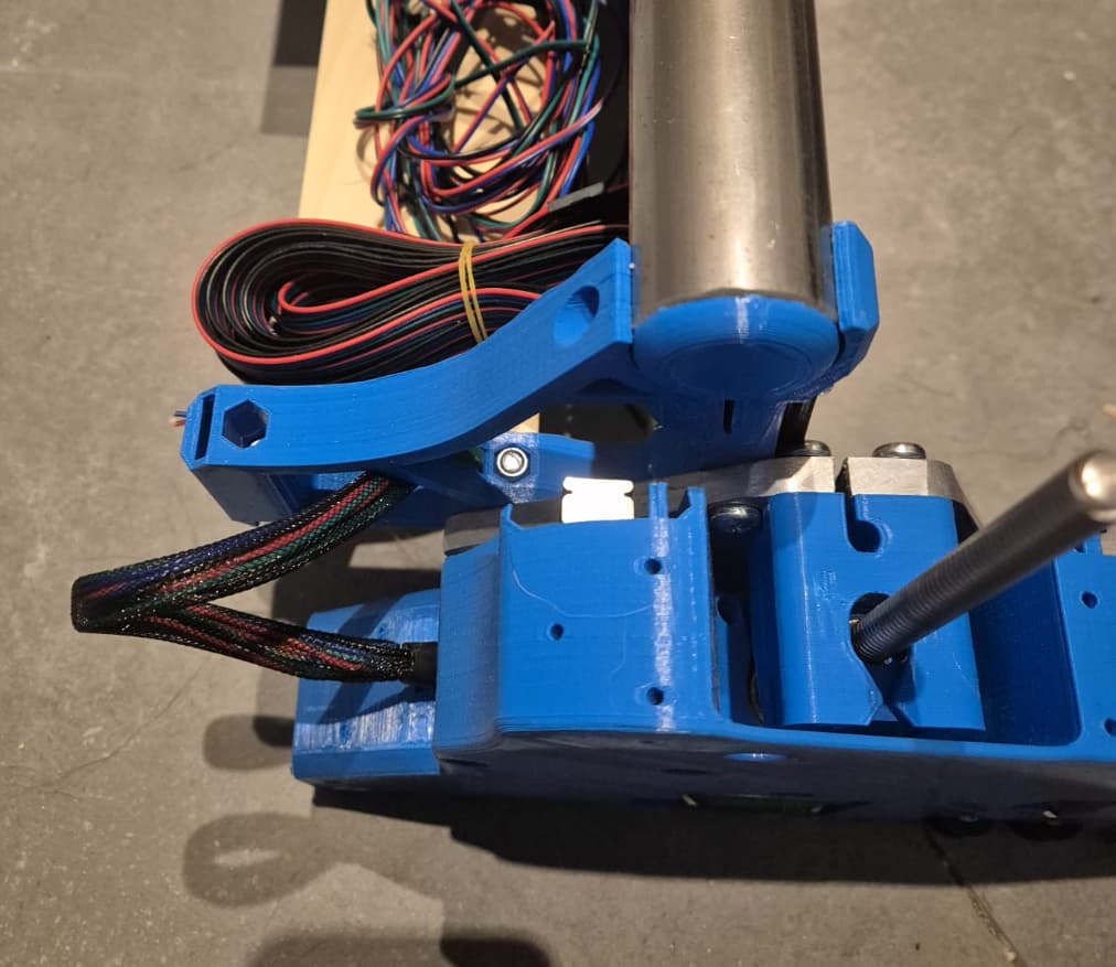

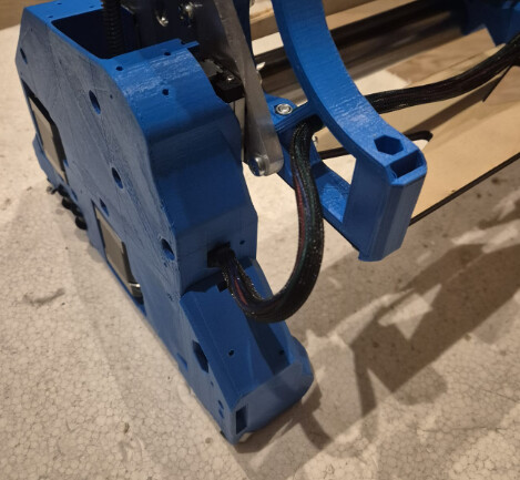

But I think my brain was not braining in the shop. It looks like I bought the wrong end stops again. They don’t have the hock at the end. Has anyone had experience with such?
Those might work as well, just try it. Changing the endstops at least on the side plates for Y and Z is pretty easy, X is a bit annoying. :smiley:
I experimented a bit, and it looks like it won’t be reliable, even if it is able to catch, as the arm looks to be too short here:
Basically I don’t have anything in the purple part, the arm is ~2mm shorter.

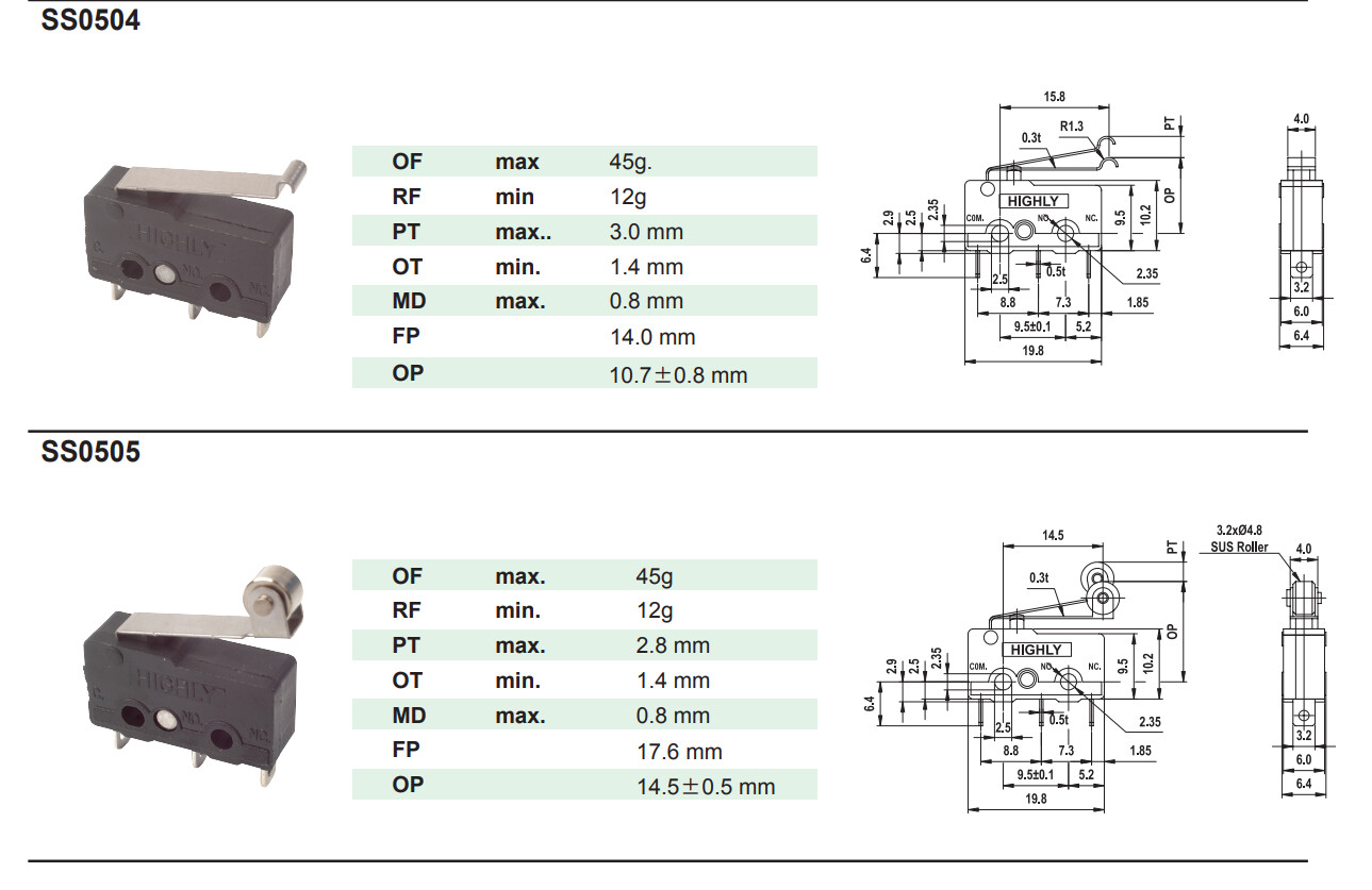

The hock ones are not available, only backorder for ~2weeks, so can’t seem to source it locally. The ones that we currently have in the shop are the lower ones:
Edit:
Found this topic, at least for older builds, the roller type seems to work alright.
brought the roller ones, they seem a better fit, compared to previously used ones. So the new endstop purchase adds 7.90 EUR to build cost. You live and you learn. Also bought the thread locker, so another 3.65 EUR added to the total.

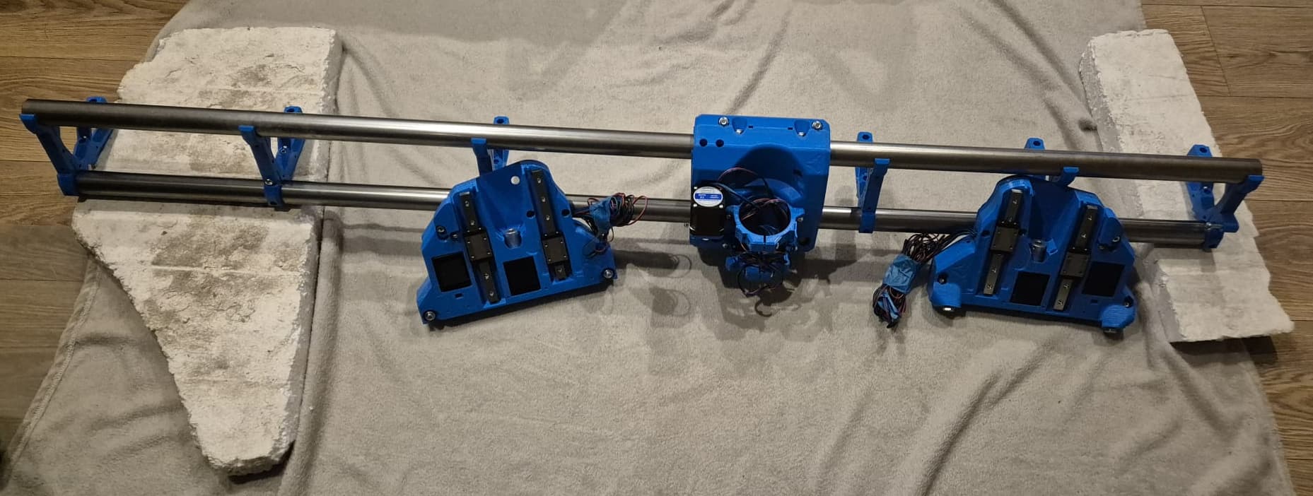

Today managed to get a lot done, not going to write a lot about it, a picture will tell more:
At one point while printing I started to hate the color (due to all the awesome builds I saw here :stuck_out_tongue: ) but in the end I think I like how it will turn out. Beams are precision steel, so prone to rusting. Right now I wiped them with gun oil. I think it will hold up ok with periodic re-wiping. Didn’t want to paint them.
The final working width of machine is going to be 1335mm. I’m using 1500mm beams, and in my country the 1220 (4feet) is not a standard size for full sheets of material, it can also be either 1250 or 1500+ mm. So I went with the largest possible in this dimension.
I’m still thinking about the length of the machine. My inner penny pincher says that to avoid scraps from the purchased material, 2200 table length ( 1950 mm working length) will be a good compromise. My inner child wants the table length to be 2800 mm. Not sure if I have the space or even the future requirement for such a beast. Still have to think about it.

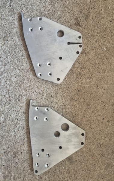

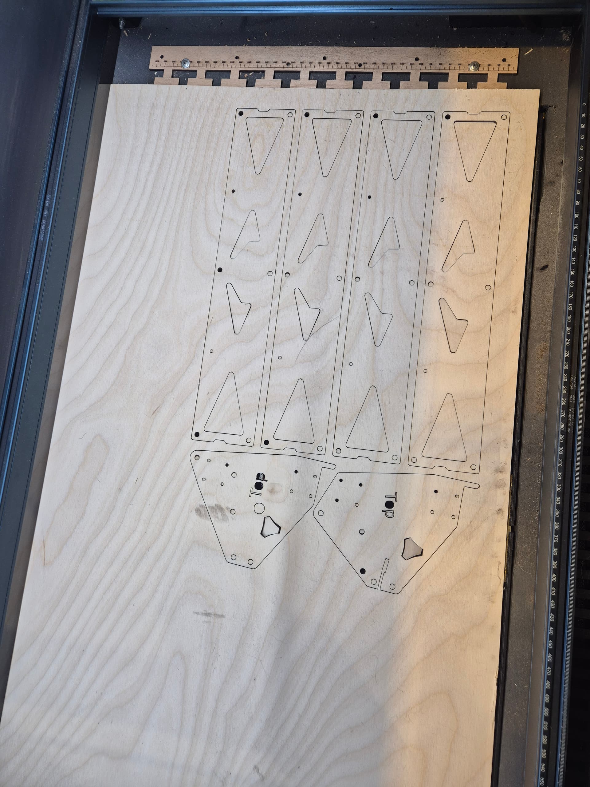

Cut temp struts from 3mm plywood on the laser, also cut the templates for aluminium processing. I will stack them to create 6mm thick boards, till I manage to cut the final ones on the machine itself.
Also managed to score a piece of 8 mm aluminium for 12 EUR. If I manage to produce the required parts, I will also have a chance to CNC a pair in the future, as there is enough material.
So from one side I’m hopeful that I will be able to hand cut the pieces, from other side I hate myself for being impatient, as @FreneticScribbler ones would be more precise than my shacking hand.
Making them yourself would be good experience!
And don’t credit me, credit the machine - the whole reason I built one is I’m bad at making stuff :laughing:
Today tried my hand at cutting the aluminum parts, not great, not terrible, I think they will be usable. Things that I paid special notes to:
  • The 8 small screw holes (3mm) should overlap when plates are stacked, same as the top two 5mm holes. And when those holes on both plates are screwed together, the endstop tabs also overlap, so I used this screwed together position to sand the tabs till they are the same size.
  • Logo part, I wasn’t sure if it serves some objective, or is just visual, but I chose to drill a hole there, to insert a screwdriver, if required at some assembly stage.
    *I had trouble getting the rails operating smoothly, so I ended up double checking the fitment, even with a drill press and center punched holes it wasn’t accurate enough. To compensate, I drilled few of the holes to 4mm. Not the best practice, but it is what it is, now the rails are smooth.
    *Didn’t have longer M3 screws on hand, so just countersunk the holes to compensate.
They looked like this when finished:

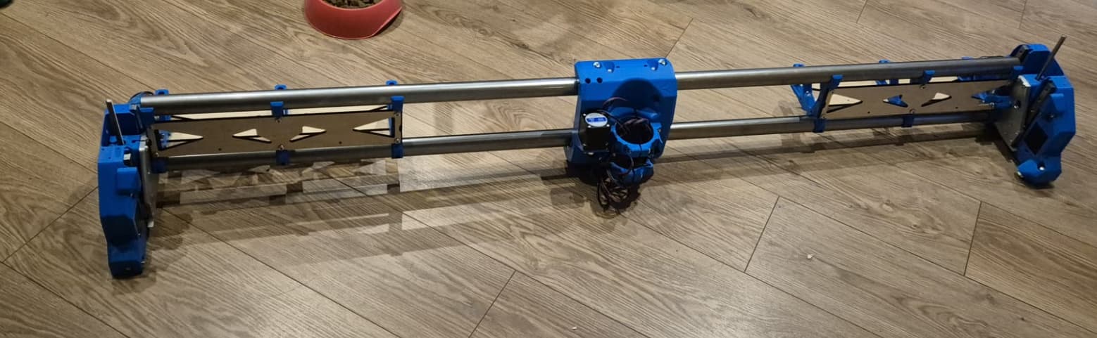

And then made some progress:
Unfortunately the build process will slow down a bit now, as life gets in the way of fun, but hopefully the next steps will be welding up the table in the following week.

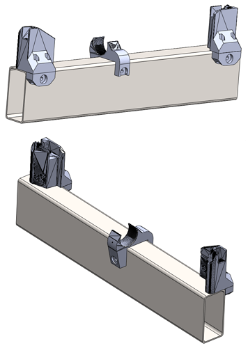

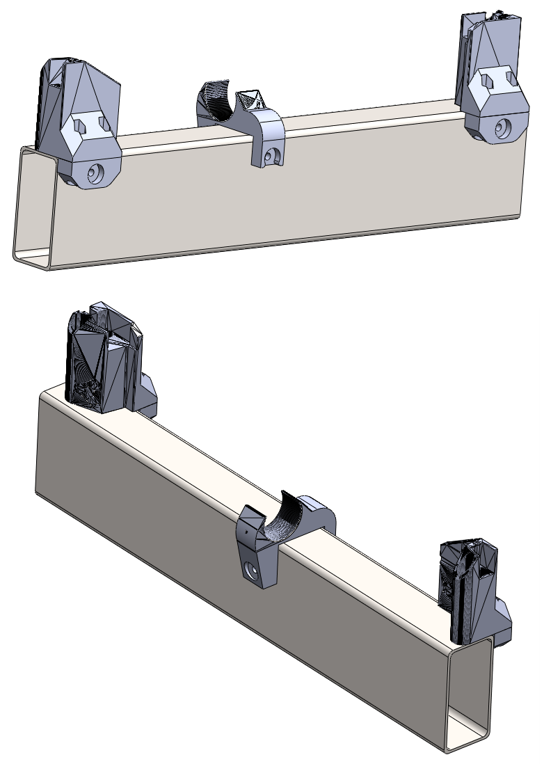

Looks like I made a bit of an oversight about my table design.
Quite fast I locked myself down to using 40x80mm steel square pipes as they have great availability and decent pricing. Over the span of 2+ meters it makes sense to put the tubes 40mm across and 80mm down (if that makes sense?) to decrease deflection. But the Y_Clip is a bit longer than 40mm, so with the belt max b and belt max f I can’t align it on top of 40mm area.
I see three possible scenarios how to proceed:
  1. Put plywood on the 40mm section, to expand it to ~80mm, bolt plywood to pipe, bolt everything to plywood.
    Pros:
  • Shims can be added to get it perfectly straight if required.
  • Simple to bolt stuff to it as it is easy to drill in plywood.
    Cons:
  • I don’t like plywood for this, as I’m concerned about shifting due to moisture fluctuations.
  1. Put the pipes 80mm across, 40mm down.
    Pros:
  • No plywood.
    Cons:
  • Harder to drill precise holes in steel.
  • More deflection in table, additional bracing required.
  1. Reprint Y clips, belt max b, and belt max f with consideration for drilling locations and considering the footprint of 40mm.
    Pros:
    *I like to thinker, cleaner design, less deflection.
    Cons:
  • Not sure how it would work out.
  • If the 40x80 beam is out of square my initial design won’t be able to compensate for it. So I need to check squareness for the pipe before attempting.
  • Have to reprint parts.
This is what I have planned. There are a lot of STL related import ugliness, but I hope the idea can be seen.
Those hand cut end plates look awesome, nicely done! Bet you might not even need CNC’d ones now.
Table wise, I’d go for the plywood runner option - I’d be surprised if you get bad warping unless you’re leaving it in the actual rain. Mine has been ok so far in damp damp land…

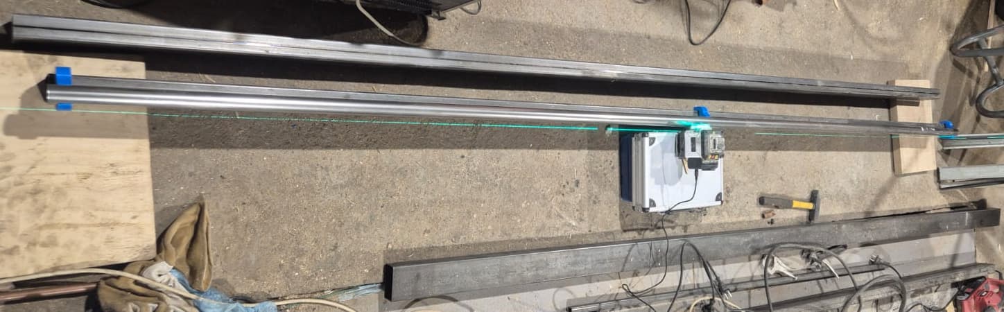

in the weekend started the table build, there is no real progress as time was limited, but managed to use a laser to understand the straightness of my pipes, most of them were a tad bent, but one was around 1mm mark over 3m section and I can live with that. It seemed surprisingly good, so I’m currently printing few parts to test Y parts I posted previously. Downside is that I can’t weld this pipe now, as it will warp, so have to figure out how to bolt it.
I like the look of a 3m length, now just have to justify what I would ever use it for :smiley:
As a sidenote, the picture is to show the process, not the laser alignment, as it looks way more off than 1mm.
And AJ, solid advice, if I burn myself with this, I will proceed to the plywood runner.
