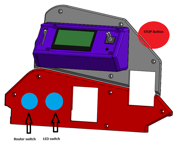

After some deliberation, I’ve finalized the screen position. Reflecting on my past experiences with the SKR touch screen—where 3D printing would randomly halt—I decided to steer away from touchscreens altogether. I also find them less tactile and satisfying to use. Instead, I’m opting for a straightforward, old-school rotary encoder. To integrate it successfully, I’ll need to make firmware adjustments, but this isn’t my first rodeo with Marlin, so I feel confident in navigating the required modifications.
Regarding the router control setup, I’ve been debating whether to incorporate a relay command. In any case, regardless of the relay setup, I intend to include a physical switch to power off the router entirely—even if it’s already in an “off” state. Safety is paramount, especially during bit changes, and I like keeping all ten fingers intact.
I’ve also decided on a separate switch for the LED light. Given its significant power consumption, I only plan to use it for detailed inspections, relying on shop lights for general observation, which are more than sufficient.
Lastly, I came across the concept of an emergency stop button and realized it was a must-have for the setup.
The router’s planned location favors one side over the other for easier access. Here’s a rough layout I’ve envisioned:
What are your thoughts?

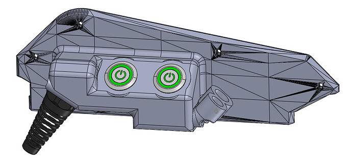

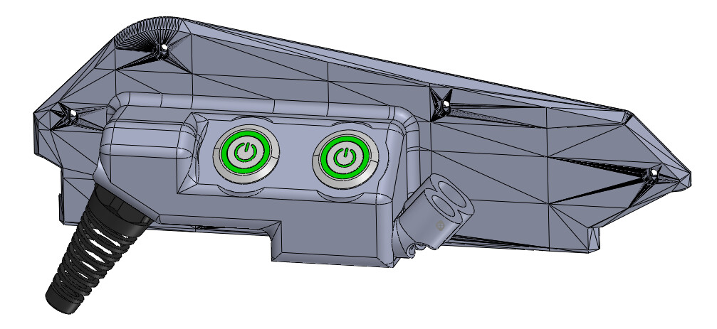

I had some free time, and this is somewhat my vision for the router switch and LED switch. I also decided to include a 220V cable relief, though I’m wondering if it might obstruct the movement in any way.
This looks awesome but might block the cooling to the steppers. :frowning:
Is that a part of the Millenium Falcon? :rofl: With my newbie cad skills it would take me a millenium to design that . Nice!
Philipp, thanks for pointing out the cooling issue—somehow managed to get the wrong file :smile:
Dan, it only looks impressive due to my need to round all the edges and pull existing things like buttons and bits from grabcad so it looks more complete, other than that it is just a box on top of the existing plates.

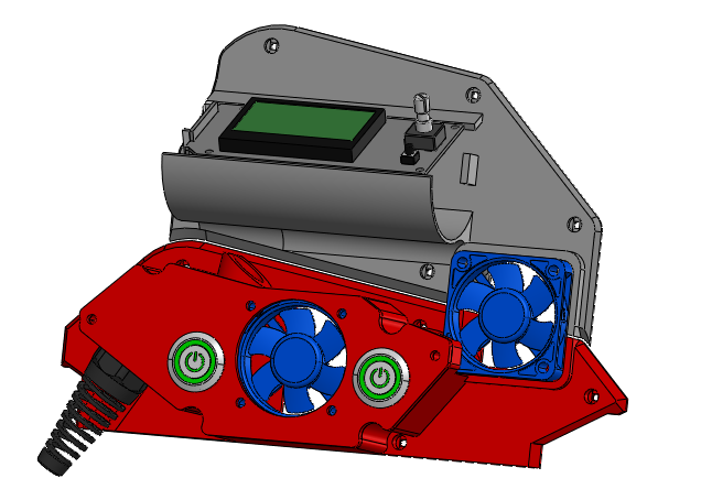

I’ve started working on an option with cooling in mind, but I just can’t seem to get the look and feel I want—it doesn’t quite sit right at the moment. Still, there’s time to refine it, these would be the last parts anyhow.
While I’m waiting for the dump truck to arrive next week to kick off the garage cleanup, I should be focusing on finishing the CAD design for the table. Once that’s done and the garage is clean, the welding phase begins.
You don’t need the fans actually, just don’t block the air. :slight_smile:

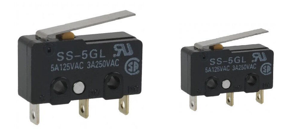

  1. The endstop switches I received are about 75% of the required size—lol. I should have checked that before purchasing. Now, I’ll have to source the correct ones locally.

No, I’m not sure how to explain it, the switch size is like a scaled down version, the M2.5 screw doesn’t even fit inside the screw holes for the switch. Here is a crude drawing of what I need (left) and what I received (right) :smiley:

Ah! Baby endstops. Maybe feed them well and they’ll grow up big and strong? :laughing:

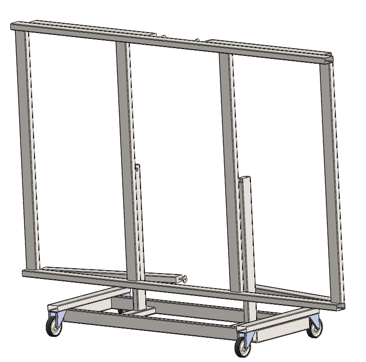

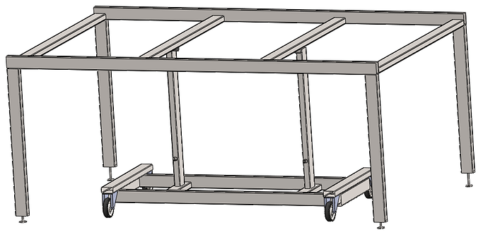

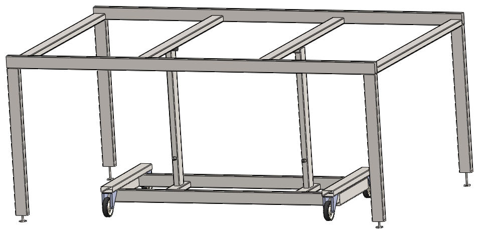

At this point, my project has taken on two paths: the main objective and an unexpected side quest. The primary focus now is to build the table for the CNC. In my rough draft, I’ve designed it with caster wheels for easy mobility, a foldable frame, and fold-out legs—each equipped with separate height adjusters. The table measures roughly 1.5 by 2.4 meters, a size that feels just right. The main rails are positioned a bit higher; this allows the table to lower approximately 40 mm below the zero level (without a spillboard), which should offer extra flexibility in the future. The structure will mainly be built from 40×80×2 mm steel. While it might need some additional bracing, I’m pleased with how the overall design is coming together.
Here is the table folded up:
And here’s the table unfolded:
Any thoughts or concerns welcome!

I did, however, manage to pick up a few 40x80mm pipes—and wow, they are HEAVY. My mind is still set on a folding version, but considering the strain on my back, unfolding and folding it regularly would be a non-starter.
Right now, I’m considering keeping the folding design but without wheels. One side would be anchored to the wall, and in a worst-case scenario, a winch could be used to gently fold it out.
This approach might come back to bite me later, but for now, I think I’ll just weld up the tabletop and figure out the legs later—whether by adding legs or integrating a folding mechanism. At least with a tabletop in place, I can continue the build process.
