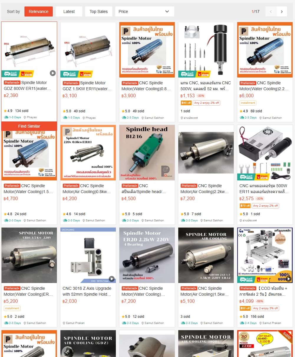

Also wondering about using a spindle - I haven’t bought anything yet except the Jackpot CNC, just preparing and making a list, and notice spindles can be bought pretty cheaply here in Asia. Most of the CNC machine sellers locally use them - in fact I was planning on buying a pre-built machine with 800w spindle for wood cutting, total cost ran to about $2500 which isn’t bad for a full size setup, then I discovered the Lowrider and thought I’d try that instead as it’s much cheaper and a nice project to work on.
How difficult is it to use a spindle instead of a router in regards to build and software?
There seem to be tons of different spindles available here so I’m sure I can find one that has the right kind of specs, just checking if it is indeed possible and won’t cause problem with my build.
From what I gather they can be slightly more accurate and much quieter than a router? Potential downside or issue being weight, at 4kg they’re twice as heavy as a Makita router.
(Pic showing them for sale online locally. It’s Thai Baht, not USD. 5000 thb is around $150)
I’m just digging into info about spindles now, but I’m in a 220-240V region. The main differences between them seem to be kw (0.8kw, 1.5kw, 2.2kw) and cooling system (water and air cooled).
I found the same model numbers on AliExpress and other sites, so they seem to be the generic Chinese ones sold everywere, e.g: GDZ65F-800
