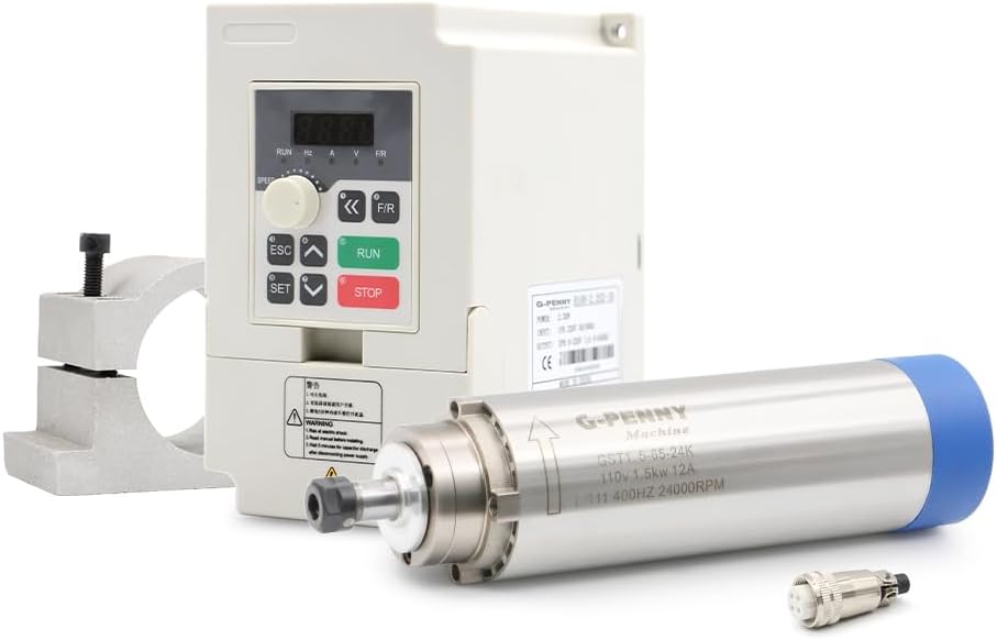

This is the one I am looking at now
The G-Penny spindle is the same one sold in the PwnCNC kit for $850.
Thoughts? This seems pretty complicated still.
They are most certainly an option. This one looks pretty dang good. I am willing to giv eit a try any other suggestions?
I would certainly add this to the options list but a makita is ~$100 and does most all the work this one does.
I think all of these Chinese spindles are pretty similar. I’ll give it a try too. Worst case I can return to Amazon.
I think I’ll be happy to pay ~$150 more to reduce noise alone.

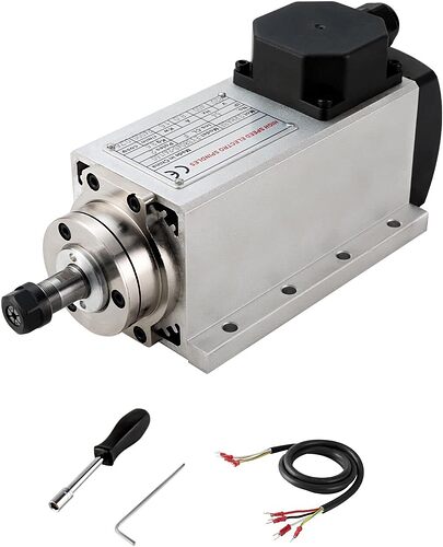

I use a vevor er11 220v spindle on mine and it is most definitely a ton quieter than the kobalt. And my harbor freight dust collector is in a lean to outside of my shop. Very nice pair for sure

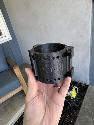

@Jonathjon are you still using this spindle mount?
On the LR3 yes that’s the one I use
Nice and clean part.
Looks great! Throw that pic up as a make on printables!
