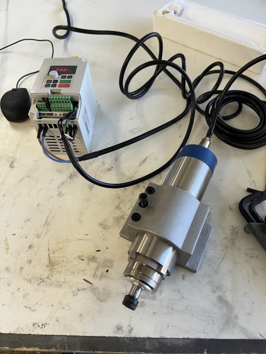

I think I got everything I need and can play with this tomorrow.
My first reactions to the spindle - this think is heavy and chunky. I am pretty excited

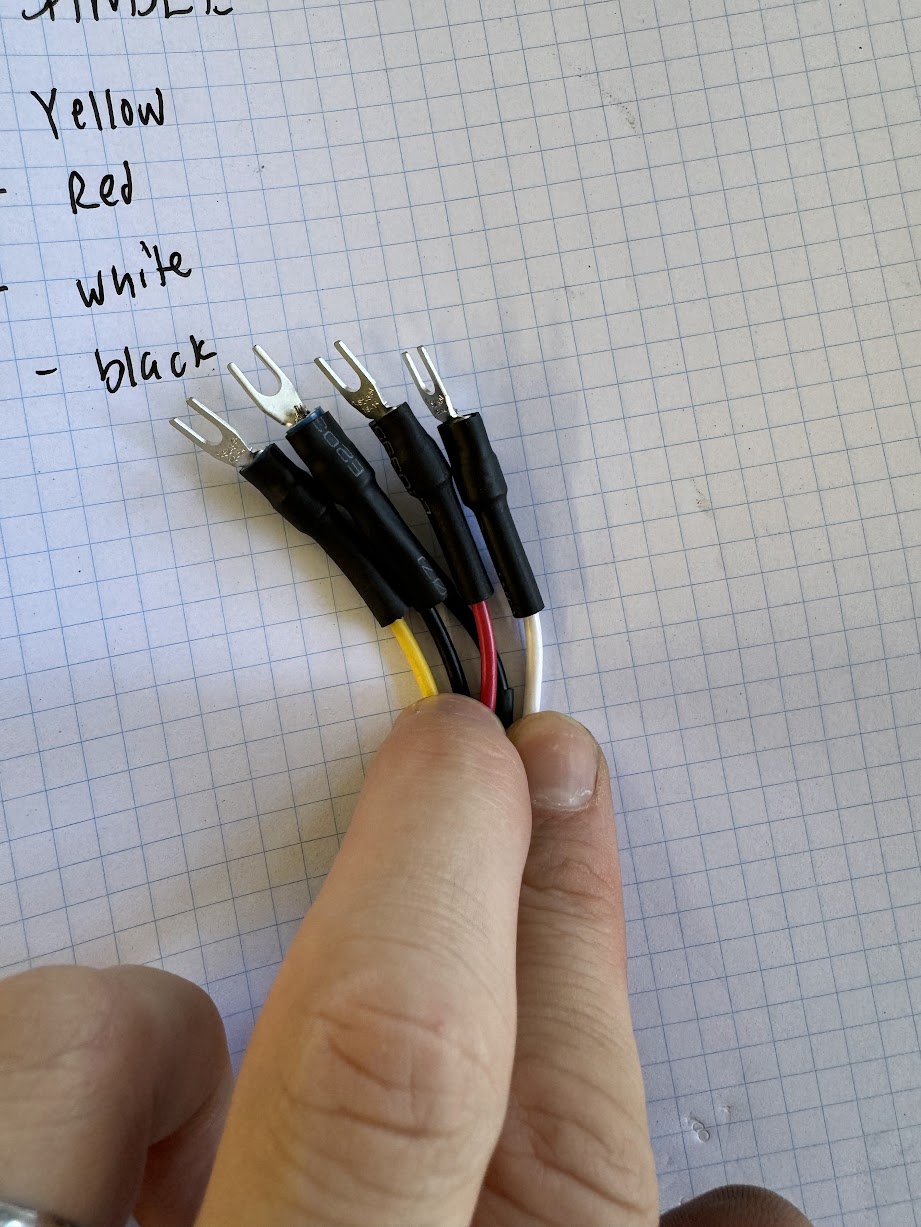

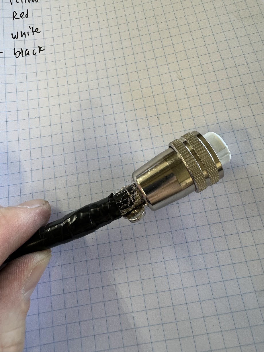

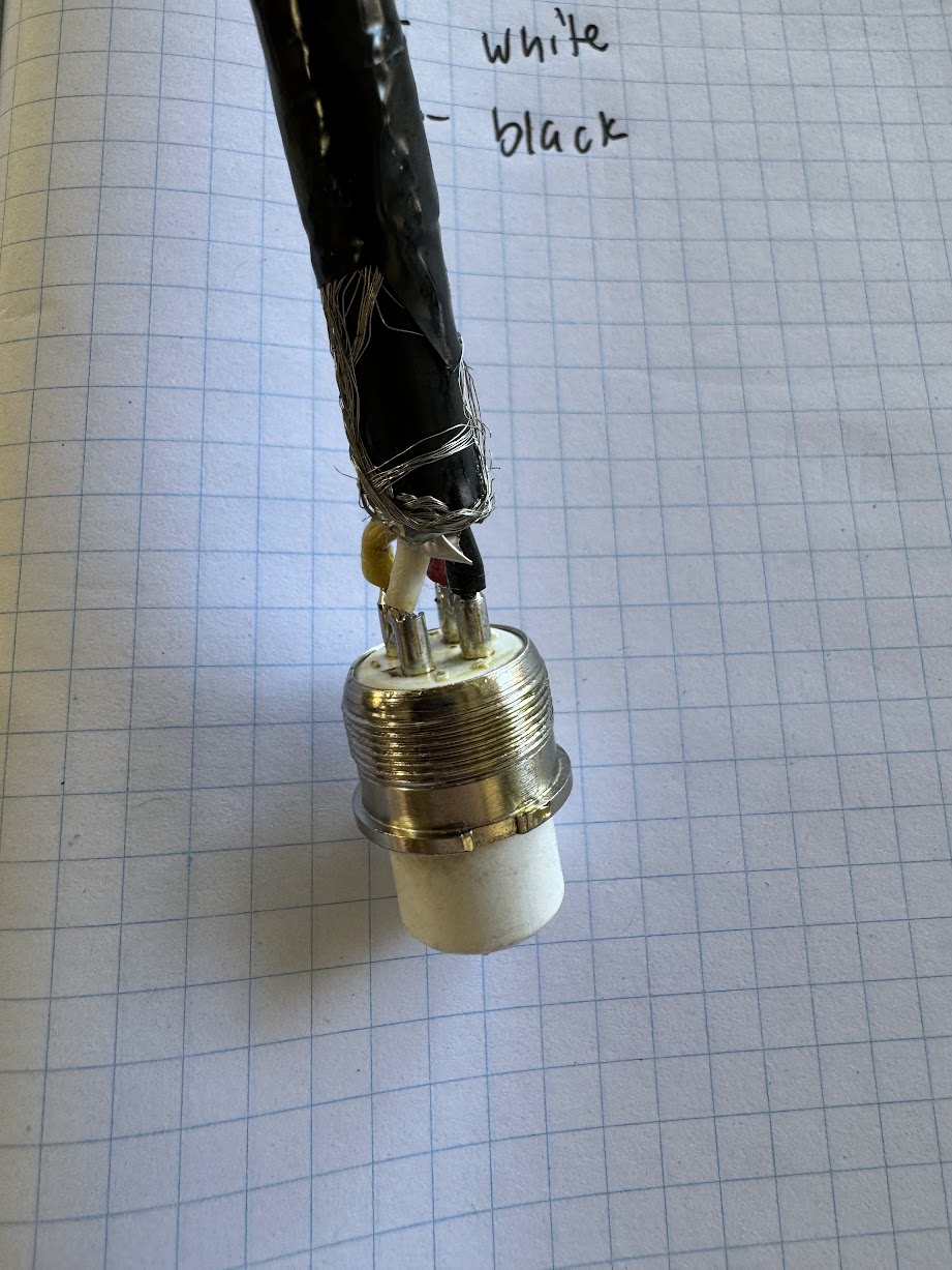

I would suggest buying a premade spindle cable. This was annoying to solder, and I consider myself decent. Need to use a big tip, and lots of flux.

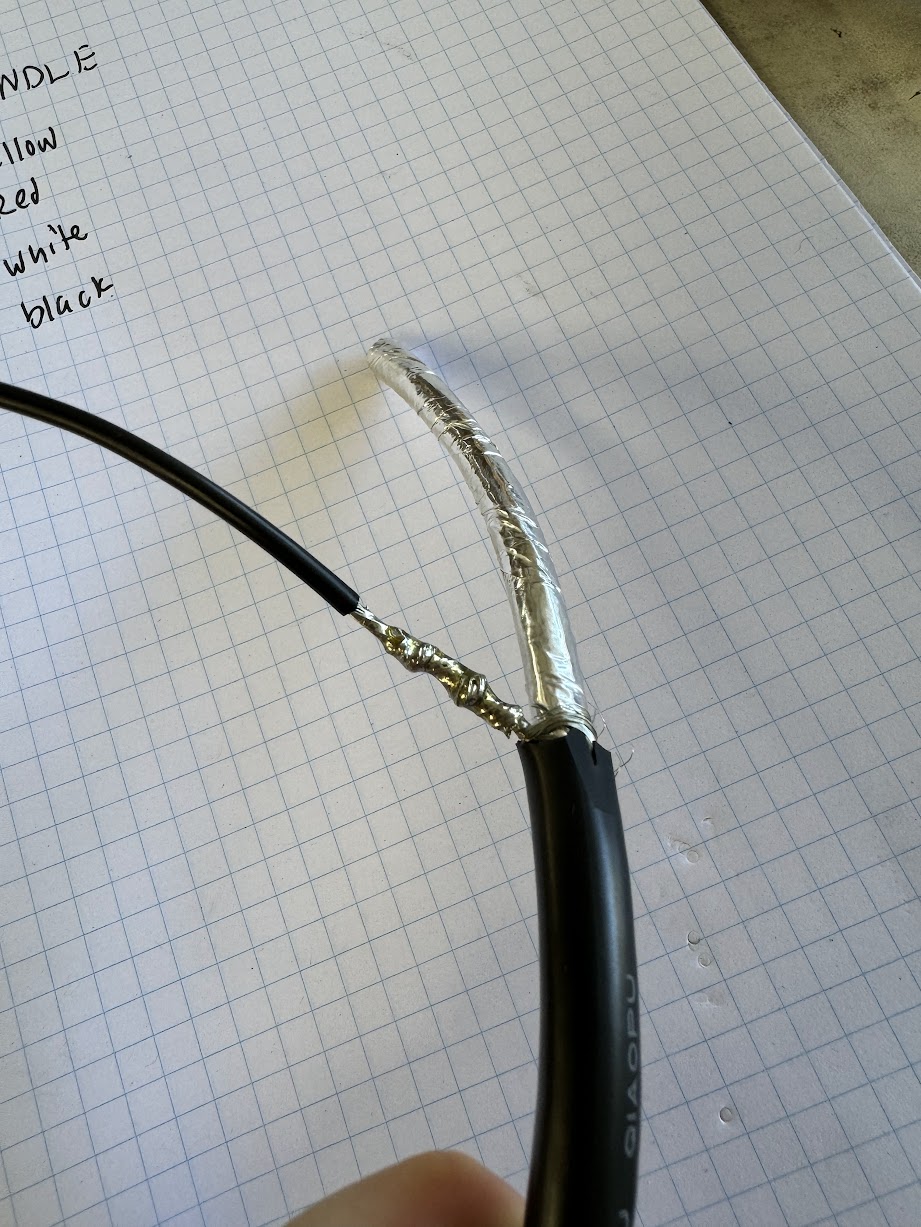

How to ground these cables is pretty controversial. I couldn’t find clear guidance. On the spindle side, I clamped the shielding into the connector.
On the VFD side, I soldered another wire on and included in in my ground connector.
Black is ground for whatever reason I decided.
It is spinning!
50 Hertz × 2 × 60 seconds / 2 poles =~ 3,000 rpm
The instructions online say to run it for 30 minutes at 3k RPM, then increase the speed and run it more. They don’t say by how much or such, so I’ll let it break it some.

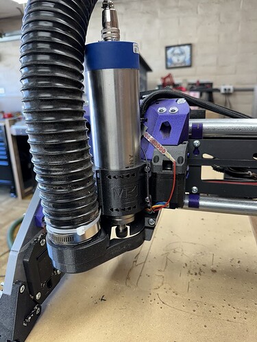

Got it mounted
I am following this break in procedure -
https://support.pwncnc.com/kb/article/290-spindle-break-in-procedure/
6000 rpm for 20-30 min - 100hz
9000 rpm for 20-30 min - 150hz
12000 rpm for 20-30 min - 200hz
18000 rpm for 20-30 min - 300hz
24000 rpm for 20-30 min - 400hz (max speed)

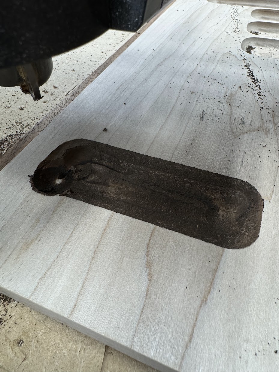

Uhh, so spindle is going great
What happened??
I ran it in reverse. Apparently you have a 50/50 shot of getting the correct direction with a spindle.
