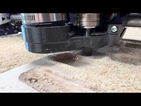

I wasn’t expecting that.
What the heck even is that?
It looks like the collet was dragging around on the work piece without a cutter.
So my forward/reverse is flipped. Tomorrow I will change 2 wires on my VFD to flip it.

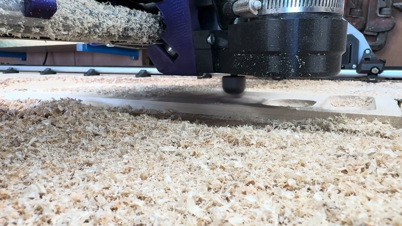

I think the Makita has much more power than this spindle. You can hear the spindle bog down. This is the same exact gcode.
Makita
Spindle
This is the big 1" bowl bit I use all the time. It is a little dull, but it was equally dull for these tests. I’m cutting extremely hard maple in the video.
So far, I don’t really think this is an upgrade. Maybe a lateral change at best.
I am running a 30 minute job cutting hard maple and the spindle is struggling hard. I kind of want to switch back to the Makita to see if it struggles on this exact piece of wood too.
edit: I actually stalled it completely once so far

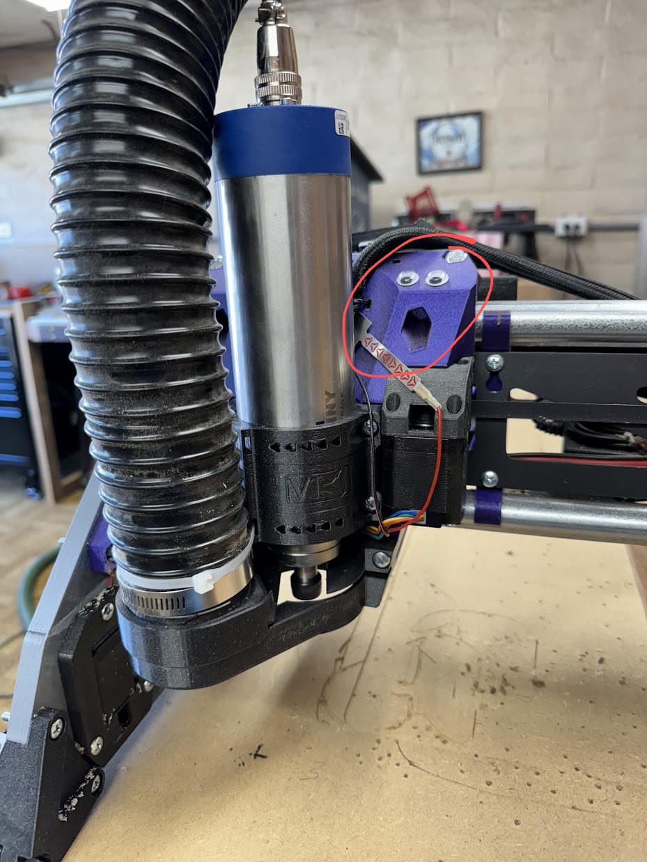

The whole machine is pretty warm / hot. All my steppers are almost untouchable. One of the z endstops stopped working until I opened the control box to let it cool down a bit
Oh, they are only ~109F

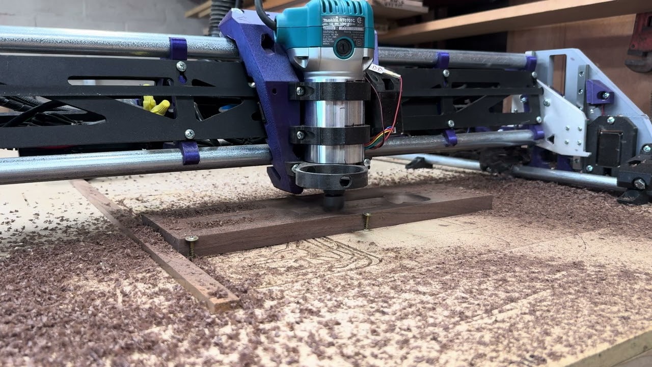

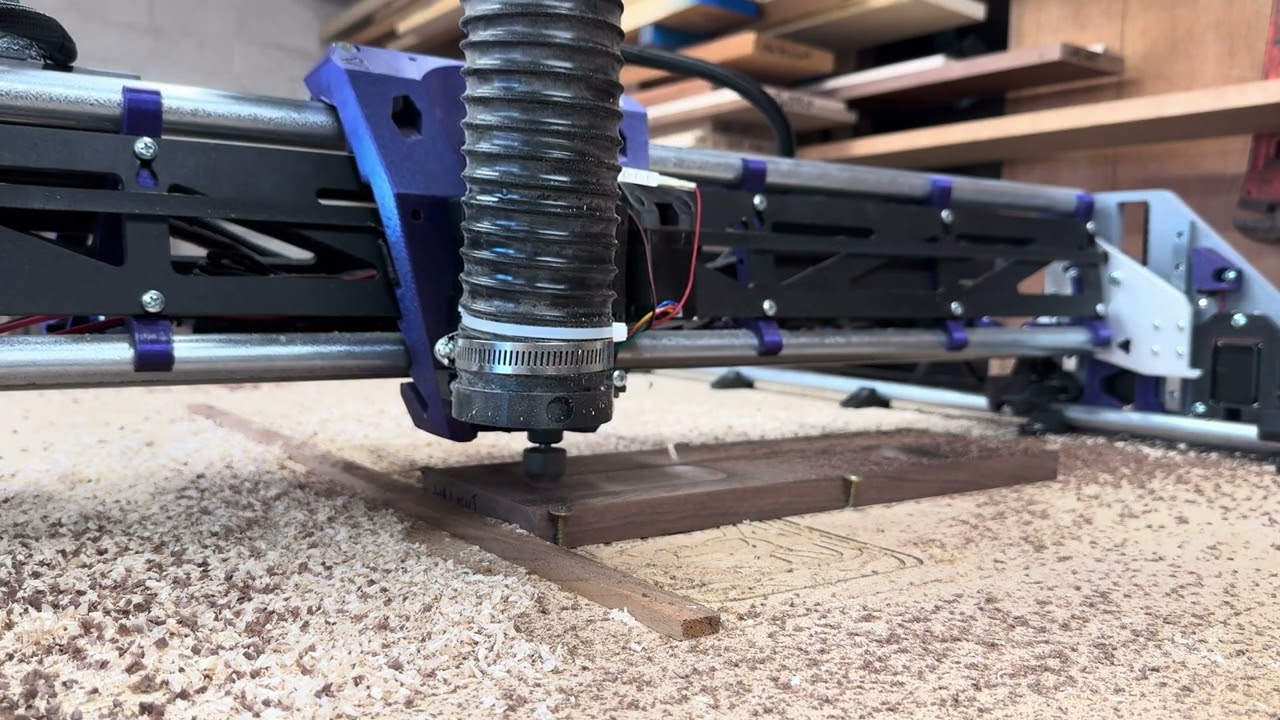

Spindle in Walnut
Makita in Walnut
Just sounds like you have more RPM on the Makita, which I think is typical. Such a big bit the extra RPM gives more rotational inertia to power through. I dont necessarily think it is an indictment of the spindle, but more of a “right tool for the job” thing. There is a reason routers are routers. If you ONLY plan on doing hardwood and big bits maybe the Makita IS the better choice despite the slightly higher power of the spindle. Remember power doesn’t always equal speed.
