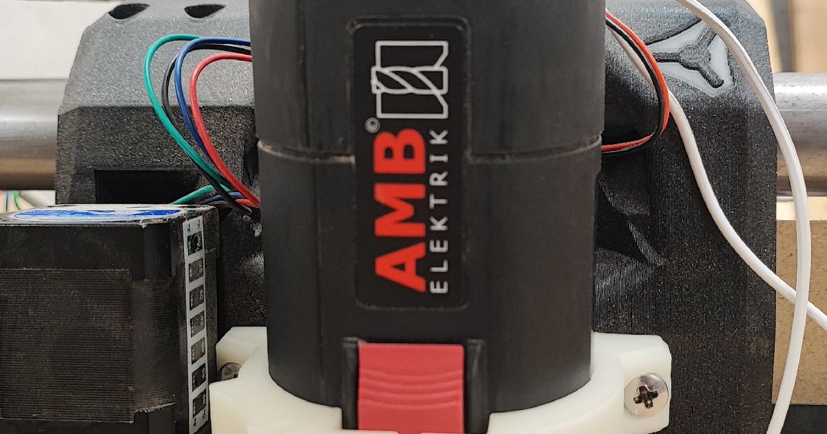

I got a good deal on a used Kress 1050 FME-1, so I hope to be able to use it.
That’s not a problem, here’s the mount:
:slightly_smiling_face:
Thank you. That will help a lot.
