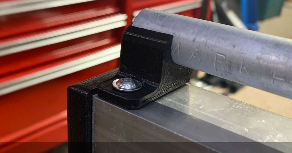

I upgraded my LowRider v2 to LowRider v3. Normally this means a wider table is needed if you want to maintain the same cutting area. However, if you have metal struts on your LowRider 2 table, then you can add these “end-caps” I designed in order to widen your table’s “reach” and thus use your existing table without widening it. With these extenders I can still cut 49" x 97" MDF sheets.
The original V1 Engineering LowRider 3 tensioner bases and tensioner mounts attach directly to these. Caveat: the original V1 Engineering LowRider 3 tensioner bases have holes intended for slightly thinner screws, and I drilled them out to accept M5.
There are nut capture slots on the bottom sides of each, which accept two M5 nuts per corner, and then you can attach the tensioner bases to these.
My LowRider v3 upgrade process is detailed on the V1 Engineering forum here: On upgrade path: LR2 -> LR3, Clarksburg, WV, USA
You want these strong, not so much to avoid breaking but primarily to avoid flexing. I printed these with 1.8mm thick walls, which is the equivalent of 4 ½ perimeter walls —if using a 0.4 nozzle at normal settings. I do only 3 walls and have it be as thick as 4.5 walls, because I print with walls that are 0.6mm thick instead of 0.4mm thick. Stock 0.4 nozzles can handle this if your extruder can keep up. I have two printers with 0.6 nozzles and several others with 0.4 nozzles. I run them all at 0.3mm layer height and 0.6mm wall thickness.

Have you consider cutting the insert that goes into the strut out of wood and then 3D printing the outside - with some modification (Holes through ) the 3D printed parts you can attach it to the wood . It could potentially save 15 hours on printing .
That’s no doubt a workable approach. Short answer is I had not considered it. :slight_smile:

Here is my remix intended for the same purpose. “WOOD INSERTS EDITION”…
LowRider 3 CNC - WOOD INSERTS EDITION of table extenders to use metal struts with LR3 - endstop/tensioner supports
LowRider 3 CNC - WOOD INSERTS EDITION of table extenders to use metal struts with LR3 - endstop/tensioner supports by Doug Joseph (design8studio) | Download free STL model | Printables.com
Thank for all the suppose - I have added some pictures of the wooden insert .
NEW REMIX provides 10mm worth of adjustability to get your belt orientation perfect.
