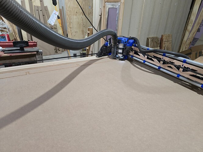

Well I’m cutting a new table! Feel good about what I’ve seen so far. I also got a new toy recently, the larger Harbor Freight dust collector and man what a difference. So much quieter and so much air flow than the shopvac. Now the poor shopvac can go back to being a shopvac.
The dust collector is setup for dual 4" hoses and even though I stepped it down to 2.25" shopvac hose, and then again to a 2" hose at the router (don’t yell at me guys) it’s still doing better than the shopvac was.
That being said, is going full 4" to the boot the most realistic answer? Is there a more realistic answer? Would like to do the reasonable thing here.

Sorry for being so inquisitive, but I’ve been in conflict for a bit on what I want to do for a better DC system. Correctly have a dust deputy, and love its performance with the shop vac, could stand to do without the screaming shop vac. Currently working on a slow build LR3, and anticipating longer run times, figured the shop vac will be updated to something better quickly.
I have the same big HF dust collector, and I have not done an impeller upgrade (don’t know much about it), but I did swap out the air bag filter for a nice tall pleated-filter canister (aka the MERV style filter). I also used my LowRider (back then it was a v2) to create an MDF + buckles adapter to connect a regular large trash can (with regular bags) to the bottom. I pre-cut some “view slots” in the side of the can so I visually see how much saw dust / chips are in the bag, so I know when to change it.
