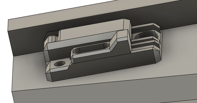

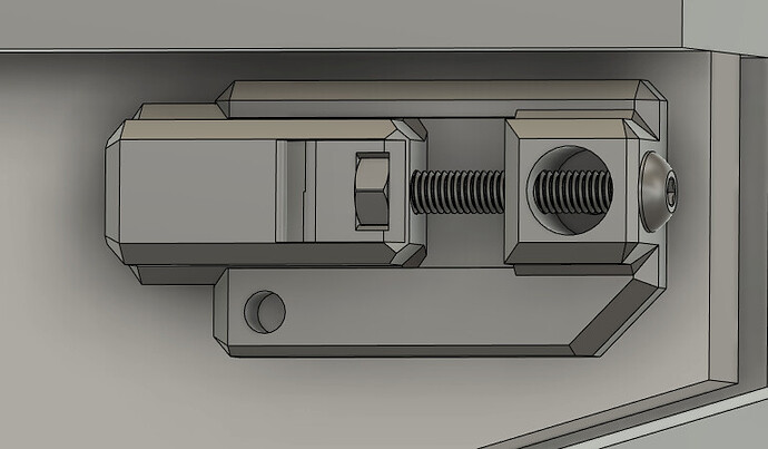

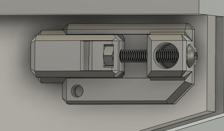

My goal for the tensioner should keep it perfectly in line with the belt. That’s if things go perfectly, I’ve already changed everything I thought was perfect so far so we shall see when I flip things around to the other side of the table!
Something like this would make more sense? Actually in a few ways it should, it’ll give that larger more uniform surface for the switch, but it also move the fastener from having to spin a wrench right up against the wall that it’s mounted to, to now straight in from the outside.
An m3 screw and 1 heatset is required of course

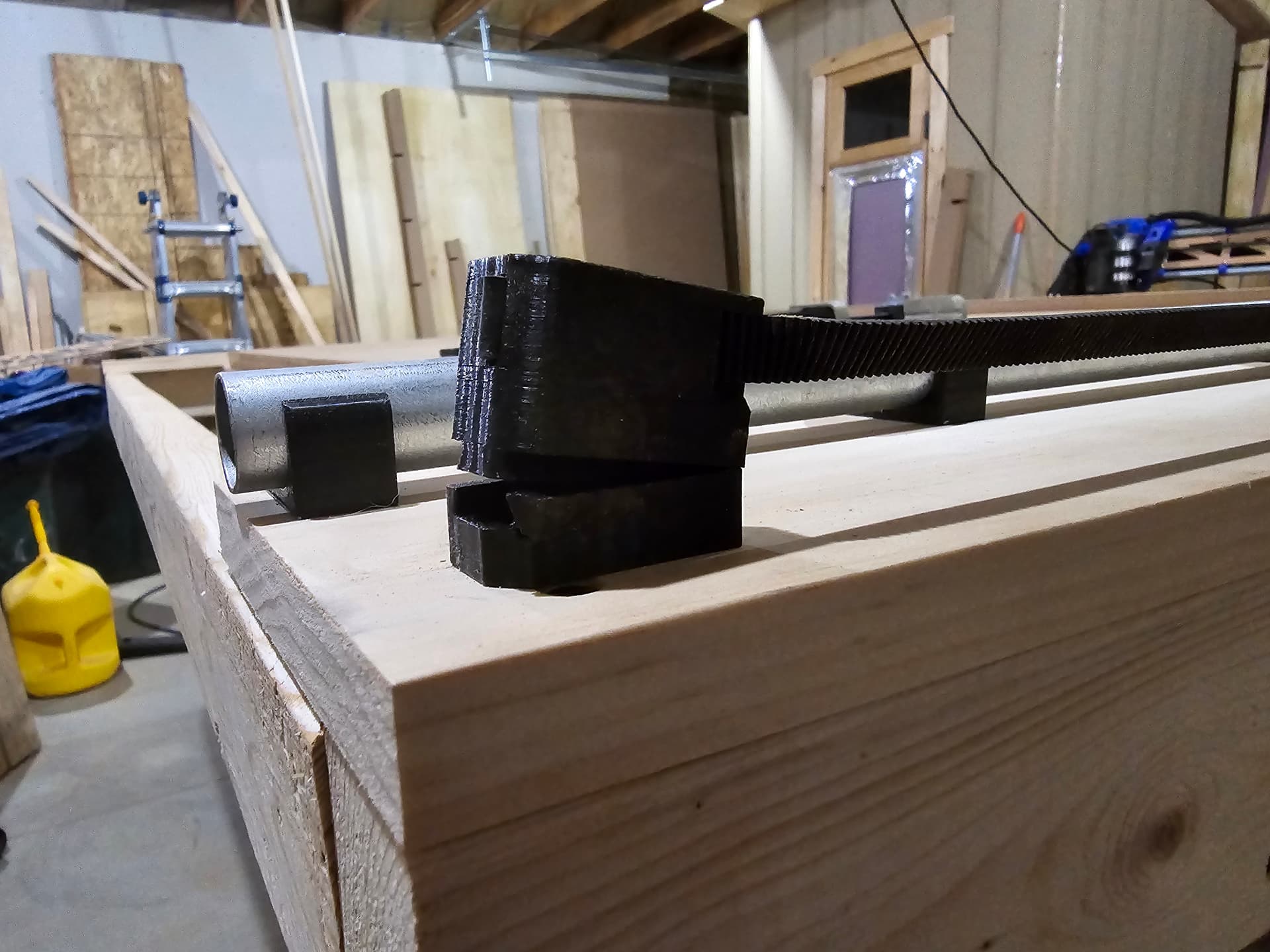

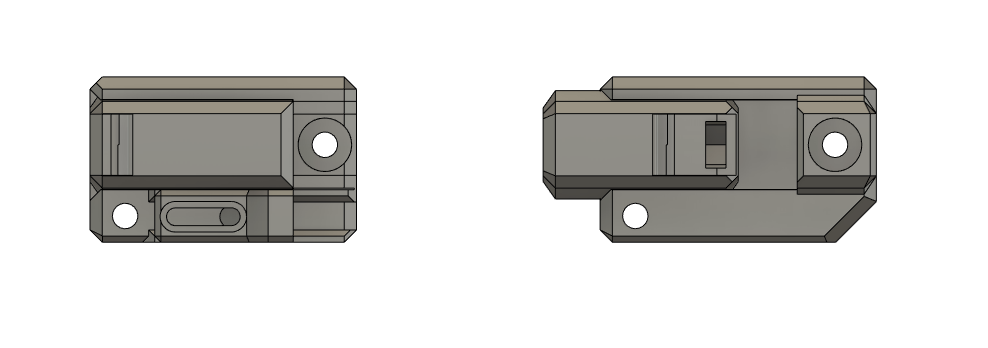

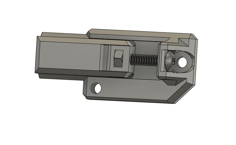

This confuses me a bit. Are you saying you don’t plan to have adjustable belt tensioning on both sides? How will you adjust the tension on the side without a tensioning mechanism?
No sorry, I’m so scatter brained I’m not explaining very well.

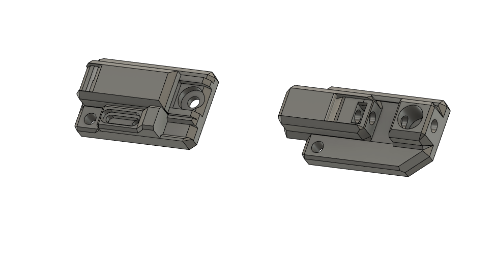

This is my plan for the other side I just threw together. Keeps similar design language, similar slide, similar screw placements, and uses a captive nut for the M5 bolt to pull on.
AH, OK, so “stationary side” meant “stationary end of one belt on each side” not “stationary non-tensioned belt on one side of the LowRider.”
Yup, one day I’ll use terms that make sense to everybody not just myself haha. Today’s not that day though! I’m printing this tensioned side now as well Something I might toy with is moving the should that the bolt head sits on to the far right so that the slide doesn’t need to be ridiculously long but people can still use the same size M5 as used in the rest of the build. Actually I’m almost definitely going to do that…
I think this is what I want here, same M5 x 30. Gives 12mm of slack for creating tension. I hope that’s enough!

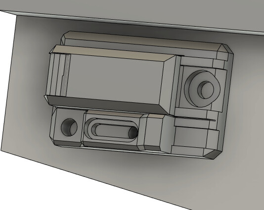

Final Answer:
Front and Rear set. Mirror for the opposite side of the gantry.
Requires 4 of whatever screw you choose for fastening to wood or whatever it is your table is made of.
Additionally, requires 1 M3x6 bolt, 1 M3 heat insert, 1 M5x30 bolt, and 1 M5 nut for end stop adjustment and tensioning.
Let me know if you have any suggestions or if anybody tries it out! I don’t have my table built yet so my real world test will be a bit :slight_smile:
Y Belt Holders.zip (74.7 KB)

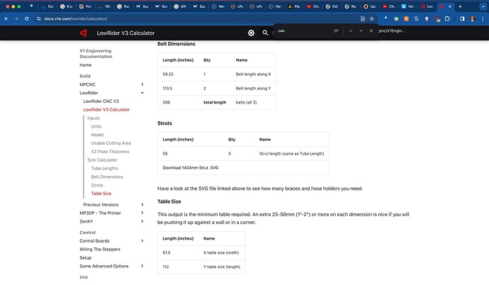

Hey, welcome! In the LowRider Docs, check out the LowRider Calculator.
I recommend inputting 49" x 97" instead of 48" x 96" if you want to be able to also reach full sheet on MDF too. It will tell you the table size needed. For example, I just ran it, and it gives:
Table Size
This output is the minimum table required. An extra 25-50mm (1”-2”) or more on each dimension is nice if you will be pushing it up against a wall or in a corner.
Length (inches) Name
61.5 X table size (width)
112 Y table size (length)

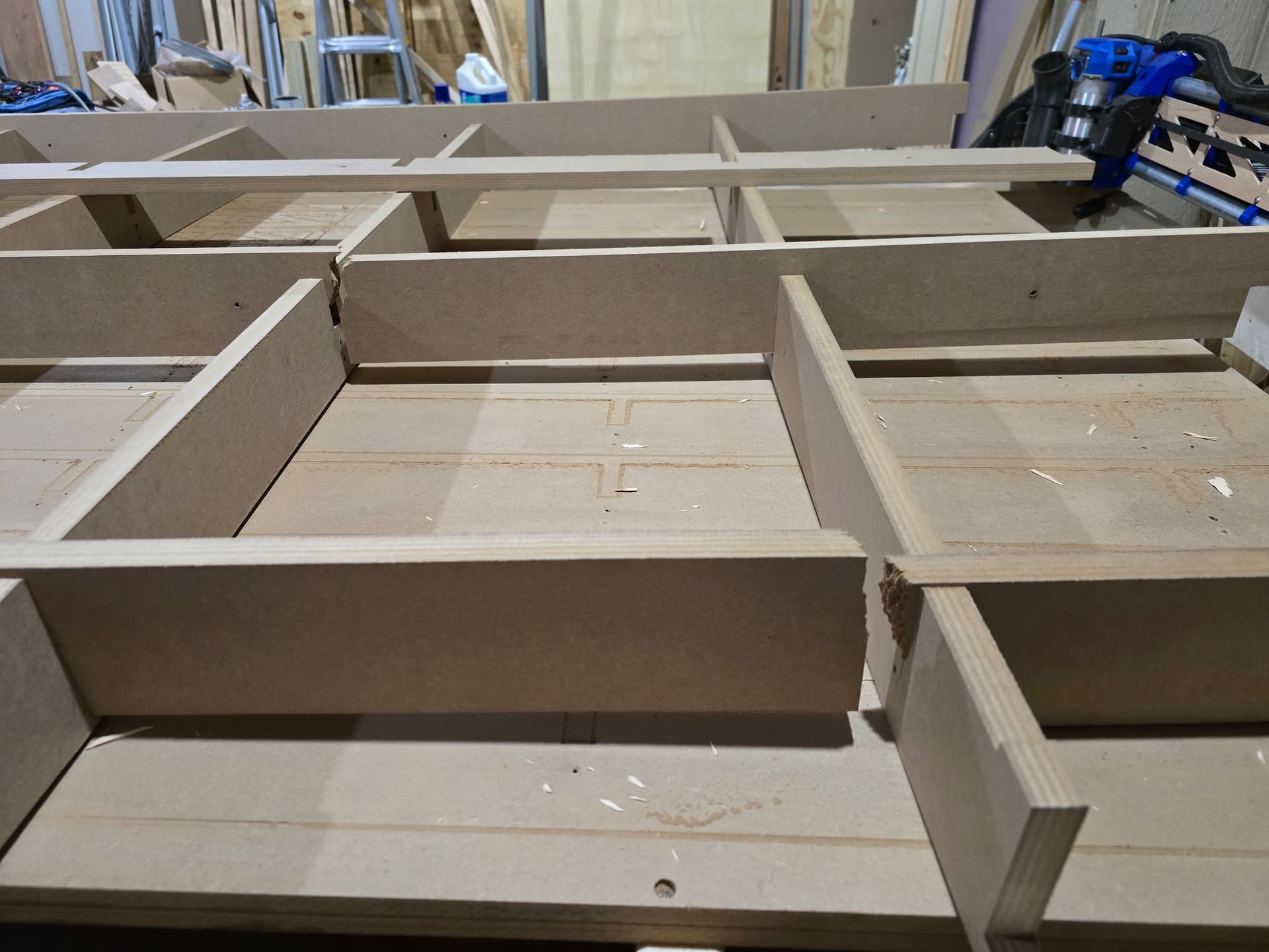

Well, I either made it too tight of a fit or MDF torsion boxes suck. Tried my best to hammer them down evenly but here we are…
Just as I thought I got lucky too because this happened on the very last cut of the box pieces:
I’m second guessing this MDF idea, need to see if I can salvage the pieces that are here and cut out new of the broken ones or call it practice and just cut this out of plywood…
