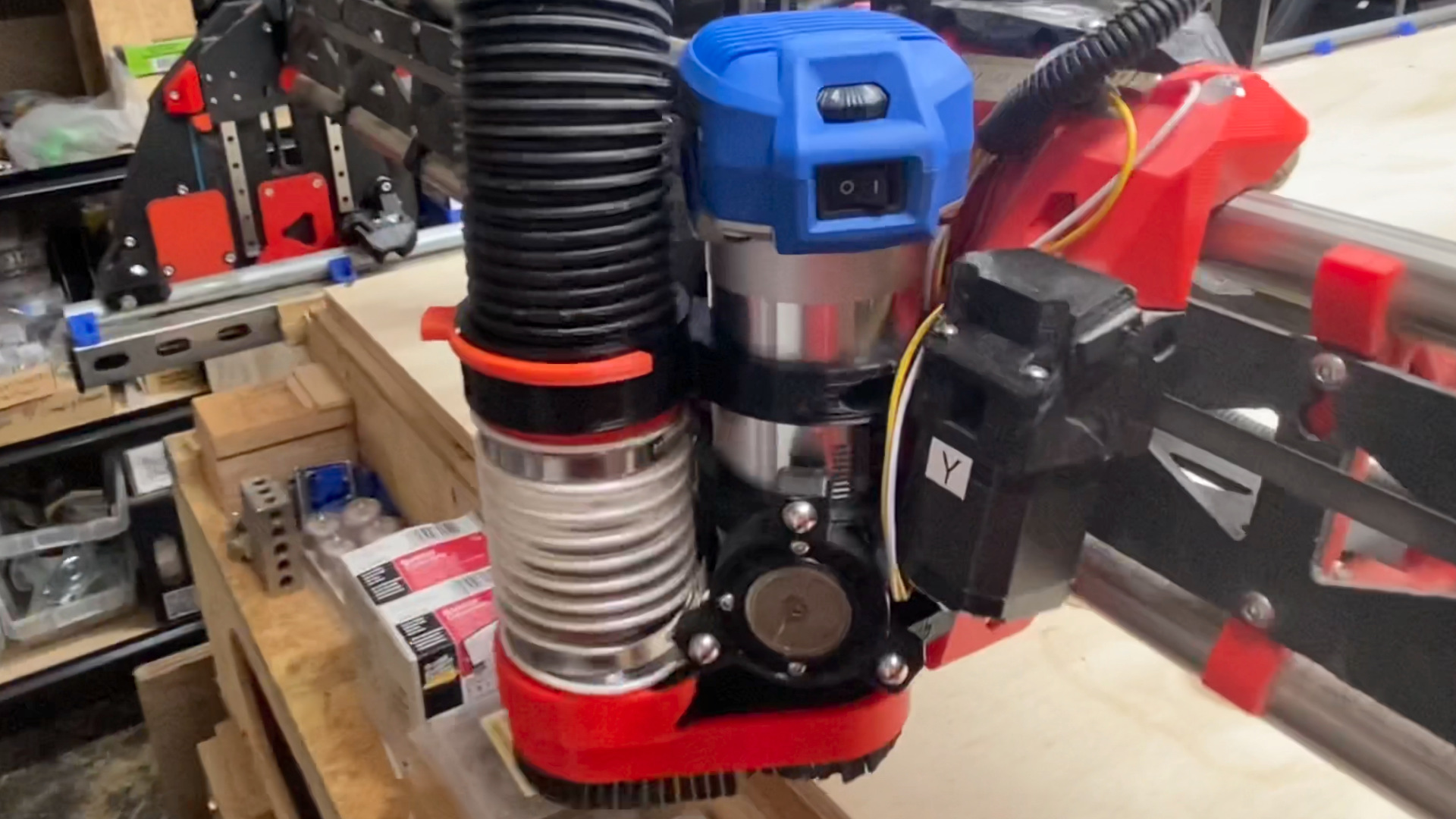

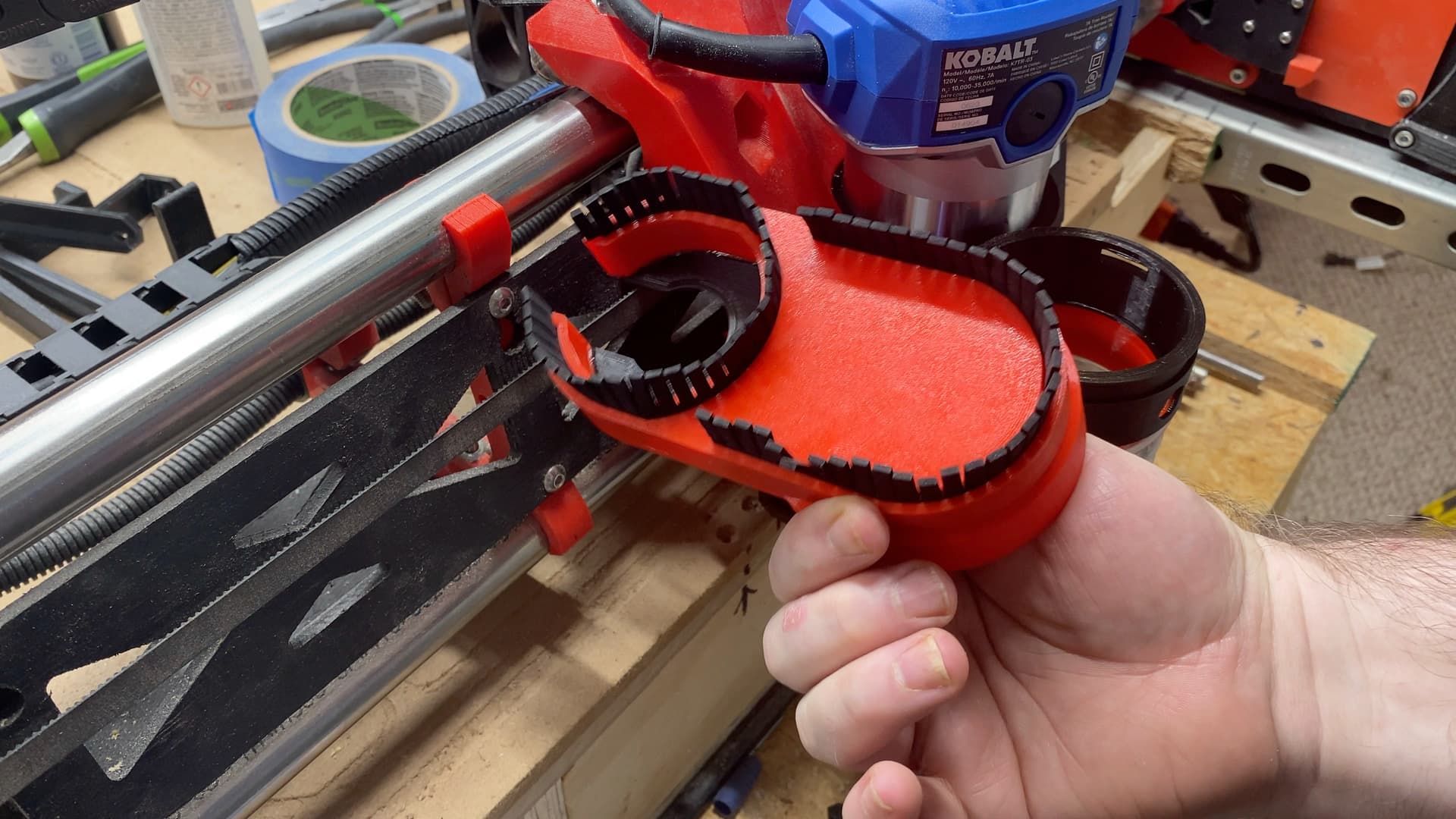

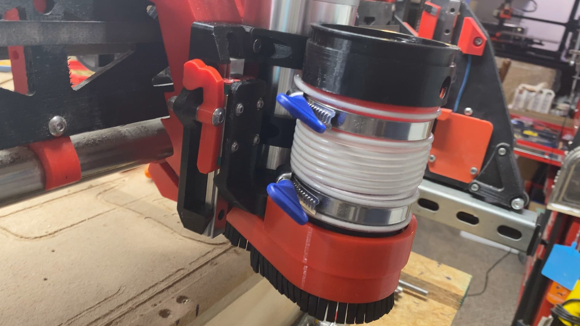

Doug after using mine for the last 20ish days I would sag that a little wider opening wouldn’t be a bad thing. I had a few occasions where it got clogged
I will try to look into that.
So, I checked again just now, and the limitation to how tall the wind tunnel in the shoe can be, is the limited space between the bottom of the router and the bottom of the LowRider core. While there is a “shield / guard” still present in my design, which could possibly be removed, that would gain only a couple of millimeters.
The previous version of shoe, which had a thinner bottom because of only having bristles at the outer perimeter, had about 5 more millimeters of height available to it. I could again re-publish the ones of that version that had wider openings at the bottom!
@Eduardo_Lujan and @Jonathjon
I updated the v1.0 listing on Printables to include the shoe versions with the wider openings at the bottom again.
https://www.printables.com/model/558203-lowrider-v3-floating-z-dust-shoe-and-makita-router
I updated the Change Log as follows:
  • December 6, 2023 — one V1E maker has an issue where his dust collection suction is so strong that the floating-Z shoe keeps getting pulled upwards by it. I offered to re-publish the shoes with wider openings, in hopes it could help him. As such, this design now offers all three of the earlier shoe versions, including option “A” as “¼ open,” option “B” as “½ open,” and option “C” as “full open.”
Thanks Doug. I didn’t have a problem with the suction not letting it go down. I believe that’s because I don’t have that extra shorter piece of hose in there with limited room to move. I think just a little larger opening would do wonders. I did print a full open from the original listing and ran it when I did my surfacing. I would get these “strings” of mdf that would block the opening on the newer one but the full open had no problems. I do think the newest one is better supported with the extra Eva foam. It doesn’t fall flat like the original. I might see about remixing your half open and see if I can add another rib of foam in there to help it not just flatten the foam and ride on the work piece. If I ever get time lol

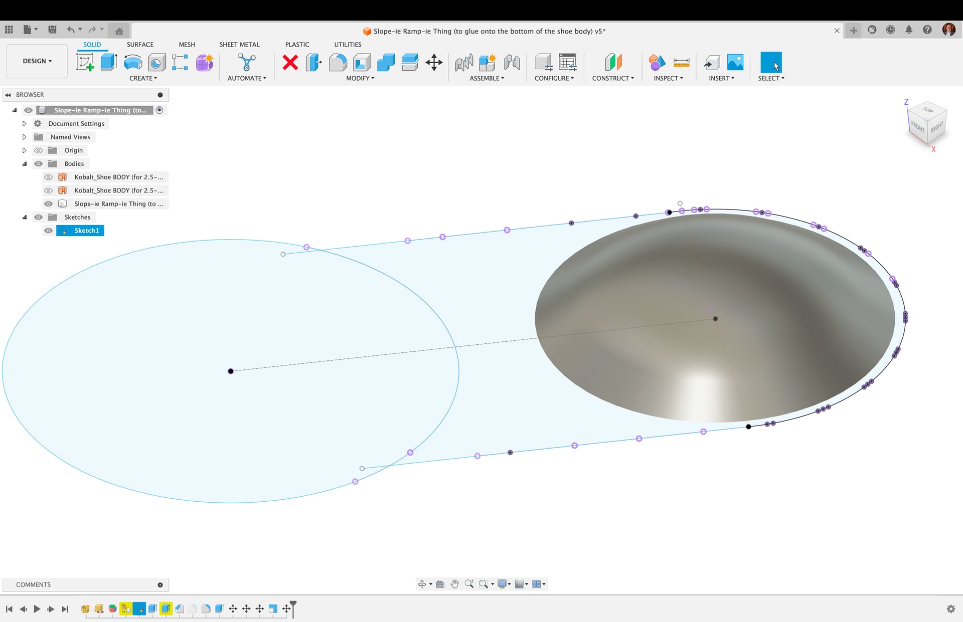

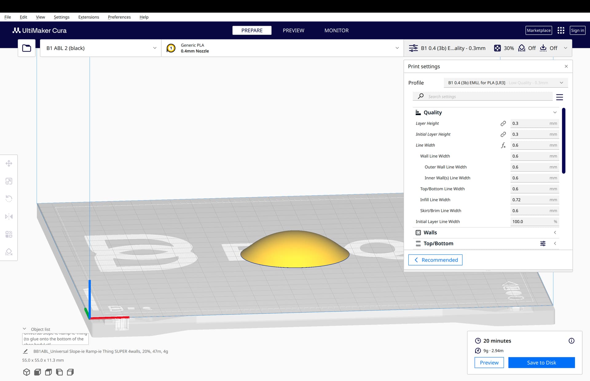

So this new part is a glue-on add-on for the existing latest v1.1 of the Floating Z Dust Shoe. It’s a “universal” part which means it works for all three editions, the Dewalt, Kobalt, and Makita.
Printables download: NEW for 3 makes of Routers - LowRider v3 Floating-Z Dust Shoe and Router Mount, for 2.5-inch Vac Hose (VacMaster Shop Vac) v1.1 by Doug Joseph (design8studio) | Download free STL model | Printables.com

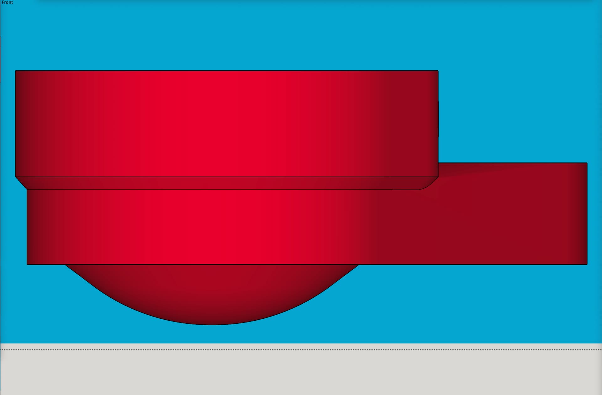

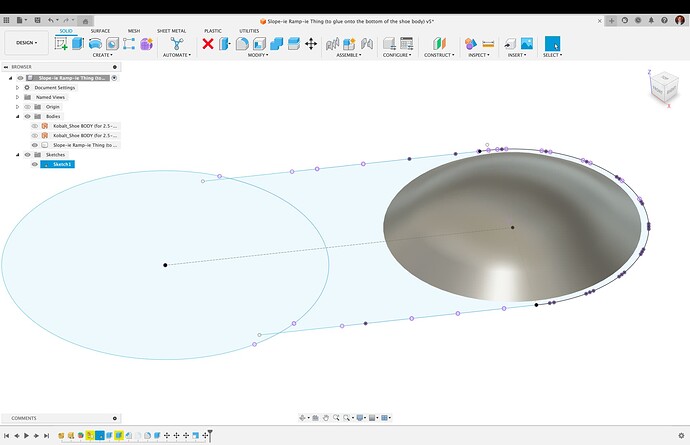

It’s a slope-ie, ramp-ie thing to glue onto the bottom of the floating Z shoe body, to minimize the surface area that “sleds” and to keep the bristles from getting splayed out because of the shoe bottoming out.
Design in F360 (sketch represents upside-down shoe body, i.e. the bottom of the shoe):

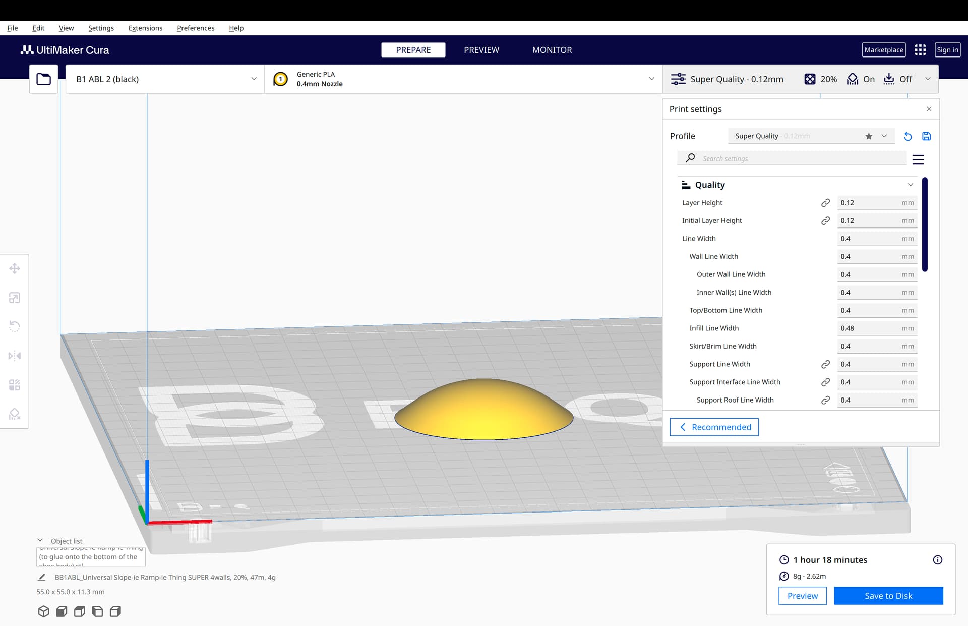

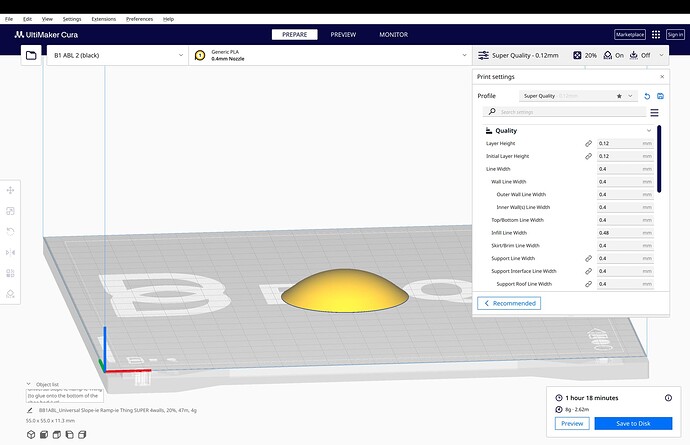

It can be printed in any layer height you wish, with thinner layers meaning a smoother, better slope-ie, ramp-ie thing, but taking longer to print. My 0.3 layer height profile could have printed this in 20 minutes…
…but I chose to go to the “super quality” to print it with 0.12 layer height, and that showed as taking 1 hour and 18 minutes:
The idea is just print it, and CA glue it onto the bottom of the shoe. It should then sled on the material, and keep the shoe from bottoming out, and keep the bristles functional. If it collides with any obstacle, hopefully it will sled right over it, because of its slope-ie, ramp-ie sides! Below are images showing what the shoe looks like with it added:
