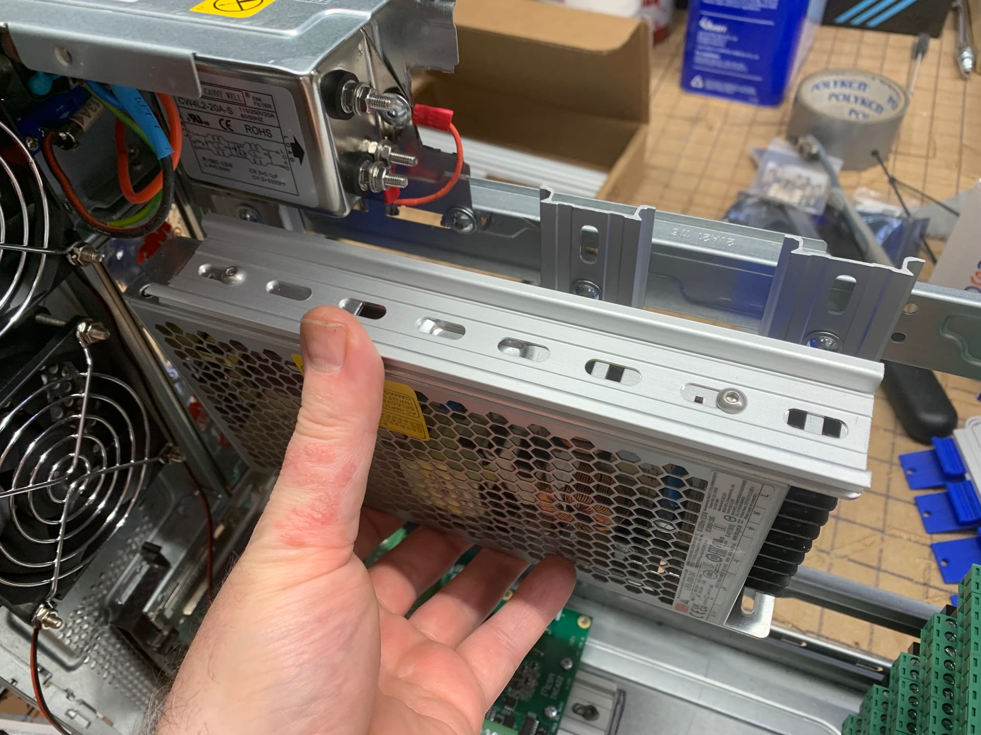

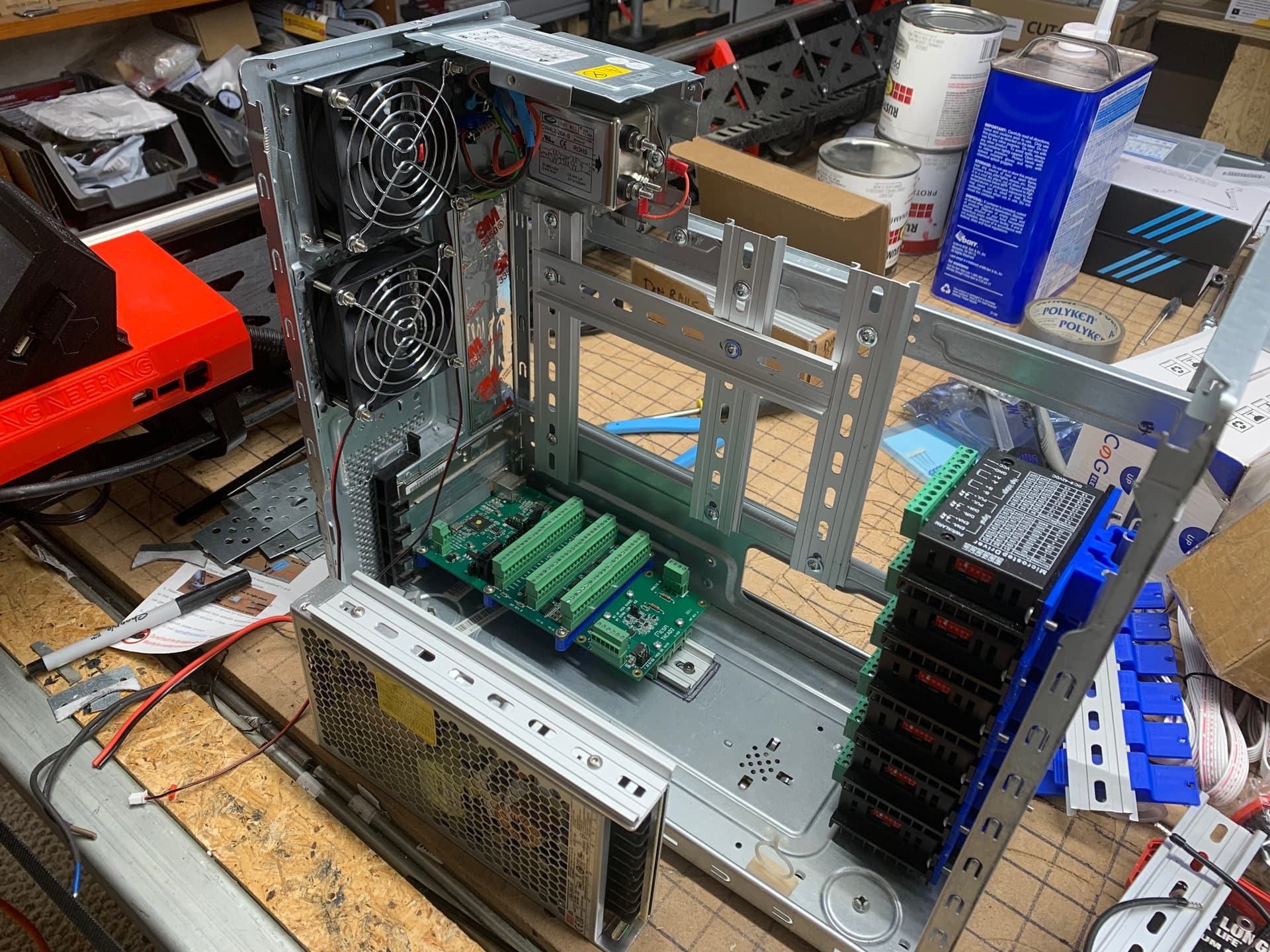

Another micro update. More progress on my control box. Now have the 13 A fast blow fuse, EFI filter, 5 V power supply, 24 V power supply, two cooling fans, both of the Mesa parts, which consists of a control board and a THC board, and all of my stepper motor drivers in place, but I still need to run the wires within the board. Beyond that my next task on this control box will be generating a panel for the front that will have aviation style connectors for the various wires that need to communicate to the plasma cutting table. I have not been able to sink a lot of time into working on this which is why it has been delayed and progress is slow.

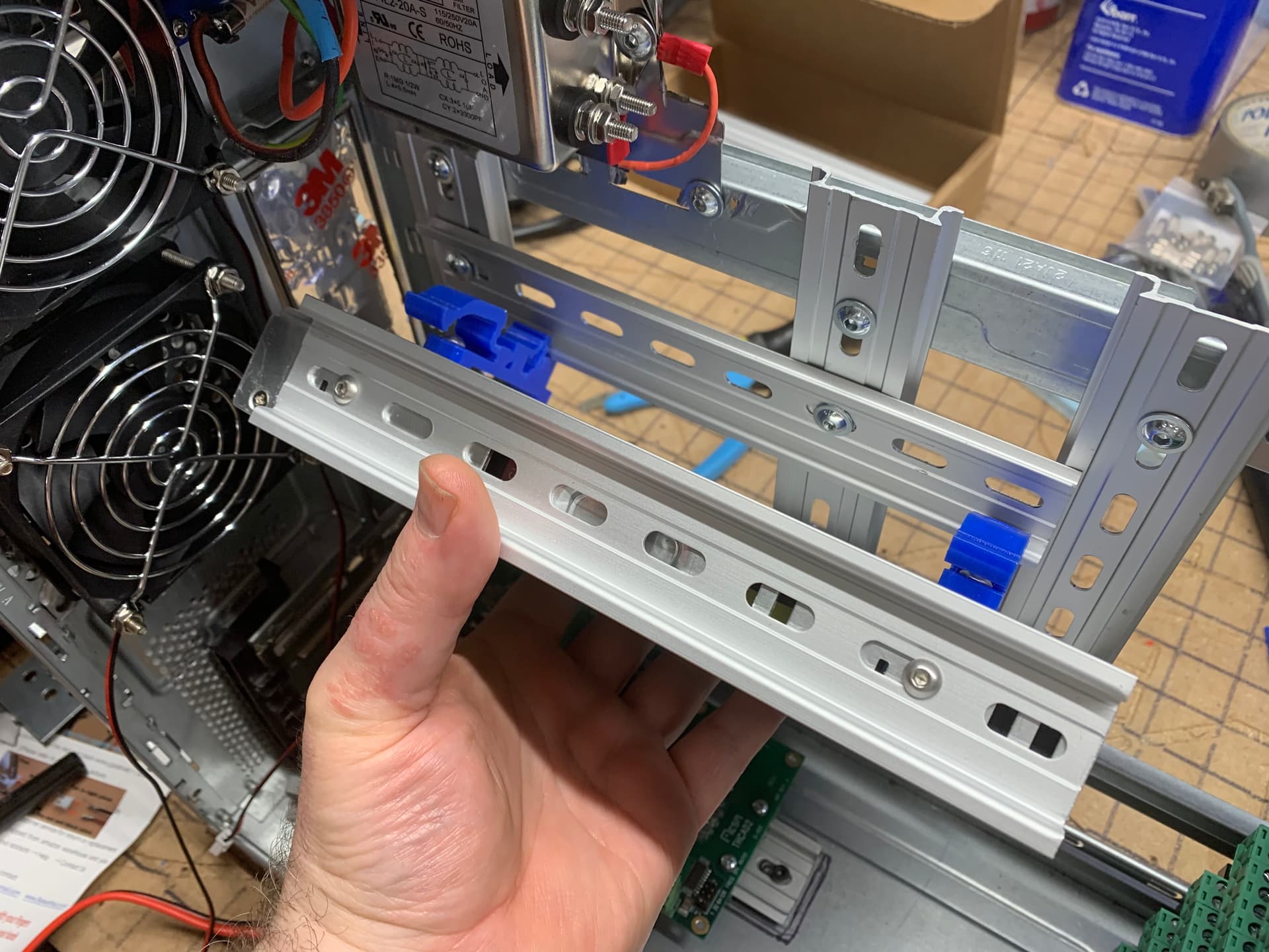

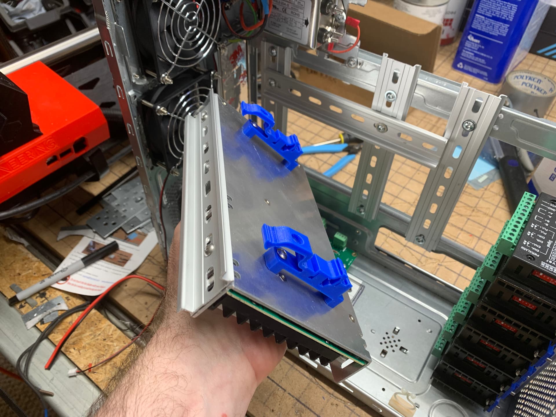

PS: Photos below show a DIN rail mounted on the larger power supply, but in the end I did not use that because it added too much height on the other power supply.

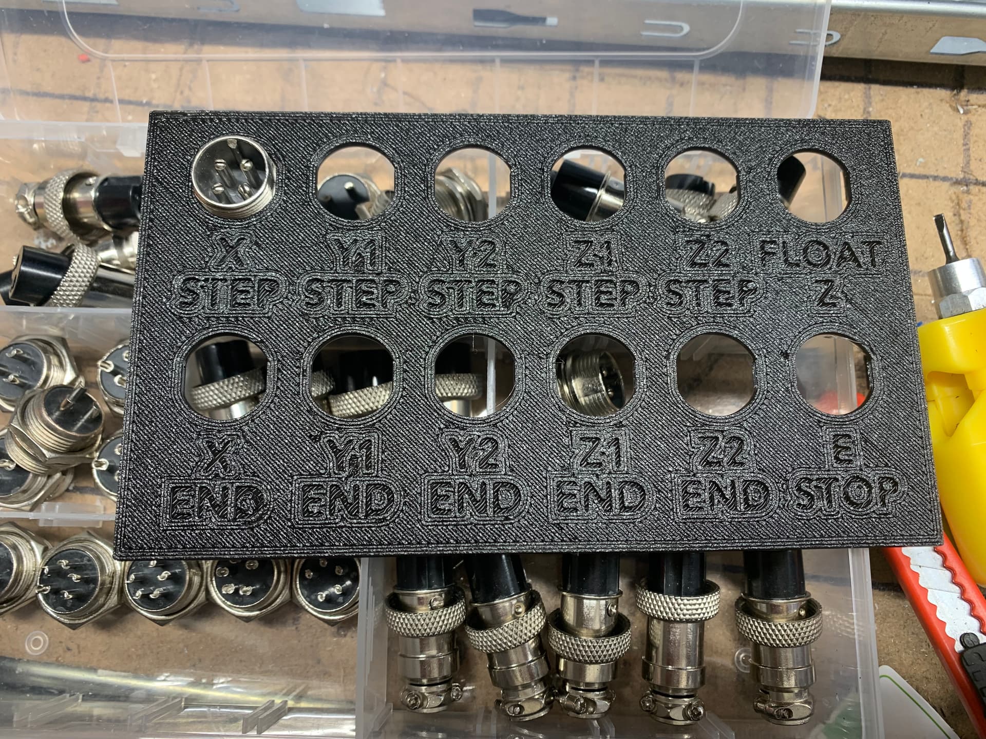

That’s are really nice print. I’d fill the writing with something white (paint pen, nail polish, white-out, etc.) for ease of reading.
If you’re relying on the metal outer shells of those connectors for bonding or grounding, you may want to add a strip of aluminum tape (commonly used for hvac ducting) on the back of your 3D printed plate so that it can be bonded to the rest of your system. Doing this helped with maintaining shielding on my cables into my plastic enclosure.
@ttraband Thanks for the tips!
My plan on the white lettering is to use the silicone method described here:
Re. aluminum tape
I have some and had already been using it to plug holes in the old PC tower case I’m using, so the cooling fans would be more effective. Seems easy enough to do. My metal case is itself grounded. Power supplies and EFI filter are grounded as well.

I gutted an old desktop PC tower for the control box for the CNC plasma I’m building, which is based off of the V1 Engineering LowRider v3 for its motion control system. I custom designed printable replacements for the plastic covers over the bays where the CD-ROMs and disk drives used to go, in order to position aviation-style quick connectors for the various wires for stepper motors, endstops, etc.
Note: the holes for the aviation-style quick connectors are not completely round, but rather are what are commonly called “double-d” holes, with sides lopped off to match the connectors. It is intended to keep the connectors from spinning once installed.
