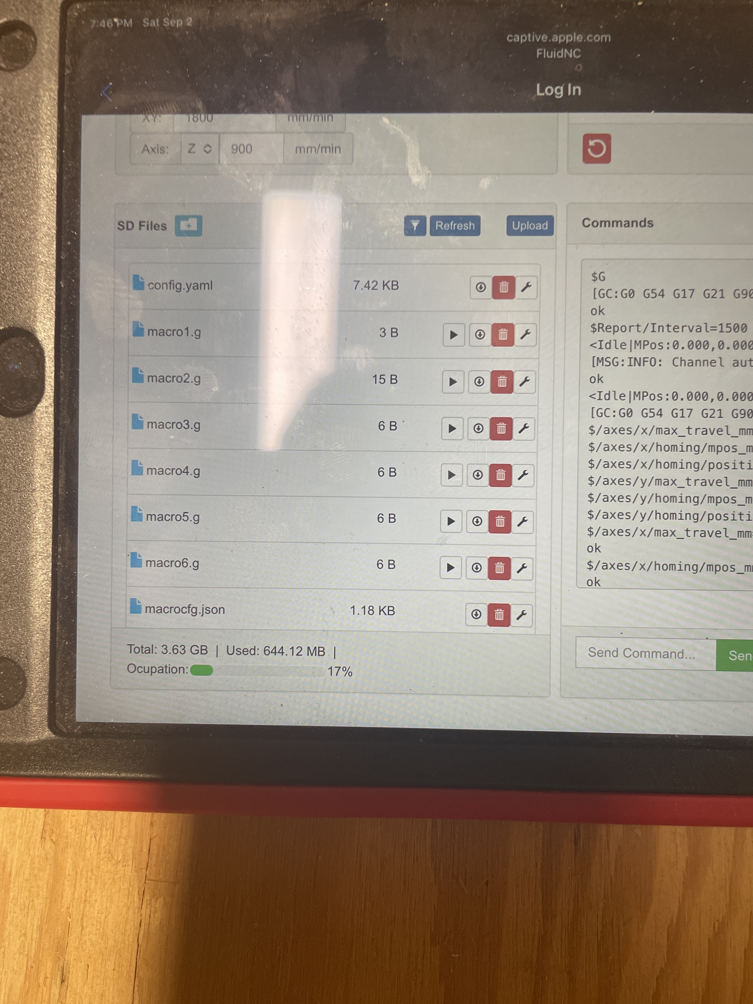

I thought the same thing, that I must have made a mistake, but this is the file directly on the SD card:
and there’s only 1 motor defined for X:

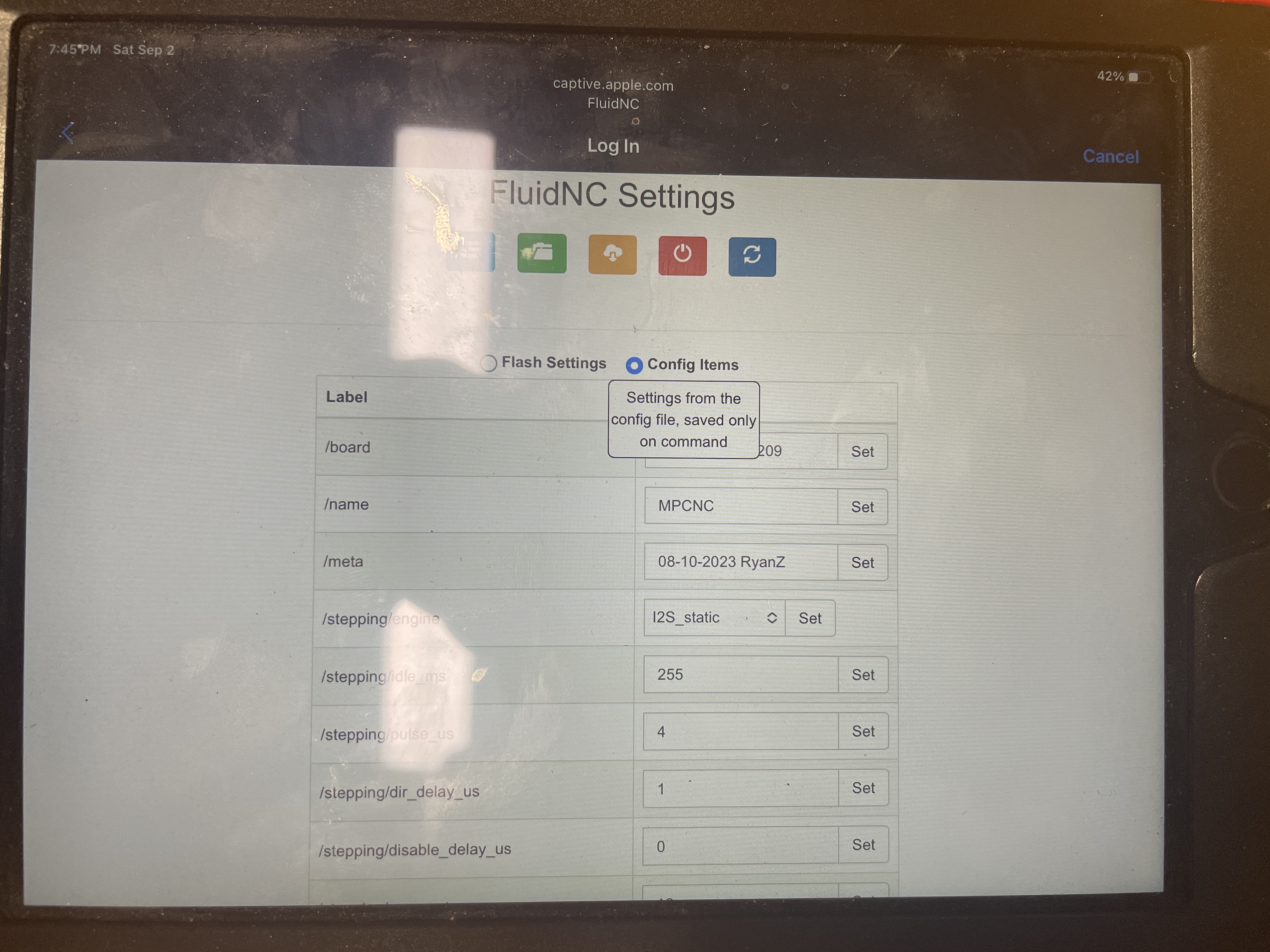

Ok, so config items say MPCNC instead of LowRider
It can see the SD card
I wonder why it isn’t loading the config.yaml

Startup messages show MPCNC. I reformatted the SD card and made sure nothing was on it except the contents of the LowRider folder from GitHub. No change.
It does see and show the Macro config, but I can’t tell if that’s just because that’s what was flashed rather than because the macro files are on the card.
The config is stored in the microprocessor Flash according to FluidNC Wiki
Right, but my understanding is that it should load the config.yaml and override the settings that are flashed

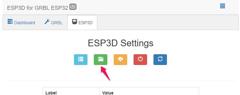

It’s been a bit since I was messing with my config but it needs to know where the new config is located here $Config/Filename=yourfilename.
Delete your current config.yaml file. Upload the lowrider config.yaml file power down, wait a minute and power up. That should load the right config.
I should not have gotten that wrong. Very sorry.
Just use the built in file browser, you can do it all from your computer and the web gui.
Delete from the SD card? The SD card already has the LowRider one on it.
Or do you mean something else?
It only uses the one on the device. So if you have one on the SD it doesn’t matter.

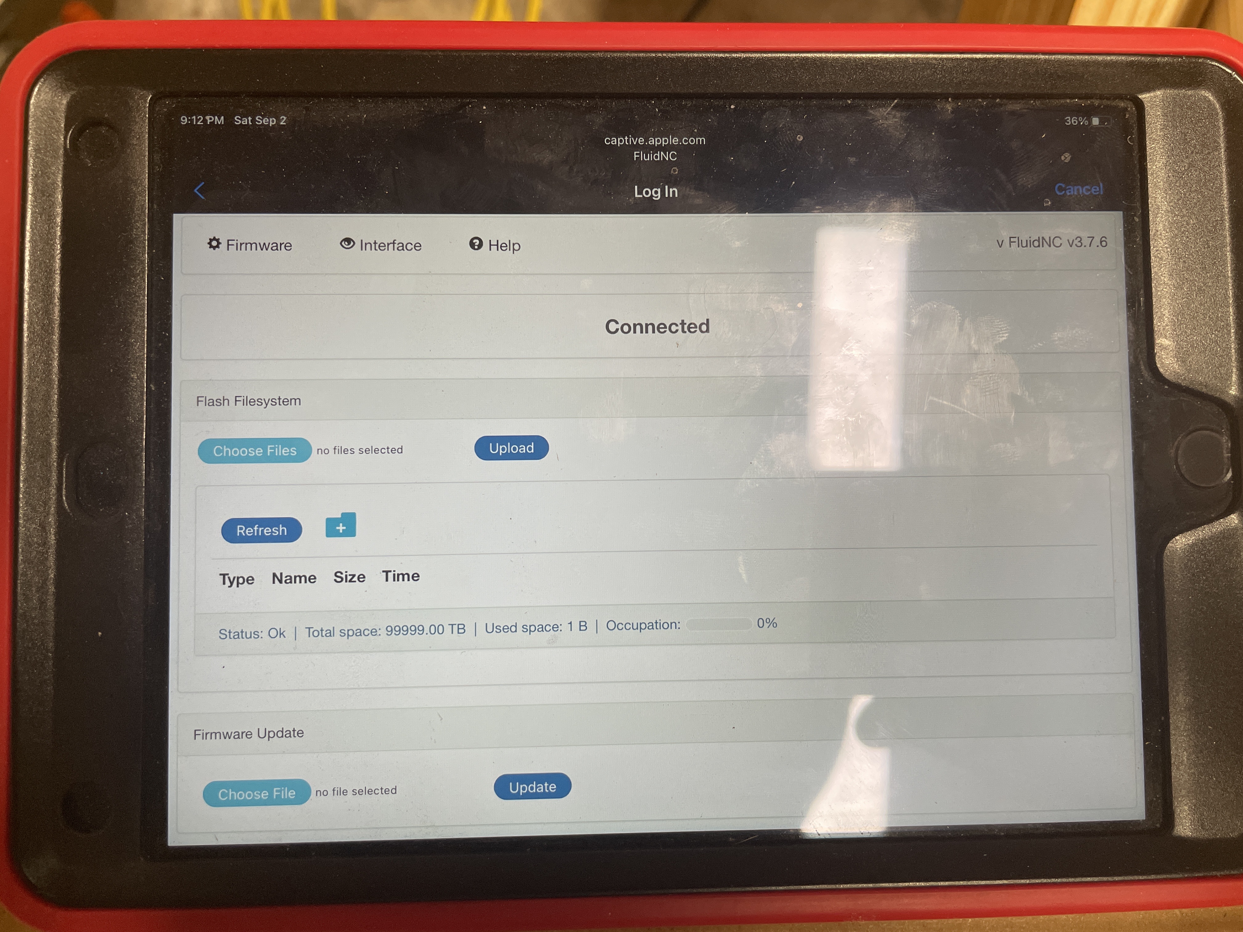

So, I went to the config and changed a config setting. The Y-Axis was configured to Home in the negative direction instead of positive.
I change that value and clicked Set.
Now this is the screen I get:
So now I don’t know what to do to get it back.
I guess I should have changed the yaml and re-uploaded it, but I didn’t expect changing a setting to wipe the filesystem
Edit: I rebooted it again and it came back now…. 3rd times the charm I guess
