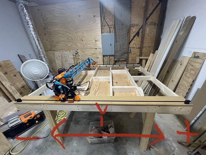

For me, my machine is configured like this for Y:
Hitting Y+ in FluidNC would move it to the right, but Home would move it in the negative direction, which is opposite of the end stops.
Is this backwards? Should I flip my motor plugs?
That same thing happened to me early on when setting my Jackpot for a JL1 laser set up.

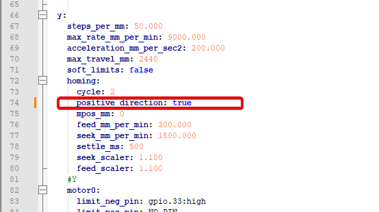

Can you poste your config.yaml in </> so we can review it?
Edit to add: The only way I’ve modified configuration is by editing a copy of my config.yaml and then re-uploading that to the root of the device. I,too, had weird crap happen when editing the default config (the one that gets used if there isn’t a config.yaml found.) don’t do that. (Now Ryan tells us to use his save macro… :slight_smile: )
Yes and yes
It’s the one in the Github. No changes…except I now changed:
positive direction: true
It’s positive direction: false in Github
Will do that tomorrow and revert the config.yaml change.

Be sure that you have a consistent coordinate system.
As per the docs, Y should be reversed as Ryan said, so that Y- moves to the right and Y+ moves to the left. So far so good.
To go with that, X- should move towards the camera and X+ should move away from the camera to go with that. Home should be to X-
If you have one axis reversed, it will cause your machine to cut everything in mirror image.
Yep, that’s why I asked.
I assumed I would not get correct cuts if it wasn’t right. X and Z were correct and homing correctly to the switches.
Initially in my wiring, the Y’s were moving in opposite directions. I chose +Y that way because I guess it just made sense to me, but I don’t remember ever coming across a place in the docs where that was mentioned.
