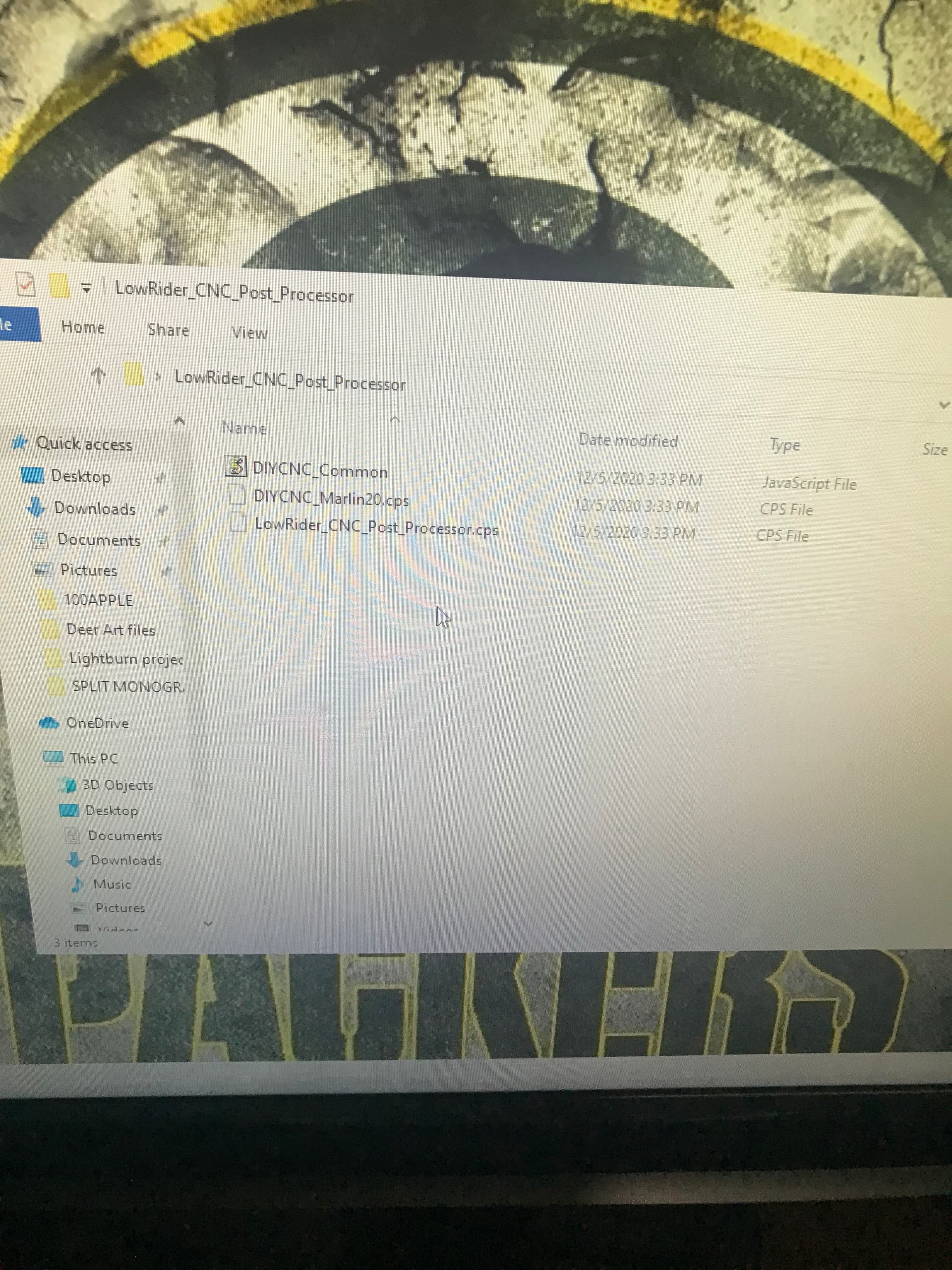

The guy I bought this from had 3 files he sent me. I don’t know where I post those.
Here are those
In short I’m unsure if I need to pick the machine confit to generic 3axis and then >post >library and > select grlbl for the milling post.

Assuming you are running a control board with Marlin firmware, none of the prepackaged Fusion 360 postprocessors will work. You will need to install a new postprocessor. You can find a download link in this topic.

The three files that i listed, where do you drop files from the zip folders?
Fusion 360 forces you to stay up to date, so you will have the latest version. The easiest way to install the postprocessor is to unzip the files to a known place on your computer. Then in Fusion 360 in the Manfacture workspace:
You click on the “G” icon on the tool bar bringing up the dialog, then click on the highlighted icon to import the postprocessor. If for some reason you want to do this by hand, I can look up the file location where you must put the files.

Alternately you can copy the files(s) directly. You can put them in:
C:\Users\[USERNAME]\Appdata\Roaming\Autodesk\Fusion 360\CAM\Posts
Note that the “Appdata” folder is hidden, so you have to turn on “Show hidden files…” in the file browser to see it.

When I went to the folder that I created with the three he sent me. Only two show up ??
Neither one of those files open anything up so guessing something wrong with those?
Okay so I clicked on our previous file suggestion from flyfisher604. Unzipped the file and then saved to desk top. Believe he has config this to work with the lowrider as well? I dropped it in. It took the file. From here what is the best way to get it and so it’s saved? That way this doesn’t have to be repeated. Do you click run without restrictions? Do I have to edit the selected or just hit export selected?
