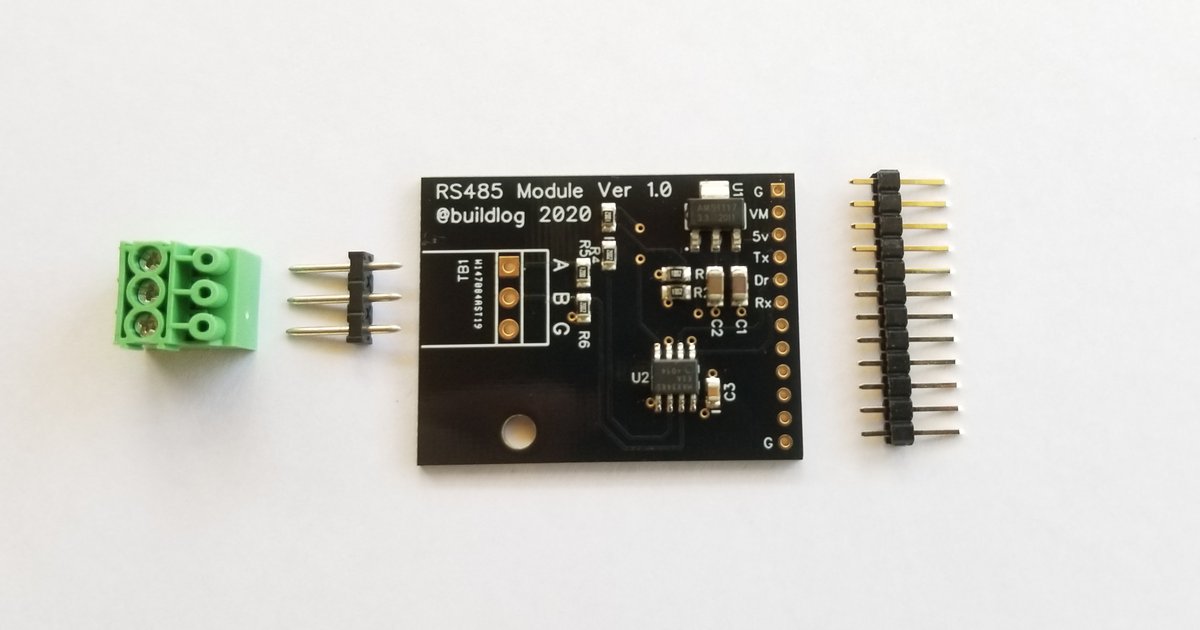

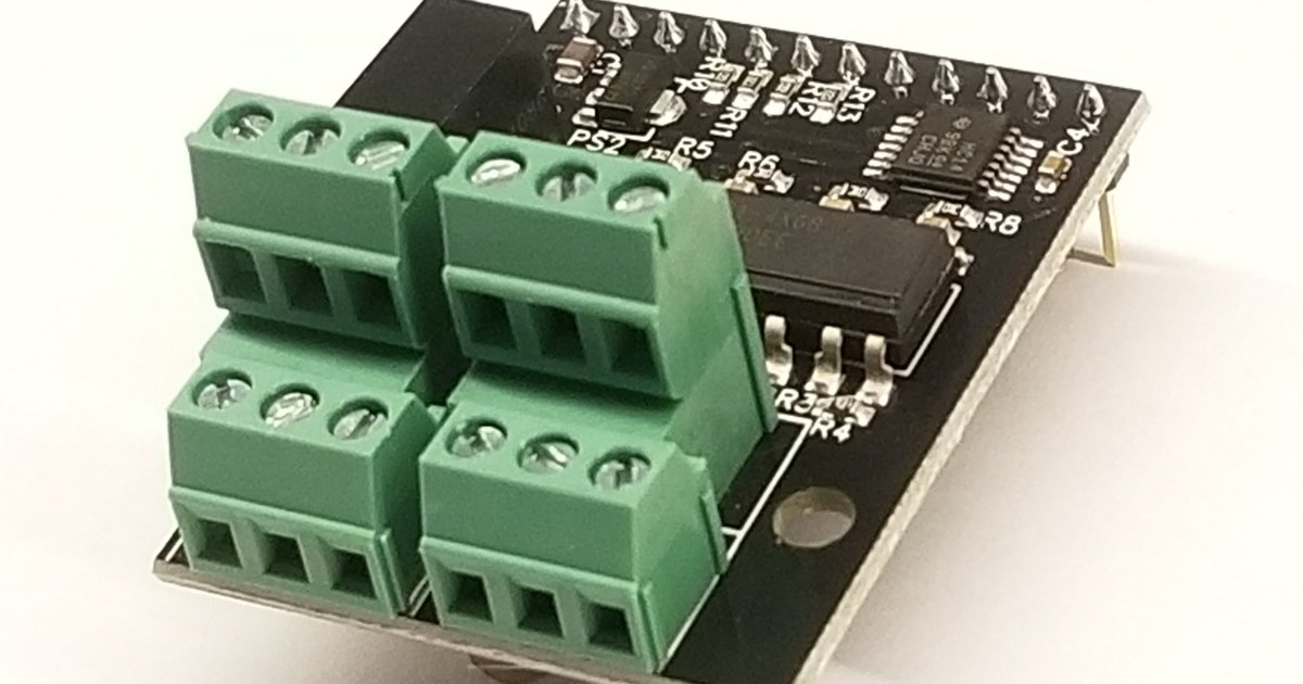

I recently upgraded to a 2.2kw spindle with inverter. I am currently controlling the speed manually from the inverter because my controller can’t. So…time for an upgrade:

I will need 2 4-input modules:
To control the spindle speed I am going to use a RS485 module:

My spindle is air cooled. I just didn’t want to deal with the water lines and pump. I think the water cooled spindles might be easier to find. My VFD is 110V. If I had it to do over I might choose the 220V VFD. My VFD offers three options for speed control: 5V PWM, 0 to 10V and RS485.
