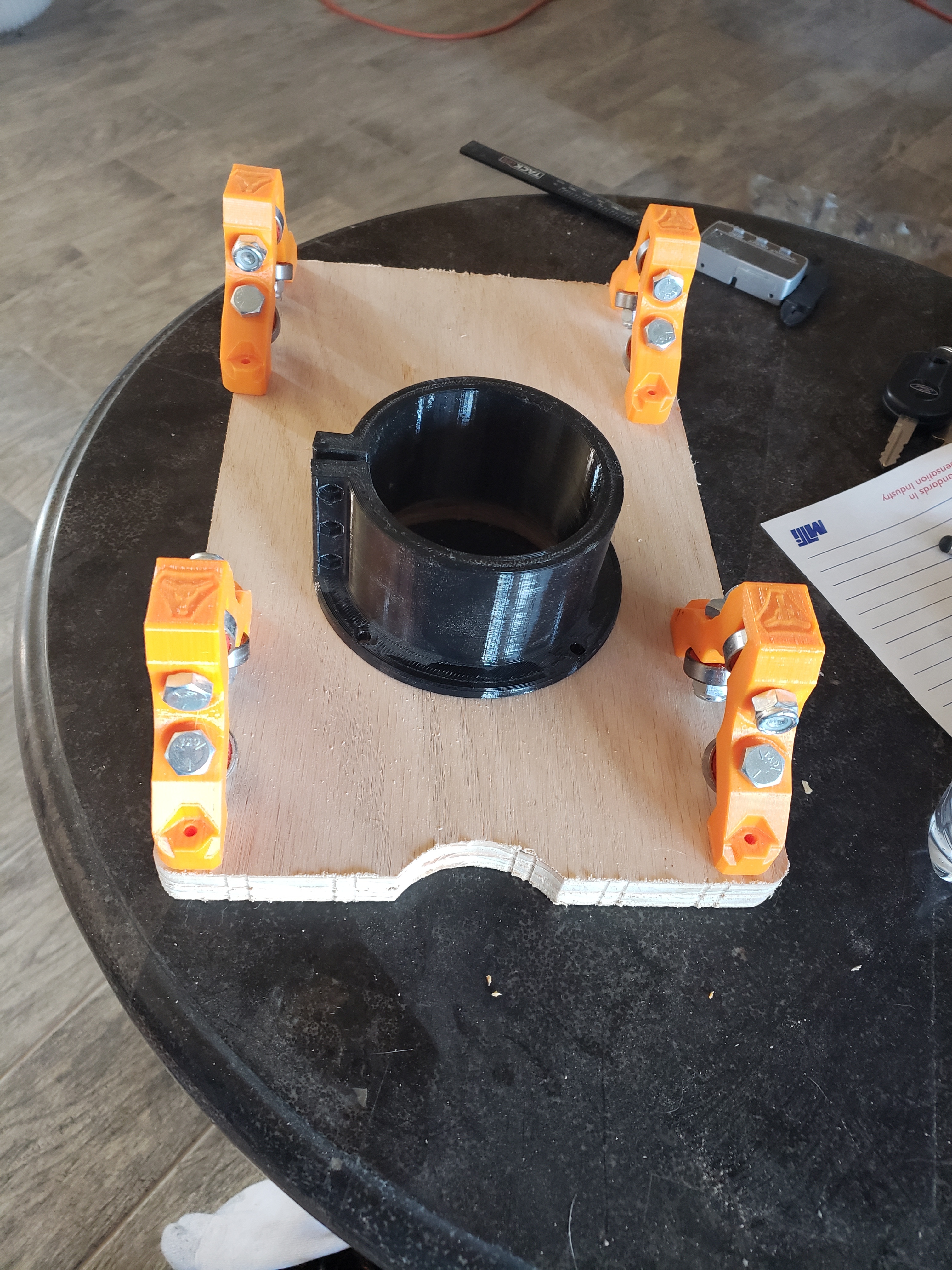

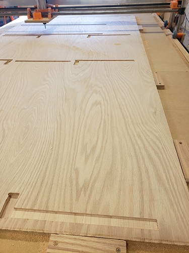

My job has slowed me down. Time to pick up the pace this weekend. I got it reassembled yesterday and started dialing it in today.my first cut was at 1/4" DOC to check for dimensional accuracy. Spot on. Then I ran another test at 3/8" DOC to check for chatter. NO CHATTER along the X axis. There was a little chatter in one direction along the Y axis. I think I need to tram it again. Finally I cut a couple of my new Y plates at 1/2" DOC. I borrowed my wife’s camera and tripod to record the 2nd cut and uploaded the video to my Google drive:

3/8" DOC, rough and finish passes…
Looks really good, however I’m noticing some judder or racking in the tool head as I
watch the video.
It looks easy to counter though with another set of 4 - LR2_X_mount mounted to the
underside of a skeletonized top plate ~330mm x 200mm and then connected with
threaded rods through the bearing carriers to tension the whole assembly as a box frame.
I mentioned the judder in an earlier post. It is prominent in only one direction. I don’t think the spindle is trammed accurately on one axis.
I have a similar solution in mind after I finish assembling my kitchen island.
In regards to the potential tram/judder issue I’m interested in seeing how your solution works out. I’ve experienced the Y-axis pitching under load especially when near the midpoint on the X-axis. To counter this I increased the tube thickness to 0.083", however I haven’t eliminated it completely.

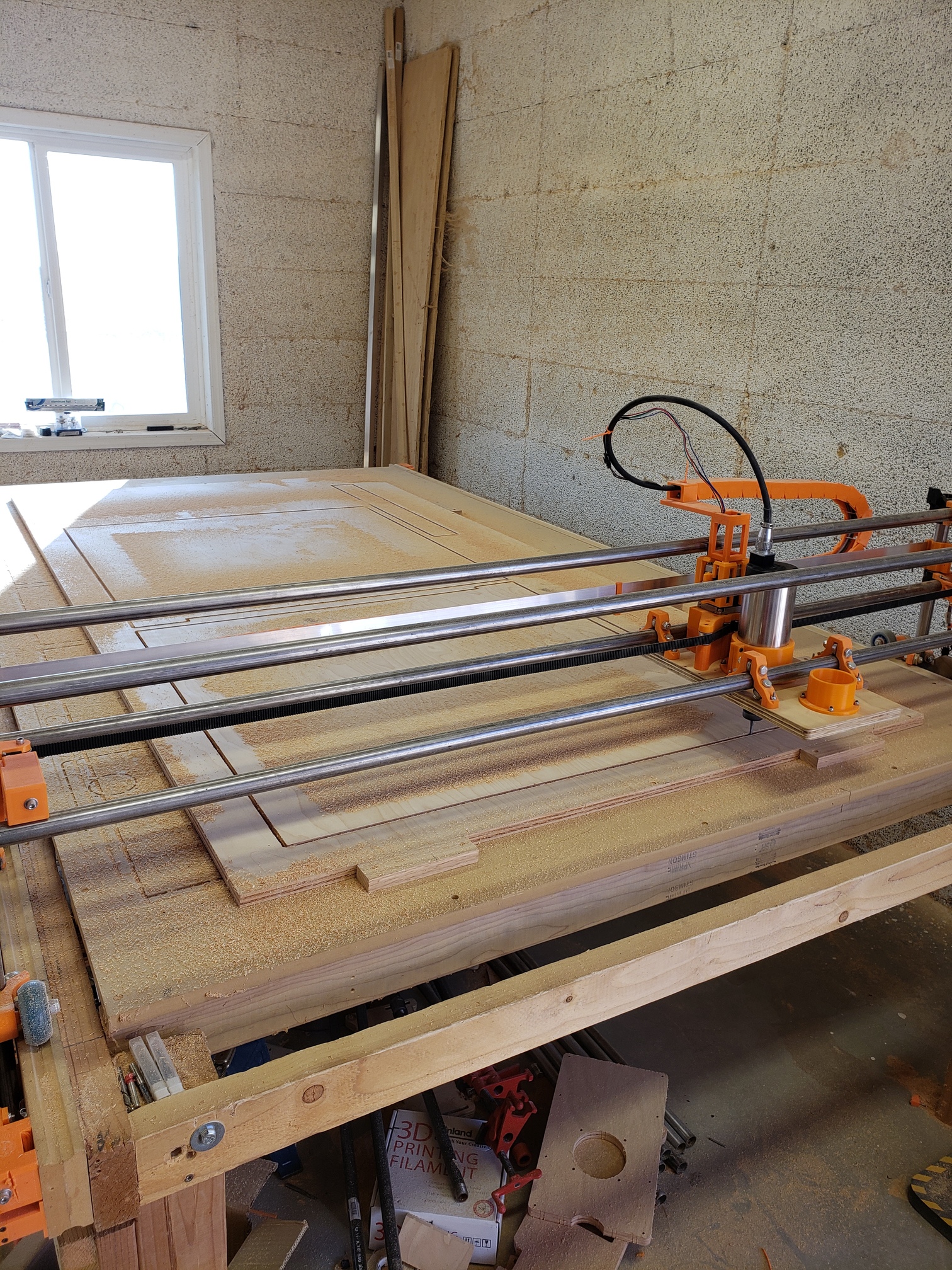

I finally had some time to work on upgrading my Lowrider yesterday and early this morning before work. I replaced both Y plates because I inadvertently changed the geometry incorrectly while widening the plates for the vertical X motor mount and butchered them with my jig saw just get the Lowrider functional enough to cut good plates. I added a 2nd pair of wheels to the bottom of each plate to ride in the matching groove on the bottom of the Y rails. I added a 2nd gantry plate to the top X-axis rails including a spindle mount to secure the top of the spindle.

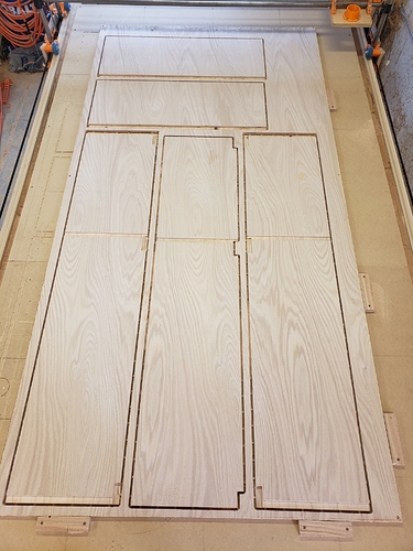

I needed a few internal supports for the hollow columns I am installing from my new island to the ceiling. I cut 3 pieces using a 1/8" upcut end mill with DOC at 3.175mm, 6.35mm and 9.525mm. Then I changed to a 1/4" straight end mill and cut 2 pieces with DOC at 6.35mm and 9.525mm. Finally I cut 1 piece with the same final settings just to record it (about 3 minutes). All cuts were at 1000mm/min. I am uploading it to my shared Google Drive folder now. At the rate it is going it should be there in about 1.5 hours. It was recorded using my Note 9 so it’s not the best quality video. The link is:

For kicks I decided to make some mods, just to see what would happen. I’ve been seeing more 4-tube gantry lowriders lately (Like the Tom’s Nema 23 beast) and thought why not. Presently, I’ve run some tests and the 84 oz. in. Nema 17 steppers seem to work although I’ve yet to run any meaningfully dangerous speeds/feeds.
What’s been altered from stock:
  1. 2 Nema 17 84 oz. in. steppers on the X-axis instead of one.
  2. 4 tubes (like seen in this thread and elsewhere)
  3. Added a top X-Axis center assembly (no steppers, just X-Mounts)
  4. Joined the the X-Axis X-Mounts (I believe this will help with the pitching I observe during Y-Axis cuts)
  5. Increased the stepper motor digipot current to 230. Plastic hasn’t been a problem though I’m still monitoring temperatures. Ambient has been fluctuating quite a bit the last several days.

I’ve completed my 4-tube variant and must say it is much more rigid on the short axis (x on mine).
I’m calling it “The Sandwich”
