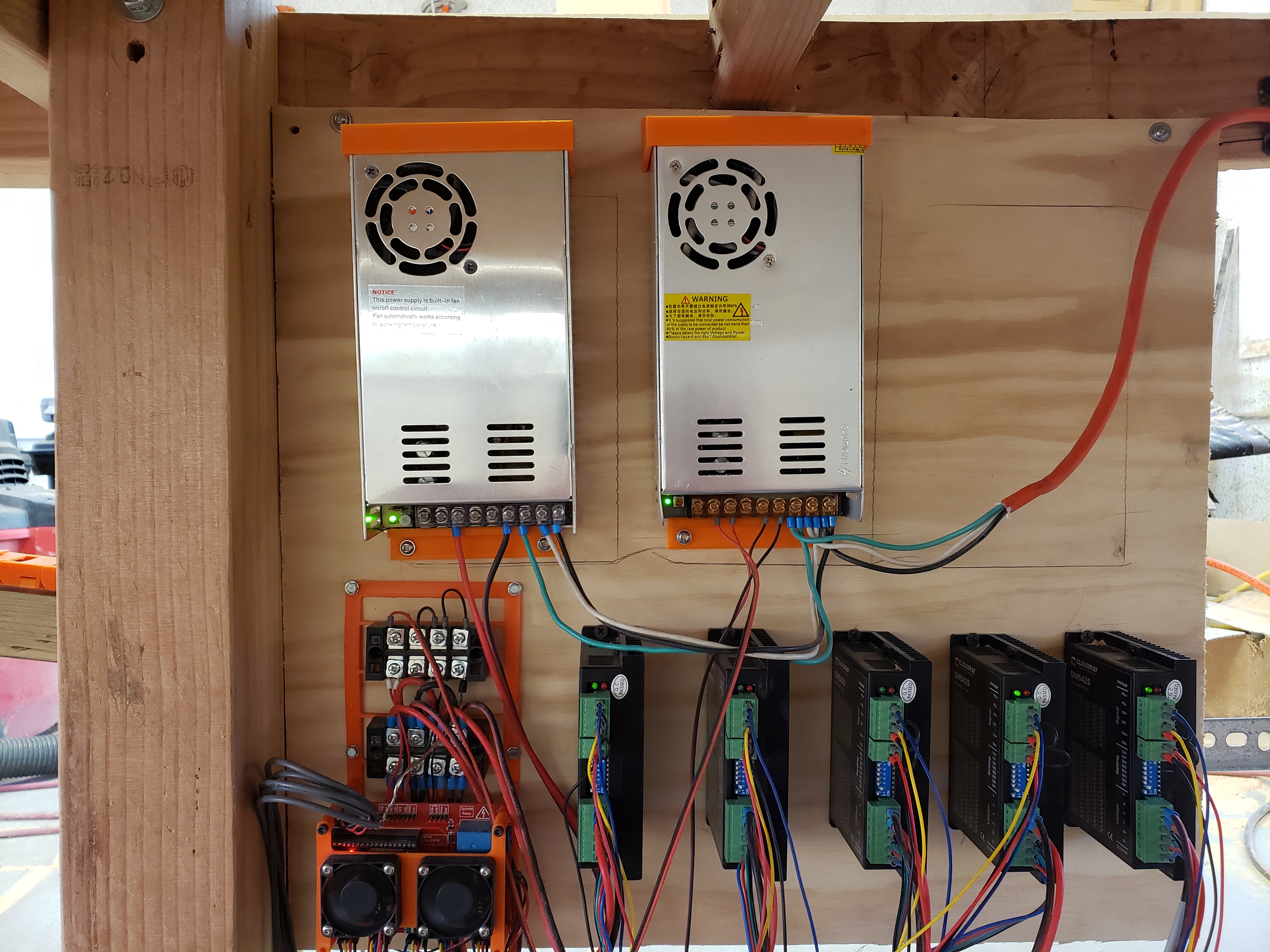

I just finished upgrading my Lowrider 2 to NEMA stepper motors last night. I will begin running it through its paces later this morning. My NEMA 23 parts are based on Ryan’s original NEMA 17 parts. I am using Bart Dring’s MPCNC ESP32 board with his external driver adapters.
That looks like an awesome setup. Those motors are huge! How are you liking the Bart board? Did you use the low rider configuration as-is, or did you have to configure anything for it?
The only change to Bart’s board was the steps per mm: 640 steps for X and Y and 3200 steps for Z. The external drivers are configured for the max pulses: 25600. I am using the WebUI interface on my ASUS tablet to control the CNC.

I was wondering what voltage you are running your drives at? I am working on a Lowrider2 and have bought the db6600 drives. I am planing on running the drives at 42 volts as it almost quadruples the max rpm over 12v. I’m going to use the nema 17’s to start.
I am powering Bart Dring’s custom controller for the MPCNC/Lowrider with a 24VDC PS and 5 external drivers (DM542S) /NEMA 23 steppers with a 36VDC PS. I am connecting these with Bart’s opto boards in the controller’s stepper sockets.
