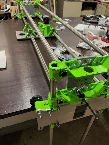

Hmm… how are you going to tension your X-axis belt?
I think, I have to print the two plates for the x axis. I have no other idea for the x axis belt tensioner.
Your double x-mounts looks great to combine the double x-axis.
My x-axis belt tensioner is easily to see in the 3rd picture I posted yesterday.
I think, I will mirror the tensioner, to use a pulley/idler without tooth.
Why, you have the metal plate on the double-X-Plate?
Extra rigidity for my X-axis belt.

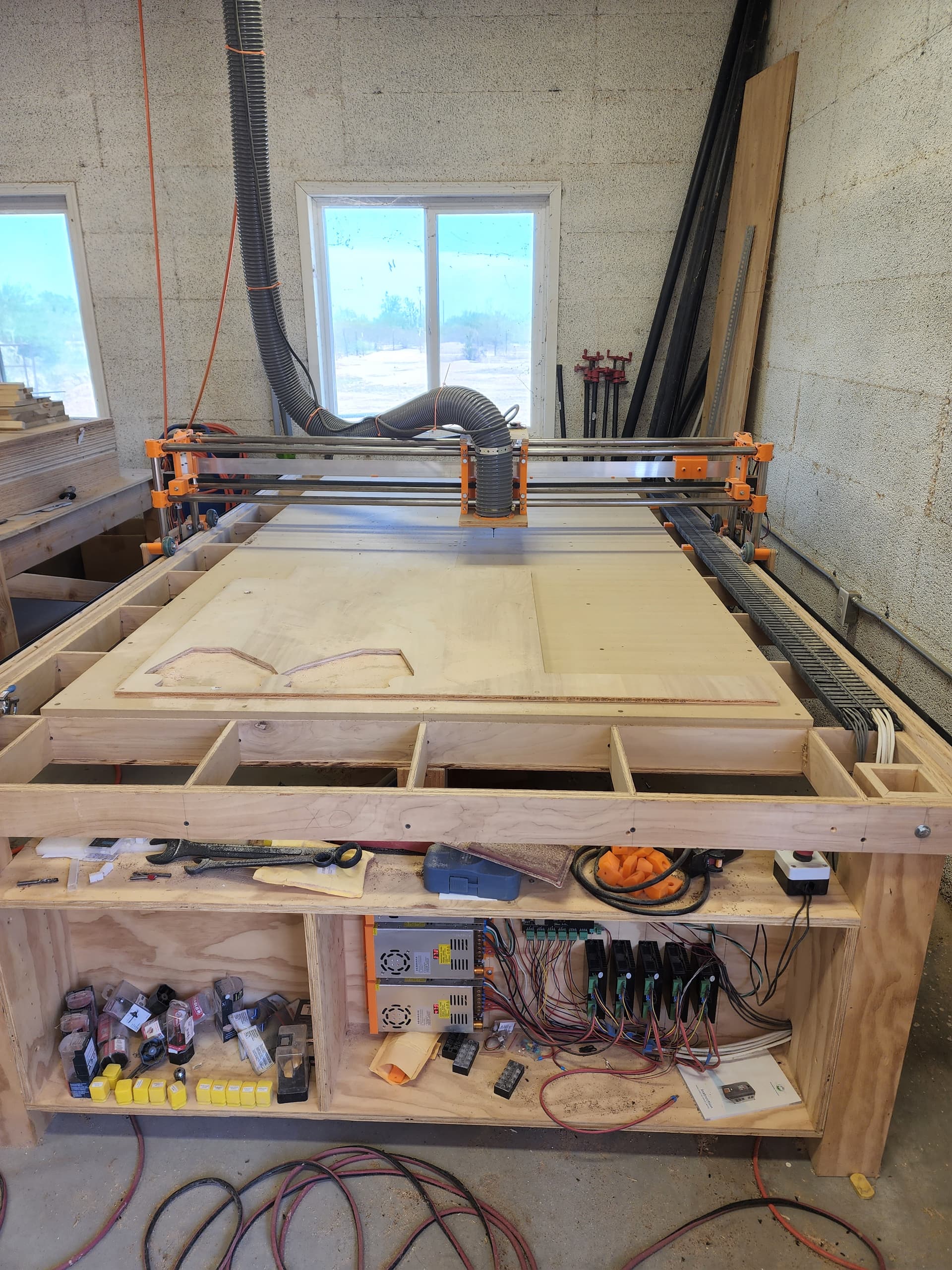

It has been a real work horse and a lot of fun. I haven’t done a lot with it in the last two months because it is too hot in my shop. Arizona can be a little tough in the Summer. I did just mill a pair of LR3 YZ plates on it. I am building a 24" x 18" LR3 for smaller projects. I think Ryan made a big improvement on the usability over the LR2.
Maybe I spend more time in my shop soon. I just got a quote for a mini split system to cool my shop.
Those nema 23 models says 3.5 volts is that the voltage drop. I see you r using 40v. You having any problems. Mine loose there holding torque. Mine are 269 oz. After I jog about 10 mm they back off a little. While it was engaged I could move the x axis. I got another stepper and driver coming. I have the driver’s are set for full holding.
I am also using the 269 steppers. I am controlling them with Bart Dring’s 6-pack controller running FluidNC (GRBL 1.1 variant). Except during the extreme heat of Arizona’s Summers, it has worked well for me. I plan to add a mini split to my shop this Spring.
