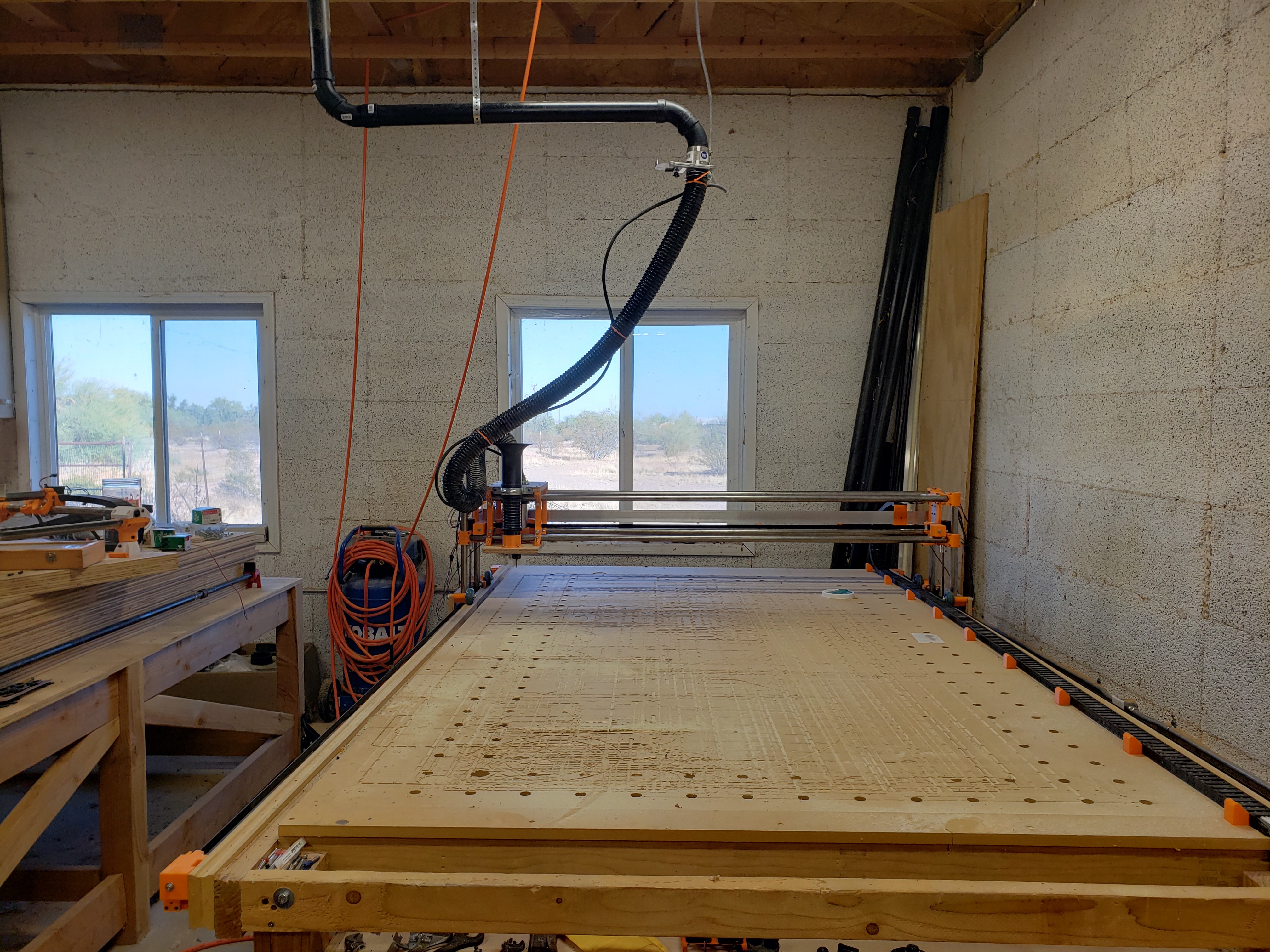

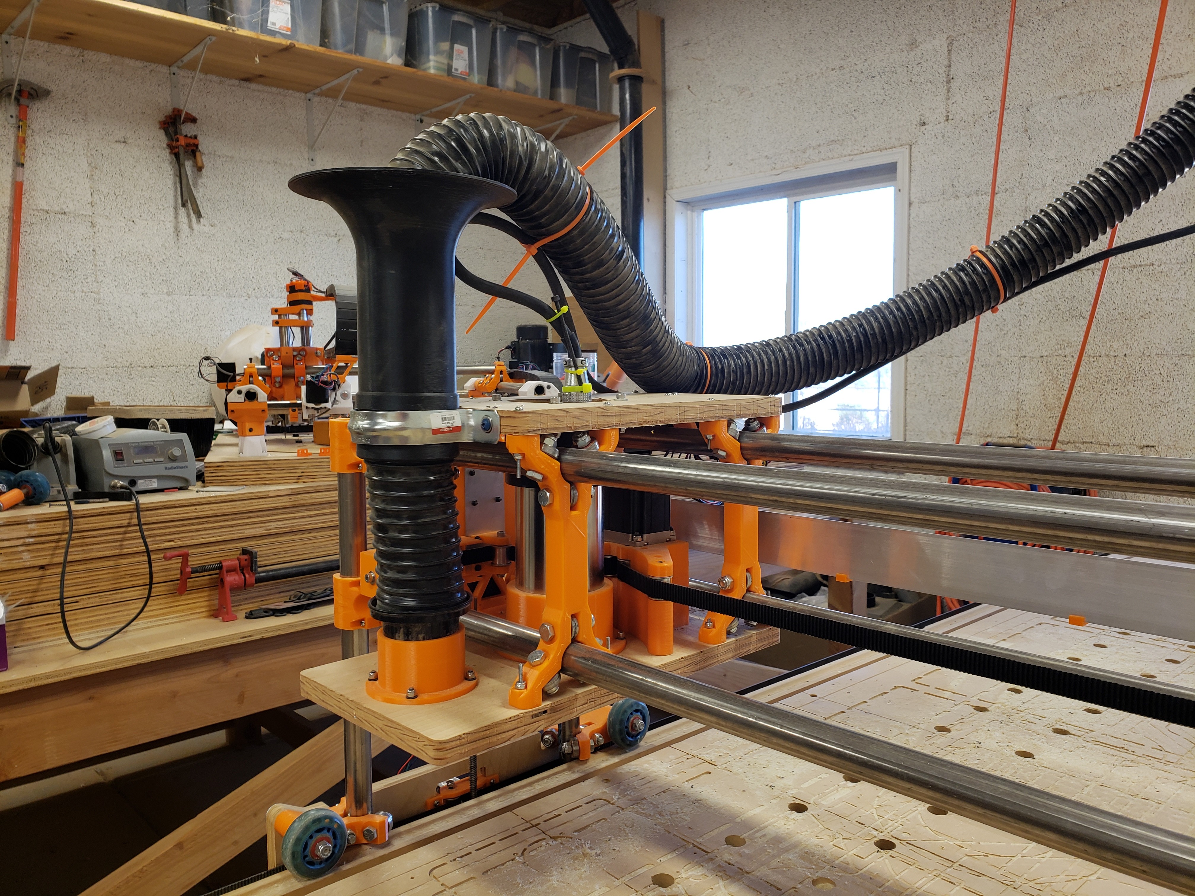

I like to mill plywood at 4000mm/min with 9.525mm DOC. That is by no means the limit of the machine. It’s not a race for me.
I imagine the original design could run as fast with a laser attached; however, I am only guessing because I have not used a laser yet. Maybe on my new Primo…
Living in the desert, heat becomes a factor for me before rigidity or torque.

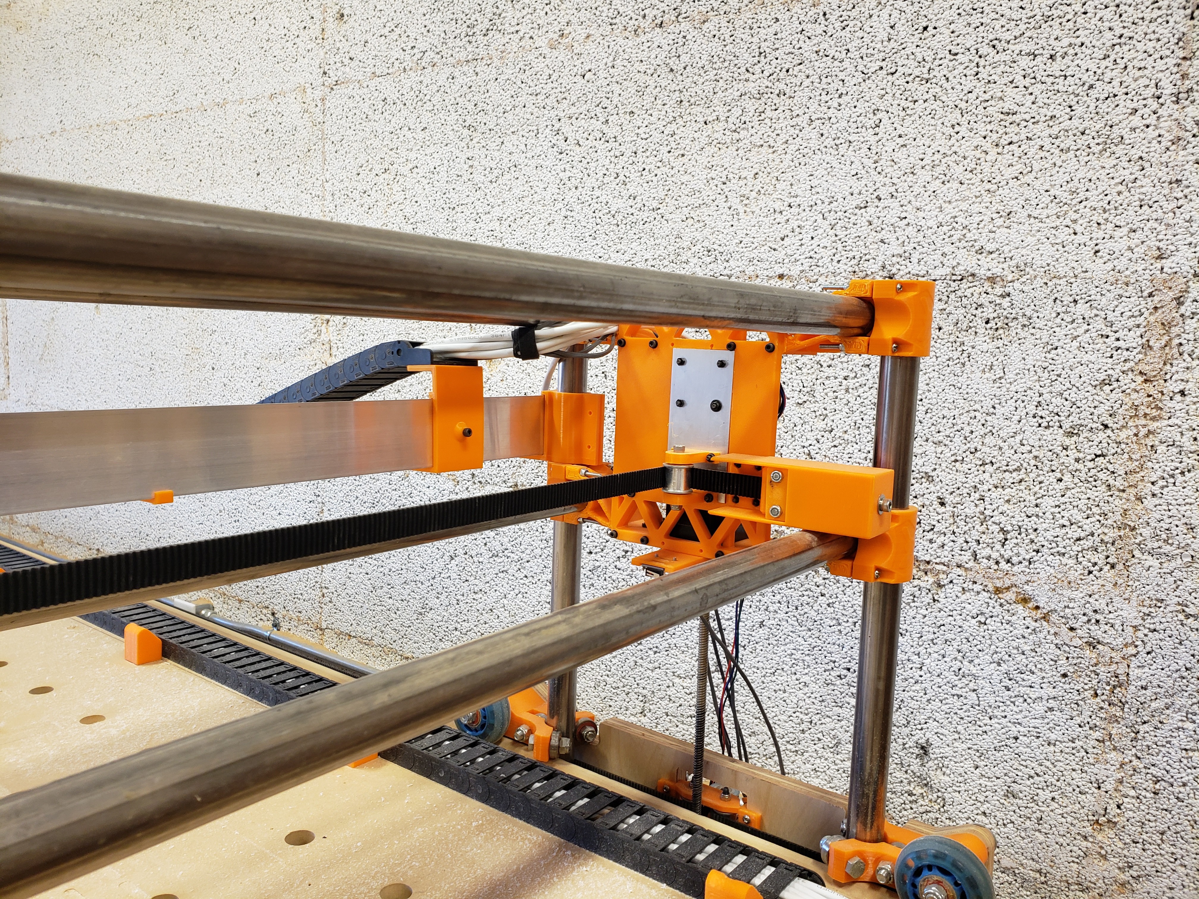

I want to build a lowrider2 with nema23, but with 25mm tubes.
I have to redesign some parts, right?
Yup, you’d need to redesign pretty much anything that touches one of the motor mounts, which have space and bolt patterns for the NEMA 17s.
It sounds like some people have updated the STLs for NEMA 23s, but I can’t remember seeing them published all together anywhere.
Honestly, if it’s your first build and you want to get to cutting sooner, I’d go with the base build NEMA 17s. You’ll be able to get more useful advice from everyone here because that’s the most common build.
For what it’s worth, the only time I’ve wanted to upgrade is when I’ve been a little too aggressive in the feed rate and ended up with the motor/belt skipping. To fix that problem, all I needed was to dial back the speed and have a little more patience… :slight_smile:
I redesign the parts of Tom Myers for a 25mm Lowrider2 with Nema23 Steppers. I can upload the files to thingiverse if it is ok for Tom.
Which spindle mount you use, Tom?
I have a 1,5kw spindle 65mm with FU.
Feel free to do whatever you want with the parts. Were there a lot of changes going from 25.4mm to 25mm?

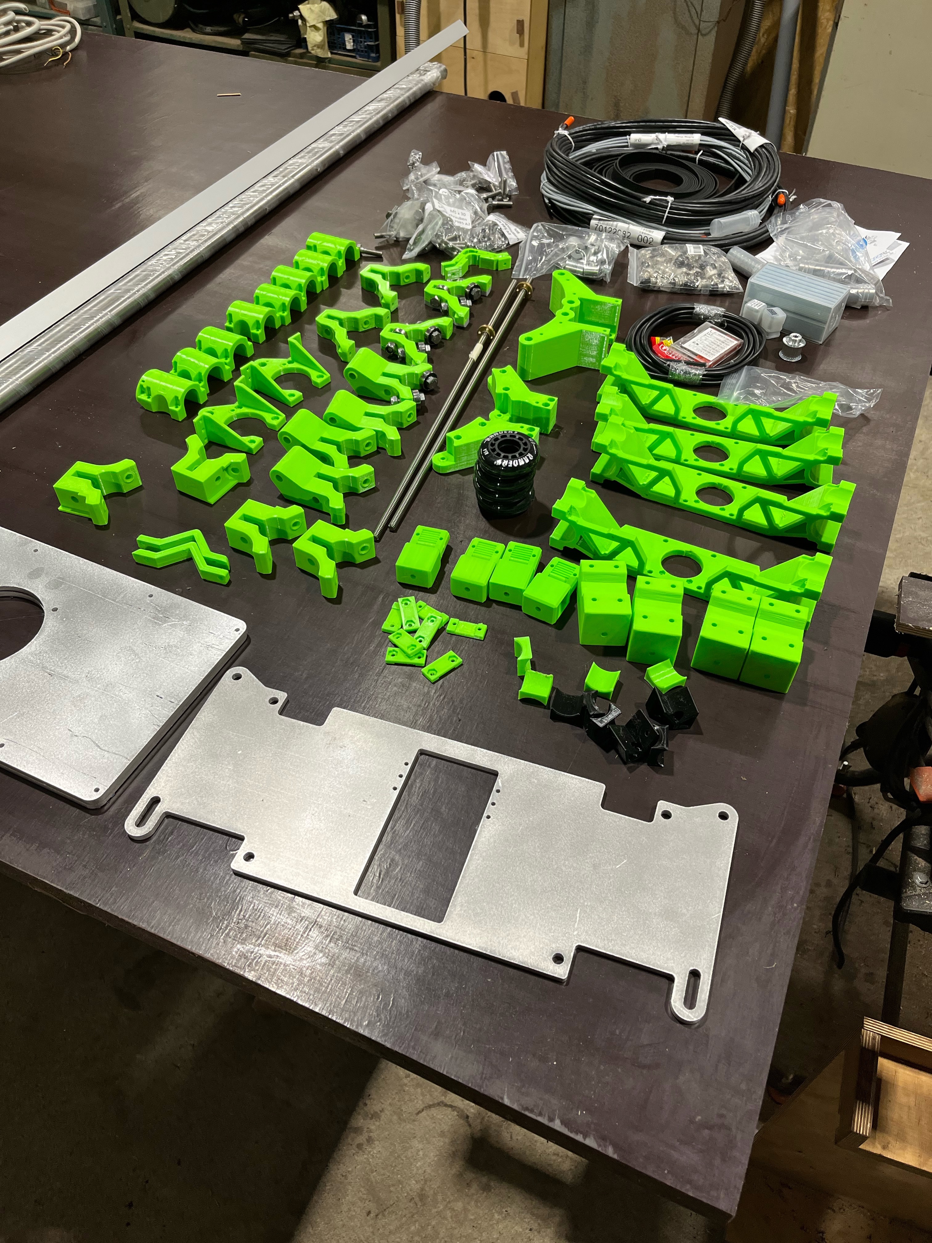

No, only the XZ Main. The 25mm parts of the classic Lowrider2 are compatible. I will upload the parts in a collection, when I build it, so im sure, that every part ist compatible.
I printed the whole things, waiting for the milling parts to build it.
I didnt print the belt tensioner for the x-axis yet, because of the mounting with the big plate.
I will build it with a Duet 2 Wifi and a Mafell FM 1000. I ordered a 1,5kw china spindle, but I will not use it.
Here is a first preview. Im waiting for the second XY Alu Plate…

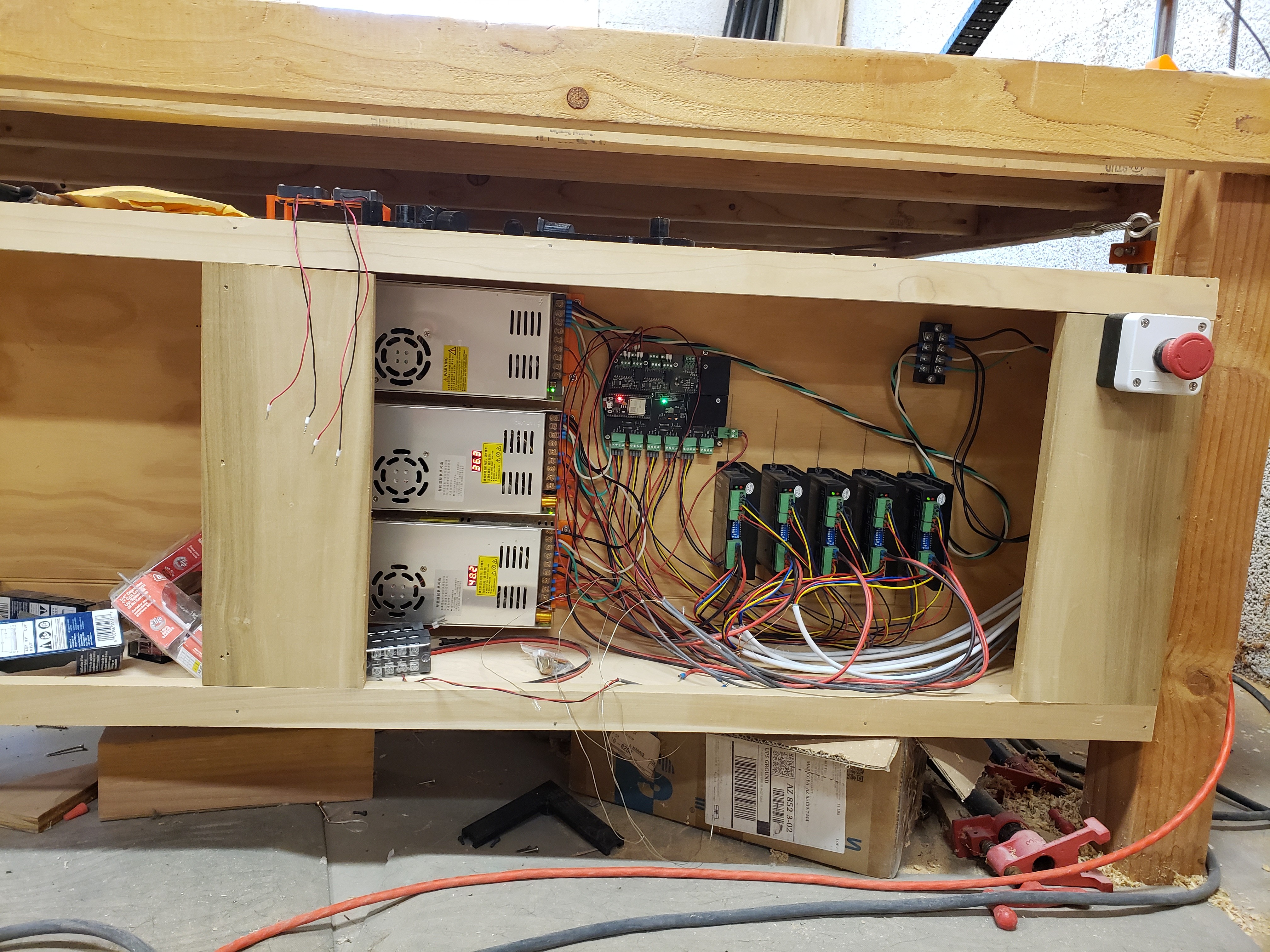

I just finished squaring up my gantry after placing all of my PLA parts with ABS and rearranging all of the controls.

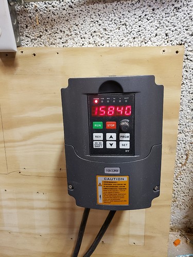

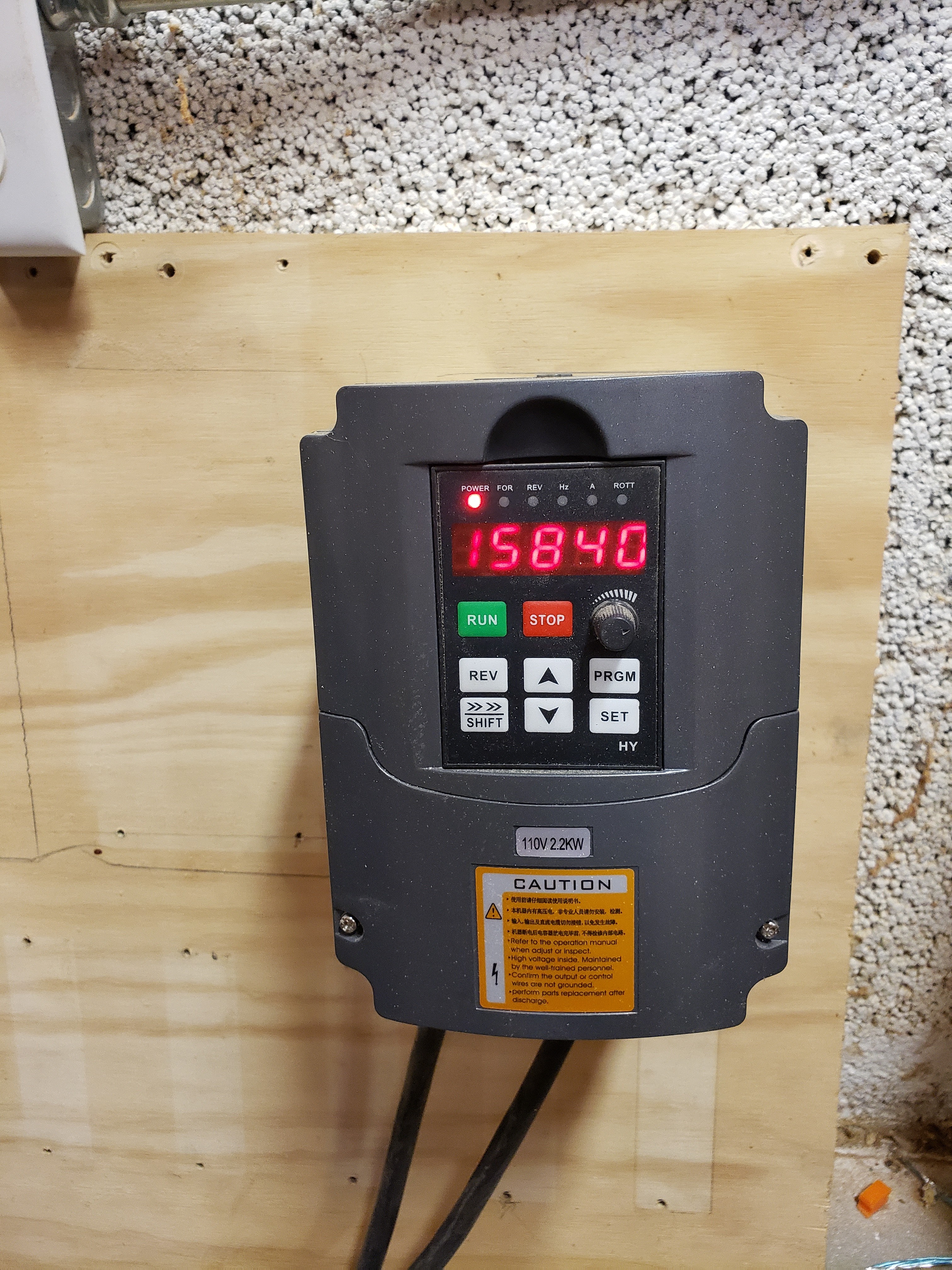

I still need to mount my VFD on the wall and connect it to my controller’s RS485 module.
