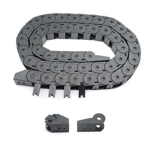

  2. are there any specs on a cable drag chain addition to the unit? ie a link to a chain, a required length, and a 3d print to attach it to the CNC?
I printed a drag chain and used an aluminium L-profile as well as @DougJoseph’s drag chain holders (which he designed for a bigger one), but still works.
For my LR3 that carries a router, I used this store bought drag chain and it worked great.
https://amzn.to/3LD0j10
…and I designed this mount for it that worked great:
https://www.printables.com/model/223004-lowrider-3-cnc-drag-chain-mount-v10

The hardware kit from Ryan’s store includes enough wire. If you are sourcing it on your own, it’s pretty easy to buy a big spool that’s way more than enough.
