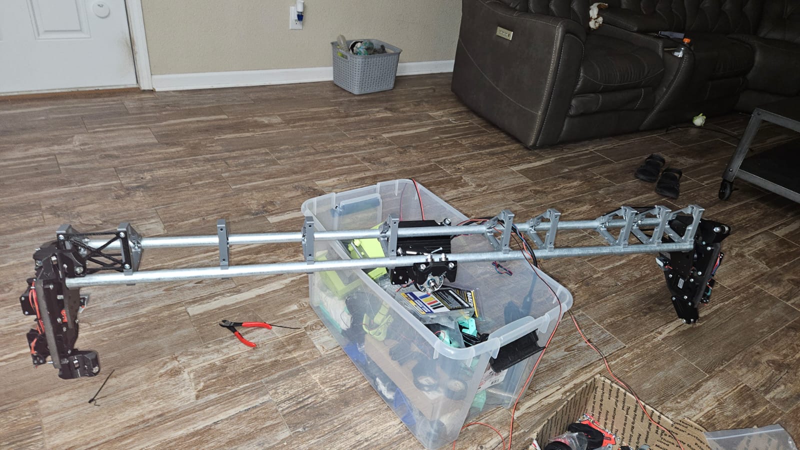

I think I have everything to start building, just need the time to do it now. I ended up printing your enclosure @DougJoseph for the SKR, not using the default one, the one that has the cable clamp and space for a Pi. :grinning:
Progress after 4-6 hrs of building.
Need to make an adaptor to use the case for the board I printed, terminate the cables, make my connections, and then get some struts made. i ended up making the cut area 50 x 98, so need to see if there are premade strut templates available

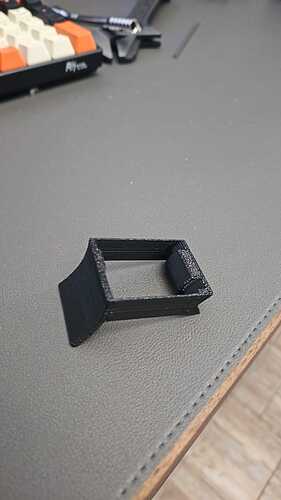

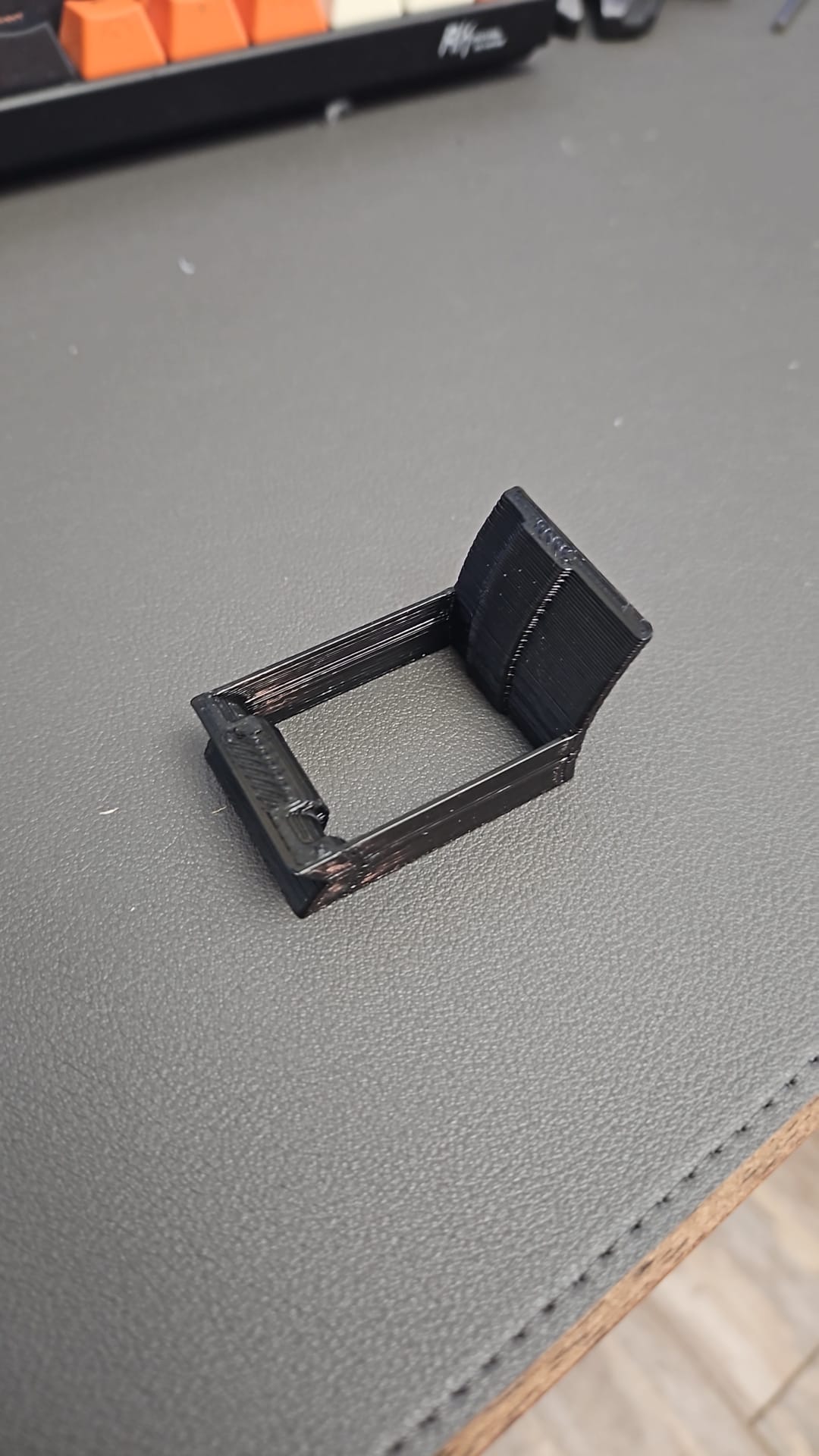

part identification needed, in the kit I have a 3d printed part I don’t see mentioned in the instructions.
What is this part for?
Looks like a Pen holder, so you can do the Crown :partying_face:
https://www.printables.com/model/237997-basic-lr3-pen-mount

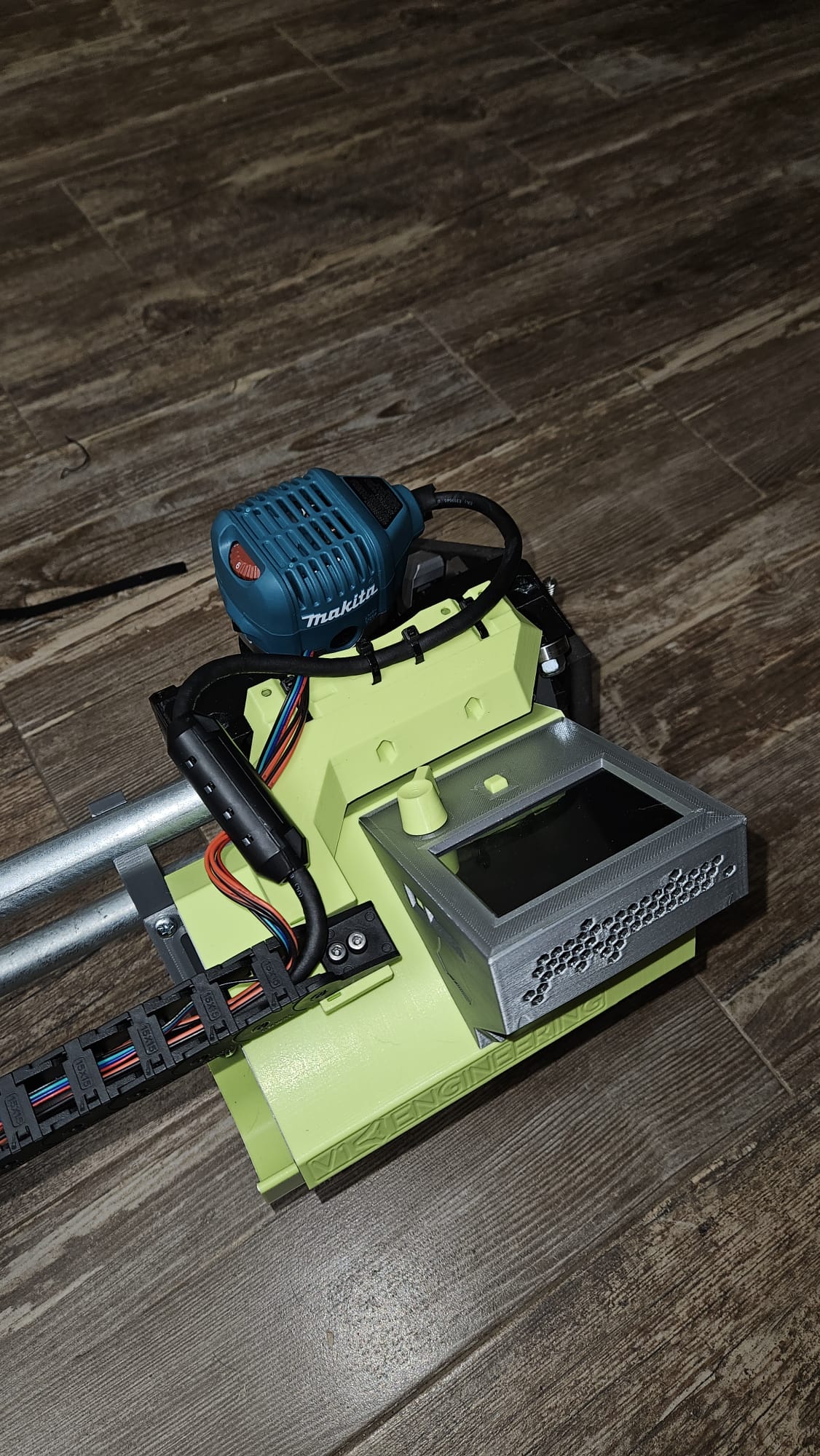

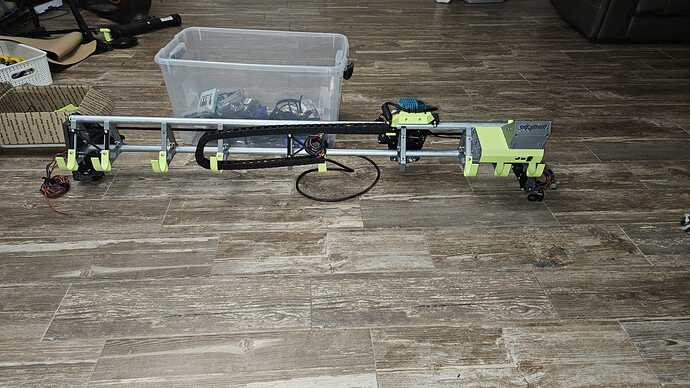

perfect, basically just got to crimp on some connectors and mount my x rail to unistrut and I’m on to testing.
Also need to redo some of the hose hooks to make them into cable chain supports.
Looking at the drawing, is the lower chain mount supposed to be mounted on top of a regular hose hook?

How are you guys getting power into your CNC gantry? I would need 2 outlets inside the gantry, one for the router, one for the control box. is there a good surface mount outlet / extension cable that is tested and used often?
