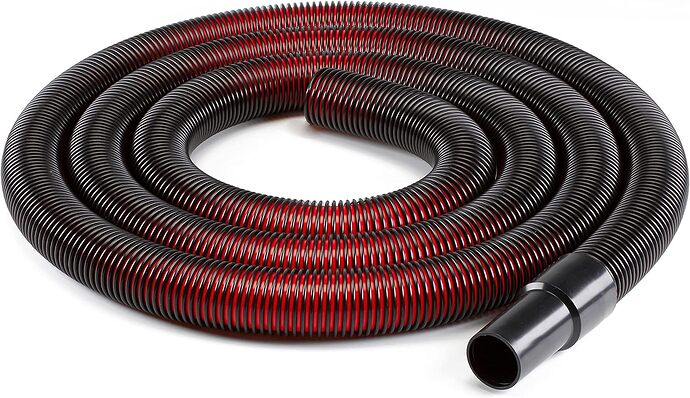

Next question is, is there a dust shoe that fits the recommended 1.5" hose listed on the V1 store:
https://www.amazon.com/dp/B075RZD97T?psc=1&ref=ppx_yo2ov_dt_b_product_details
This is already en route, connecting to a dust cyclone bucket and shop wen 12 gal collector

I got one last question for you, I am assuming the 3D printed parts coming with the kit don’t include your modified dust shoe.
Is there a variant of your dust shoe that works with makita and is compatible with the 1.5" recommended hose on the main page?
I’m in the middle of making a remix of an adapter to fit Doug’s 2.5ā€ shoe and my 40mm (ish) OD vacuum hose. I’ll post a link once it’s finished (might be a week or two, depending on how many times I screw it up).
Not that I have created, but some remixes exist that may suit the purpose, and as @Bartman mentioned:
So once he gets that posted it may help.
My thinking is the adaption point would be at the top. I don’t know if that’s the most effective conservation of suction power, but hopefully the diameter change from the top to the flex unit and down, would be OK.
Ryan will send out standard printed parts and not third party modified parts.
This means the standard dust shoe (which works with the Makita perfectly well) and standard height YZ plates, and not my taller modified ones. (Which are also not necessary for regular machine use.)
