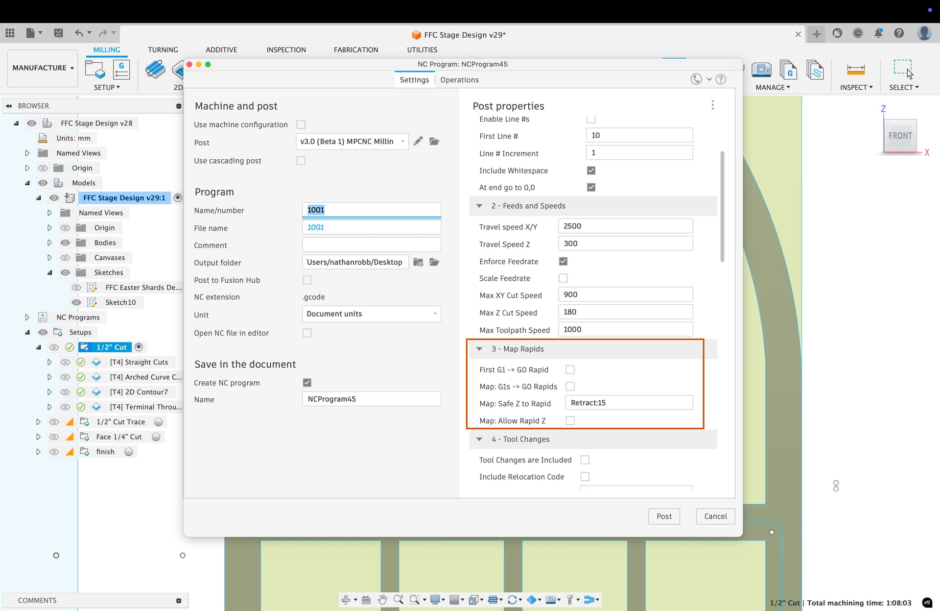

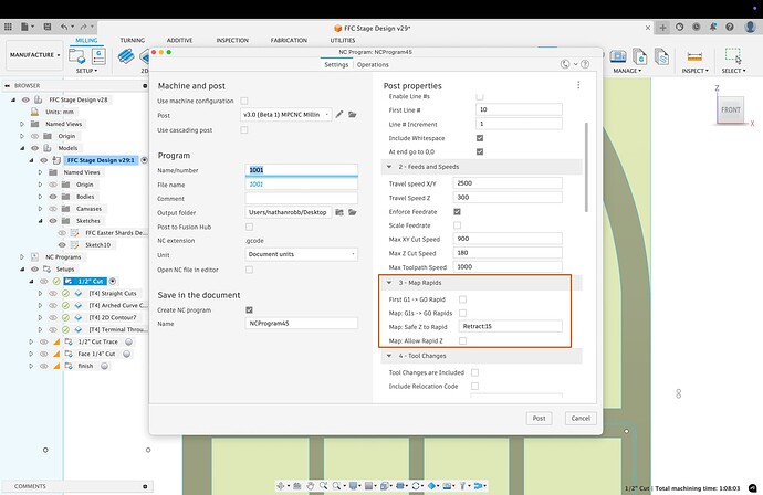

Yes, I’m using the “MPCNC v3.0 (Beta 1).cps” post Processor from Fusion 360.
estlcam seems to be windows only and I’m all Mac lol, so that is not a great fit into my workflow but I might have to find a PC to give it a test. Can’t imagine there not a good solution out there to go straight from Fusion360 into a GCODE file. if this “MPCNC v3.0 (Beta 1).cps” solution is actually not working out.
I do see G2 & G3 in the .GCODE files I’m generating so I must be using ARCS. Also, I see it’s checked in the PostProcessor before export.
I’ve been looking through the documentation for everything again and I just realized I did not bend the Senseless Homing Pin on any of my the TMC2209 chips as instructed in the Doc: “Disable Sensorless Pin”. Could this cause my X Axis issues?
I’ve got this section in Fusion 360 to convert G0 into G1 in the PostProcess section.
