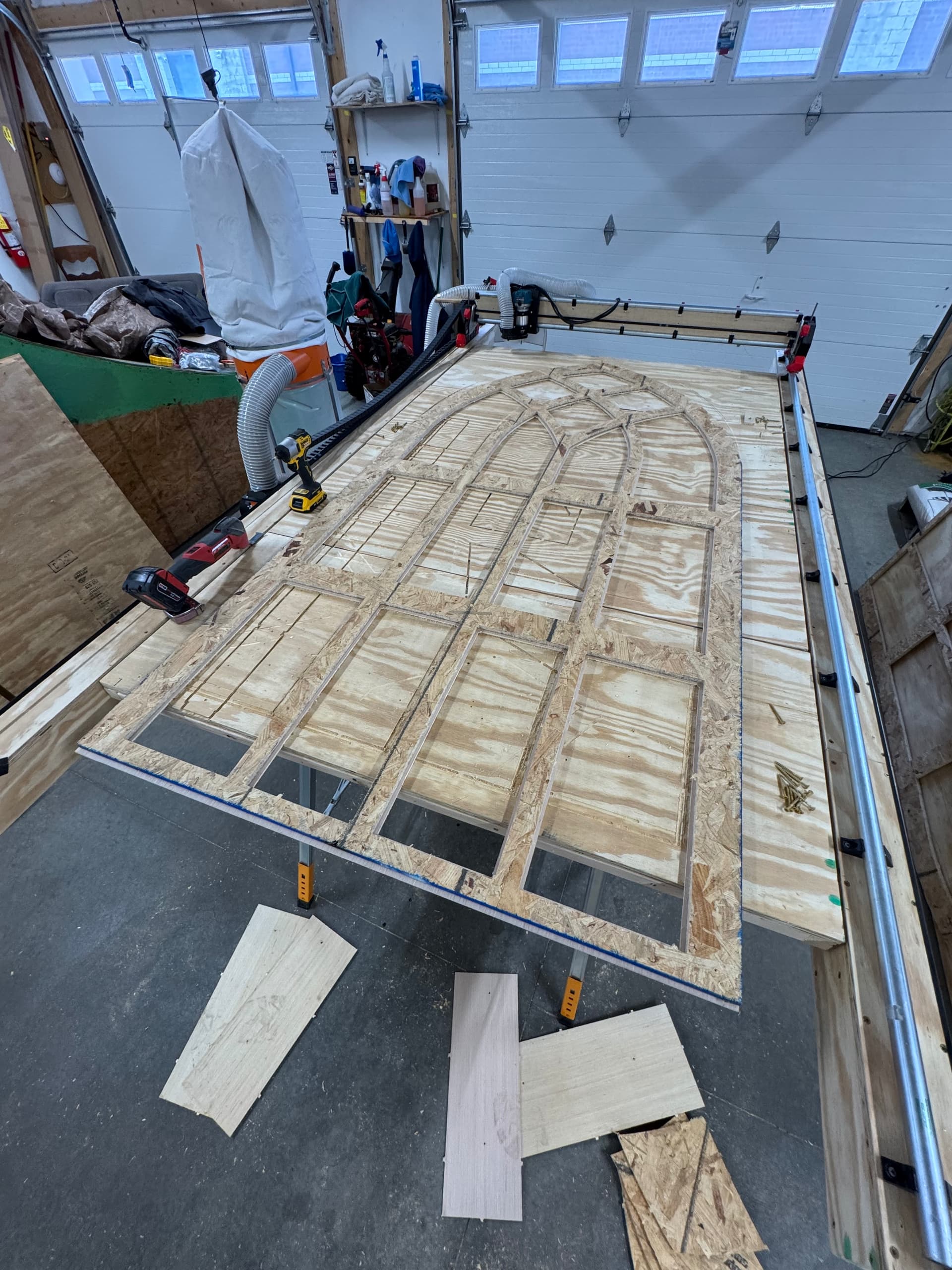

@vicious1 I’m cutting 1/2" OSB straight lines at “1000 mm/min”, 5mm per pass with the Router on 2-3 so (~12,000 - 15,000 RPM). Then I’ve got an arch I’m cutting out of the same sheet at “700 mm/min” and 4mm per pass. I was cutting faster before and the results are in that video I shared above (the other day), the router went rogue. So I’m thinking the X axis motor was either not strong enough at that speed and it skipped steps, or the motor needed more power. But I’m cutting slower now and it’s working much better. Regarding the larger X axis motor, I was thinking if it worked more like SkyCam at the NFL, where the motors are on the ground and pull the camera around. Probably isn’t necessary though, This Machine is super well built. BTW. :wink:

I just got the 1 Flute Bit, It does cut really well. But I’m still observing what seems to be skipping causing cuts to fail after becoming mis aligned. I slowed it back down to 4.5mm per cut, 900 feed rate. I can probably go slow and make it work still. BUT I’m seeing mis-alignment issues over multiple attempts to start the file. I think this might be some of the root issue with those skipping issues that I’m having.
I’m squaring the LowRider V4 to the end of the table, then manually aligning the endmill to the edge of the 4x8ft sheet of plywood, probably getting it +/- 1mm. But when the machine starts and the head moves over I’m seeing the cut 1/4" off from where it had just been cutting. The previous pass could not have been off by that much, The belts are tight, end mill is brand new. Both Y axis are aligned when it starts from 0.
I’ve got 40-4x8ft sheets to cut in the next 2 weeks and I’m becoming stressed. I’ve appreciated your helpful information so far.
Check the grub screws, belt tension, tension of the core on the rails, whether the connection between beam and side plates is good. That’s all that comes to mind at the moment.

I just completed checking the set screws and hardware, everything seems tight. With the motor engaged, it probably takes about 20LB of pushing force to get the X axis to slip. Definitively feels like it takes a little bit more force to get the Y axis to slip when the motor is engaged. Maybe 35LB.
I just watched the X Axis Stepper Motor Skip, like: not enough current getting to the motor skipping. Not the belt slipping, the end mill was going in a straight line towards X- and the X stepper started skipping. The X Carriage stopped moving (Skipped for the time it should have used to move 5 inches) then turned 90 degrees towards the Y- axis before I unplugged the machine. The 90 degree turn it took, it was supposed to go another 5 inches then turn left. The Stepper was NOT slipping on the grub screws.

Could I have gotten a Bad SKR Board? I’ve observed this a few times now, but I just ran a cut, I started the end mill at the corner of my 4x8ft board where I programmed 0 to be on all 3 axis to be. It went over to start the cut and its first pass is 1/2" above the surface. Now I realize this was my 13 attempt to start a cut with newly exported GCODE just today, so I could be going crazy. That part is weird, but the issue is this. I hit stop on the screen, but the machine kept moving. Sometimes when I hit stop from the screen, the machine stops immediately, but the other half of the times it does this and just keeps going until I unplug the machine sending the end mill through my board RIP. While the machine was supposedly stopped, I was even able to restart the cut.
I’ve not re-uploaded firmware on this SKR. The wiring is all taped and zip tied, there is a fan blowing continuously in the 3D SKR board case. I’m wondering if this is the cause of some of my problems. I increased the current on the X axis this morning from 900 to 1000. The rest are still set at 900, like I shared before.
