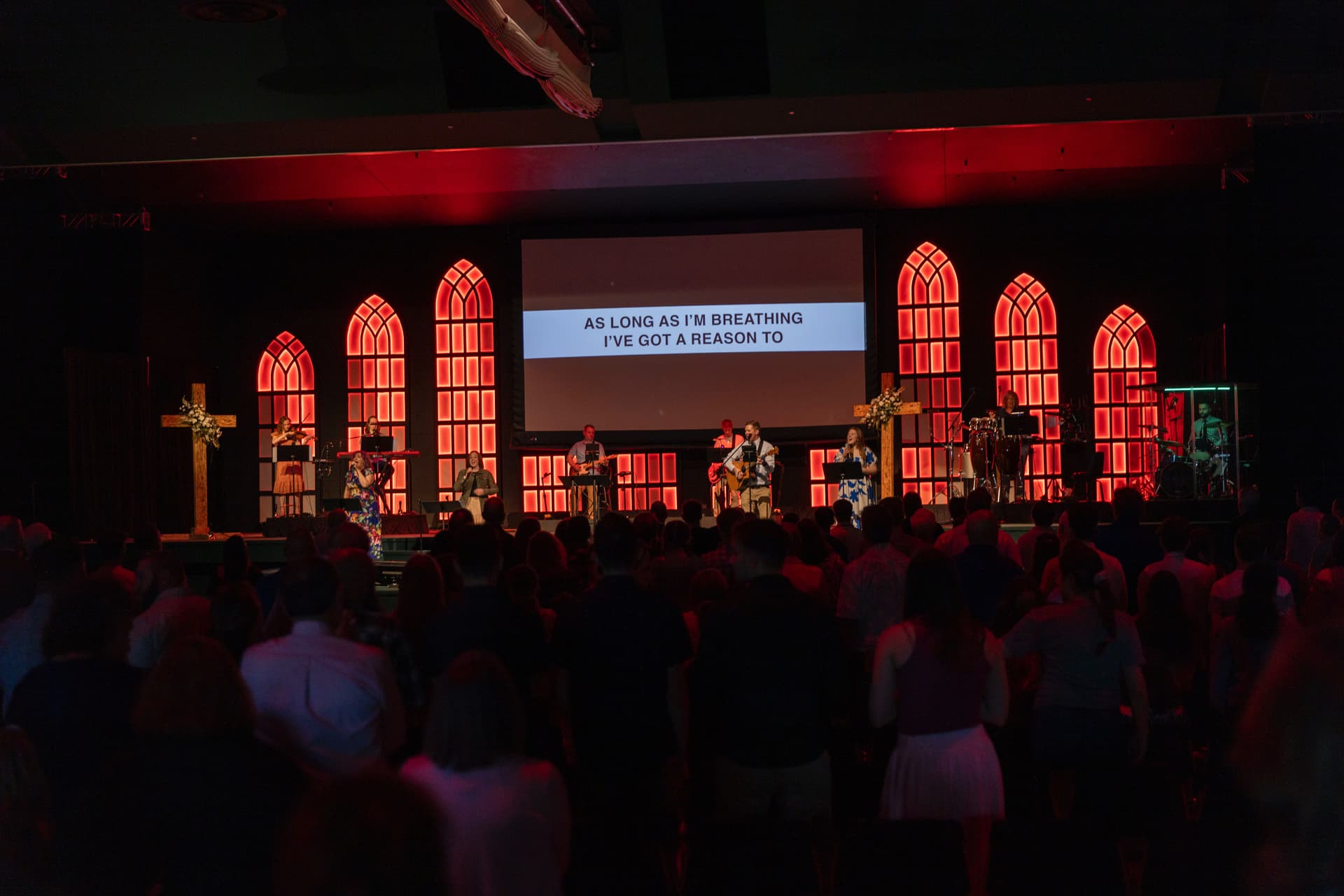

What a month it has been! I finished the new Stage Design Project, it took about 300 hours though. We ended up using the Circular Saw for a bit of the cutting of the rectangles from the 1/2" OSB, but used the CNC to cut all the faces out of 1/4" plywood. There is a Diffuser layer between the 1/2" LED layer and the painted black Face, with a white back on each to reflect the light. (WhiteBack->1/2" OSB with LEDS & Wiring-> DiffuserMaterial-> 1/4" Face painted black.) In the final days of cutting I took the Router off the CNC to do some manual routing and realized the single flute end mill was horrible on any speed, It’s hard to run on speed of 3, Which is what was recommended. No wonder the machine was struggling. I switched back to the duel flute end mill and turned the speed all the way up and it cuts like butter. haven’t put it back on the CNC yet, to try and cut something, but there is clearly more to this then I previously realized. I learned I should manually cut a sample of the cut material to check for the best settings, then cut with the machine.
Thank You all for your help on this! Now I need to get back to the dreaming stage to see when we should cut next.
